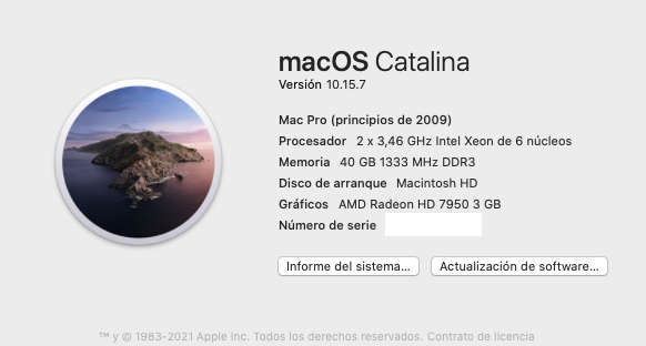

Is your card flashed with the Mac BIOS too? Or do you use the original bios? Thanks
