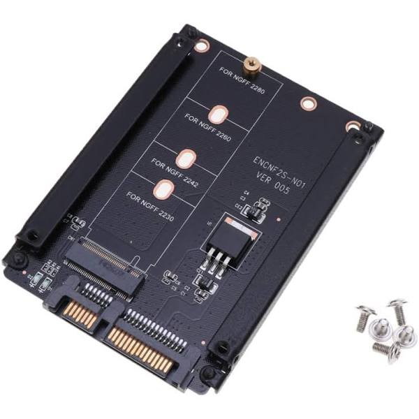

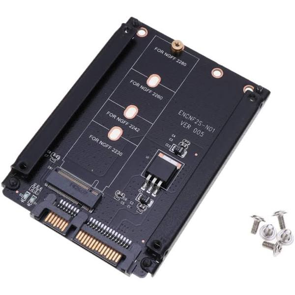

This don't exist at all, only SATA M.2 to plain SATA.
BTW, SFF8639 adapters work because the U2 SAS cable also has the PCIe signals.
Maybe a miscommunication or false terminology

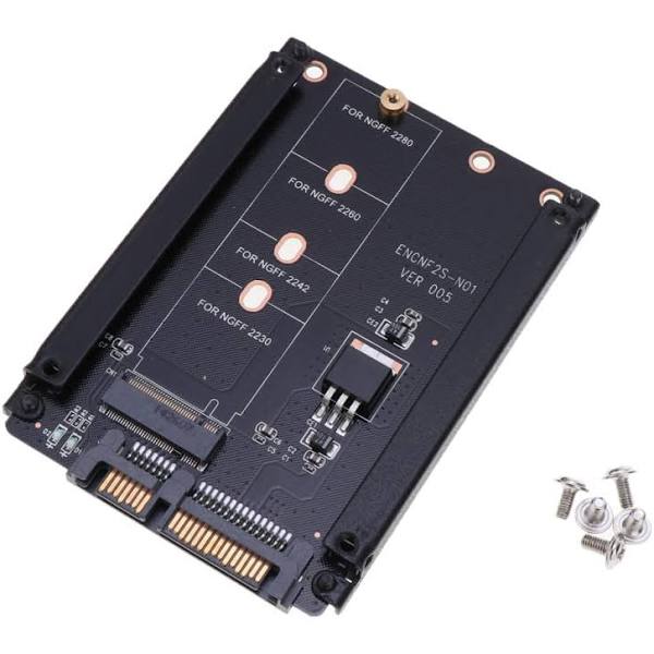

This is for a B-key (SATA) M.2 blade. You can't even insert a M-key (PCIe AHCI/NVMe) blade.
It says for both actually in the product description, but if not this card then another. Point being they exist. But I have since learned that that's not a solution either, regardless. It's just a bit misleading when everyone's talking about Nvme's when it could be any hard drive - the issue persists regardless.
Sorry, but they don't. How do you convert PCIe signals from the M.2 blade to the Mac Pro SATA interface?!?
M.2 is a format, this format have two main standards, M-key and B-key. M-key blades require a M.2 PCIe interface, B-key blades require a SATA M.2 interface. You can't use a B-key adapter with a M-key blade, they don't even connect.
You can only use a format adaptor to connect a B-key M.2 blade to the Mac Pro SATA ports.
So what about 2.5" SATA SSDs? But like I said according to my research, it doesn't seem to make a difference, either.
There exists USB to NVMe Bridge Chips (such as the JMicron JMS583). Some of the enclosures that can do this also support SATA devices using a USB to SATA bridge.
I suppose a SATA to NVMe bridge chip could be possible (well, anything in computing is possible with enough work) but I don't know of any.
I did find this NVMe to SATA Bridge:
https://www.intelliprop.com/ipp-nv186a-br/
But it connects SATA SSDs to a host's NVMe slot which is the opposite of what we want: to connect NVMe SSDs to a host's SATA slot.

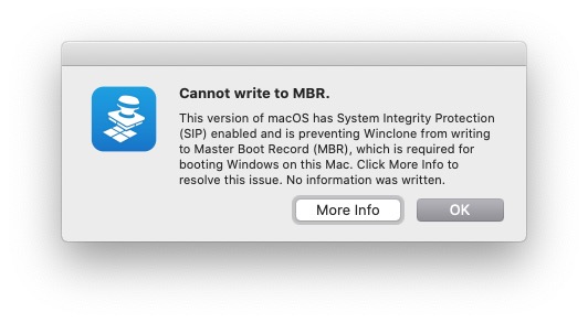

SOLVED
It was my own mistake. WinClone 9 was not able to unmount the internal partition from that boot SSD and so it shows up that error. I boot up from an external SSD and all was fine restored.

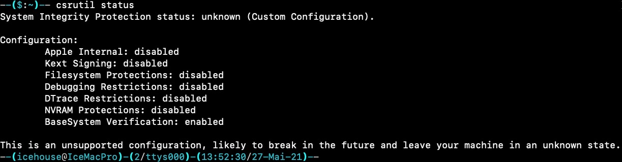

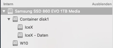

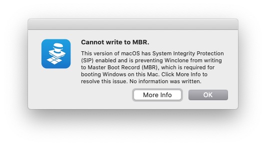

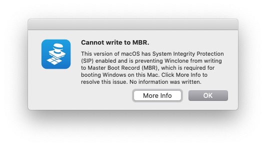

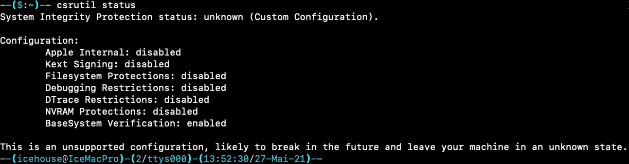

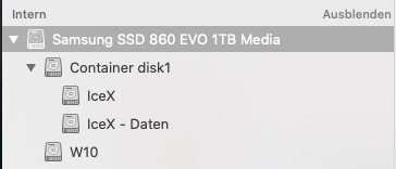

Hello together,
I am looking for some advice. I'm running the OpenCore 0.6.9 Package from Martin Lo with macos Catalina 10.15.7 Build 19H1030. I also running Windows 10 Pro 64 Bit latest Updates as UEFI Install via OpenCore BootManager - all fine. Today I made a Image via WinClone 9 because I want to move Windows to the internal drive Samsung EVO 860 SSD 1 TB via OWC Accelsior S.
I made a 200 GB Partition in the backyard of the disk (see picture disk.jpg) as I had this structure before on the other disk. Now I try to restore the Windows Image from WinClone 9 to the disk and then I got an error which I did not expect because it shoud not be shown - but see for yourself:
SIP is disabled
WinClone 9 Restore Error
Disk Structure
Any hint is very welcome...
SOLVED

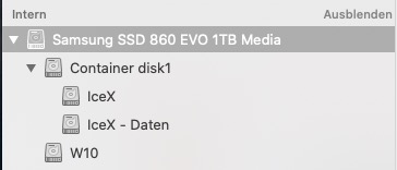

Hello together,
SIP is disabled
Disk Structure

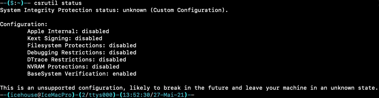

Use this setting for SIP:
Code:
<key>csr-active-config</key>
                <data>fwgAAA==</data>
Code:
nvram csr-active-config
csr-active-config    %7f%08%00%00
Reactions: paalb
