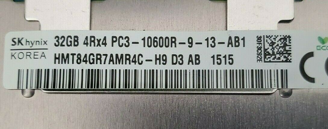

Did anyone happen to get a look at 205Maxi's config file? I picked up some 32GB sticks but I can't get passed the memory check on startup at the mac logo startup screen. I think he was spoofing mac pro 7,1 to get it booting but I'm not sure.
Confirmed. Working up to 256GB. The OC team have done some incredible things for mac pro 5,1 users. Thanks to all of them for their hard work and contributions developing the software. This will be my last mac computer I think. It is an amazing machine and I would argue that it is probably the best Apple have ever made.

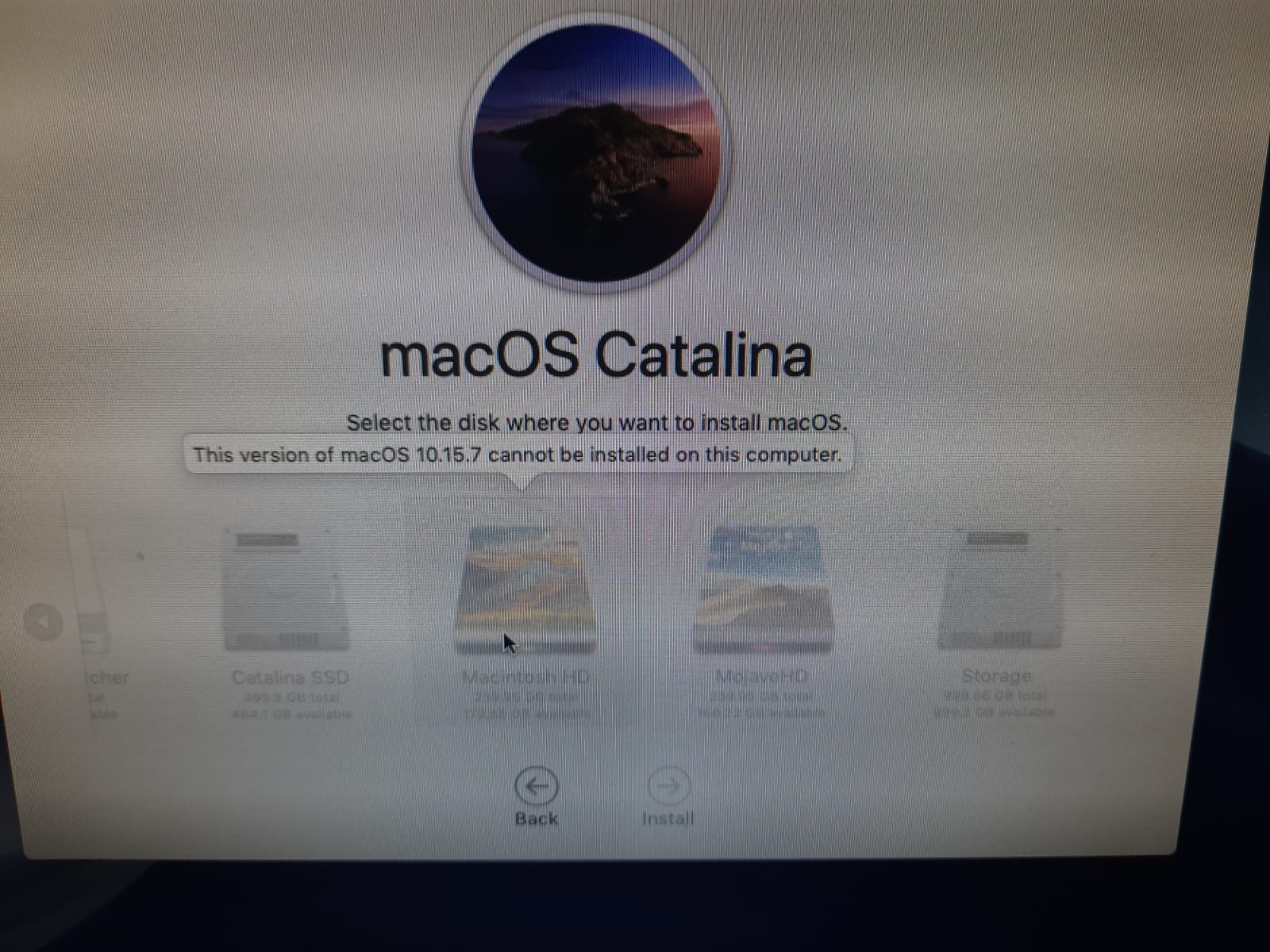

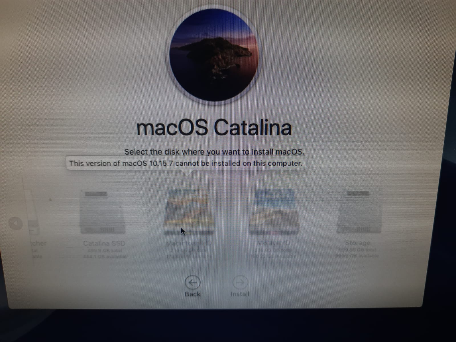

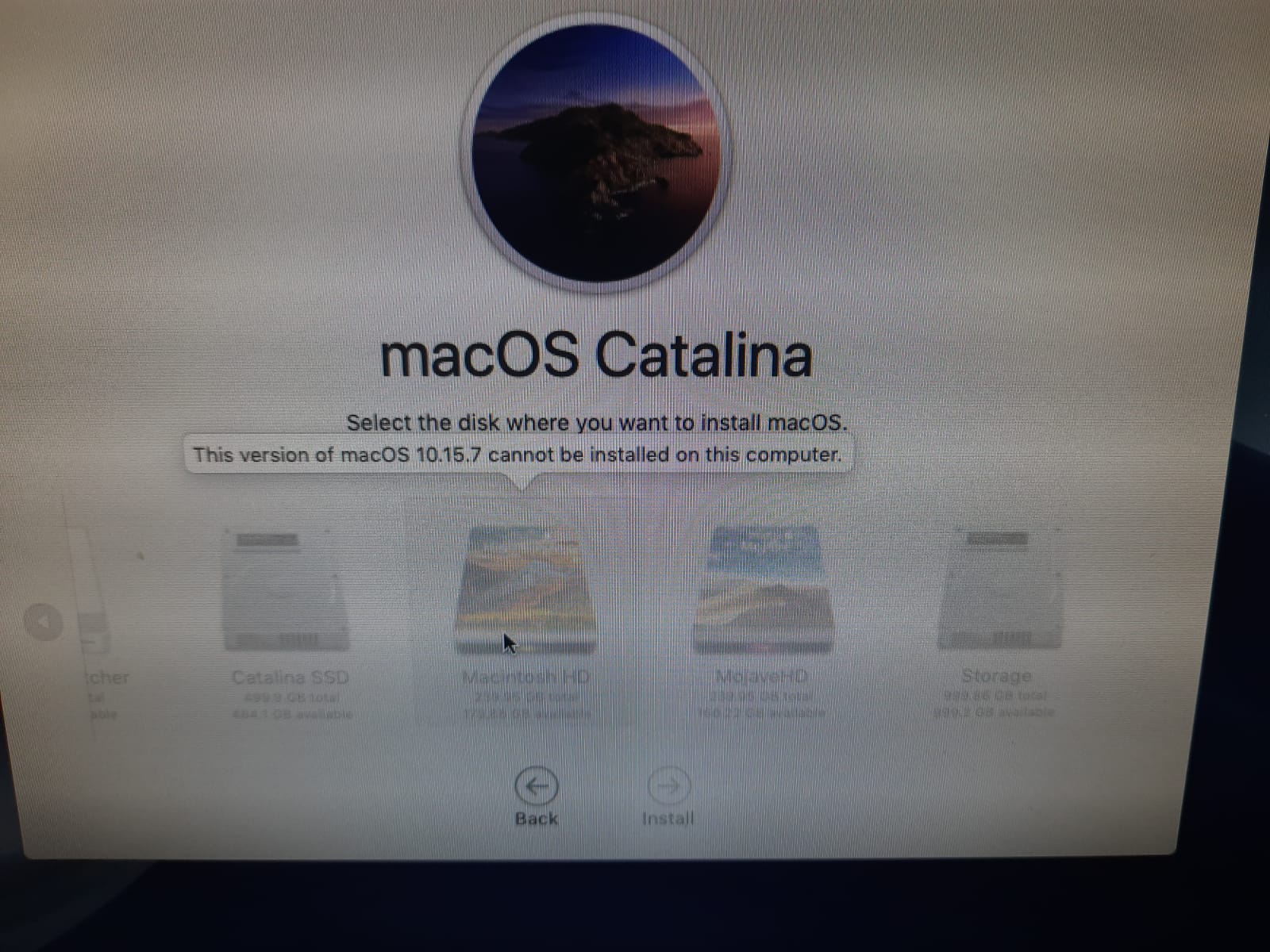

MacPro 5.1 opencore 0.6.9 install catalina from mojave the installation disk was disable,try with HD7950,GTX680,how ever catalina patcher was work,one issue was display ports catalina going black after booting ,highseira and mojave work on the display port of gtx 680,any solution for display port (Dell E2720H )
Make sure that the VMM flag is enabled.
