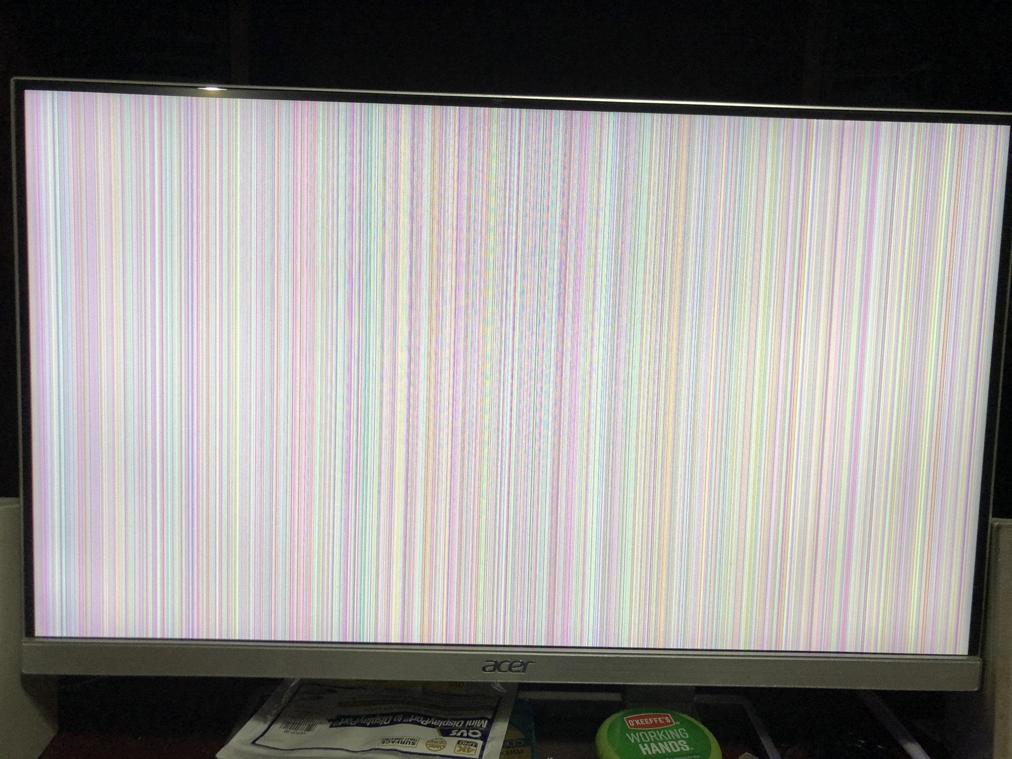

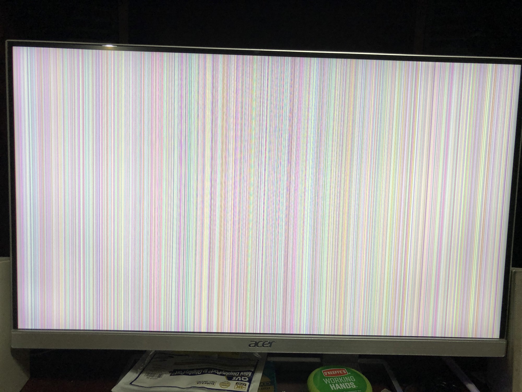

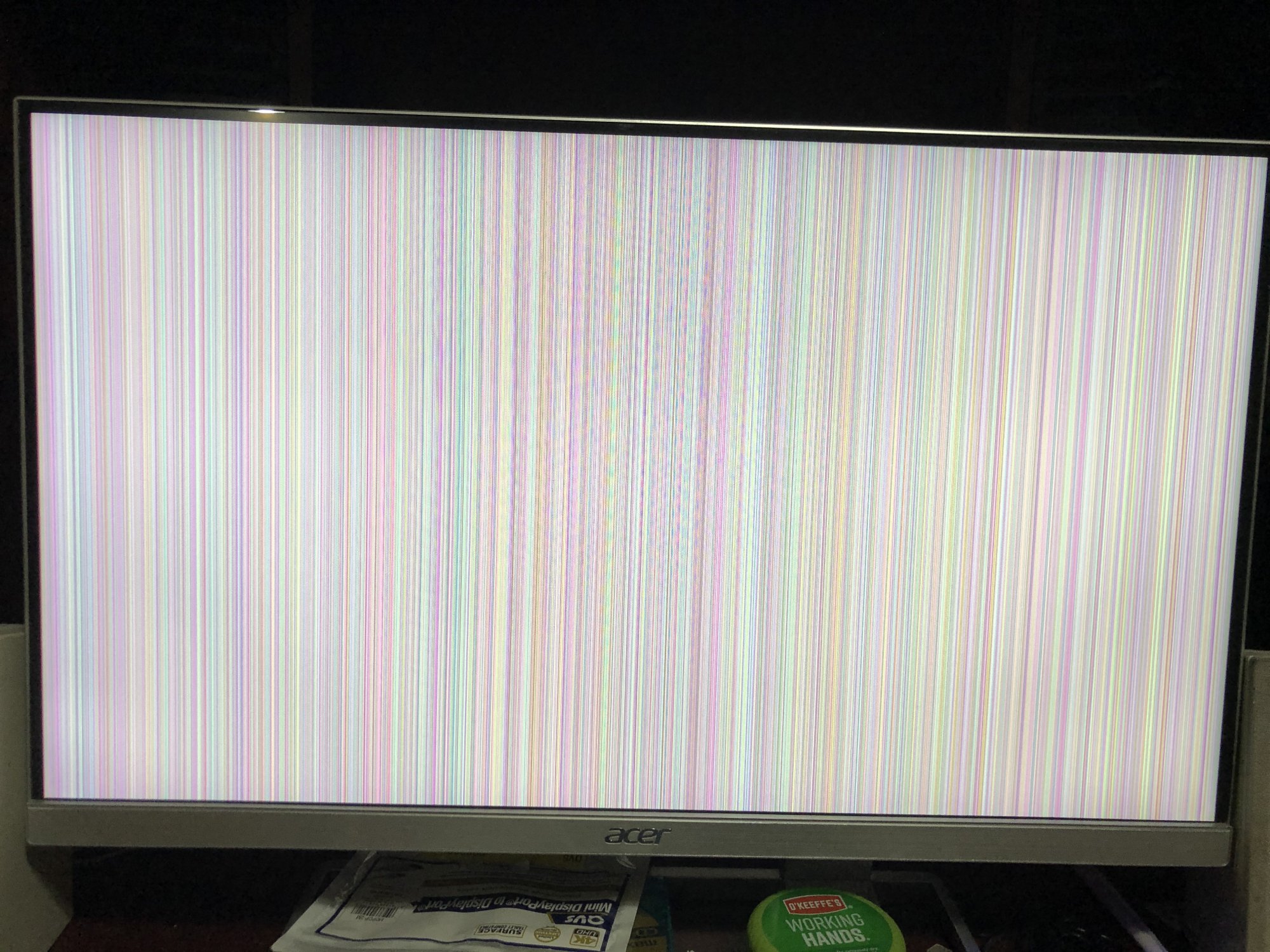

Just woke my MacPro5,1 up from display sleep (locked screen - Not full sleep) and got this screen.
VNC worked to do a graceful reboot and then it was fine.
FileVault had finished encrypting the main drive earlier today, so that could be related.
I am running OC 0.6.8 on Mojave, does 0.6.9 fix any issues like this? Video card is Radeon RX 580 "MacVidCards" edition.
It was not a full sleep which I haven't even tried since putting OC. Before OC if I slept it, it would just wake up again right away. But it's also the file server so sleeping it kind of defeats the purpose.
Other might have an OC answer to you. My tip is to disconnct and connect your monitor the next time this happen. I am familiar with this happening on a clean install without OC.

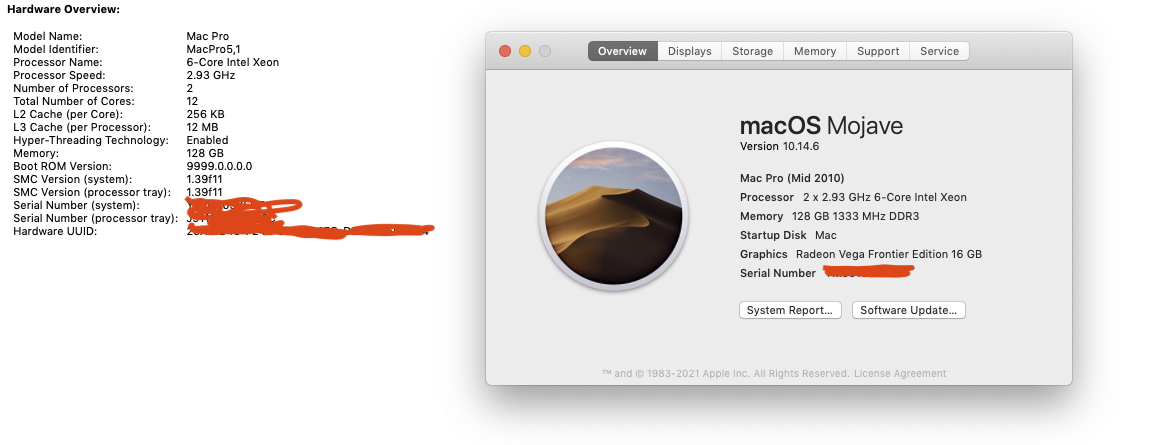

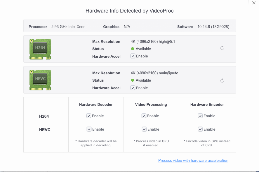

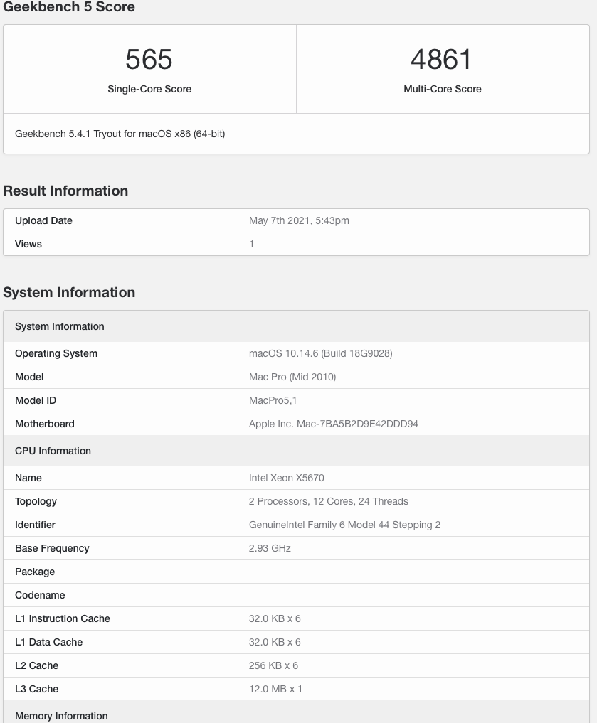

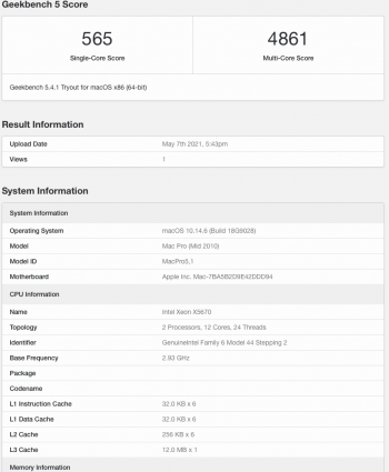

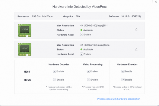

Hi, I have also asked this question in "Activate AMD hardware acceleration" thread. I had successfully installed OpenCore 0.6.8 on NVMe drive and Windows 10 UEFI on separate NVMe drive. Everything works. Both MacOS Mojave and Windows 10 properly reported 2x x5690 3.46GHz CPUs. After installing OpenCore 0.6.9 and turning on hardware acceleration my MacPro 5,1 with 2 X5690 reports as 2 X5670 @2.93Ghz. Is there a way to fix this. I followed a guide from this thread and double checked my config.plist. Is it something to do with AppleMCEReporterDisabler.kext? I have tried removing dictionary for Disabler kext and nothing changes. Anybody else has similar issues? I see people having hardware acceleration enabled and still showing 2x 3.46GHz cpus. I am puzzled as 0.6.8 OpenCore reported correct data. Thank you.
Edit: Just ran Geekbench and that's what I got😕! Single-Core 565 and multi-Core 4861...
You may want to try enabling debug log and see the frequency report/calculation there.
Reactions: AlexBurdov
I have really low geekbench scores with 0.6.9. Mac Pro is maxed out and looks like should be able to get to ~28000 in multicore test. I only get 4861! I have never tested it with 0.6.8. If I want to revert back to basic 0.6.8 without any advanced features turned on. Do I have to do anything extra besides replacing OpenCore files and config.plist on EFI partition with 0.6.8 version? I am not to well versed in it and I am not sure how writing to SMBIOS during hybridization step and deleting couple keys from NVRAM by following the guide affected it. I am hesitant to brick it...
