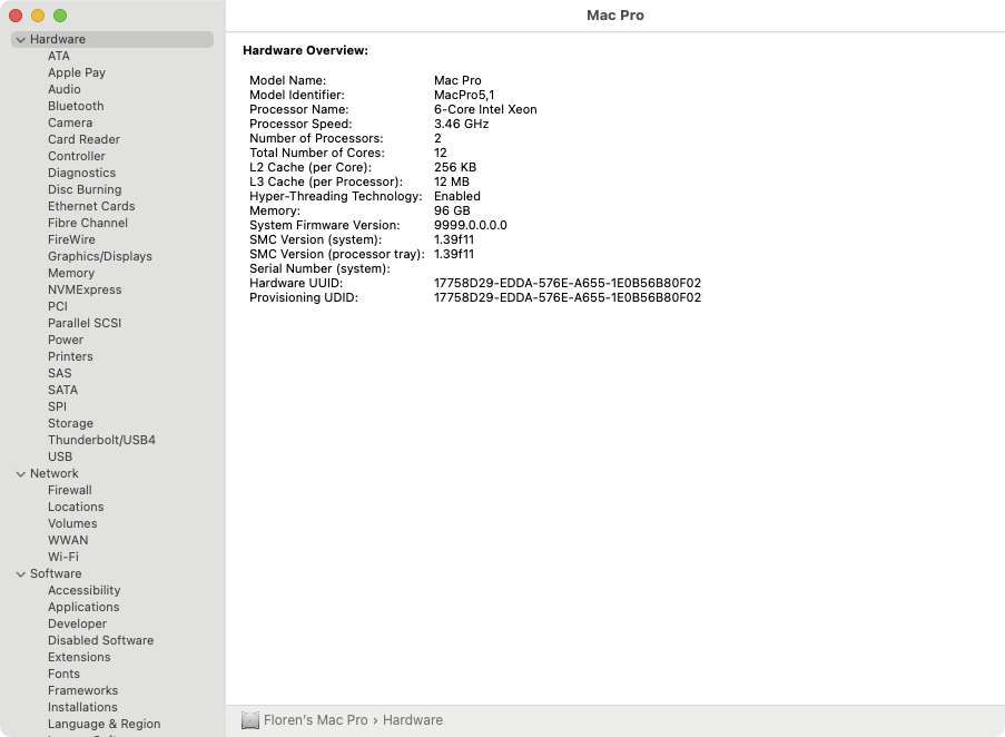

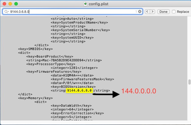

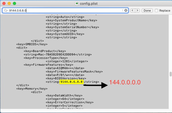

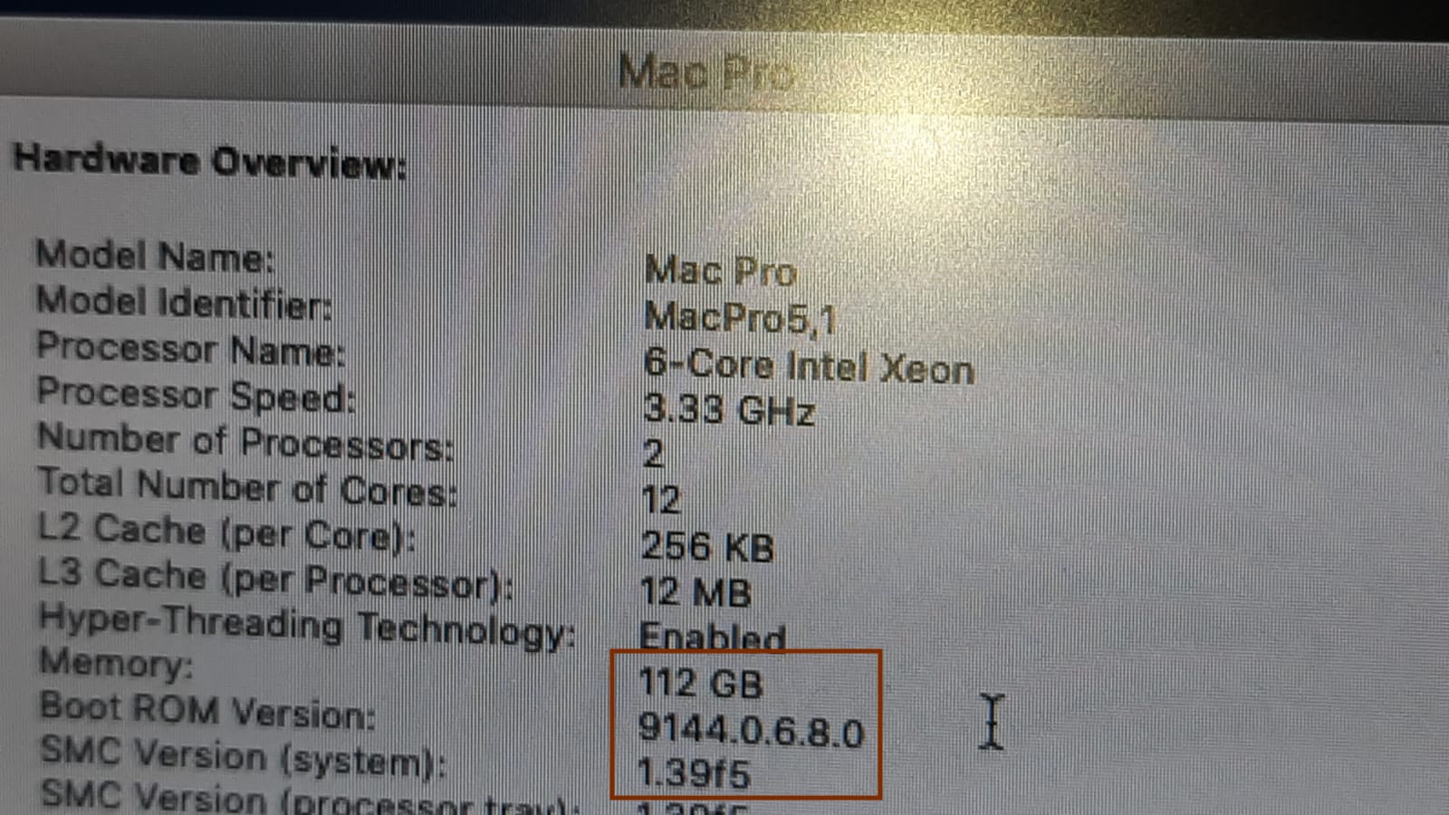

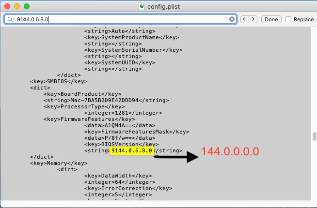

This is the intended version number set by Martin's package. Part 2 of the guide explains how to set this value. You want a high version number to prevent unwanted firmware updates.
Note that resetting the NVRAM without properly reblessing OpenCore is problematic. There are several comments about this in the last few pages of this thread.

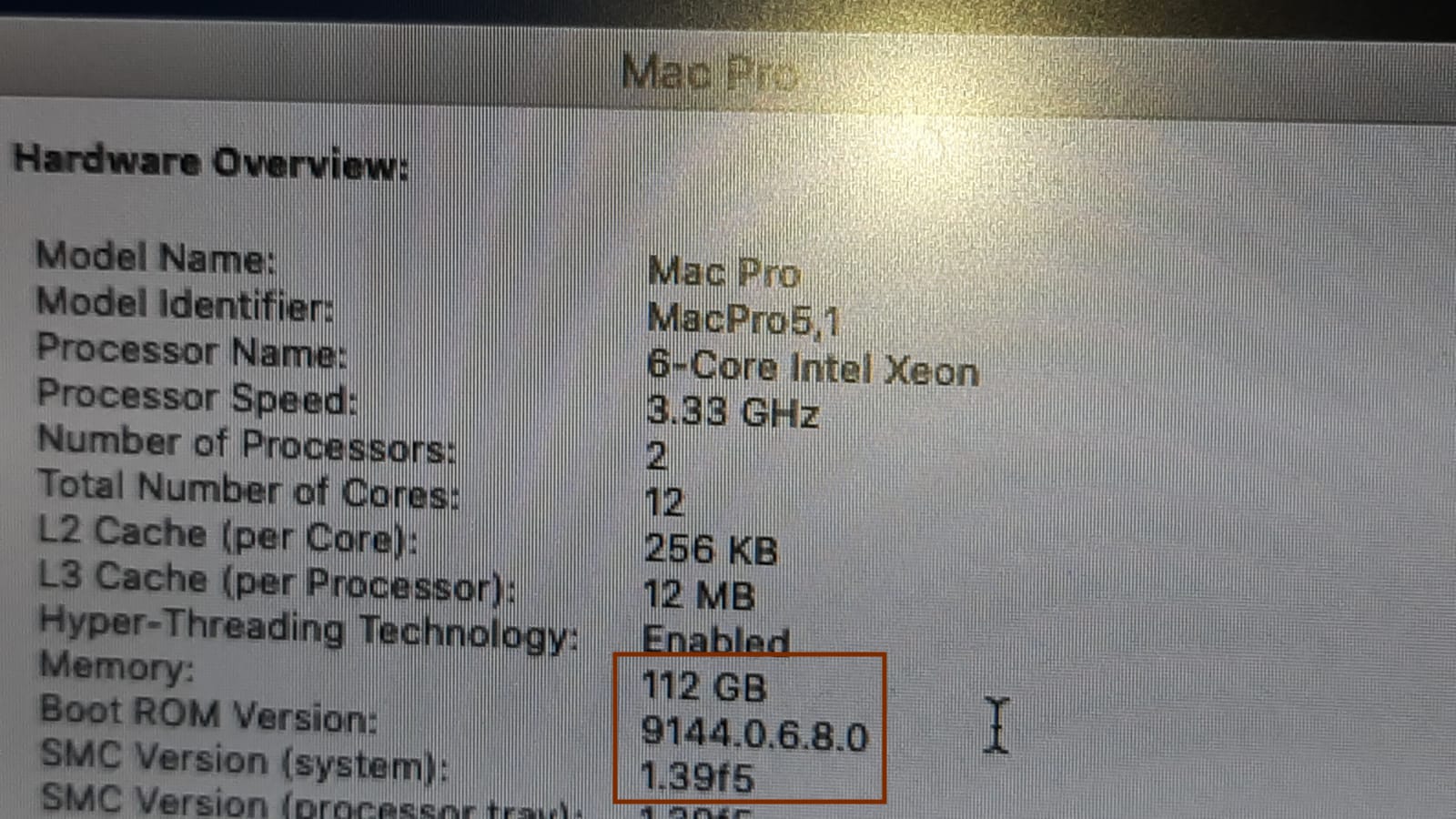

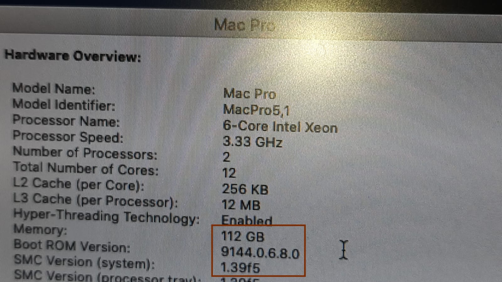

@cdf thanks for the reply ,the spoofed BIOSVersion valve we change to real boot room valve cause any issue 144.0.0.0.0 or keep as it is.
The real value can cause unwanted firmware updates, so I strongly recommend keeping the value as it is now. (Note that if you absolutely want to use the real value, you can also just leave the string empty.)

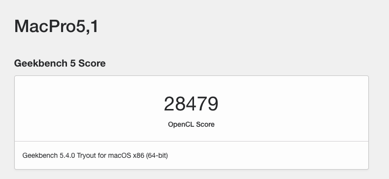

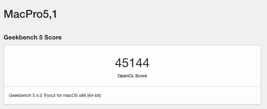

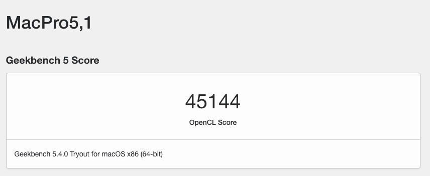

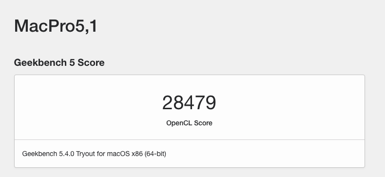

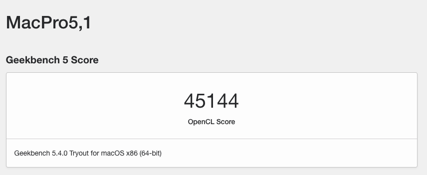

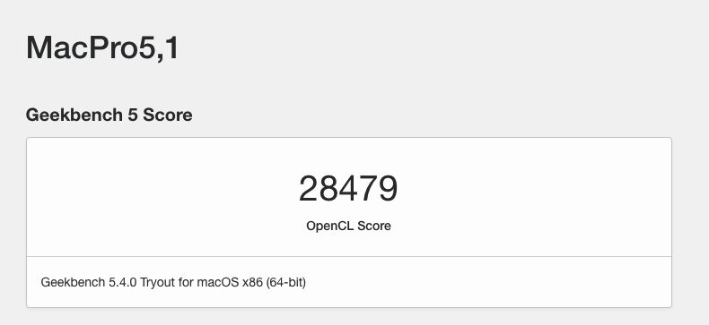

Hi - after enabling Hardware Acceleration (which VDADecoderChecker confirmed as successful) my Geekbench scores (compute) are worse (lower). Any ideas?
(Mac Pro 4,1 flashed to 5,1. Catalina via OpenCore. 48GB RAM. Radeon RX580 4GB.)

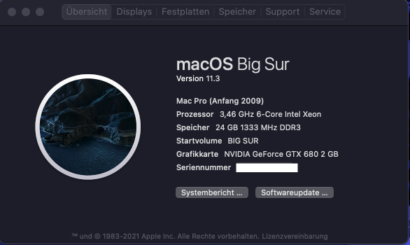

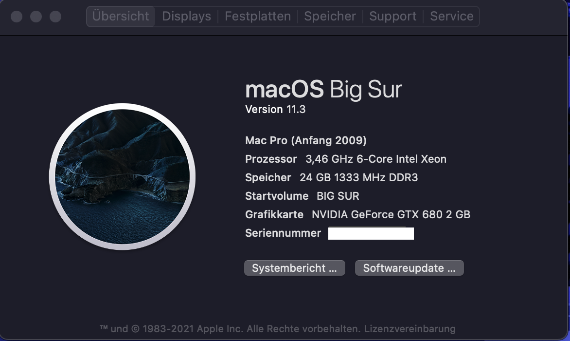

Glad you had a positive outcome like myself, many others don't. Please share your exact hardware and install steps as reply to #300 post, so people know you had the same result. cc @cdf

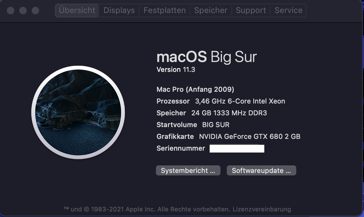

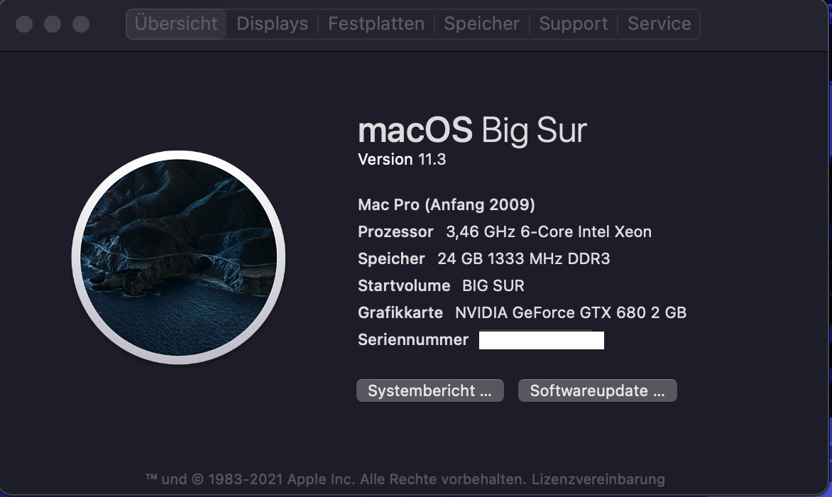

I installed Mojave on a SSD in bay 1. Then I pulled all HDD sleds except for bay 1. Then I downloaded Martin's Package and installed it by the book on the EFI partition of the Mojave drive. Boot picker worked. After that I put the sled for bay 2 with another SSD back in. Then I downloaded Big Sur 11.3 and started the installer from Mojave an installed on the bay 2 SSD.
The install hung once with a progress bar freeze. After a forced shut down it ran through.
Then I moved OC to the Big Sur drives EFI partition. Everything works. The only problems I have are the warm boot issues, the messages that I did not shut down the machine correctly and mysterious recovered files in the trash.
