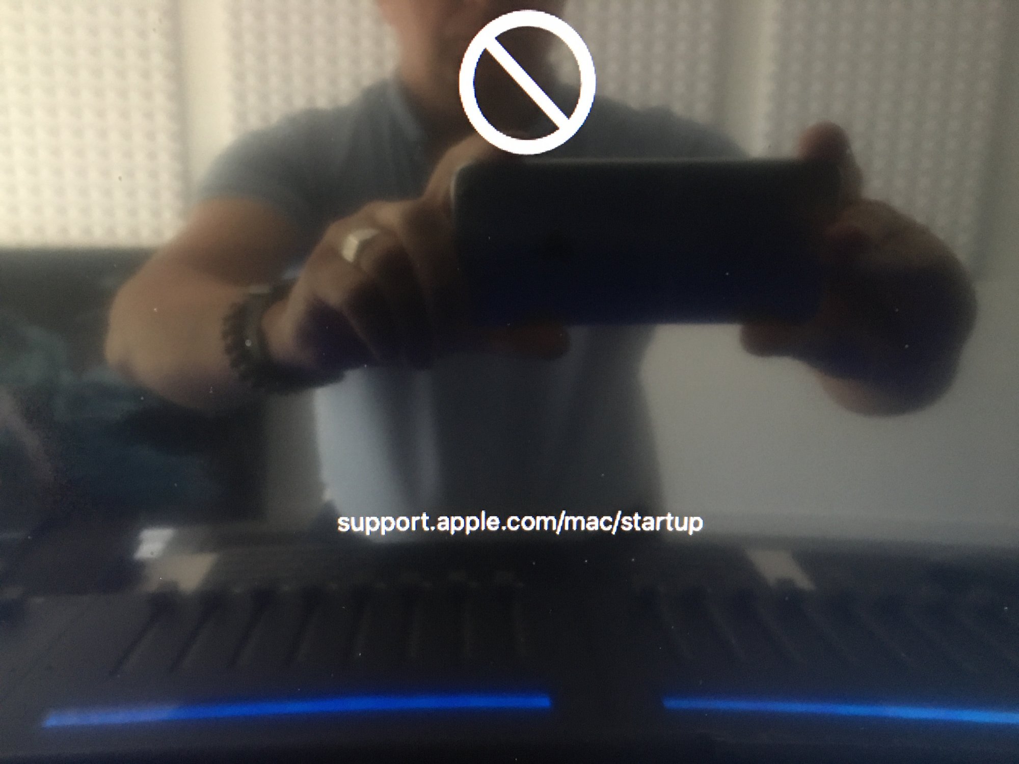

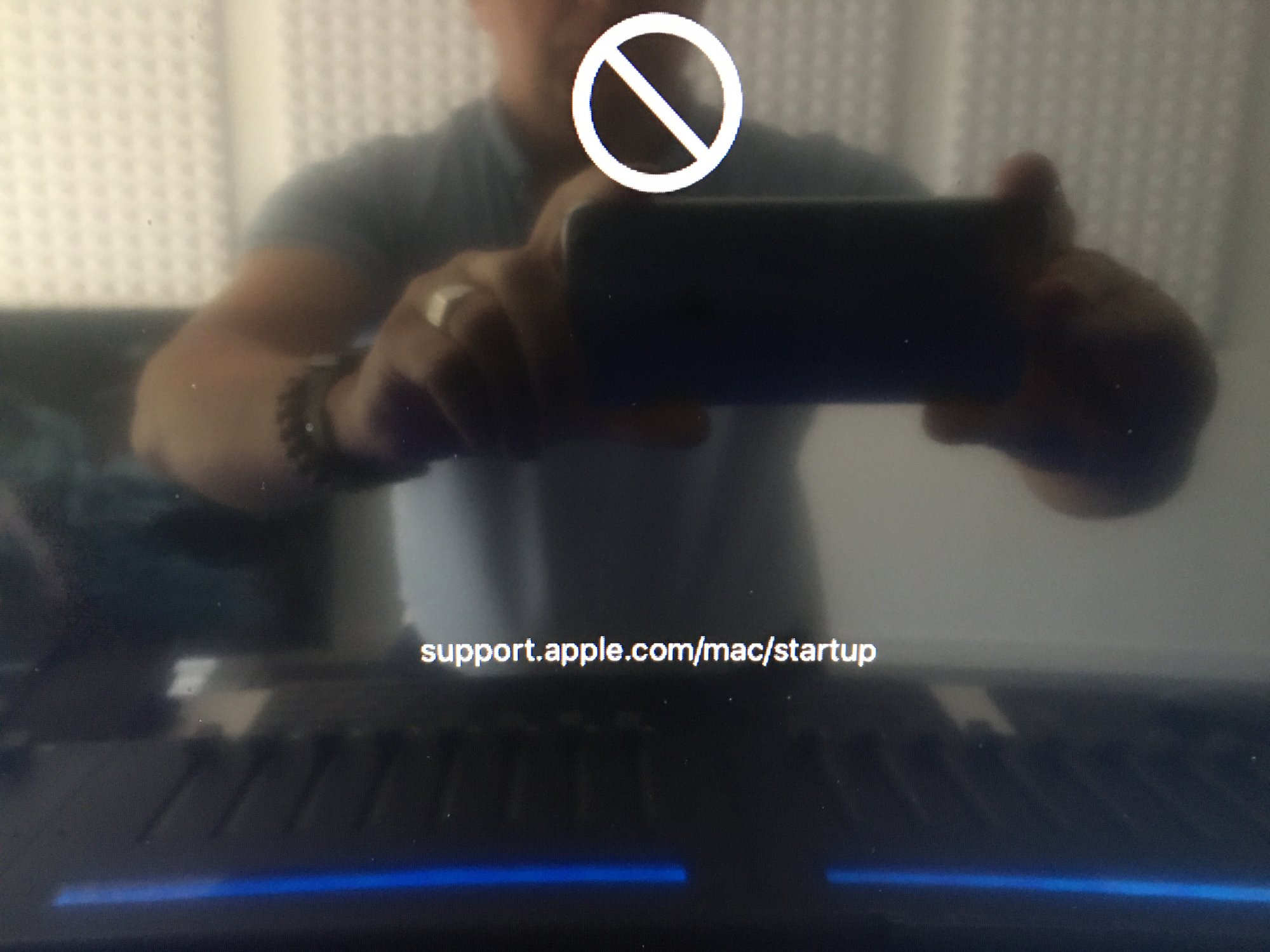

That s what i get i think that opencore is guilty
  • Haha
Reactions: JohnD
"A prohibitory symbol, which looks like a circle with a line or slash through it, means that your startup disk contains a Mac operating system, but it's not a version or build of macOS that your Mac can use. "
I don't think this is the underlying issue. Regardless where you place your bootloader, you will have issues with PCIe/NVMe disks, please correct me if I'm wrong. I'm one of very few who don't have issues, see #300.
I don't have neither PCIe nor NVMe and I got the issue.
I may or may be wrong but in my case, my keyboard has a usb hub where I connect a tablet and a camera, I kept getting 🚫 on boot until I unplugged those two usb devices

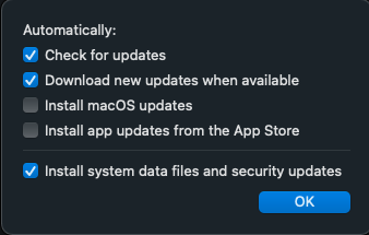

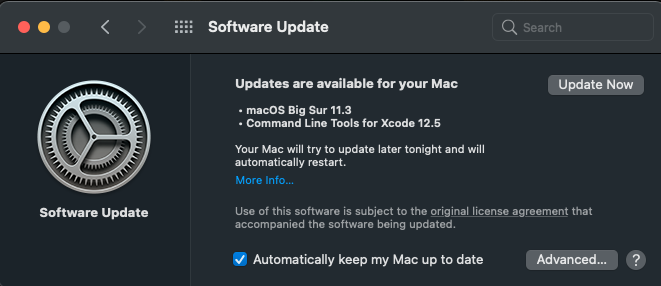

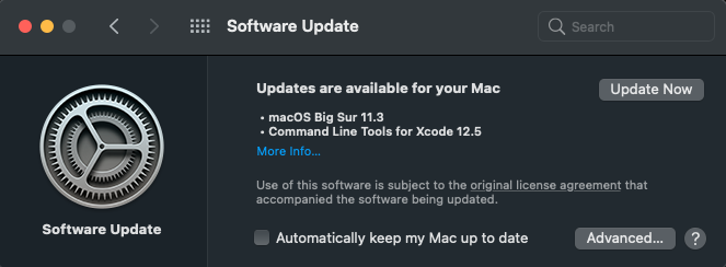

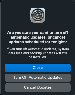

my cMP is telling me it's gonna reboot for updates later today
Unchecked the Auto update box (above screenshot)
Then clicked "Turn Off Automatic Updates", entered password prompt
When I click the Advanced it shows these options
(I unchecked the "Install system data files and security updates")
That puts me at this screen:
Notice it no longer says it will update/reboot later tonight.
I managed to successfully toast my Mac 5,1 yesterday afternoon 😱. Interestingly all attempts to reinstall over my trashed boot drive were thwarted with my 'incompatible' version of Mac OS. I did test the upgrade out on another Mojave installation and experienced the same crossed circle message though I was able to downgrade this back to Mojave so the 'incompatibility' issue may be related to my multiple attempts at recovering the system. Mojave kindly enabled SIP adding to the recovery process with a GPU swap for the necessary Mac EFI support.
The good news is I have my home directory located on a separate drive to avoid such eventualities and Time Machine enabled which I used to recover my apps and config using the migration assistant tool after booting a fresh copy of 11.2.3 I was able to thankfully locate and download.
Needless to say automatic updates have now been disabled.

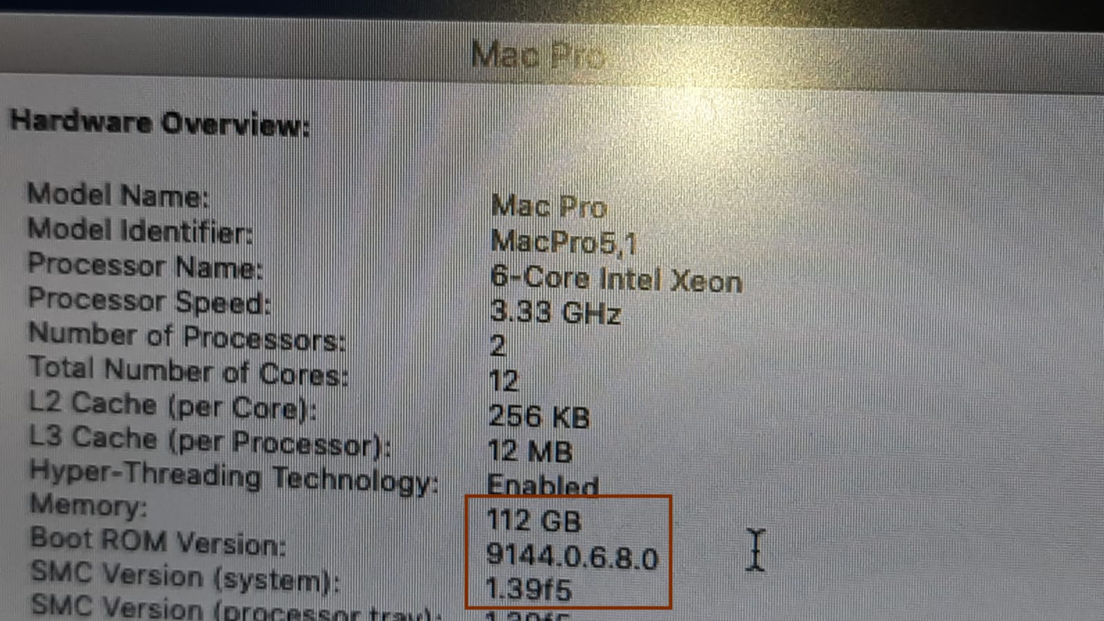

MacPro boot rom was automatically change to open core version 9144.0.6.8.0 ,is this will create any issue for the feature use, reset Nvram also shows same result.
This is the intended version number set by Martin's package. Part 2 of the guide explains how to set this value. You want a high version number to prevent unwanted firmware updates.
Note that resetting the NVRAM without properly reblessing OpenCore is problematic. There are several comments about this in the last few pages of this thread.
