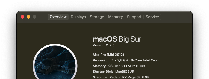

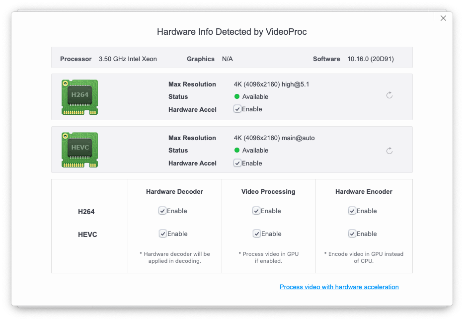

anyone have Config full for RADEON RX VEGA 64?
graphic not detect
MPc 2012
try play DOTA 2 but shutdown -_-
already bro , but not change
iNitialE - You're posting this here too? You failed to mention that you're powering your Vega 64 from a SATA port from a drive sled. We gave you the answer in the OpenCore group - perform the pixlas mod before you burn up your backplane. There is no "config" - there is nothing else to do, "bro".
PS - Based on your screenshot, you're running an old version of OpenCore.
iNitialE - You're posting this here too? You failed to mention that you're powering your Vega 64 from a SATA port from a drive sled. We gave you the answer in the OpenCore group - perform the pixlas mod before your burn up your backplane. There is no "config" - there is nothing else to do, "bro".
A VEGA 64 fully powered by the backplane, seriously? I smell crispy power controller chips.

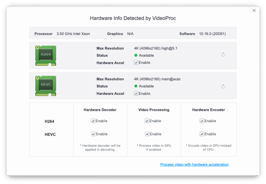

i use on macos big sur 11.2.3 for render normal bro, but i try playing game, macpro die and must unplug power cable, but on macos 11.1 and 10.14 100% Normal No problem , on videoproc not detect of VGA, how to detect VGA??
