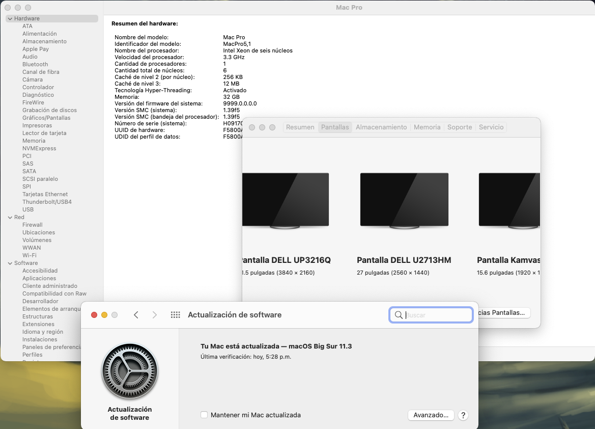

I got the mentioned issue, I had to reboot at least 2 times before the update resumed, didn't do any power cycle, first time I got the "🚫", second restart the update resumed (showed the big sur boot screen, it actually looks different if you're still on the gray boot bg), it restarted as part of the update, got stuck again, then it finally booted Big Sur. My issue was actually being caused by a 3rd 4k monitor I had plugged, after unplugging it completely the update finished
