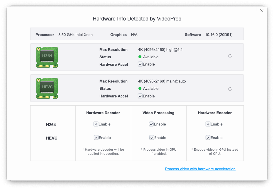

anyone have Config full for RADEON RX VEGA 64?
graphic not detect
MPc 2012
try play DOTA 2 but shutdown -_-
