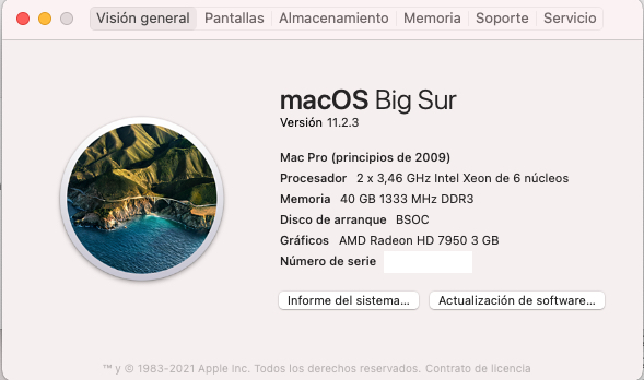

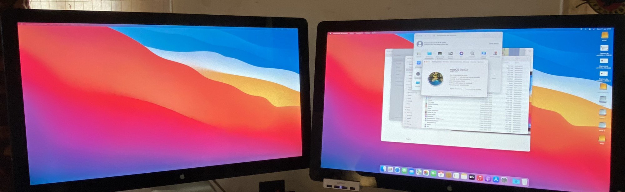

Thank you for your post. What software did you use to get Big Sur running on your MP? I used OCLP 0.6.8 and Big Sur 11.2.3. Did you have to do anything special to et the second monitor worksing?
I have 3 Apple displays working. Hardware config is in signature. I followed post #1 a while back (OC 0.6.2) and installed Catalina. Recently did an upgrade to Big Sur just using the System software update (VMM on) (post #7,808). Didn't do anything special to get displays to work.
