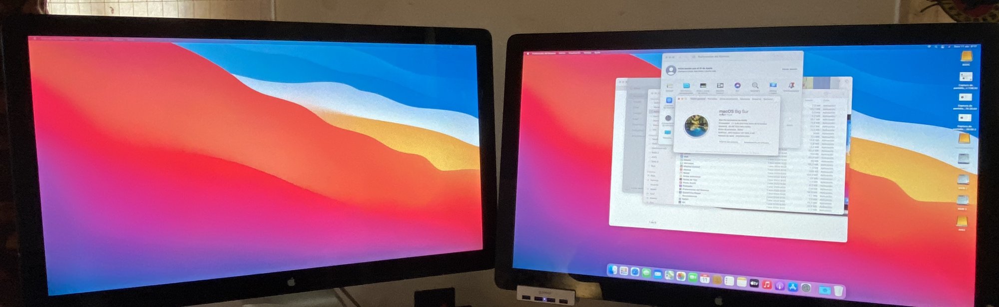

Help! I have a Mac Pro 5,1, 64 GB RAM, AMD Radeon 7950, OC 0.6.8, Bug Sur 11.2.3 installed along with two Apple 27" LED cinema Displays. After upgrading to Big Sur Only one of my monitors works. Has anyone else run into this? I have been searching for a few days for a solution but haven't found any clues yet.

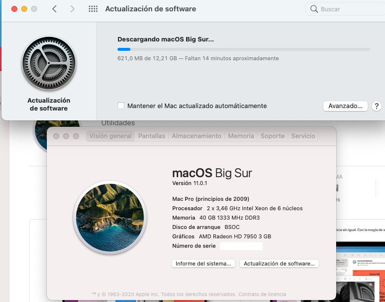

Same config here. Mac pro 5,1, two 27 Led Cinema Display, Radeon 7950. Running catalina but last time i tried BS all was smotth and fine. If you want, I can try running updated BS.
Has one of you tried OCLP instead of this particular version of OpenCore described and maintained here? If the problem exists there too you may open a GitHub issue - I am quite sure the developers might have an idea. But you have to test it on your system first.
Nop, I use another configuration, initially for Catalina but runs fine with BS. This one. Never had an isuue with it. Runs perfect.

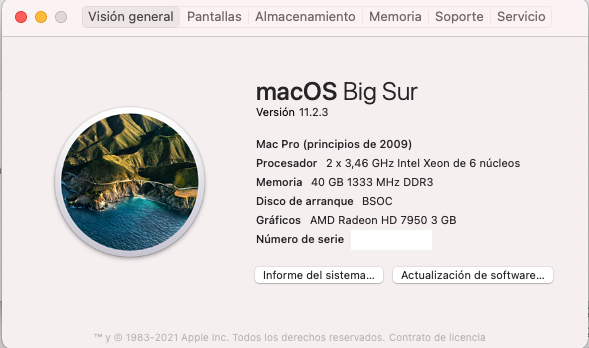

As I told you, running 11.0.1 smooth. Now downloading 11.2.3. I will tell later how it goes.
I confirm. 11.2.3 running in both Apple Led Cinema Display nicely.
