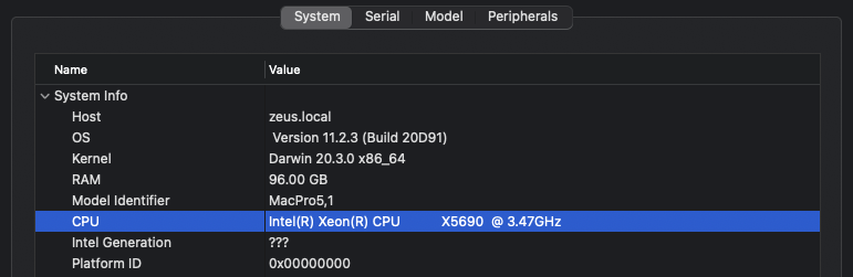

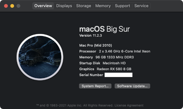

@startergo Proc shows the correct value now in 0.6.8:
In Hackintool is still wrong:
The frequency reported by Hackintool may not actually be calculated. Check with dmidecode. In my case, there is a similar line:
Version: Intel(R) Xeon(R) CPU X5680 @ 3.33GHz
This line is always the same with and without OpenCore. I suspect that in your case the frequency would be 3.47GHz... So it may not actually be "wrong."
