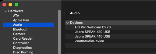

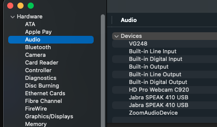

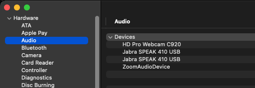

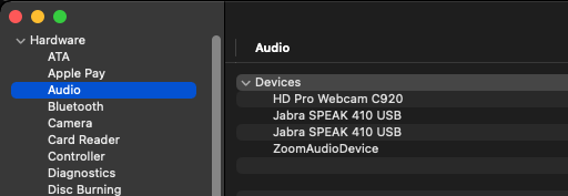

Just flashed my new BootRom from Alex.
Noticed my audio is not longer working. When I checked my settings, it no longer shows the optical output as a choice.
Booted back to vanilla install (Mojave) and it is present there.
Wondering what setting in OC would cause this?
reinstalled BS, still no digital/optical audio option. (Also does not show my GPU audio channels, used to see x3 of them - 1per DisplayPort)
I'll reinsert my OC config and try that..... this is very strange!
UPDATE: This must be a fluke.
I wiped my OC config, started back with the default config.plist (Martin's). Rebooted and my audio is now showing again. Then applied my customizations (nightshift, disabled DirectGopRendering, add DeviceProperies for GPU).
Audio is back now

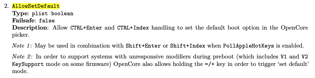

Look at OC documentation for MISC/Security/AllowSetDefault. You cannot change the disks order but you can set the default. And you should set the default boot partition inside MacOS.
Took a quick look at these 3 areas... didn't see anything obvious to select, but will look more into the documentation.
Your setup is almost identical to mine. Set the Big Sur drive as the startup disk in the system preferences and it should stick to that (it does on mine). I then use the arrow keys in the OC startup to change to Windows.
Since this was fairly easy to do, went ahead and unlocked the panel, selected my drive and re-locked the panel
If AllowSetDefault is set to True in your config.plist, you can highlight a disk, then use CMD+Enter to have bootpicker remember what disk you're chosen previously.
