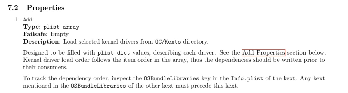

Please see the OpenCore documentation: "Kernel driver load order follows the item order in the array, thus the dependencies should be written prior to their consumers."
I thought that lilu and whatevergreen are supposed to be before any other kext entry in config or am I wrong?
They do not have to be before any other kext but Lilu has to be before any kext that depends on it.
alphabetical order is the right/expected config format way.
Not quite.
Your output will work fine indeed since by a lucky fluke, it does not include any kext depending on Lilu that has a name starting with a letter that would put it above Lilu alphabetically.
I actually pushed for the alphabetical order in OC here: https://github.com/acidanthera/Open...2d6fd2bdf5120e69729ece#commitcomment-44895360
It does not apply to kexts however which have to go in based on dependencies. If AAA.kext depends on CCC.kext, the required order is CCC.kext before AAA.kext.
See excerpt from the manual:

I see, thanks for linking that documentation. It is the only exception to alphabetical order. In my case, WG and NS are Lilu plugins and because I list them after Lilu, everything works properly. Luckily, the plistlib generator respects the kexts order so it will not be an issue. But I'm going to add this into documentation, much appreciated.

Pushed a change to the docs to make this clearer as the previous state (current as at v0.6.7) was actually wrong.

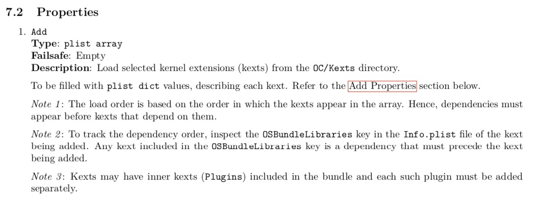

I'd just like to say that you've done an outstanding job of clarifying the documentation 👏

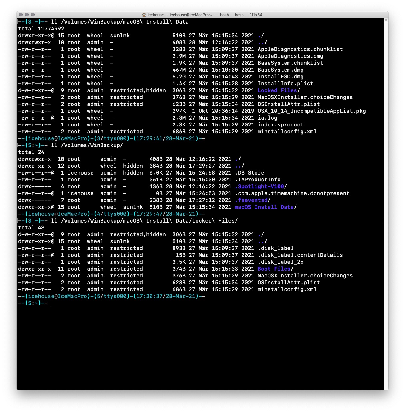

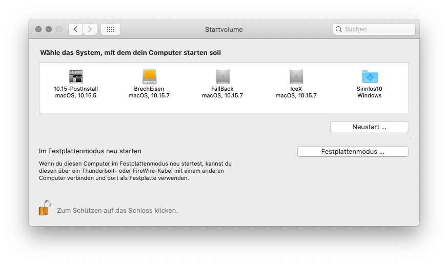

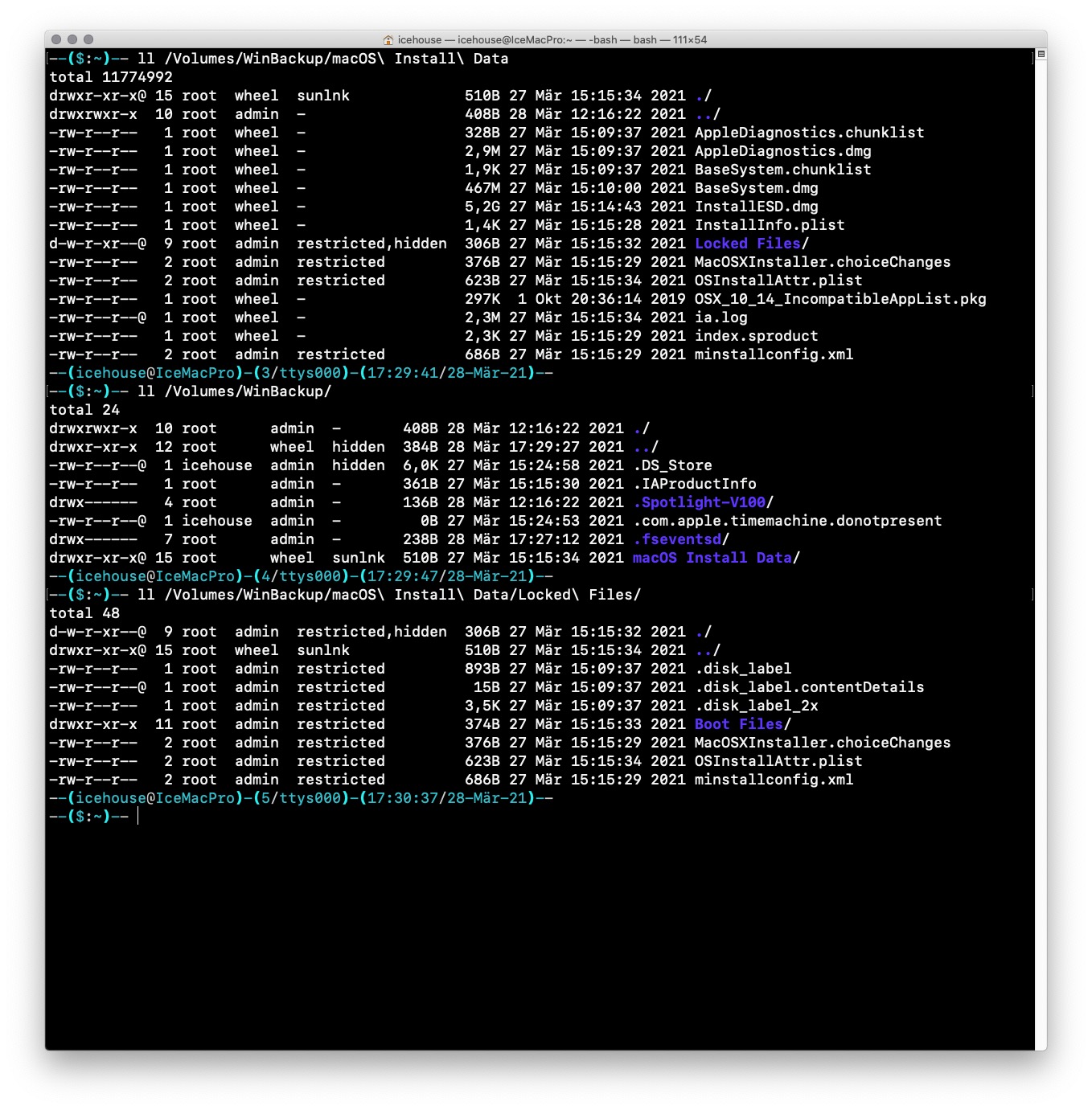

As you can see - I prepared allready the external SSD but macos 10.15.7 (19H524) did NOT show up the bootable volume wich I allready had bootet 3 times with OC 0.6.7 but with the error log instead of showing up the macos Installer Startscreen - and I have no idea why. 😳
Remove all OS disks. Only the disk you wish to install Mojave on in the Mac. Boot with Option-Command-R at startup to upgrade via internet to the latest macOS that is compatible with your Mac. For you, that is Mojave. When booting with Option-Command-R be very patient. You will have a completely black screen for a long time. No progress indicator for 10-25 minutes or more.
Classic Mac Pro does not have Internet Recovery.

Hopefully this new change to the docs that spells out that the order can be important for kexts leaves no one in doubt:
