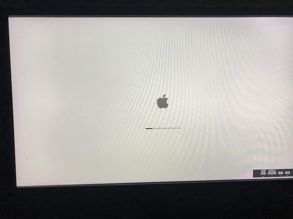

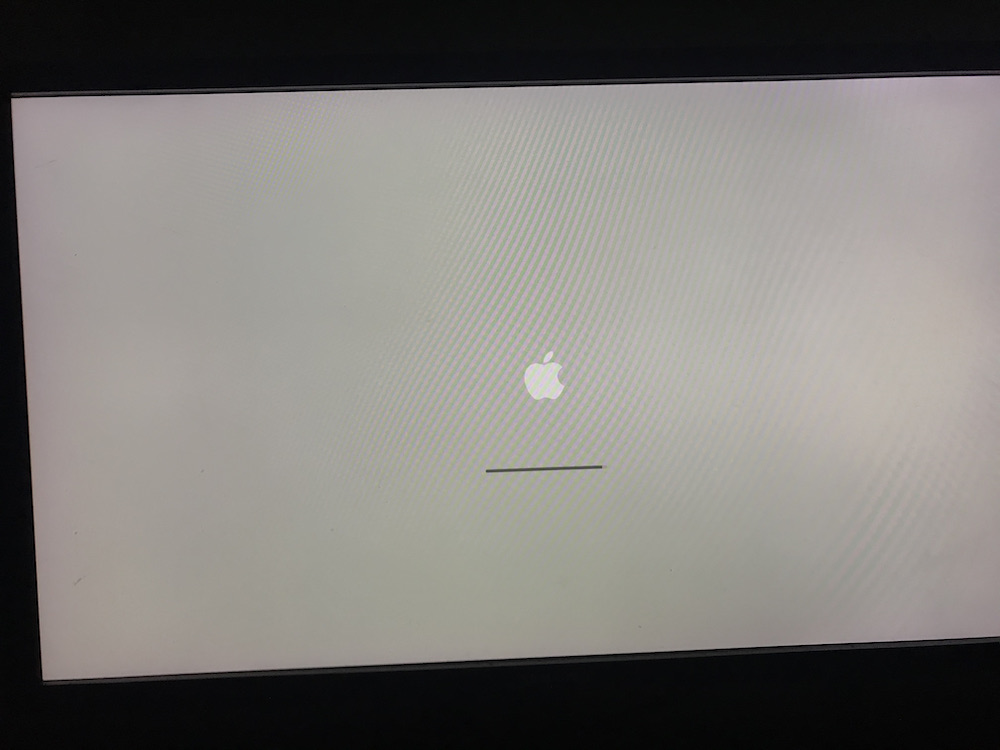

Hi all

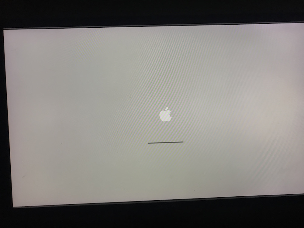

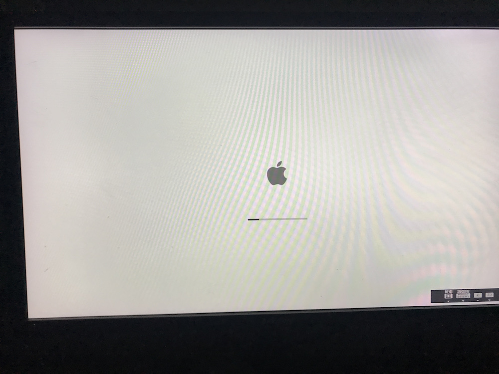

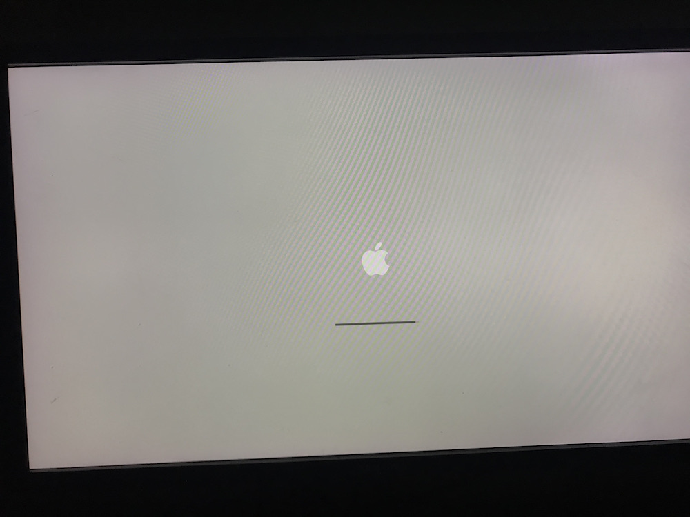

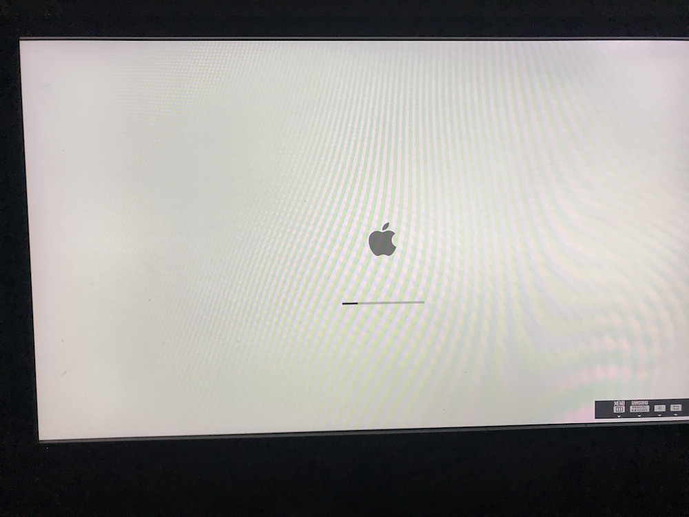

When my 5,1 boots I get two different backgrounds during the process; the first is the one set in OC and the second the one I believe it to be the default for big sur. Between those two there are a few seconds of black screen. Thus my questions are:
Can I set the default background value in OC to match the second one and is the black screen during the switch from one to the other normal?
Thanks!

Hi all
Thanks!
On modern Macs, the background is "syrah black." For legacy Macs, it was "light gray." Both colors can be set in OC. However, because no Macs with the gray background are supported in Big Sur, the gray option may lead to unexpected results during the second-stage screen, like the apple turning white. Thus it is recommended to use black. It will also make the normal blackout period between the first and second screens less noticeable.
Reactions: eVasilis
Thanks!

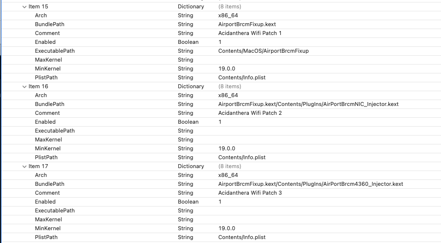

Just installed 0.6.8 on my work machine but had to revert back to 0.6.7 due to WIFI no longer functioning. What's odd is that BT and WiFi hardware is detected but WIFI remains in a constant "off" state. Otherwise, 0.6.8 seems to boot 11.2.3 just fine from a PCIe drive. It however, seems to be significantly slower in booting (debug off) than 0.6.7.
Attaching a copy of my config.plist in case something stands out as being wrong, thus preventing WiFi from working. Has anyone else experienced WIFI issues on an cMP5,1 and 0.6.8?
Thanks @Dayo, the above tip worked. WiFi is fully functional again. Is there a way ConfigFactory can query if a native-Apple card exists, and if so, automatically disable those patches?

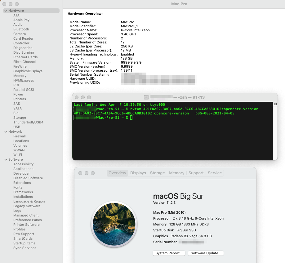

Anyway, 068 seems to be running fine on 11.2.3. Processor speed also seems to be correctly reported now. Curious, but I don't recall seeing SMC version getting "spoofed" with 067 but under 068, it's now reported as 9.9999. Will report back if I notice anything else unusual.

I see, now it makes sense. Do you have stock 5,1 Bluetooth card or a newer upgraded model? Myself I have a card pulled from an iMac.
Is there a way ConfigFactory can automatically disable those patches?
Was something that was not ready for release and should have been disabled/deleted (as done now)
There was a recent scare that not only was firmware being inadvertently upgraded, but that the same was happening to the SMC. Turned out to be unfounded but the risk is there. ConfigFactory now sets things up to prevent such from happening if an attempt is made ... similar to the firmware version change.
Good to know! Thanks!
