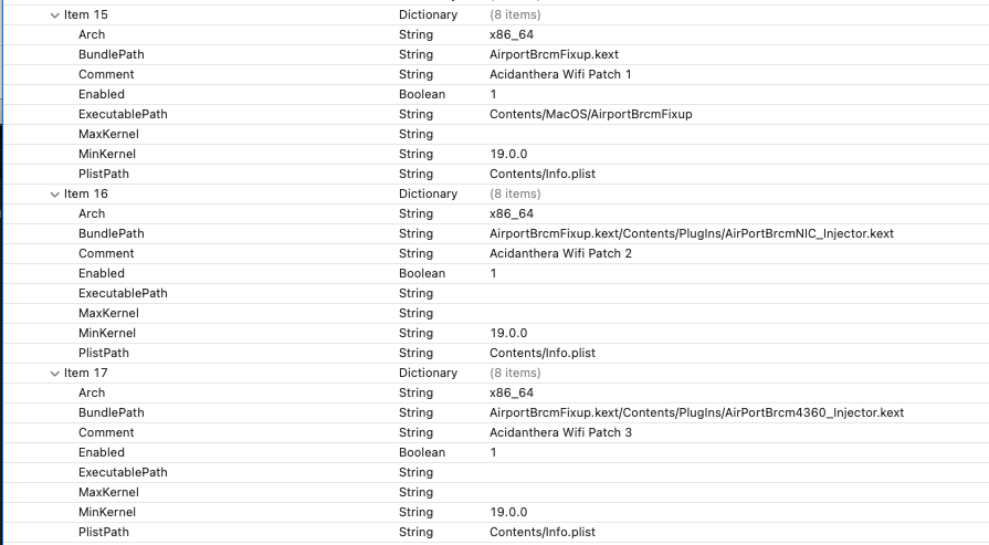

Installed all works fine except wifi. Have the following code in the OC config.plist. The wifi icon shows up on the top bar. But it seems that it would try to scan the wifi networks only for a while. But got nothing and eventually grep out every time it performs a scan to wifi network. I've already followed the post-installation guide here and changed to 19.0.0. The wifi Preference also showing wifi is On. But it just wouldn't show the scanning or scanned network to join:
According to Mac Pro 5,1 in the URL table. The wifi chip should be BCM4322 series.
Still no luck. The Wifi would scan for a while but always grep out finally. It wouldn't return any wifi ESSID in the air. Any helps would be appreciated.
