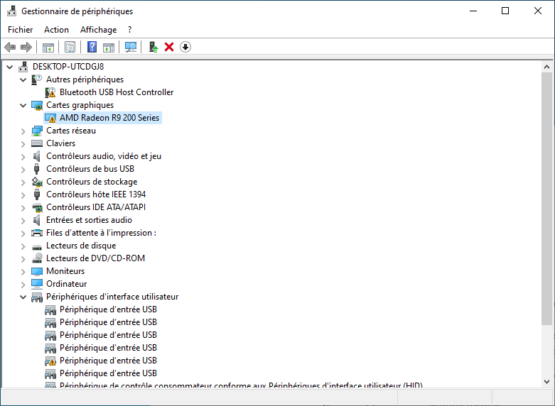

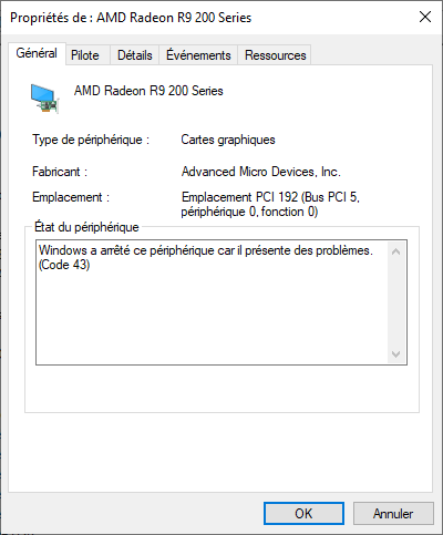

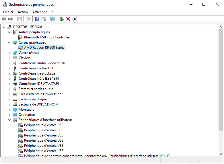

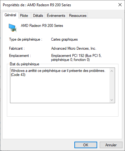

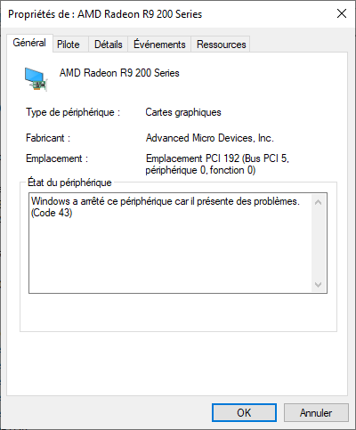

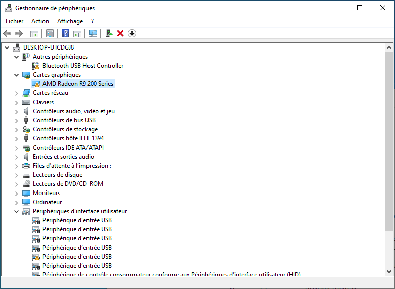

Hi everyone,
I'm using a Mac Pro 5,1 single CPU quad-core xeon W3530 with a Sapphire R9 270X 2048 MB (Dual-X OC w/ Boost) video card:
https://www.techpowerup.com/vgabios/148208/sapphire-r9270x-2048-131105
flashed with a PC UEFI bios from techpowerup unverified upload database (vbios version : 015.044.000.003.000000):
https://www.techpowerup.com/vgabios/169815/169815
This card originally came with no UEFI support.
This is my problem: i just installed in UEFI mode windows 10 on my sata drive in bay 2 following post # 1 cdf method. All went correctly, and i can boot directly into windows through opencore 0.6.8 except for the fact that the system is not be able to load the graphic drivers.
I already noticed after my first post installation windows boot, that the display and graphics capabilities of my card was provided by the "Microsoft Basic Display Adapter" as shown by Device Manager. So naturally, i went to install the manufacturer drivers downloaded from AMD website, namely the radeon adrenalin 21.4.1. Upon reboot, the device manager show now as expected "AMD Radeon R9 200 series" but unfortunately with the yellow exclamation mark signaling error code 34 (attached photos below). It's clear, for whatever reason the graphic driver refuse to load and i don't know until now why.
Is this related to OpenCore itself which support only certain graphic cards ? or am i missing some mod or small tweak in my config.plist file that i join below ? I'm here talking about OpenCore because weirdly if i repeat the same windows 10 installation in Legacy mode instead of UEFI all goes well without any issue and the AMD drivers load correctly. Furthermore, i also didn't see any problem with my card when using OS X after booting with OC.
If someone can help me to understand why? Thanks in advance.
  • config.plist.zip
    config.plist.zip
When the signature is broken Windows will not load the correct drivers
But with this same modified BIOS, with a legacy windows 10 install (so without OC) the graphic drivers correctly load. I noticed the trouble occur only with UEFI install (with OC). Don't have a vbios switch on the card.
That is correct. Legacy Windows does not care about signatures.
