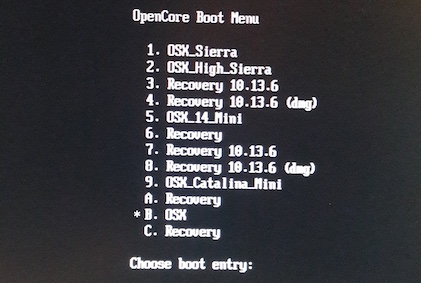

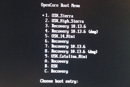

What makes me wonder a little is the sequence of the bootpartitions in OpenCore Bootmenu.
This view from booted in "B. OSX" (my main Mojave system)
1. OSX_Sierra => disk7s3 (SSD on Dual SSD PCIe Card)
2. OSX_High_Sierra => disk7s4 (SSD on Dual SSD PCIe Card)
3. Recovery 10.13.6 => disk7s5 (SSD on Dual SSD PCIe Card)
4. Recovery 10.13.6 (dmg)=> probably BaseSystem.dmg in disk7s5
5. OSX_14_Mini => disk8s1 (disk8 is APFS Container in Disk7s7, SSD on Dual SSD PCIe Card)
6. Recovery => disk8s3 (see above)
7. Recovery 10.13.6 => disk1s3 (additional Rescue Recovery on Data-disk without MacOs in SATA Bay 3)
8. Recovery 10.13.6 (dmg)=> probably BaseSystem.dmg in disk1s3
9. OSX_Catalina_Mini => disk5s1 (disk5 is APFS Container in Disk4s2, SATA Bay 1)
A. Recovery => disk5s3 (see Catalina 9. above)
B. OSX => disk6s1 (disk6 is APFS Container in Disk0s2, SATA Bay 4)
C. Recovery => disk6s3 (see Mojave in B. above)
Only cosmetics, but how to get i.e. "OSX" (now B.) to Pos 1.?

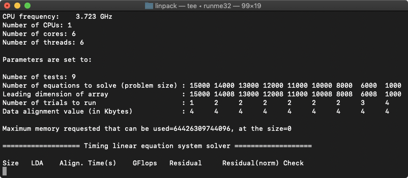

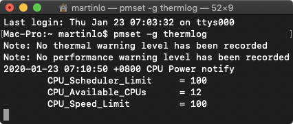

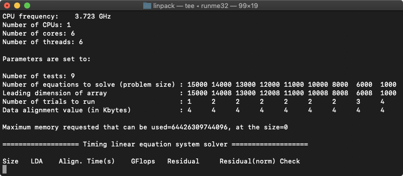

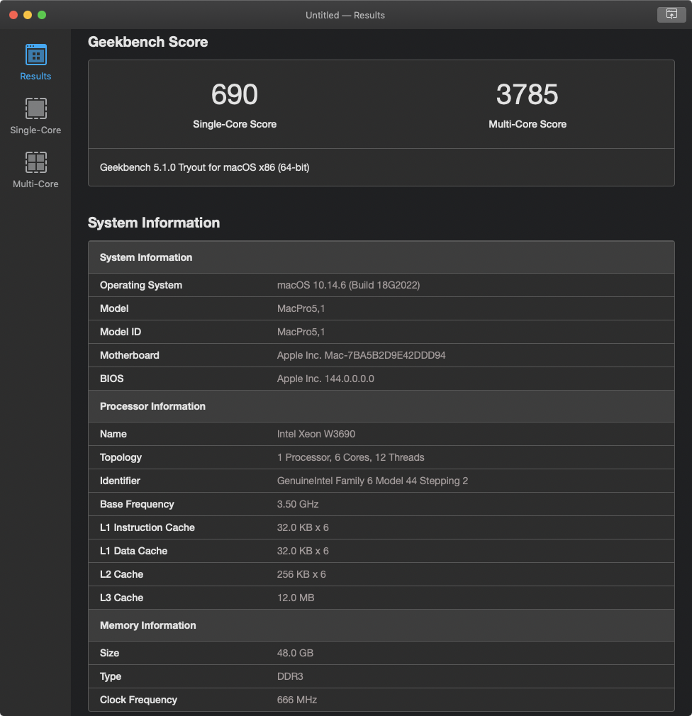

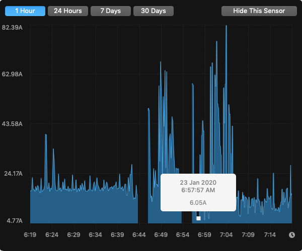

The latest OpenCore 0.5.5 fixed something. Despite the system info still shows 3.5GHz for my W3690, but the CPU power management / actual clock speed is correct.

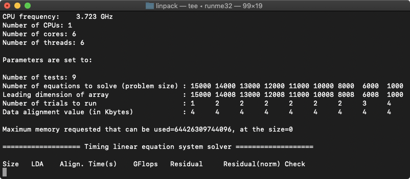

1) Linpack shows that the CPU can boost to 3.73GHz

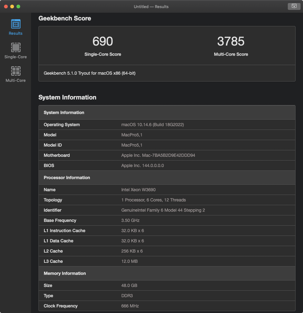

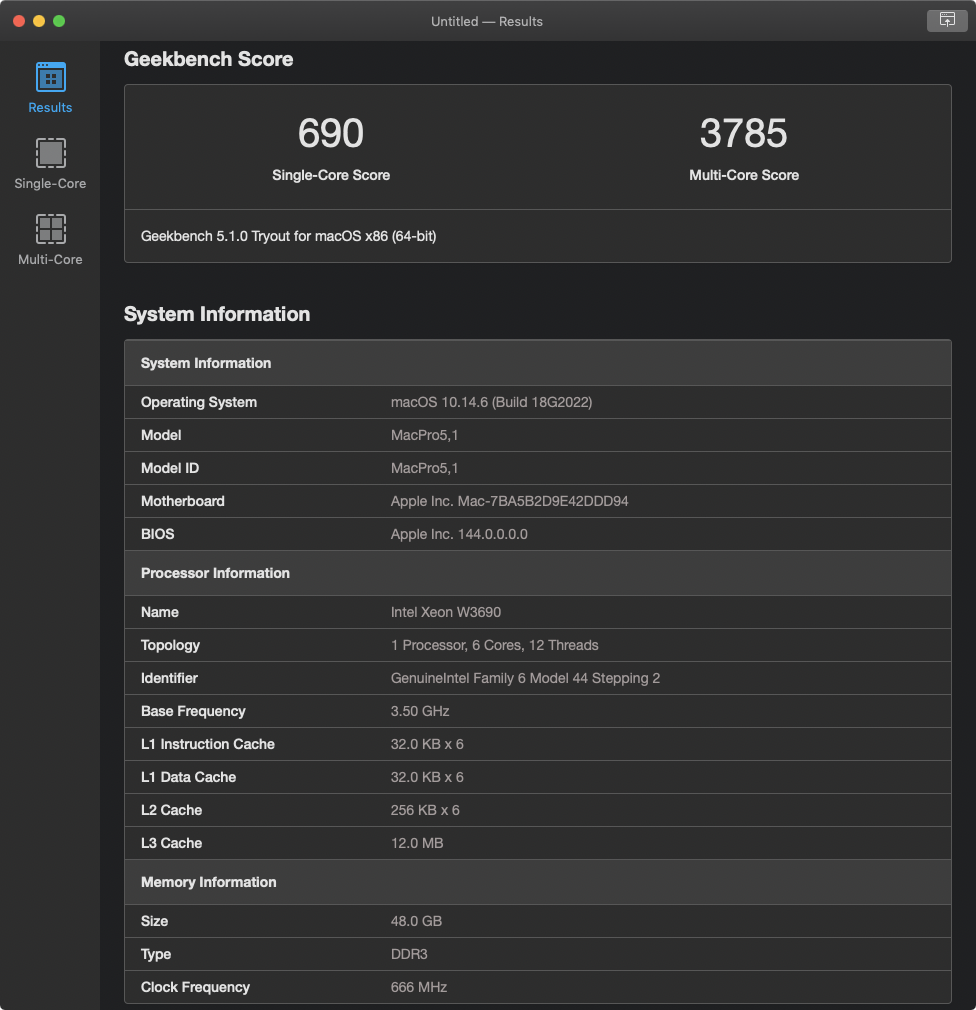

2) GeekBench score also suggest that TurboBoost back to normal

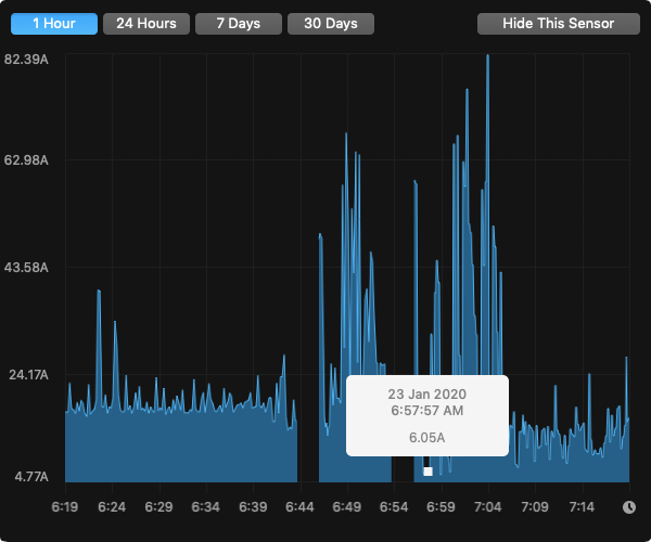

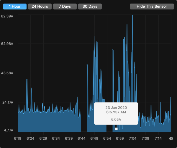

3) iStat shows that the CPU now can idle at real low power mode

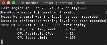

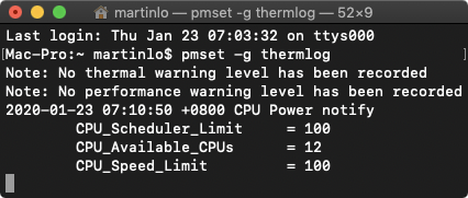

4) "pmset -g thermlog" also work properly in terminal

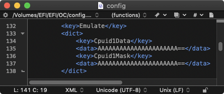

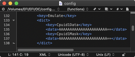

And the key parameter is... again... the VMM flag. The CPU's power management only works properly when the VMM flag is OFF. I only do this test in Mojave (18G2022), not in Catalina yet [Update 1: Catalina also tested, same as Mojave]
But anyway, apart from that 3.5GHz cosmetic error. Everything now is truly working properly in Mojave.
A) Full HWAccel
B) DRM Streaming
C) CPU run at full speed

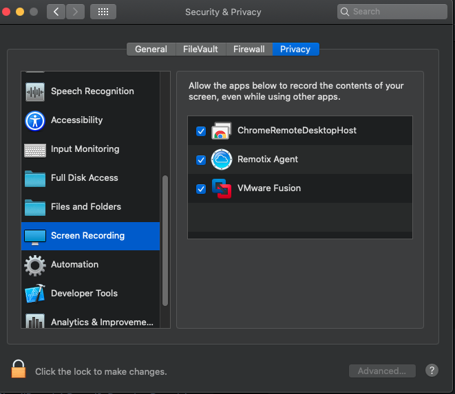

Unbelievable, so I finally found the culprit for the black screen after banging my head against the wall for the past few days. It was Chrome Remote Desktop host that was running in the background. My hunch is that the process running in the background makes MacOS think that a potential recording could be happening, thus turning DRM content black. The instant I uninstalled the program, everything went back to normal.
Yes I was thinking along the same route, but I looked in
Here and screen recording was allowed so I did not suspect it to be the case. But here it is...

Your multicore score seems low. I have the same processors and am getting 667 / 6865 on Catalina with VMM flag off.
For dual CPU's I can only test PMset.
Intel gadget does not work with dual CPU's and Istat shows 0% in the processor log. GB5 score is low: 5234 for multicore CPU, 666 for single core.
[automerge]1579838617[/automerge]
Plus I already found some bugs in the latest commit of OC.

Windows is fine.
I simply keep
RequestBootVarRouting = False
Therefore, I can still use the system preference -> start up disk to select next boot to Windows.
But when I boot back MacOS by using Bootcamp panel (in Windows), OC will be disabled. So that I need to re-bless it. But I am happy with this extra step, I only use Windows occasionally.
Windows is fine.
I simply keep
Therefore, I can still use the system preference -> start up disk to selectnext boot to Windows.
Funny, I'm doing it the other way around. I'm using OC with RequestBootVarRouting = True to boot Windows 10 EFI from a dedicated NVMe by manually blessing the Windows drive. It will not boot any other way.
Booting from Windows into Windows or macOS works perfectly fine via Bootcamp panel (in Windows).
This looks like a bug as from the description it is supposed to work. If your Windows installation was done in UEFI mode and it shows up in OpenCore, go to macOS and select it in the Startup Disk preference panel. Reboot and collect OpenCore debug log, then file a bugreport in our bugtracker. MBR Windows installations are not supported though.
I don't think you can select UEFI boot Windows from the system startup disk (you can but it never worked on reboot). It will give you something like "cannot find the system disk". Only through blessing manually or through the boot picker it was possible. I believe I tested the OC boot picker too it works fine.
Reactions: h9826790
This works just fine on hackintosh, and we particularly designed it the same way it works on Macs for full compatibility. The fact it does not work for you must be some peculiarity of a certain setup.
