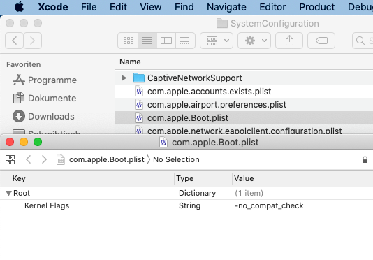

To prevent the "-no_compat_check" disappearing for whatever reasons, i yet activated a plist in launchdaemons that sets this boot-arg when the mac shuts down, so as to ensure a native boot into catalina is always possible.
you could just add the flag to your com.apple.Boot.plist instead and it would always be there for this install.

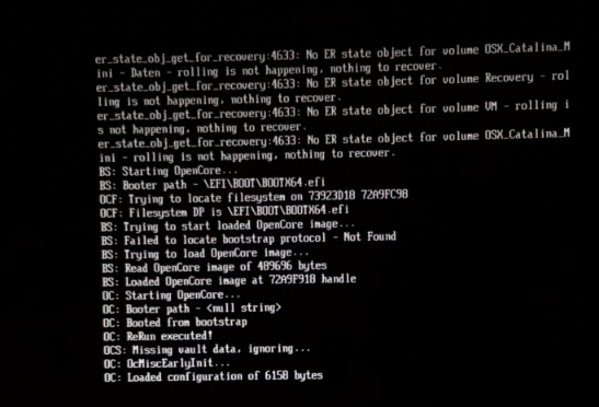

You need to include your boolog, otherwise no one knows what happens.
Ok, i first have to learn how to write a bootlog... No worry, i will find out!
[automerge]1580081727[/automerge]
My daemon is running successfully. But yes, i will have a look to this plist. It might be a better idea to set it there. Thanks for this hint!
Ok, i hope i did it right, DisableWatchDog to true and Target to "81".
Result is only one Entry in the logfile:
00:000 00:000 OCB: Failed to fix the default boot Device Path
  • opencore-2020-01-27-114400.txt

Made some thoughts about putting the "-no_compat_check" into com.apple.Boot.plist rather than to run an automated script at shutdown which is setting this boot-arg immediately prior the shutdown.
What i wanted to ensure is, that for whatever reason this boot-arg is deleted in nvram due to a process in the running system, maybe an update-process or similar, it would be surely set again prior to a reboot.
I'm afraid that, when a boot into catalina is started and in nvram this argument first is missing, the boot process will be denied even before the com.apple.Boot.plist is checked and the argument again is set. Am i wrong?
By the way dosdude's patch modifies the boot.plist with -no_compat_check

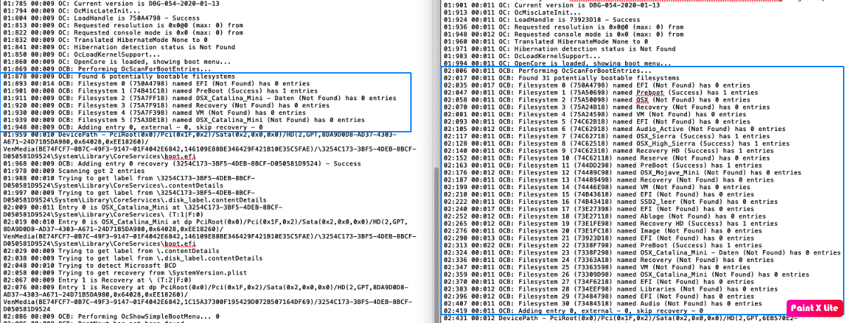

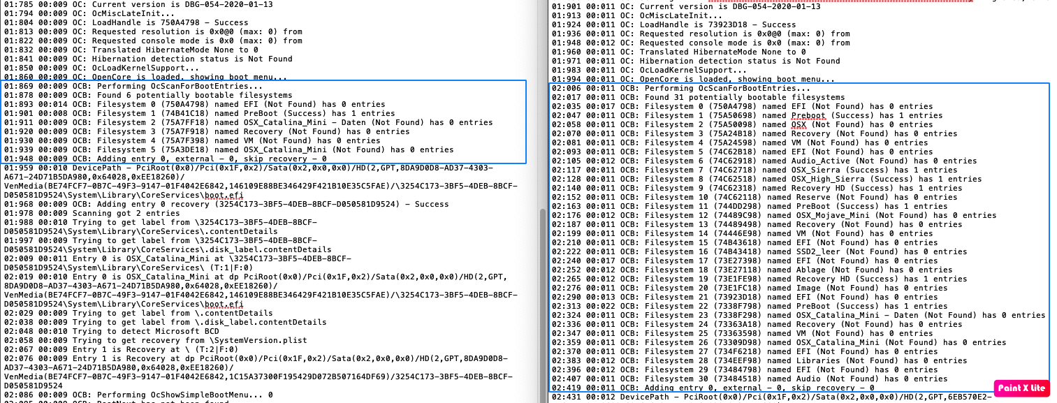

What i noticed is, that the disk numbering changes without any further swapping. As i put my EFI-OC disk with the catalina from bay4 to bay1 it changes from disk1 to disk0. The EFI with OC then was disk0s1. The boot menu then suddenly was complete.
Today, the disk is still in bay1, but it is now disk3. The OC EFI now disk3s1. The boot menu now is incomplete again in the same way as before the diskswapping. Don't know what did cause this renumbering without altering the diskpositions and don't know, too, if this could affect the issue with the boot menu. What makes OC recognize my bootable volumes and what is inhibiting this? Does the physical order of the disks play a role when booting with OC?

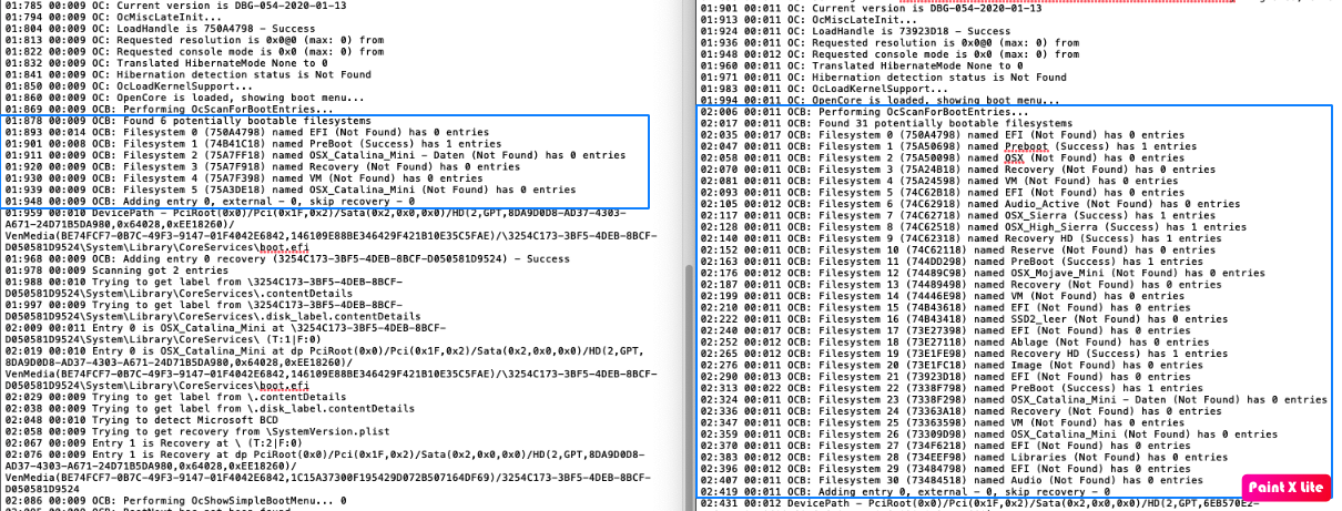

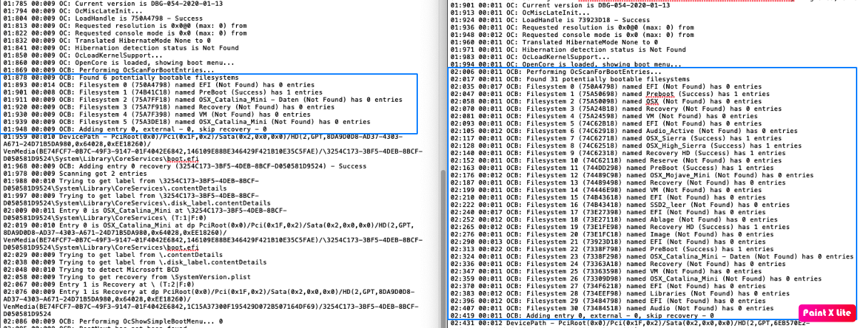

Sorry, but it's me again. Still the "boot menu" theme.
Please is there anybody who has experienced something similar with the OC boot menu and knows some advice? I searched this whole "OC on MacPro"-Thread and didn't found something similar.
I have now done some more tests and have created logfiles to that.
First, with the initial situation where the boot menu is not complete, so OC does not completely cover my bootable systems.
Second, after I was able to create a situation where the boot menu shows all my bootable systems by swapping drives again. But this will probably only work for a short time again...
My initial setup:
- The SSD with the EFI on which the OC is installed is located in Bay 1 of my MP5.1. The Catalina is also installed on this SSD. EFI with OC is blessed.
- The SSD with my main system (Mojave) is in Bay 2.
- In Bay 3 & 4 are pure data disks without system.
- In the lower DVD drive bay ("Lower") i placed another data disc, but on this one there is also (as a kind of emergency rescue system) a recovery from an old High Sierra as Apple_Boot partition.
- On a SSD PCIe card is a SSD with additional system partitions:
> Sierra and High Sierra as HFS+ plus and a Apple_Boot Recovery HD
> Additionally in an APFS container a small Mojave with Recovery
Here first the case with the incomplete boot menu:
When booting, the following 2 contents appear on the screen:
1. Very very briefly:
2. the boot menu, for the time of the configured time out:
So the boot menu shows only the two systems from the APFS container on the SSD with the OpenCore in the EFI volume.
The corresponding logfile "opencore-2020-01-28-105828_prior_to_new_diskswapping.txt" is in the attachment.
Second case with correct boot menu:
Shutting down the computer. Then i exchanged the SSDs (what too had been successful for a short time days ago):
- The SSD with the EFI on which the OC is installed is placed now in "Bay 2".
- The SSD with my main system (Mojave) now in "Bay 1".
When booting it looks like this:
1. again only very briefly and without any changes to the previous start:
2. the boot menu, now actually complete again:
The "OSX" (that is my Mojave main system), which I selected in the startup disk preference pane, is now also correctly marked as a preselection in OC boot menu.
This is how it should be. But I had that before and it didn't last 2 days and probably won't this time either.
In the logfiles belonging to both cases at least I don't recognize anything suspicious, except that in the second logfile the "OcScanForBootEntries" now suddenly covers all system drives.
Here a comparison:
(on the left side computer startup 1 with the boot menu error and on the right side computer startup 2 with correct boot menu)
You can find both complete logfiles in the appendix plus my config.plist.
Does anyone have any idea what's not working right here? It can't be so strange only for me...
What is remarkable for me: Even without physically swapping disks, the disk numbering changes sometimes the last days and this may lead to a recurrence of the boot menu problem. For example, without a recognizable systematic connection, "disk1" and thus also "disk1s1" etc. suddenly became "disk3", "disk0" suddenly became "disk1" etc. This may have something to do with frequent changes of the startup disks, and blessing and unblessing etc., I don't know... I'm a bit at a loss on how to create a stable boot menu behaviour in OpenCore without permanent diskswapping.
Any help out there? Please...

Use VMM flag spoofing just when software updates are released and rely on boot-args="-no_compat_check", no need to use SMBIOS spoofing.
Ok, of course running catalina without OC (boot into OC then only for system updates) is a little off-topic here, but maybe the trick with the Boot.plist is interesting anyway, when it would work.
I've tested this now: "-no_compat_check" added to the com.apple.Boot.plist instead of running my "set -no_compat_check on shutdown"-script:
Did this in catalina with:
sudo /usr/libexec/PlistBuddy -c "Set :'Kernel Flags' '-no_compat_check'" "/Library/Preferences/SystemConfiguration/com.apple.Boot.plist"
So then I removed my script from launchdeamons and,too, deleted the boot-arg from nvram, so i have a "clean machine" now.

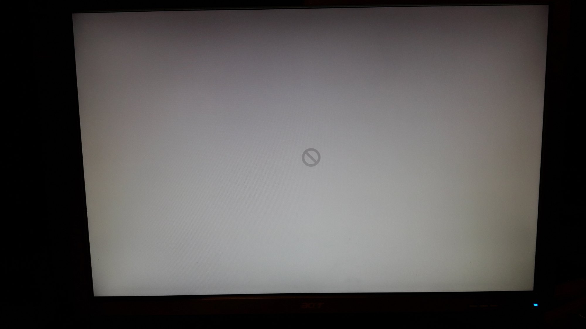

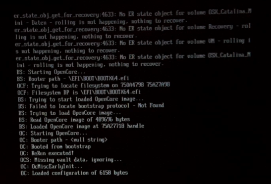

As suggested, the Mac should be able to boot into Catalina without OC now because of the setting of the "-no_compat_check" as a Boot.plist entry.
Catalina is still set as Startup Disk in the preference pane. Reboot...
But sorry, that was denied:
I rebooted three times... a fourth trial by starting with <option> into Apple Boot Menu and selecting catalina manually. None worked.
I then booted back into Mojave via Apple Boot Menu and installed my script again.
After that booting into Catalina without OC was successful again. After reinstalling the script in launchdemons of catalina and, just to be safe, manually deleting the boot-arg in nvram the reboot work, too.
It seems that my fear of com.apple.Boot.plist not read prior to the system check is justified?
Any other experiences?

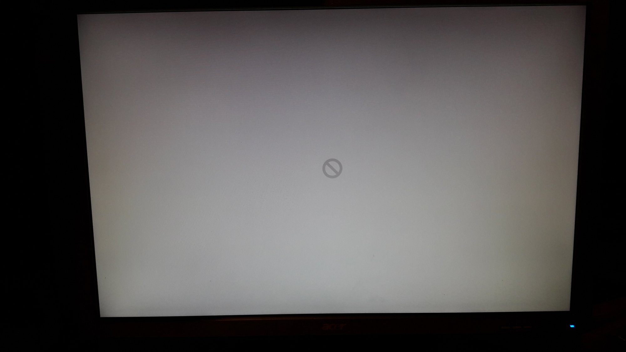

Maybe you have to add to Preboot also.
