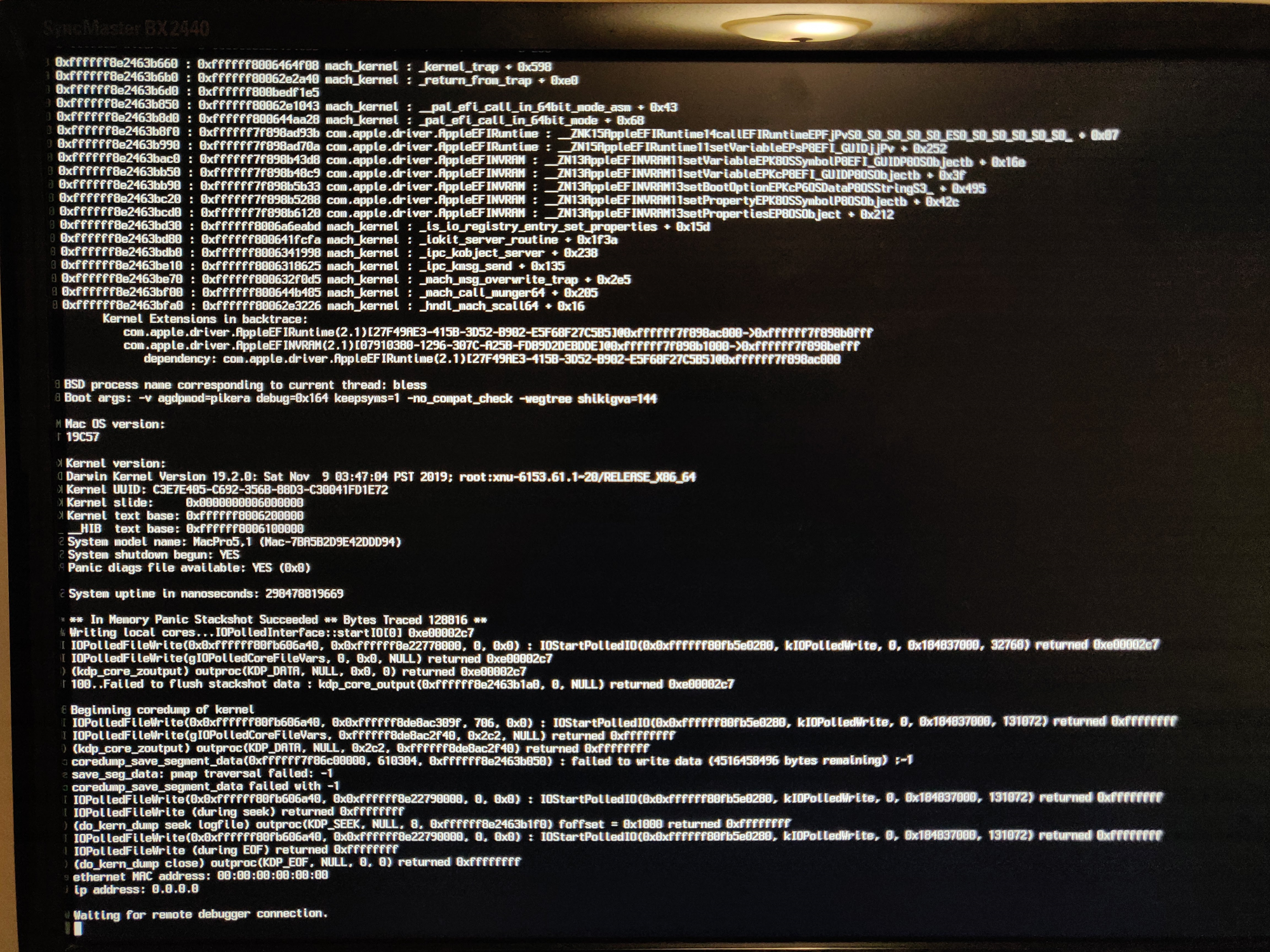

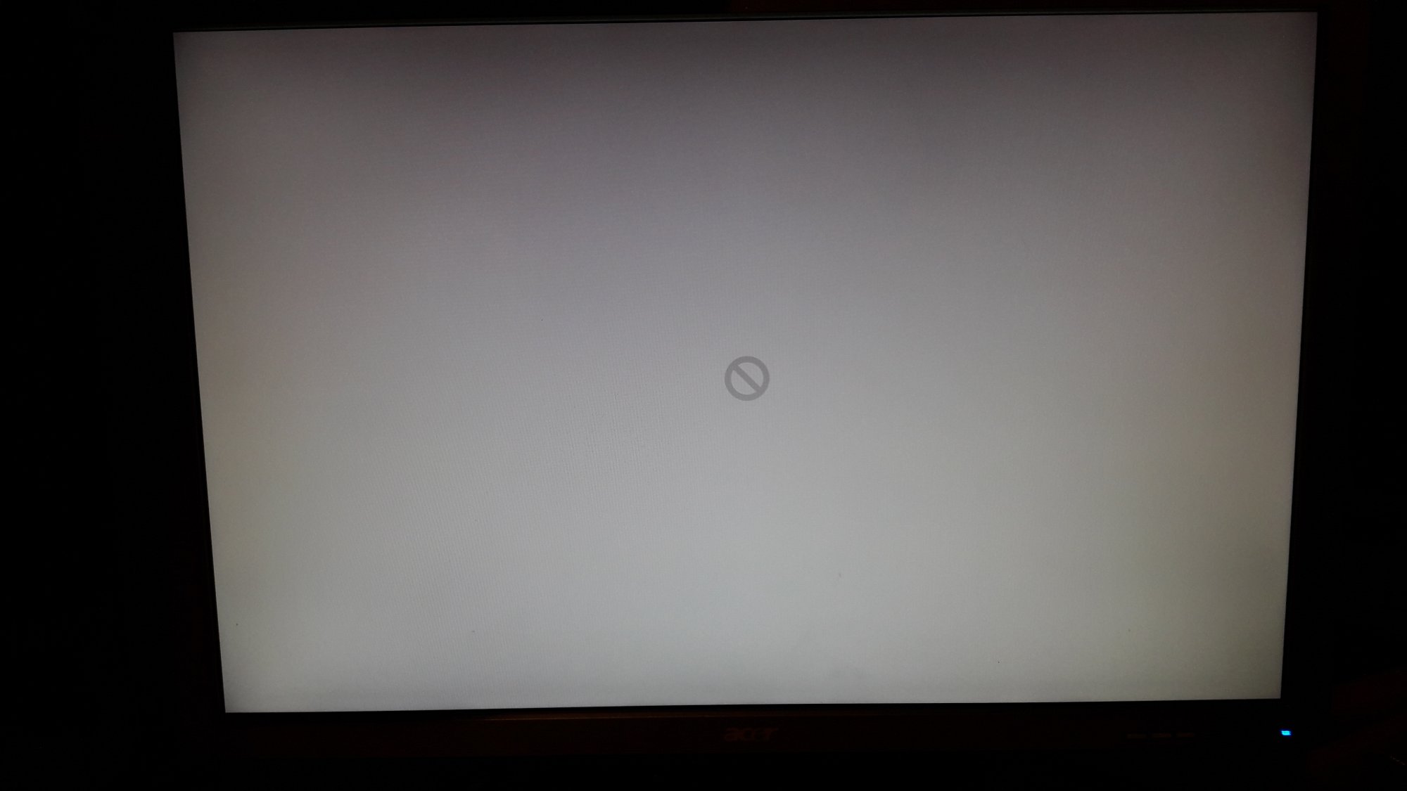

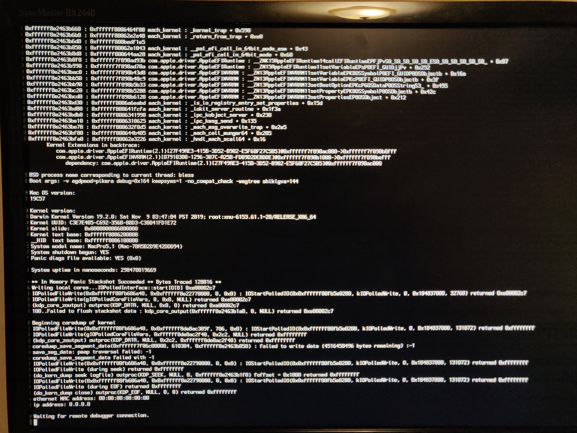

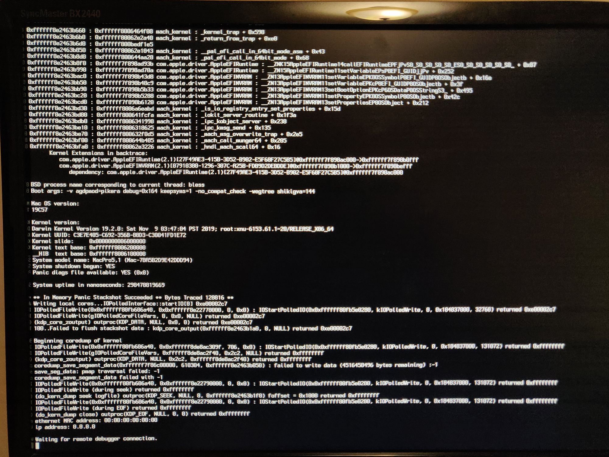

But sorry, that was denied:
I rebooted three times... a fourth trial by starting with <option> into Apple Boot Menu and selecting catalina manually. None worked.
I then booted back into Mojave via Apple Boot Menu and installed my script again.
After that booting into Catalina without OC was successful again. After reinstalling the script in launchdemons of catalina and, just to be safe, manually deleting the boot-arg in nvram the reboot work, too.
It seems that my fear of com.apple.Boot.plist not read prior to the system check is justified?

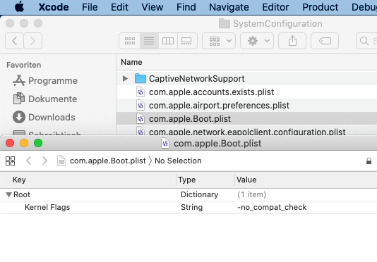

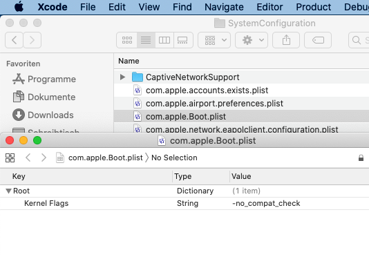

plist buddy:
i found that syntax in the "sierra on unsupported macs"-thread.
Because of your warning, I looked at the permissions of the so edited Boot.plist. Instead of root:wheel it is now actually changed to root:admin. I will correct this with chown and make a new test. The content with the added string under "Kernel Flags" seems to be correct. Or must there be added quotation marks or similar to it?
This is a pure text view of the edited file in addition to the XCODE view in my previous post:

Ooops, then it was right and not altered from the "plist buddy"-command. I have to revert my hastily manual change from "root:admin" to "root:wheel" back to "root:admin".
All other plists in that directory has "-rw-r--r-- 1 root wheel"...
Changed back to admin now, but it lists a bit different:
-rw-r--r--@ 1 root admin 248 28 Jan 18:53 com.apple.Boot.plist
=> what does the "@" mean instead of the blank that normally occures at this place. Didn't found a way to get rid of this.

That looks exactly like mine, did it? But ok, so there is nothing wrong with my editing.
