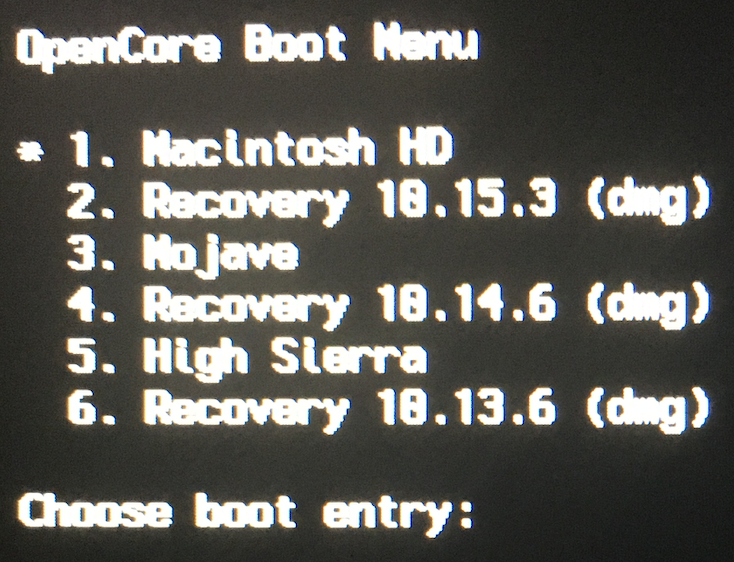

Guys you can start testing with this config file (don't use OpenCore configurator yet) and pick some other values as mentioned by @vit9696 above. Thanks for the great work Vit! Download the latest source from the master and compile. You should be able to see the OC boot picker with provided config file. Please report your results.
Directly use your plist file doesn't work on my cMP (stuck at booting, not sure if because I don't have the AppleMCEReporterDisabler.kext installed).
But if I only extract the relavant settings, and inject them into my own config plist, then my cMP can now boot with verbose mode with a single non flashed Radeon VII.
OpenCore definitely can provide some sort of "boot screen" for cMP now.

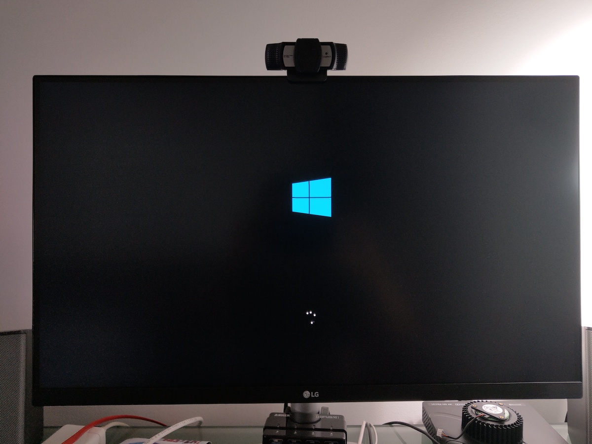

No luck. SIP is fully disabled. I selected Windows from Startup Disk, rebooted, and it immediately went to macOS. In addition, this config prevented my kernel extensions from loading.
Hmm. Try the attached config.plist with your kexts added back but first compile OC again as some important changes were made ie. you can now see OC options on boot without requiring a mac efi flashed gpu thanks to @vit9696

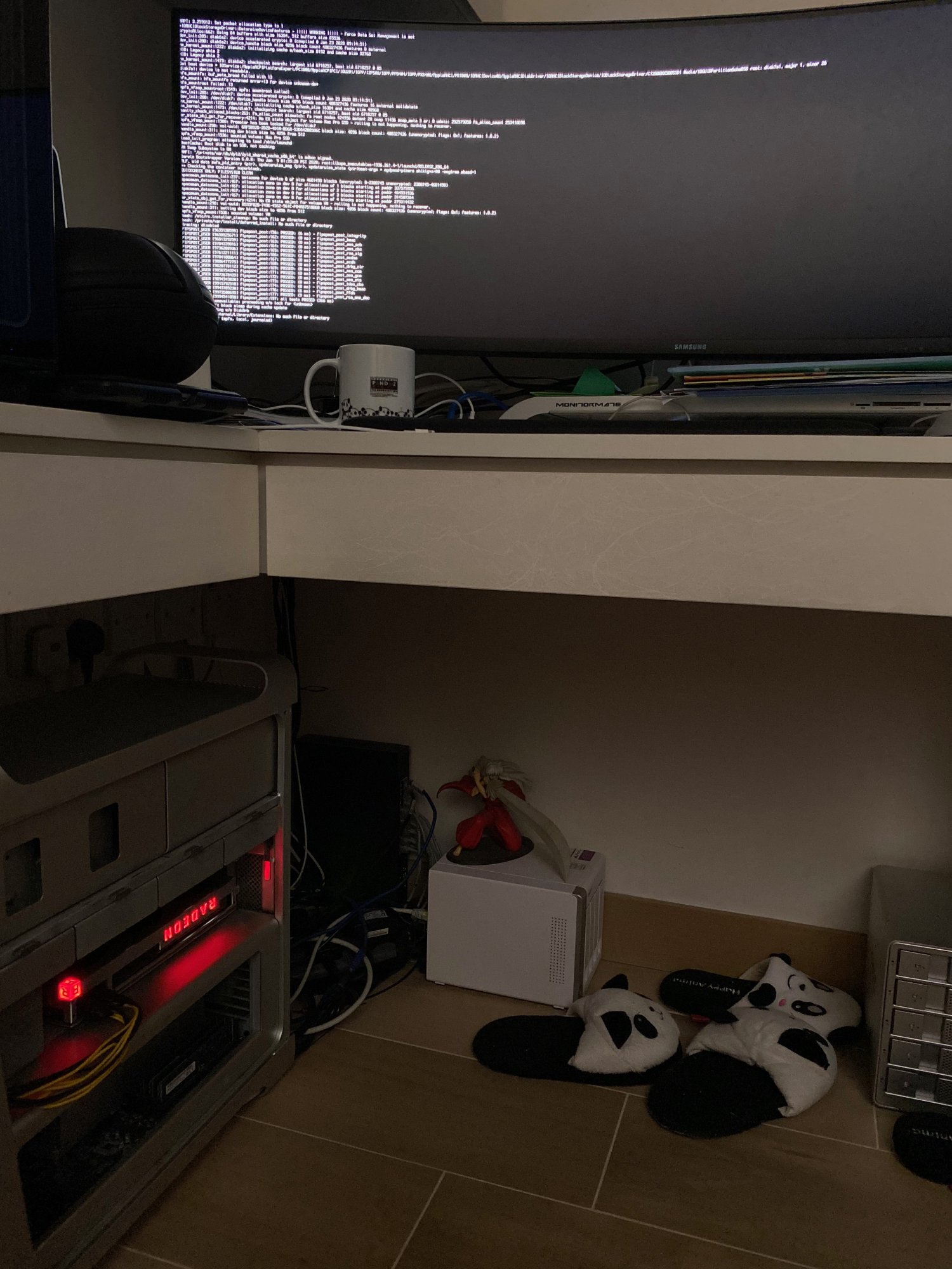

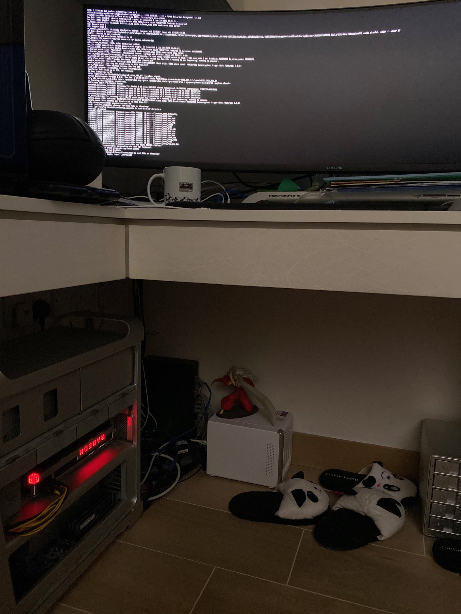

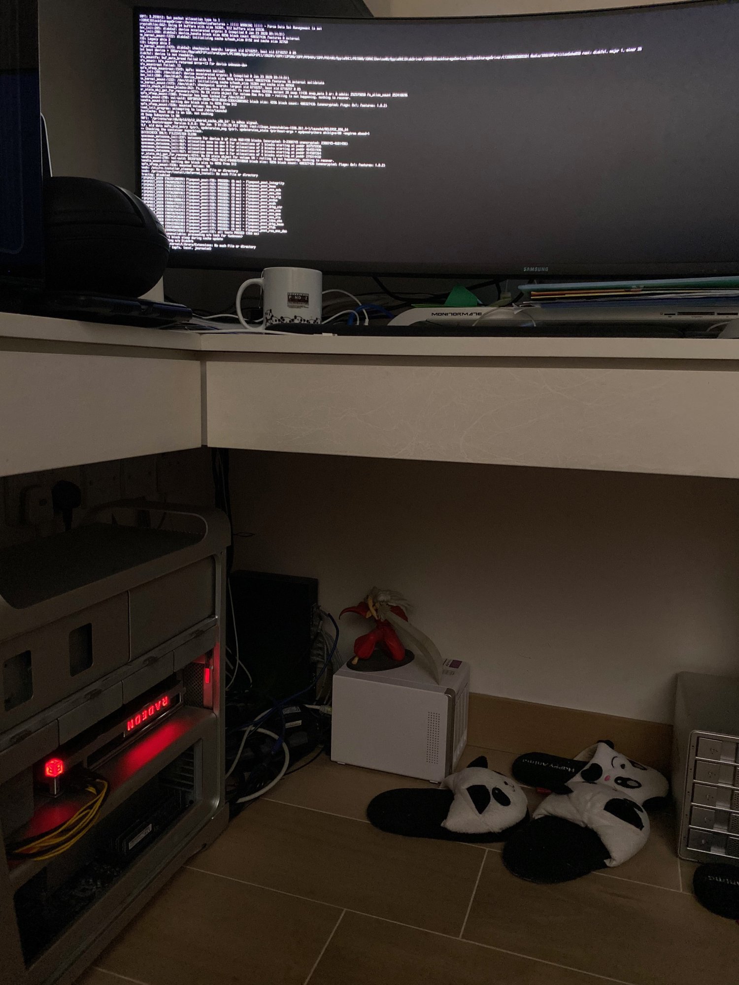

The output onscreen on the video is not from OpenCore. This is rEFIt or Clover. OpenCore does not name entries like this.
Thanks for the comment. So, it means that my system is “dirty” (I tried to use rEFInd and Clover on my cMP to get “Boot screen” before. And I failed to uninstall them properly). When I did that test, I hit some key in blind and accidentally use OpenCore to activate the display via Clover etc.

I tested with the release version and that was enough to get the boot screen.
