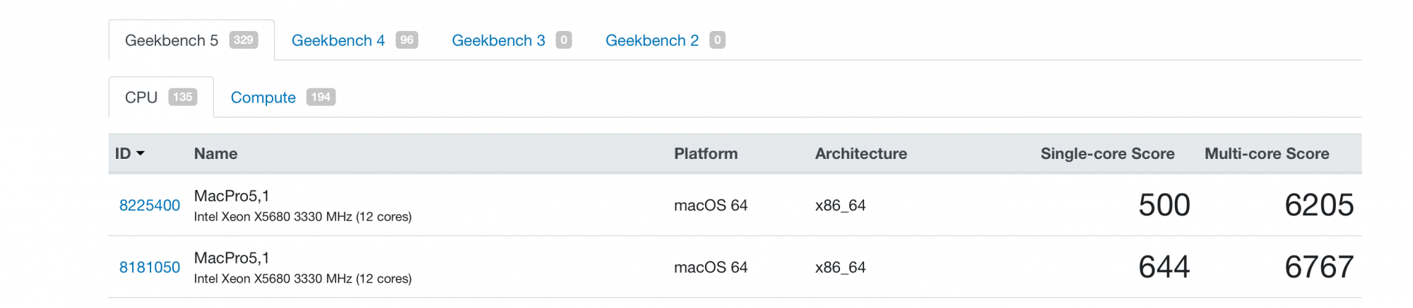

I have CMP 4.1/5.1 dual CPU 5680, 96Gb RAM, GPU Radeon Pro W5700 or W5500 or RX580 (also RX570)
BigSur 11.2.3 with OC 0.6.9
Сan open core reallocate resources between the processor and the video card? I got a problem:
After replacing Sapphire RX580 with Radeon Pro W5700, my cMP processor performance decreased. According to the Geekbench 5, the score became 6200 instead of 6800, as well as about 20% slower CPU rendering in the corona benchmark or CinebenchR23 But, if I return the RX580 or put Radeon Pro W5500, the results of the processor's work will return to the previous level of good performance. As to TBP: RX580 has 225 watts, W5500 has 130 watts, and 5700 has 205 watts. I thought at first that it was motherboard reaction to the modern GPU 6+8 pin power connectors, that reduced the CPU performance, so I switched it to a pixlas mod, but no improvement happened, then the problem is something else. I didn’t find any information on macrumors forum about decreasing CPU performance due to GPU. May be my question will be reason for additional research?
Also Parallels Desktop + windows 10 works with W5700 awful
