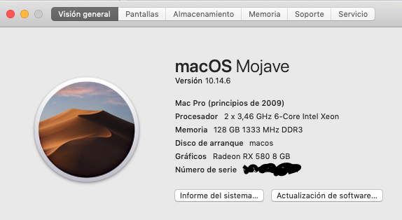

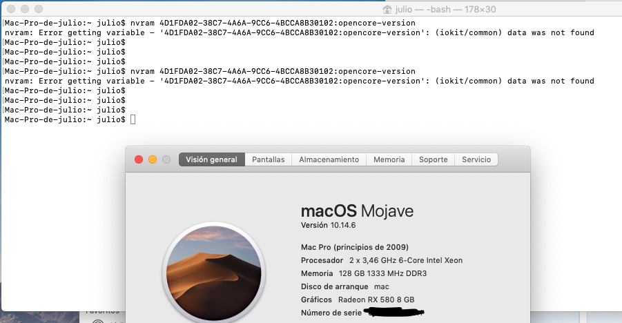

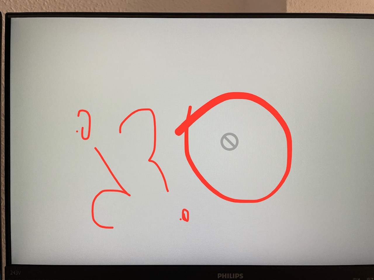

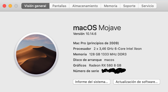

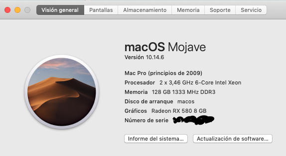

hello guys , I'm following the tutorial... and on this step:
Confirm the installation
  • In macOS, open Terminal
  • Confirm that OpenCore has booted the system by entering: nvram 4D1FDA02-38C7-4A6A-9CC6-4BCCA8B30102😱pencore-version
You should see REL-070-2021-06-07.
i have the next error - see image, what could be wrong?
regards
regards
If you see that result, OpenCore has _not_ booted the system. That's why the instructions get you to double-check at that point. 🙂 Instead it looks like you've gone directly into Mojave - not via OpenCore, but just directly, i.e. as you would have done before OpenCore was even there.
You probably need to go back a few steps - you're looking to see the "simple text-based bootpicker" which it mentions just before that, in the instructions. Until you see that, you're not starting OpenCore.

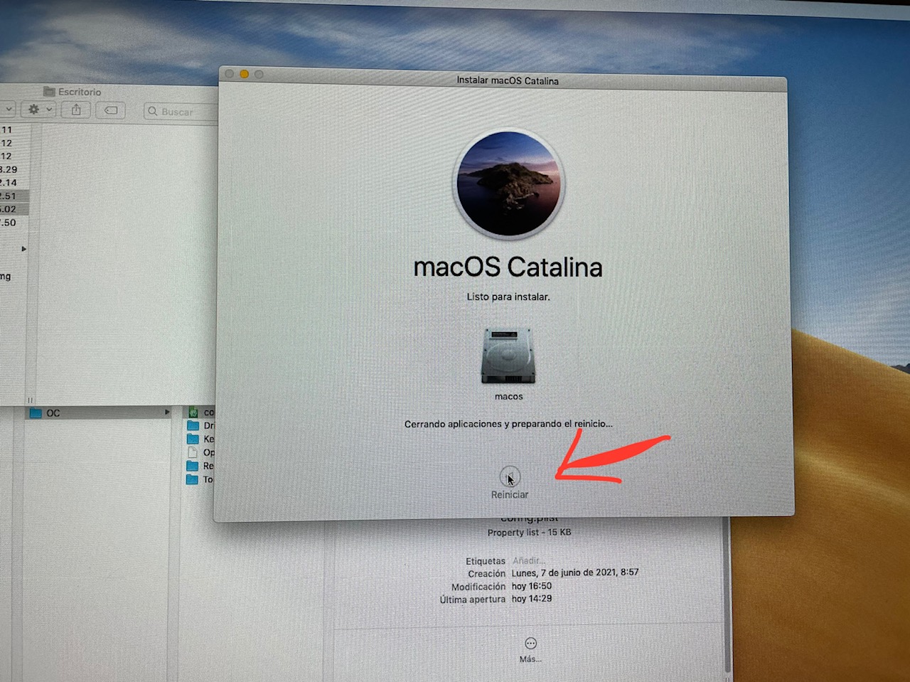

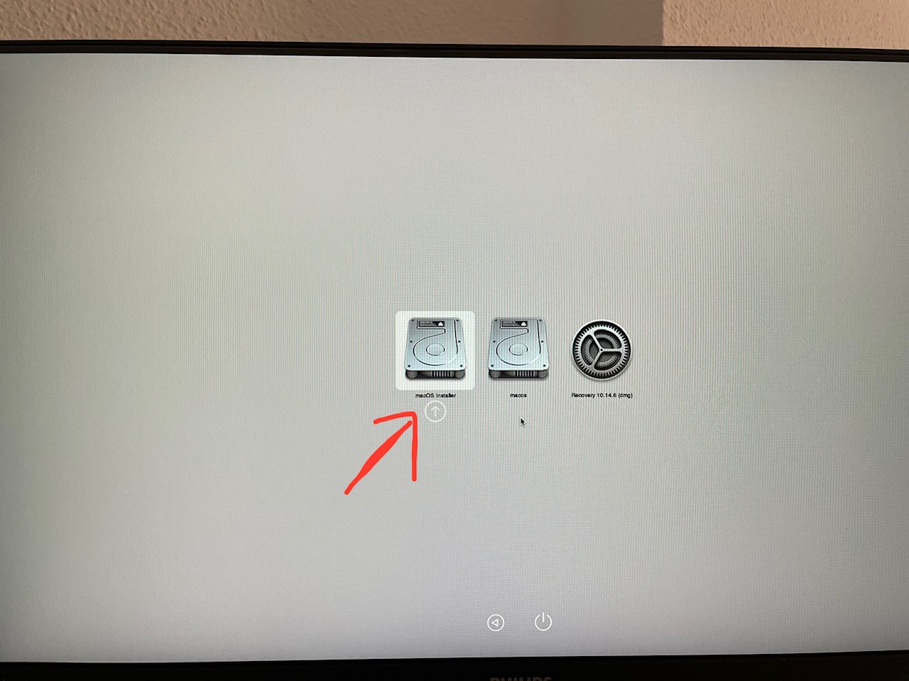

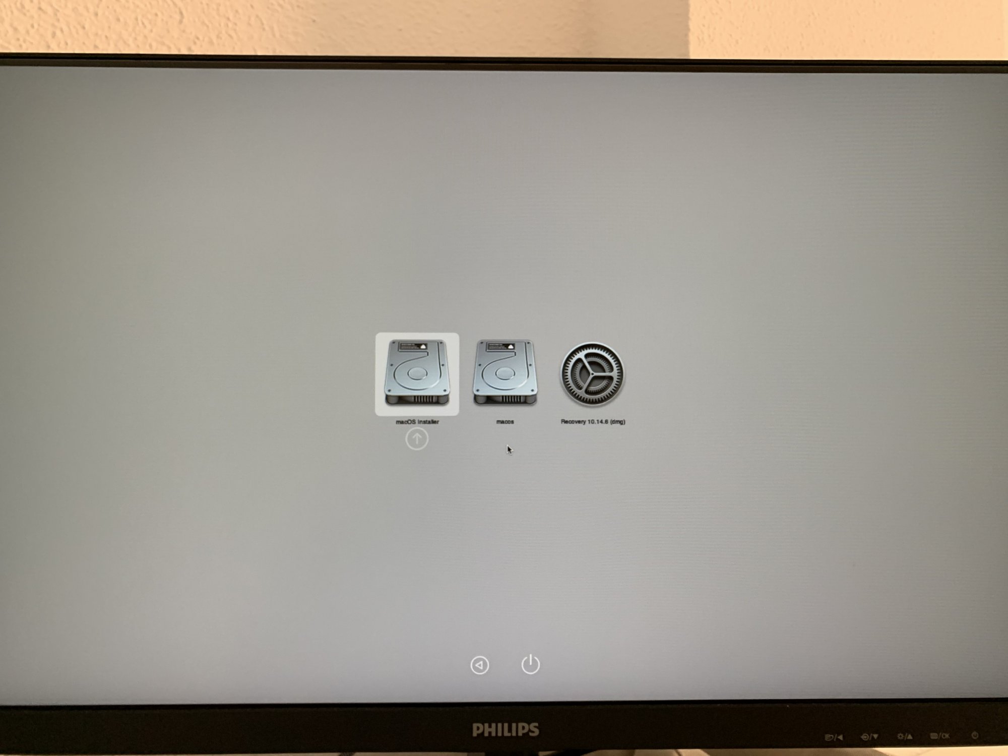

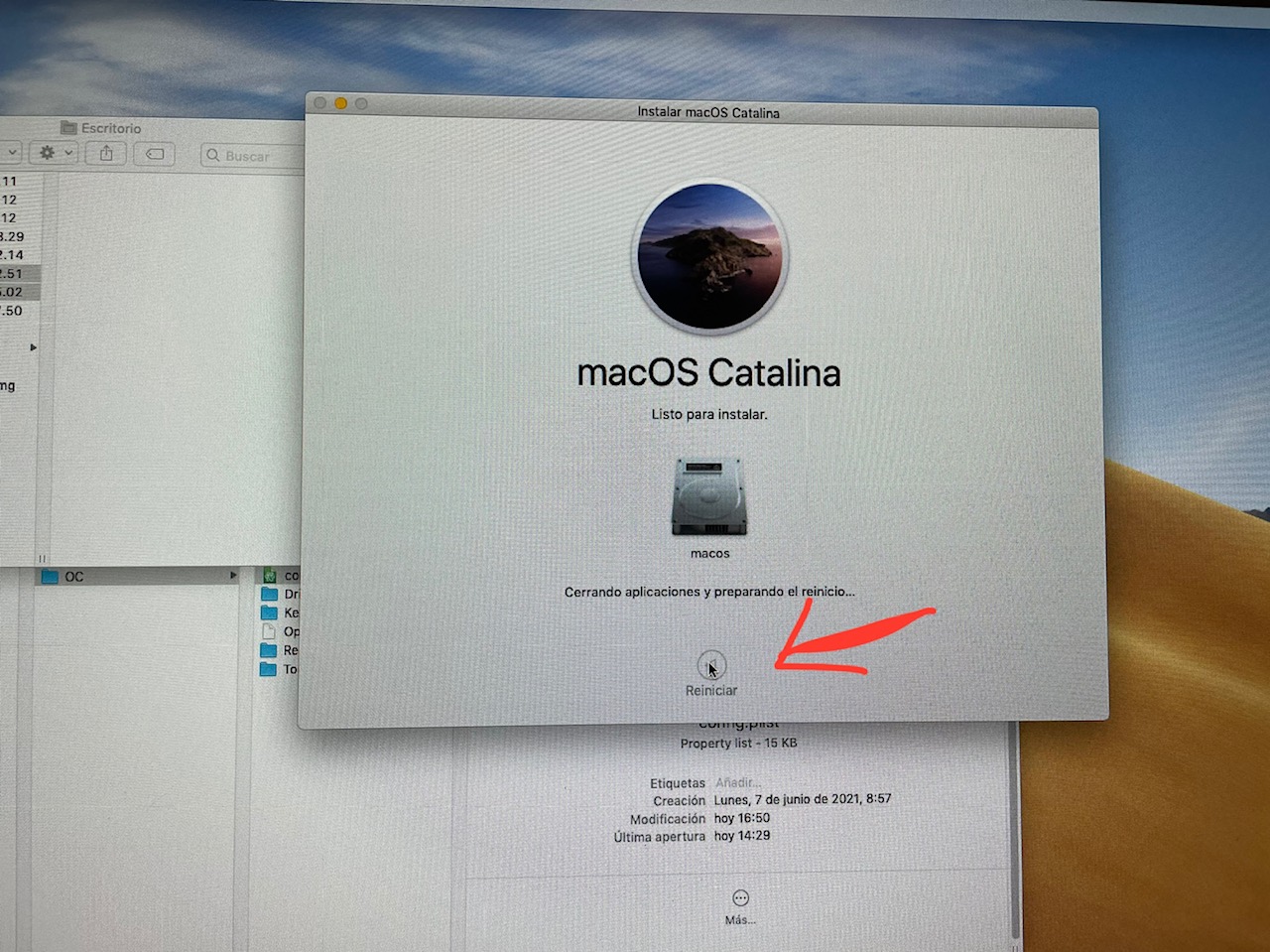

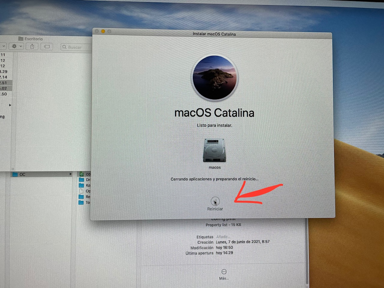

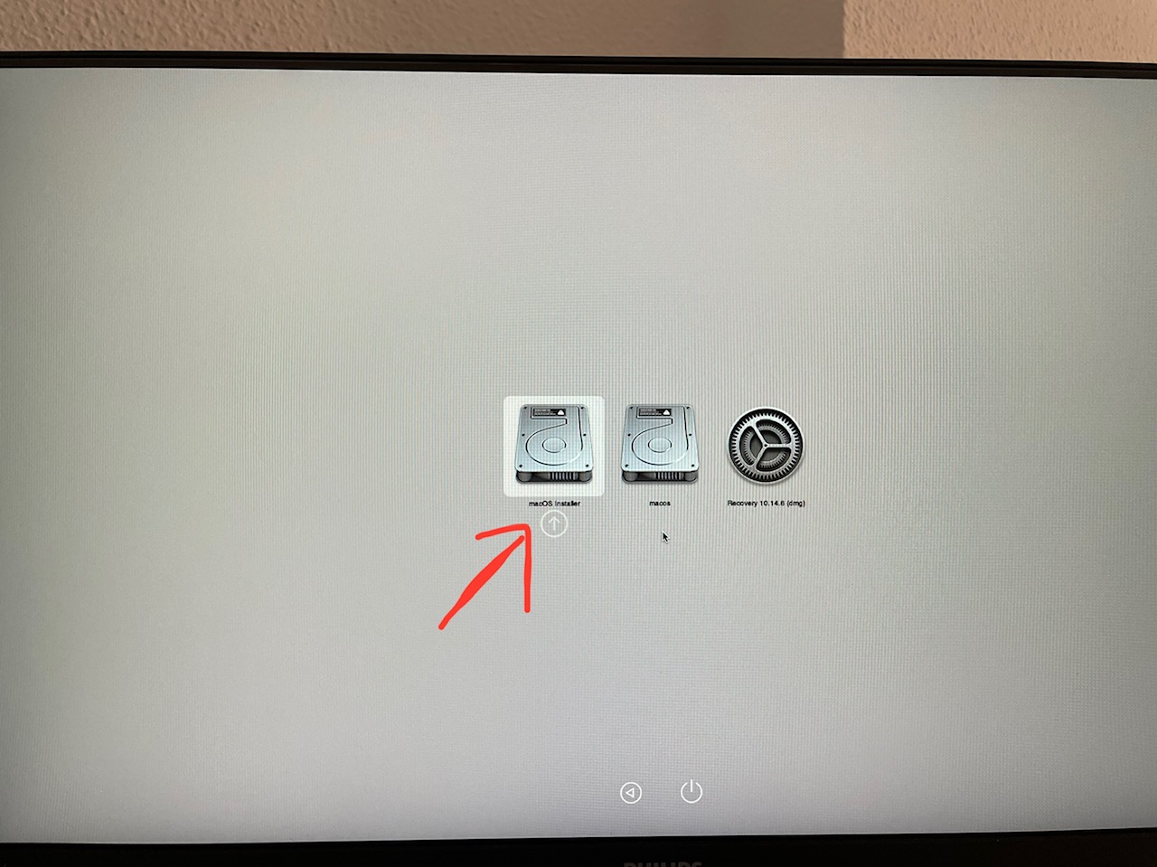

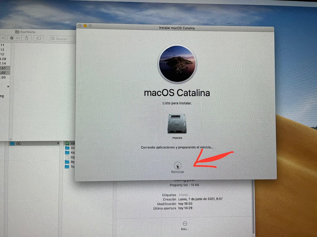

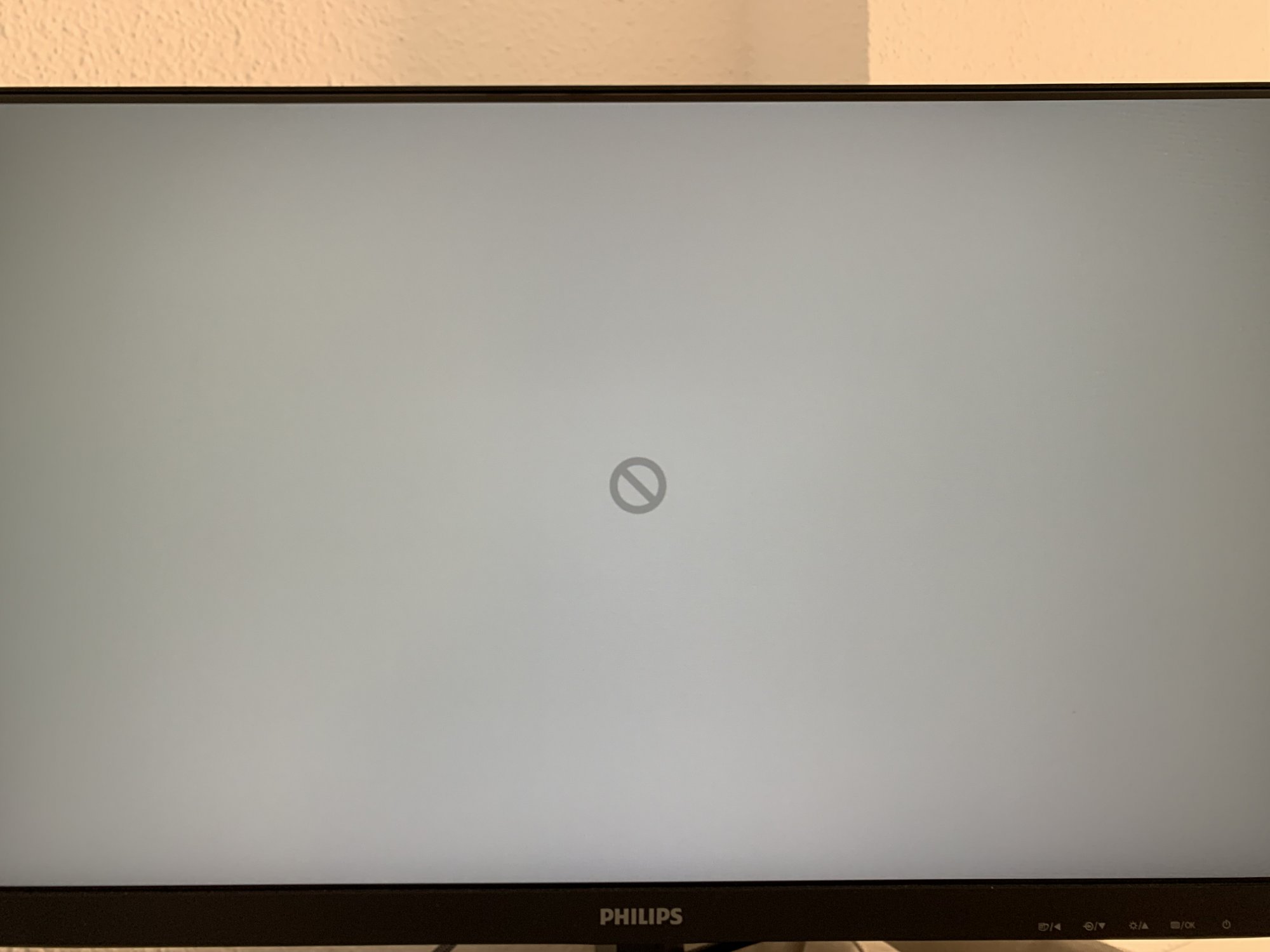

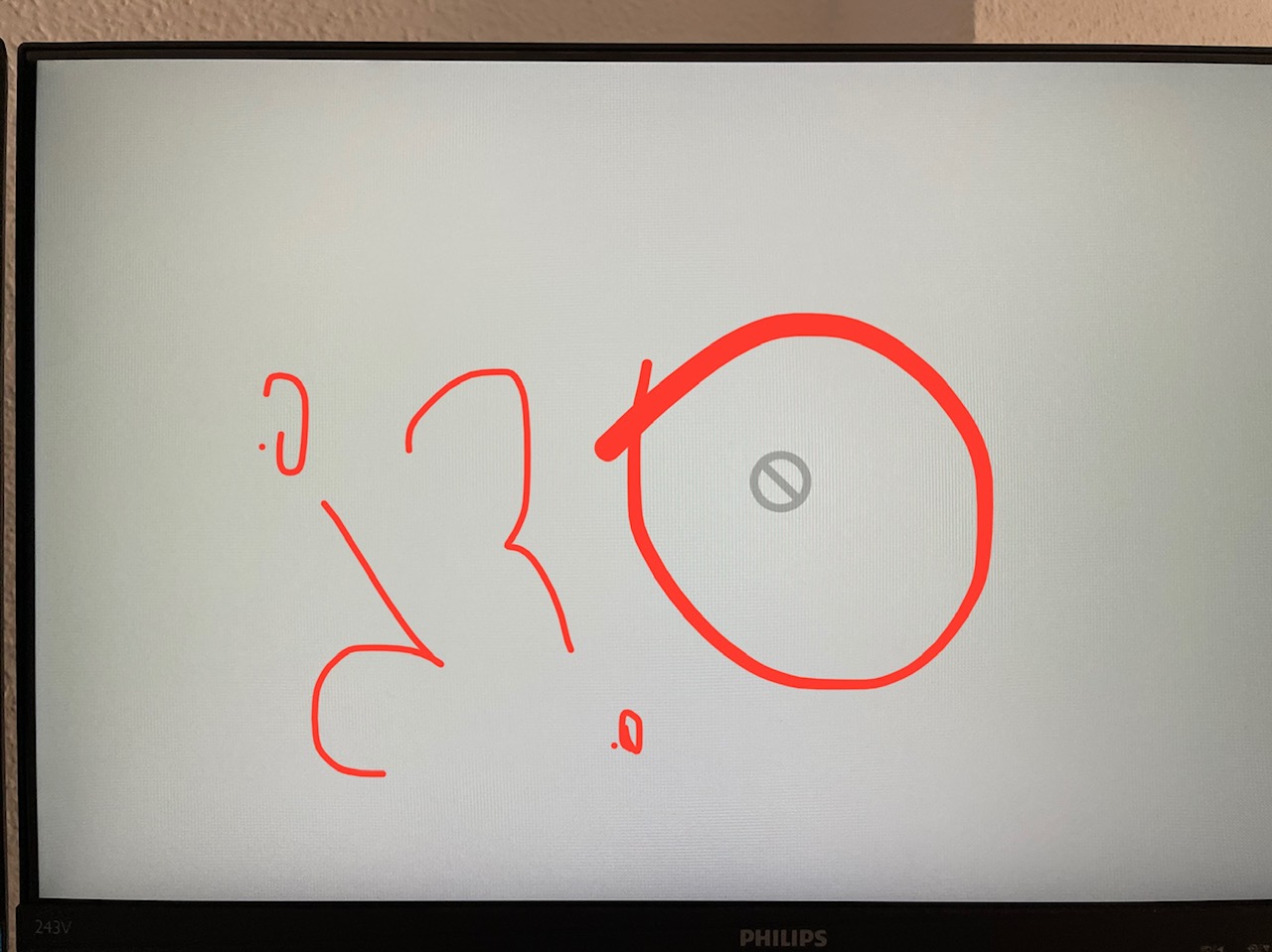

Hello guys, i have a problem, i will explain first what i did:
1- clean install Mojave - all was ok
2- install openCore 0.7.0 (follow the tutorial) - all was ok
3- i wan to update mojave to Catalina - ERROR
i don't know what is wrong i'm just update mojave to catalina, but my mac shutdown.
i upload the screens
after this scree , my mac turnoff.
i also upload my config.plist file
can somebody help me?
View attachment 1791276View attachment 1791278

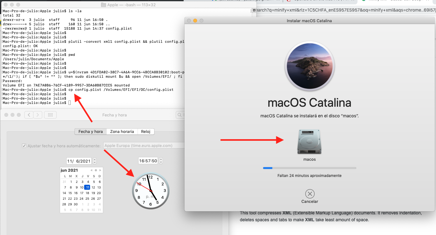

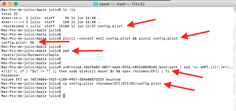

Check your config file with this:
Verify and load the configuration
  • Close config.plist
  • In Terminal, enter: plutil -convert xml1 config.plist && plutil config.plist

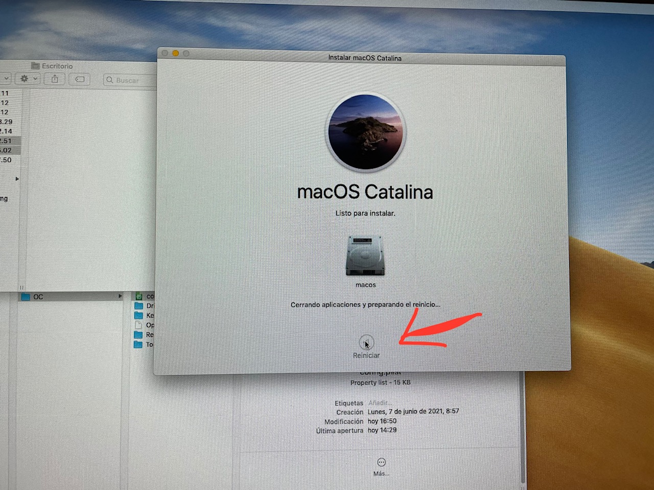

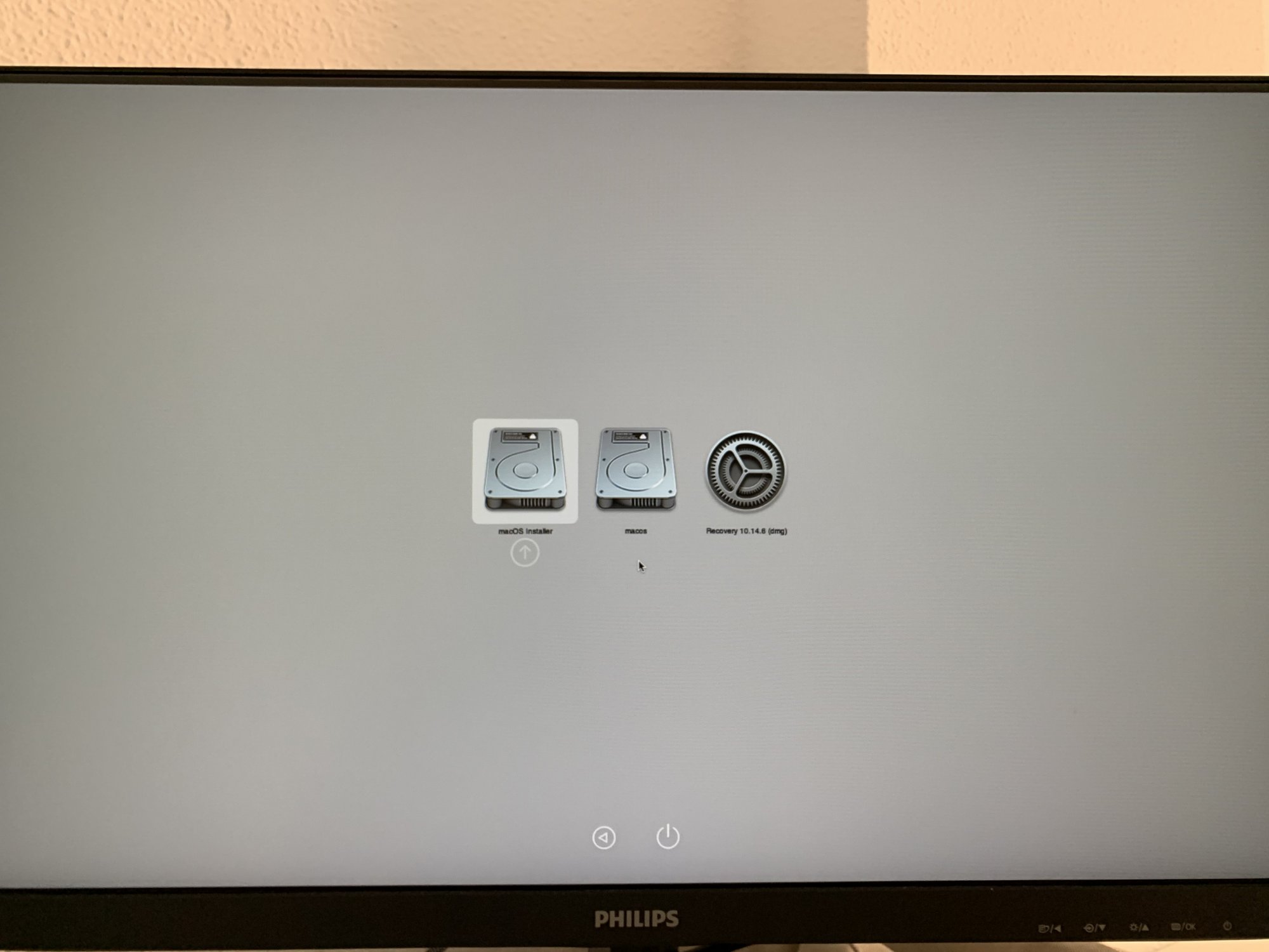

The same ... my config file is OK
and I copy to EFI folder ... start the update process (catalina) but is the same ... the same error, here are the screenshots about the process
what is wrong?
regards
