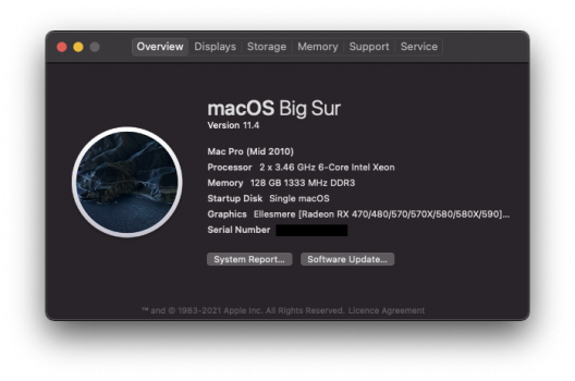

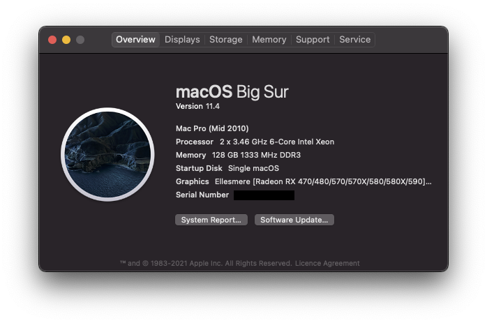

Hi everyone. I've installed OC 0.7 on a cMP5,1 and installed Big Sur. Great job to everyone involved BTW. I have one minor issue. None of my USB ports work. There's power, but it doesn't detect if anything is connected. I've tried installing USBInjectAll.kext and USB-Mapper.kext but whenever I plug in my wired mouse, it won't even recognise it. I'm pretty sure it's loading OC 0.7 because I see the boot screen and NightShift is working. Has anyone else had the same issue and how did you fix it. I tried looking on the thread for issues similar, but couldn't see anything. Any help is much appreciated.

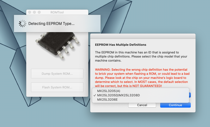

Hello, I tried to verify my NVRAM Garbage Collector, but i'm facing multiples chip ID's...
I have to choose a specific one?
Thanks

You can read the chip type by inspecting the chip visually.
but it dont depends with reading.
you can use my dumper what detects the type by trying and with the knowledge what type is in what machine. Also it can calculate free space and some other data points.

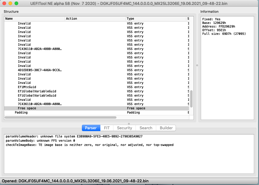

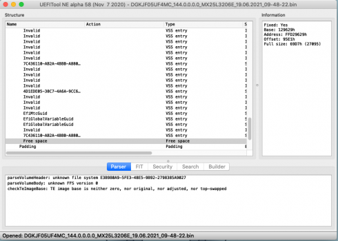

A normal working single CPU Mac Pro with 3 DIMMs have the Free Space Full Size usually around 45000 to 40000 - this is for a healthy working dump
Mine is like attached at 27095...
So it's not good, as it should be 45000 - 40000, right?

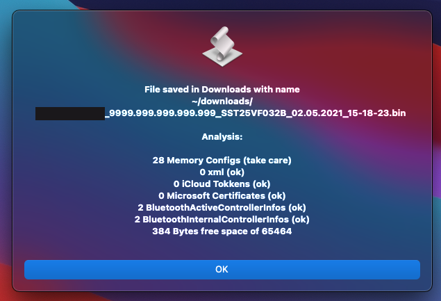

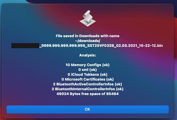

Hi! Thank you for your great tool, i am concern about the free VVS space, my free space was 51000 but after boot to windows downs to 33000 and then after to reboot to windows and return to MacOs was down dramatically to 5200 this is a normal behavior?
When your Nvram is healthy, it should run into garbage collection with the next one or two reboots.
see 1st picture is a full 1st VSS Stream,
next boot, without doing anything special, just rebooting, the garbage collection has run, Memory Configs reseted with plenty of free space:
here is a full circle from full to empty: https://forums.macrumors.com/thread...s.2289056/page-21?post=29845724#post-29845724
at least with Big Sur used space is increased about 5000 Bytes with every Boot. Also 2 Memory Configs are added with every boot on my Single Mac Pro 5.1
Until it is almost full, then it got flushed, replaced somehow with the content of the 2nd VSS Stream.
The free space what my tool counts is not 100% accurate, but enough to see what's going on.
If the 1st VSS Stream is damaged in any way (by duplicated variables, Windows certificates, etc) this garbage collection can go nuts and the Stream can exceed its limits. With bad luck overwriting the discriptors in the 3rd stream.
It's always a good idea to have a prestine, clean Firmware. I do always clean and rebuilt the Firmware on the machines I am working on.
