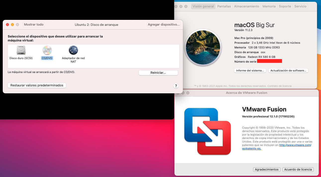

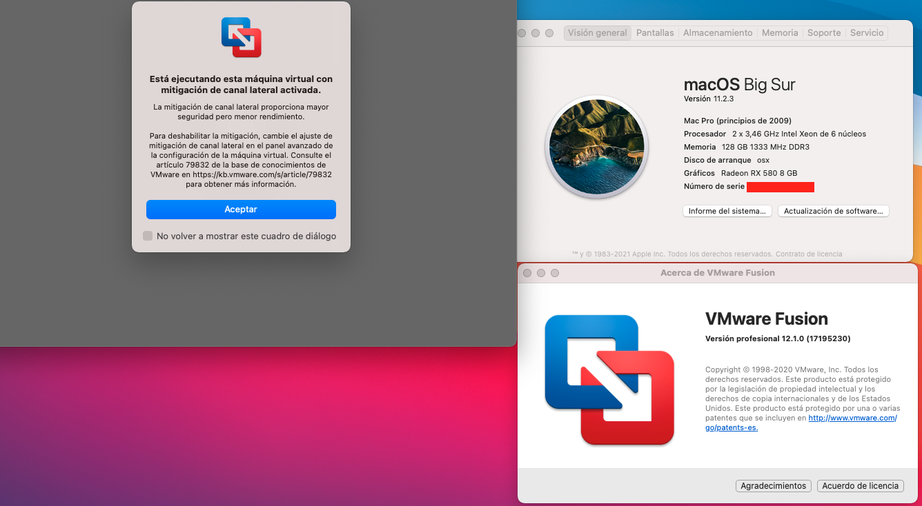

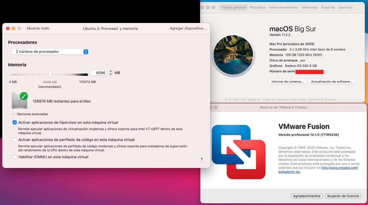

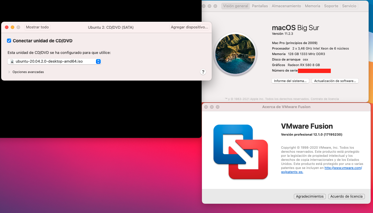

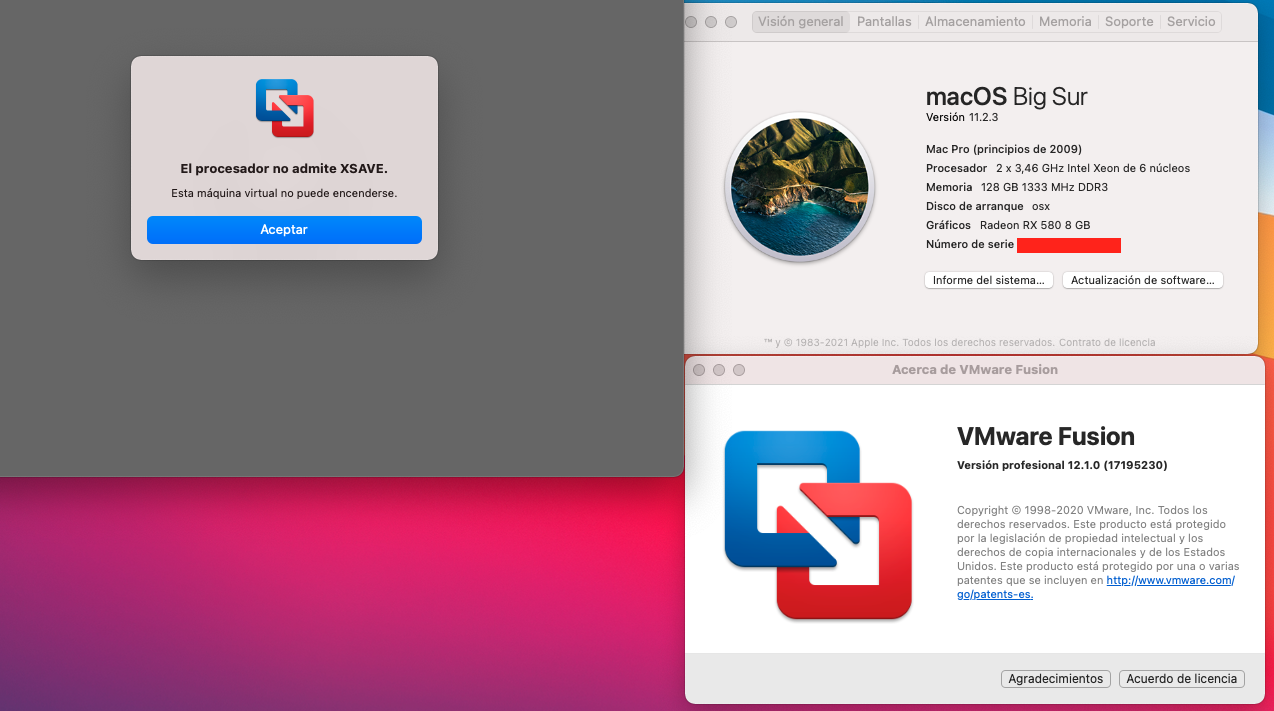

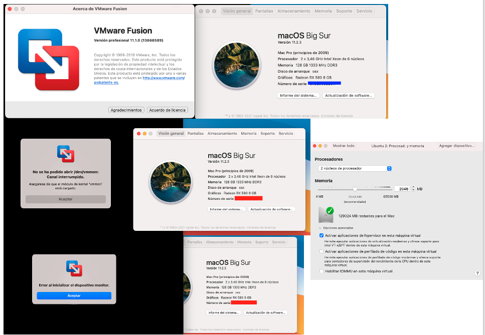

Hello guys, first sorry about this question, but i don't know what is wrong.
recently (the last week) I follow this tutorial and i got my mac pro 5.1 works, all is working, but now that i'm trying to use VMWare Fusion 11, 11.5 and 12, i have some errors (images loaded)
Can somebody give me a hand?
Regards

VMWare dropped support for Mac Pro 5.1 CPUs after Fusion 11.5.6 in Big Sur.
Try changing the hypervisor in your 11.5 or switch to Parallels.
Also, this has NOTHING to do with OpenCore, why wouldn't you create a proper separate topic?
Reactions: 0134168
@juliovg
I'll answer in Spanish: VMware Fusion 12.x ya no soporta Big Sur en un Mac Pro clásico. Usa Parallels Desktop, que sí lo soporta. Tendrás que importar tus máquinas virtuales de Fusion a Parallels. No da problemas.
Regards
Read this thread - vmware-fusion-no-more-on-macpro5-1.2261362
Short answer is that VMWare will not run on macOS Big Sur or later on our mac pro 5,1s.
