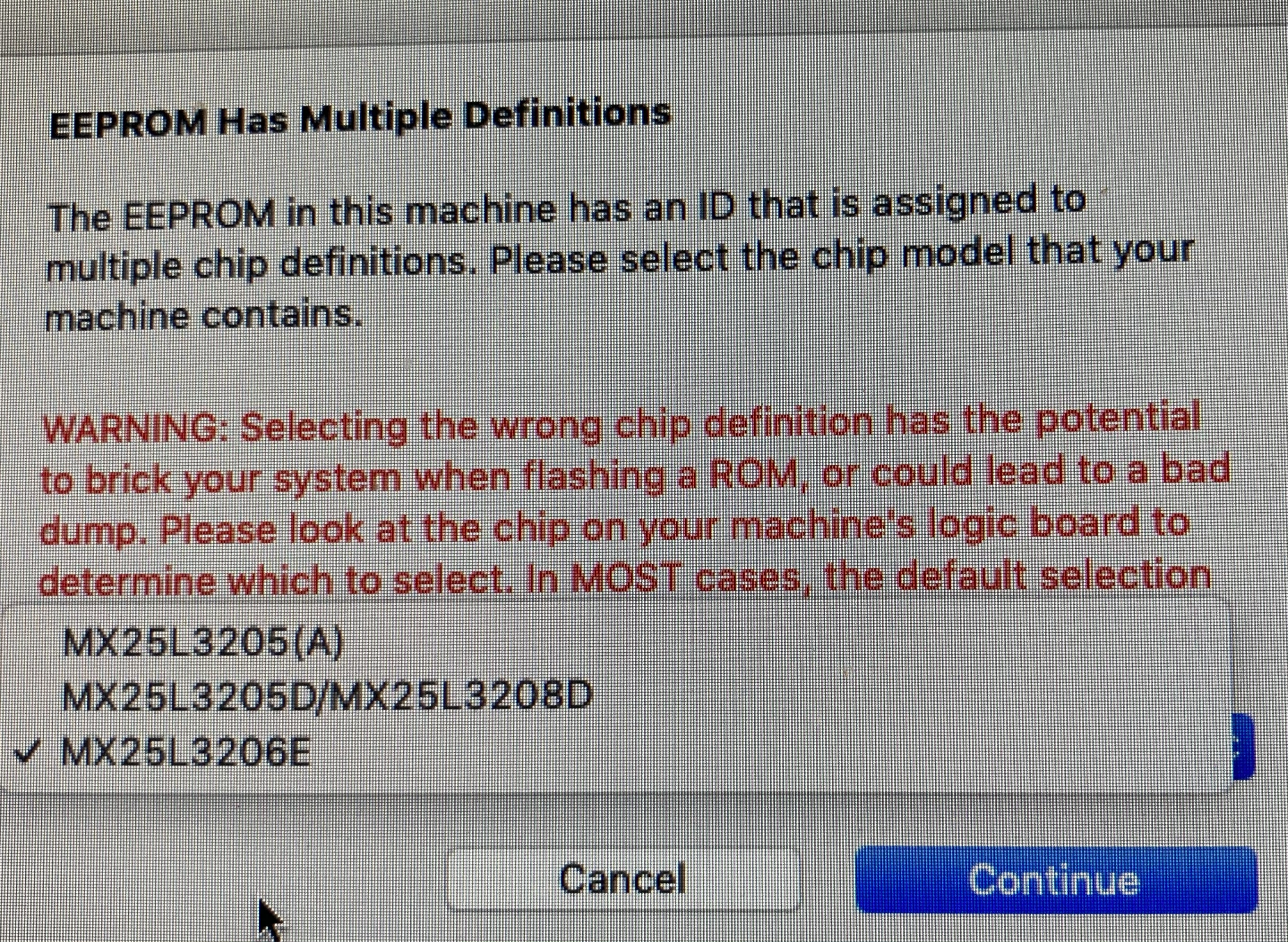

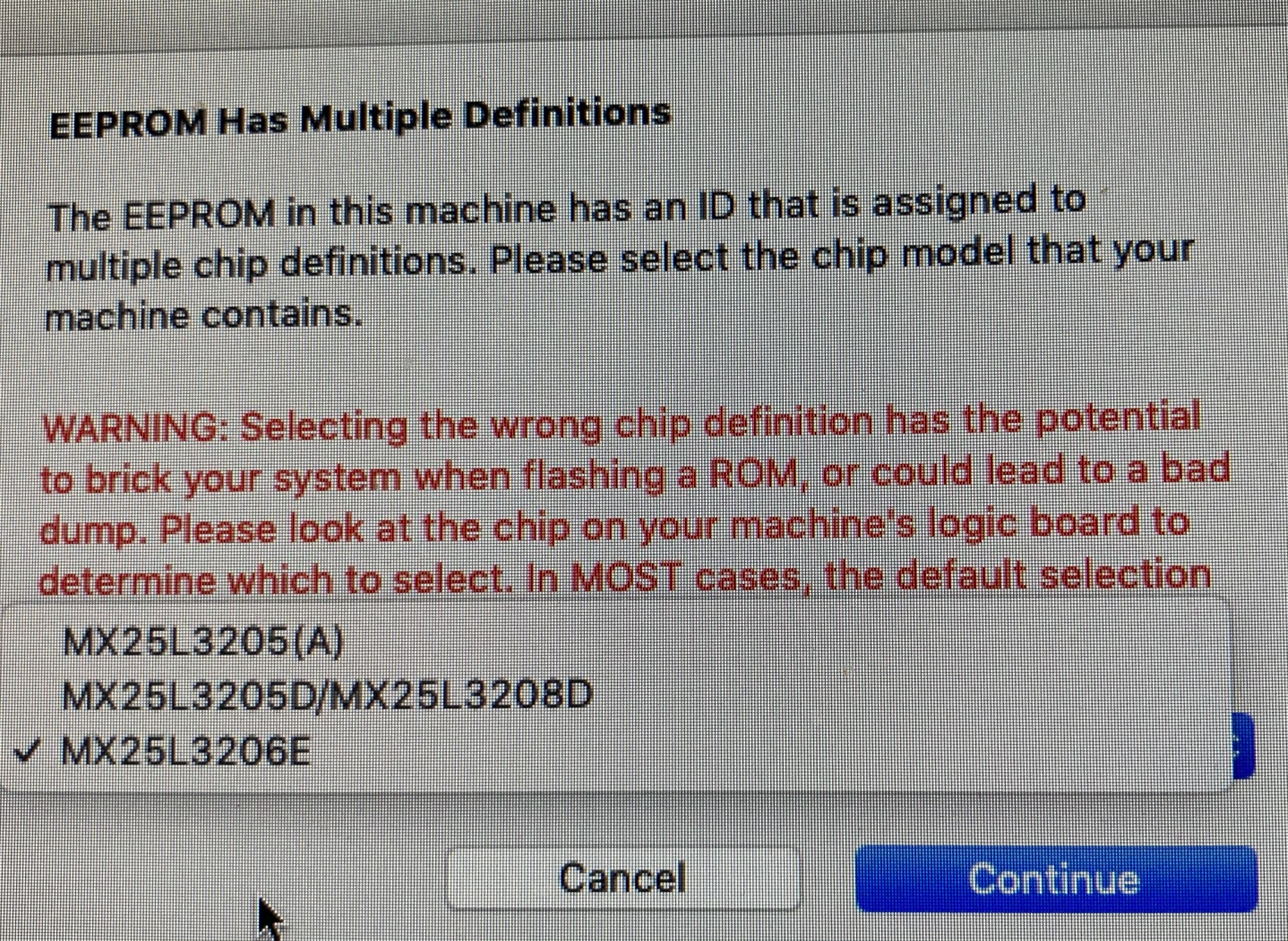

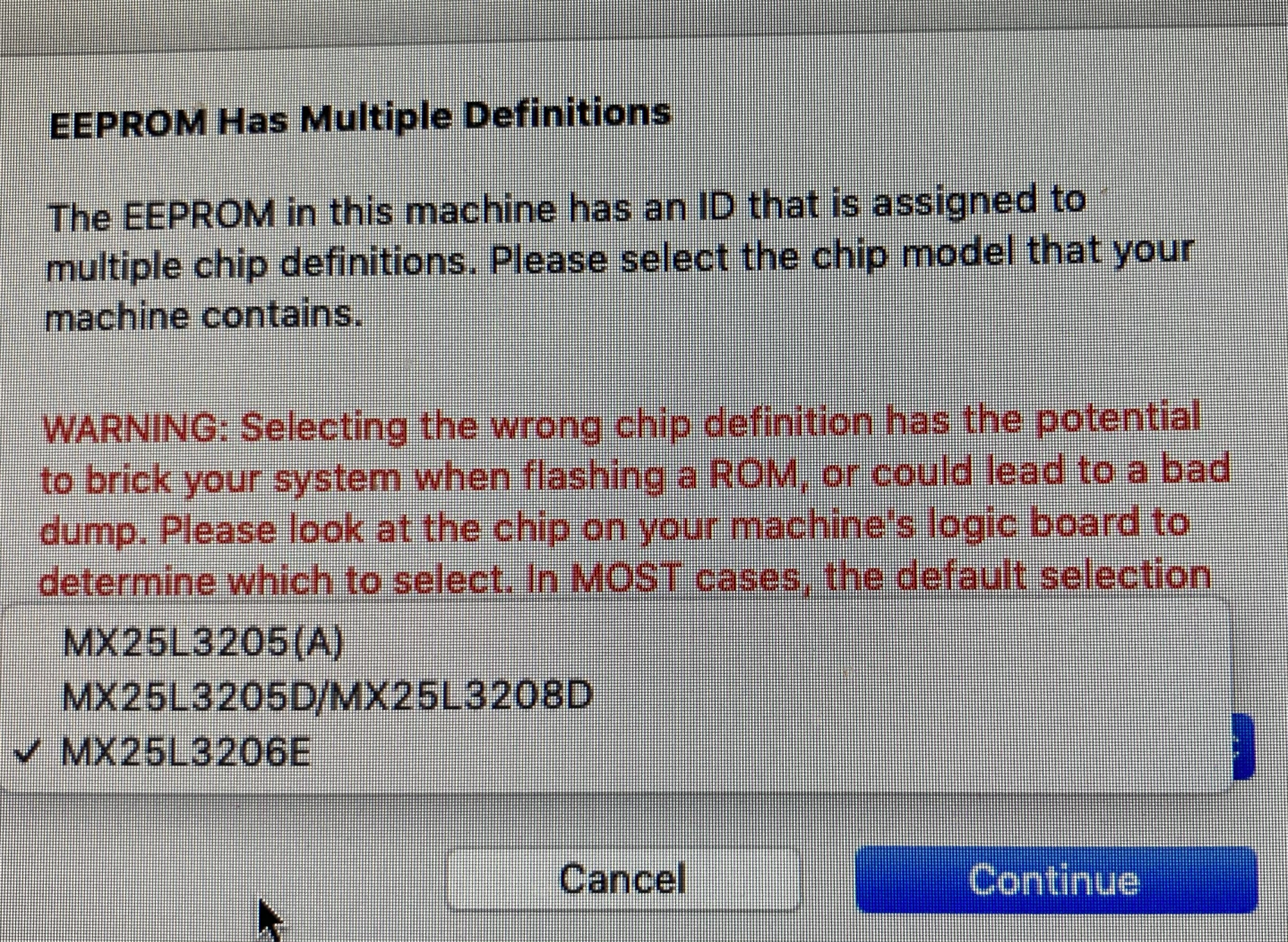

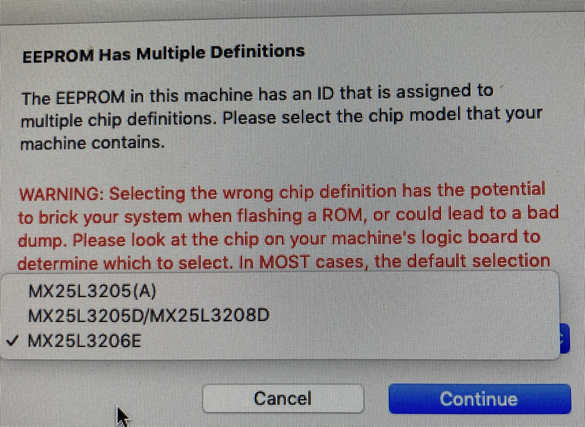

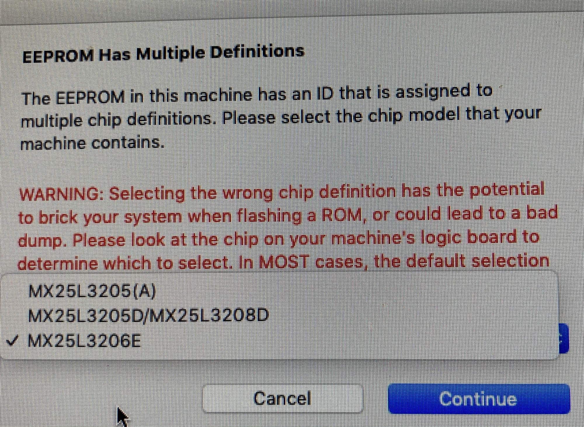

Alex, thank you for your quick reply, I am not very confident with this ROMtool bit and when I went to dump the rom I got the attached message. (I have a 2010 5.1 dual 3.46.) tempImagenWbsxP.png
Alex, thank you for your quick reply, I am not very confident with this ROMtool bit and when I went to dump the rom I got the attached message. (I have a 2010 5.1 dual 3.46.)View attachment 1802192
You have to check the model of the U8700 CI on the backplane, right next the two mini-PCIe power connectors. I'm gonna send you a PM with detailed instructions on how to dump correctly and how to gather everything needed for a diagnostic, check your PMs.
