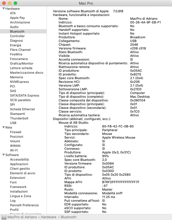

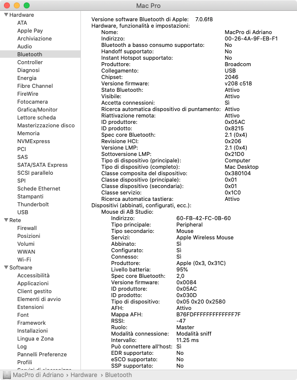

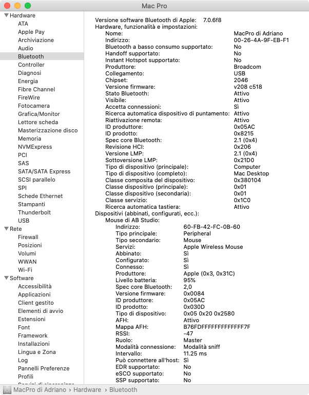

I'm a bit confused, because original Bluetooth card works perfectly with Catalina on my MacPro (it did with Dosdudes patched Catalina, and it does now with OpenCore). I thought problems will happen with BigSure but now if I didn't misunderstand you, as I've not replaced my BT card, it shouldn't work with Catalina too.
Look at the 3 "No" in your System Information.

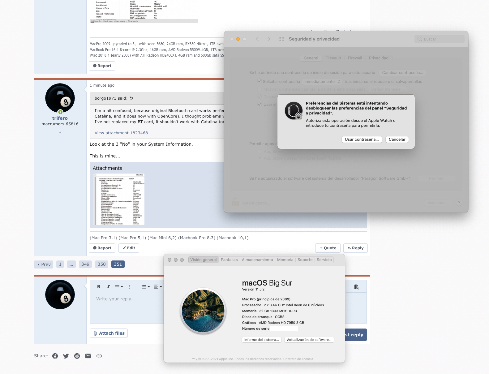

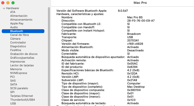

This is mine...

Please, gentlemen, let's not take this thread beyond its intended purpose. OpenCore is NOT intended to magically add hardware capabilities to old Macs; only to make them appear as supported to the OS that is booted. In other words, if you have an unsupported Mac Pro 5,1 but you want to fool Catalina, Bir Sur or Monterey into believing they are running on an iMac Pro, that's fine, and it will work, but that won't magically add novel features, such as faster or more energy-efficient versions of Bluetooth, et cetera. Unless you somehow modify the OS itself so that it will have the proper interface to obsolete components no longer supported in the latest versions of macOS, macOS won't imagine you have up-to-date versions of such components. I insist, unless you modify the OS itself (by adding the relevant controllers for obsolete components), I very much doubt they will work. For your hardware components to behave like their modern counterparts, you don't need OpenCore; you need their modern counterparts, with or without OpenCore.
I suppose you meant "gentleman". I NEVER said anything related to add novel feautures. In fact, I can´t agree more with you.

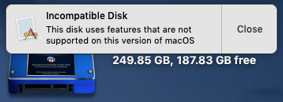

I started from scratch. Wiped out all the drives and removed them. Then I left a SSD that I also wiped clean and in recovery off of USB I did a fresh install of Mojave. What's got me baffled is that the drive was wiped clean and the only drive in the computer. Fresh Mojave install but for some reason hardware acceleration is still active, which that wouldn't even work without OC. The computer runs noticeably faster as well and gives me the ability to update to Big Sur 11.5.2 but for the life of me OC is not installed in a clean reinstall of Mojave.
I do get this:
Incompatible Disk
This disk used features that are not supported on this version of macOS
I take something is lingering ?
Although the computer is running really fast ?
I do get this:
Incompatible Disk
You have to format the drive, not the container. In "Disk Utility" press Command+2 to show all the devices.

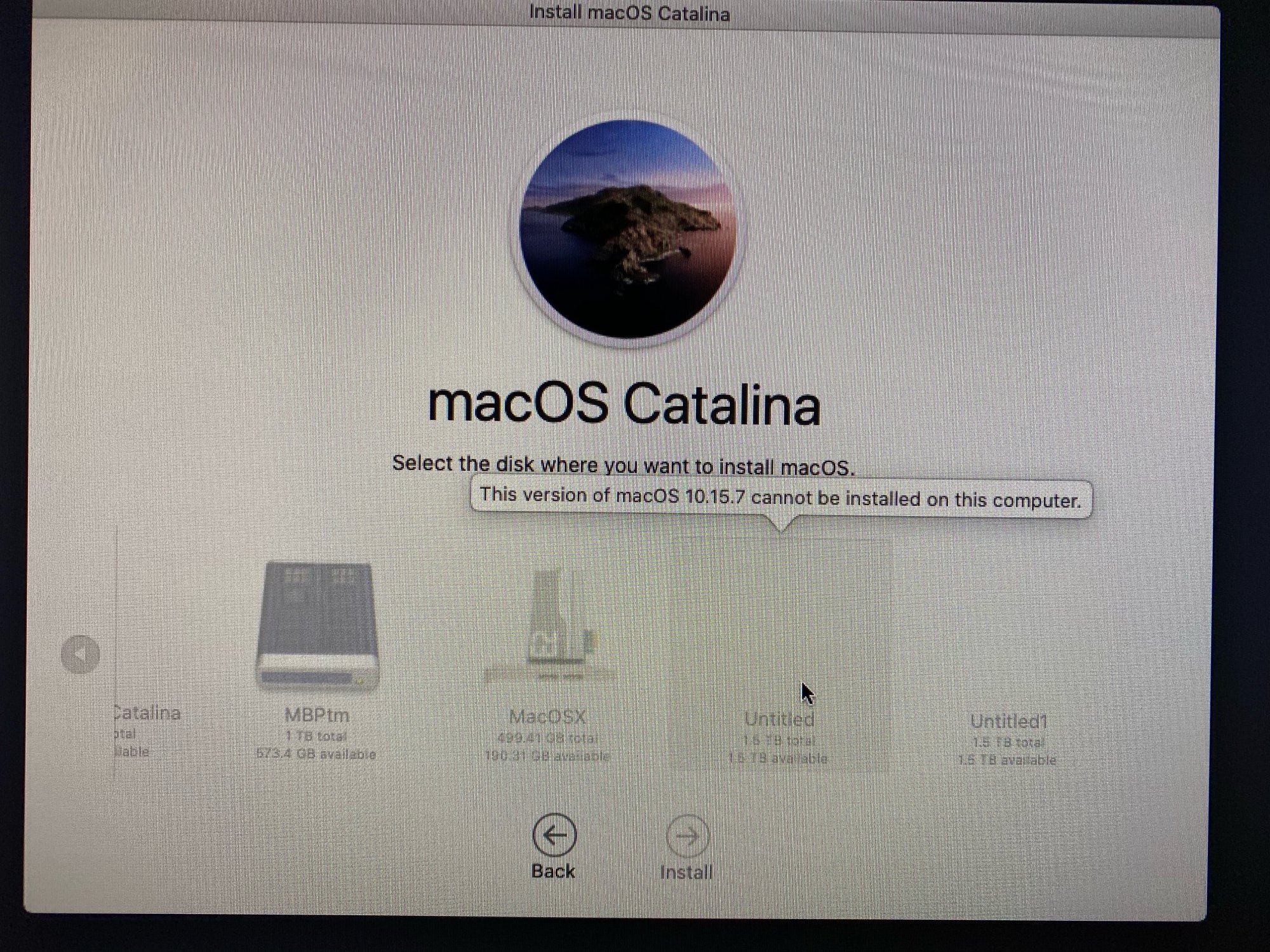

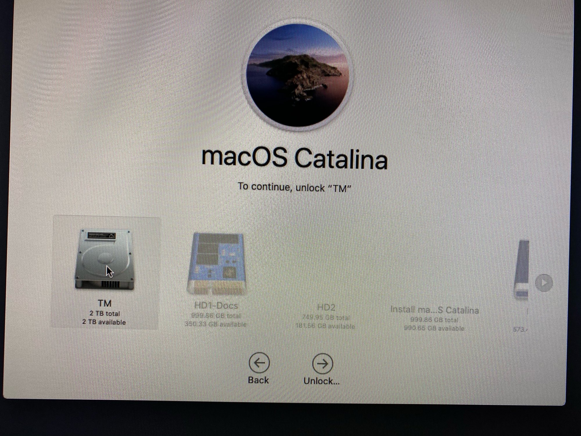

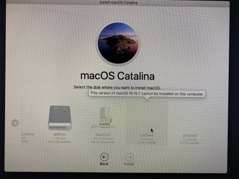

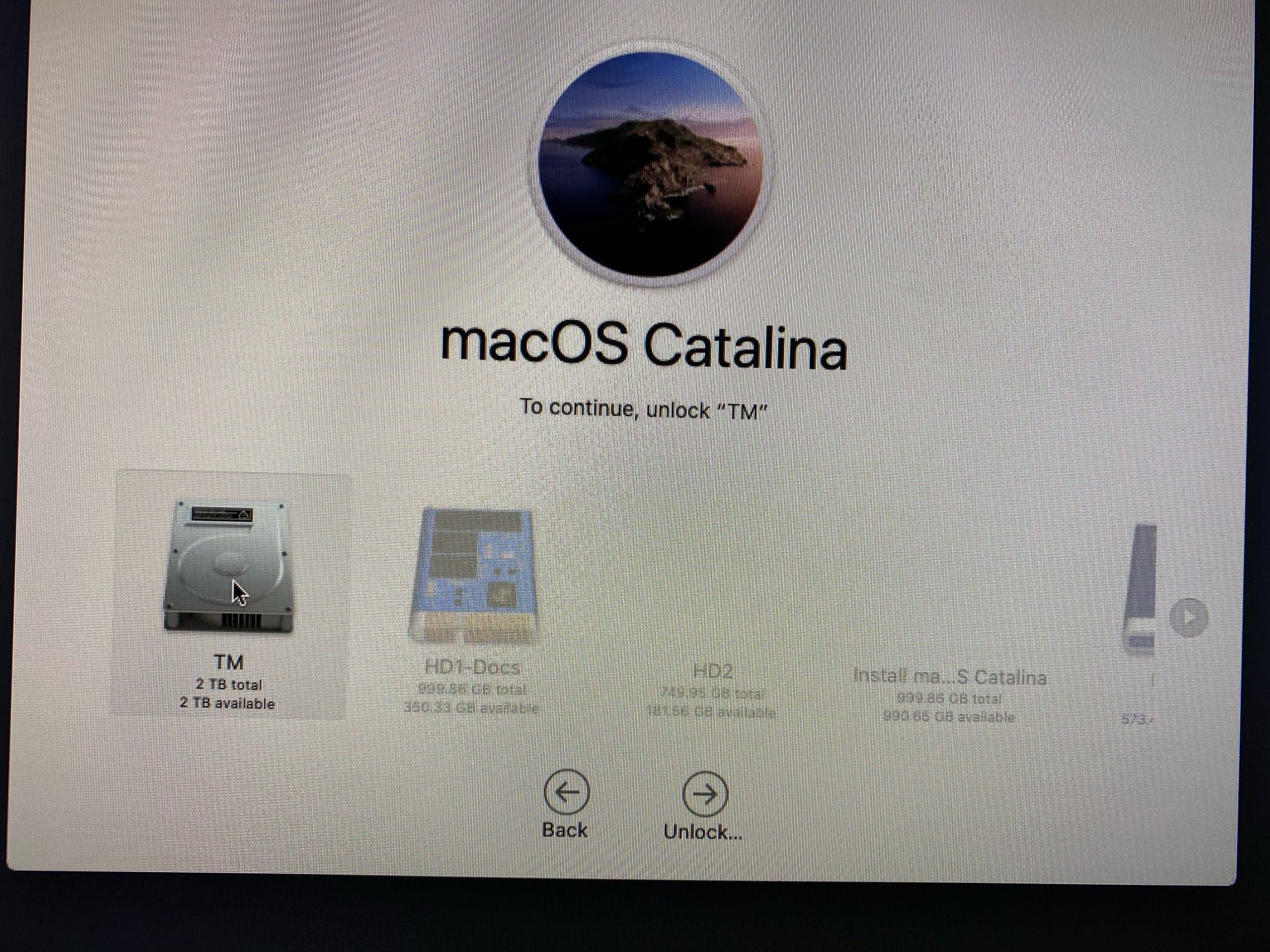

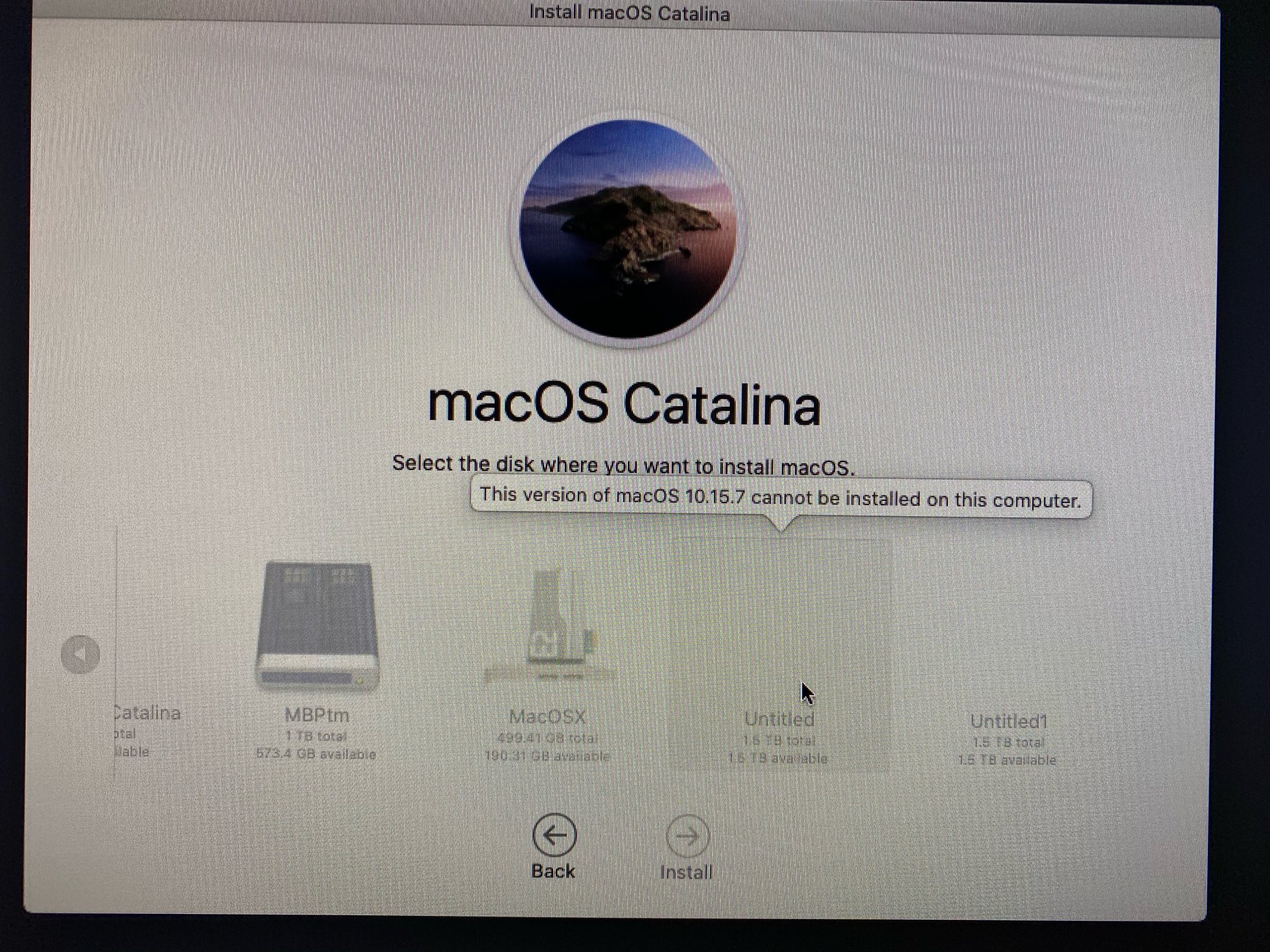

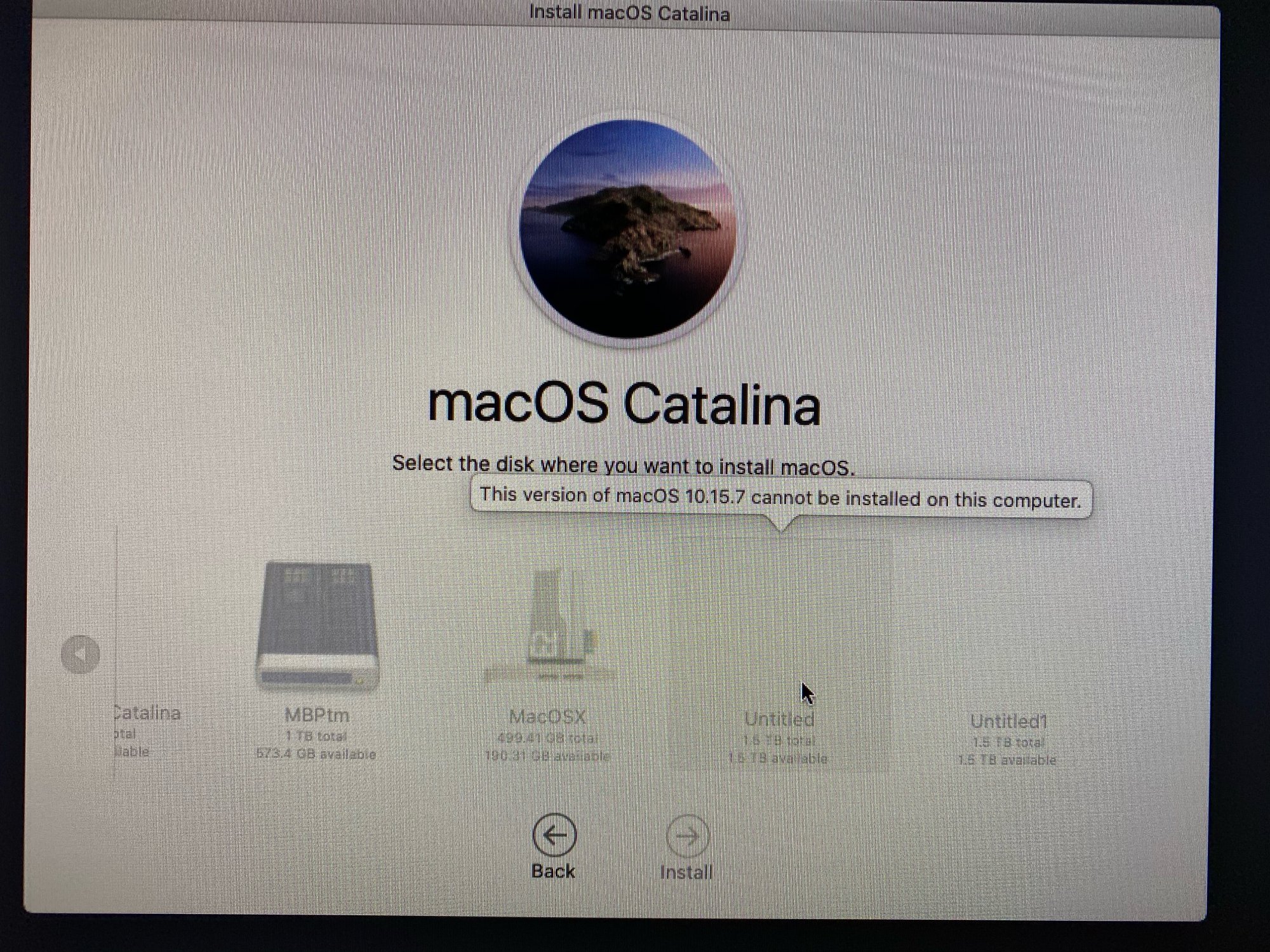

Hello,
Trying to update my cMP 4.1 flashed to 5.1, Everything seems to progress well until I get to the screen to choose the drive to install Catalina on.
All the drives are greyed out and the message "This version of MacOS 10.15.7 cannot be installed on the computer" except my Time Machine which is locked and I don't want to install there anyway.....
I have tried with drives putted out and different drive in - reformatted etc but just can't see what I have done wrong - any help greatly appreciated.
I do have the installer log if that is any help...
Cheers
Study the first message on this thread. For Catalina, you NEED to set the VMM flag.
