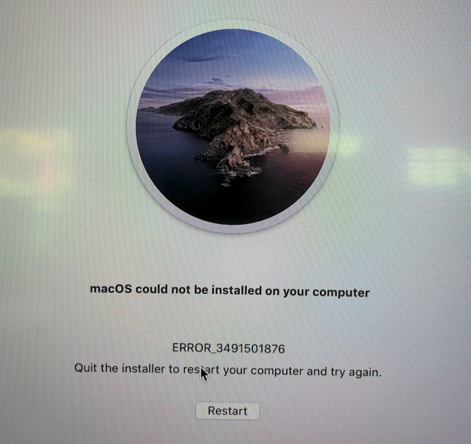

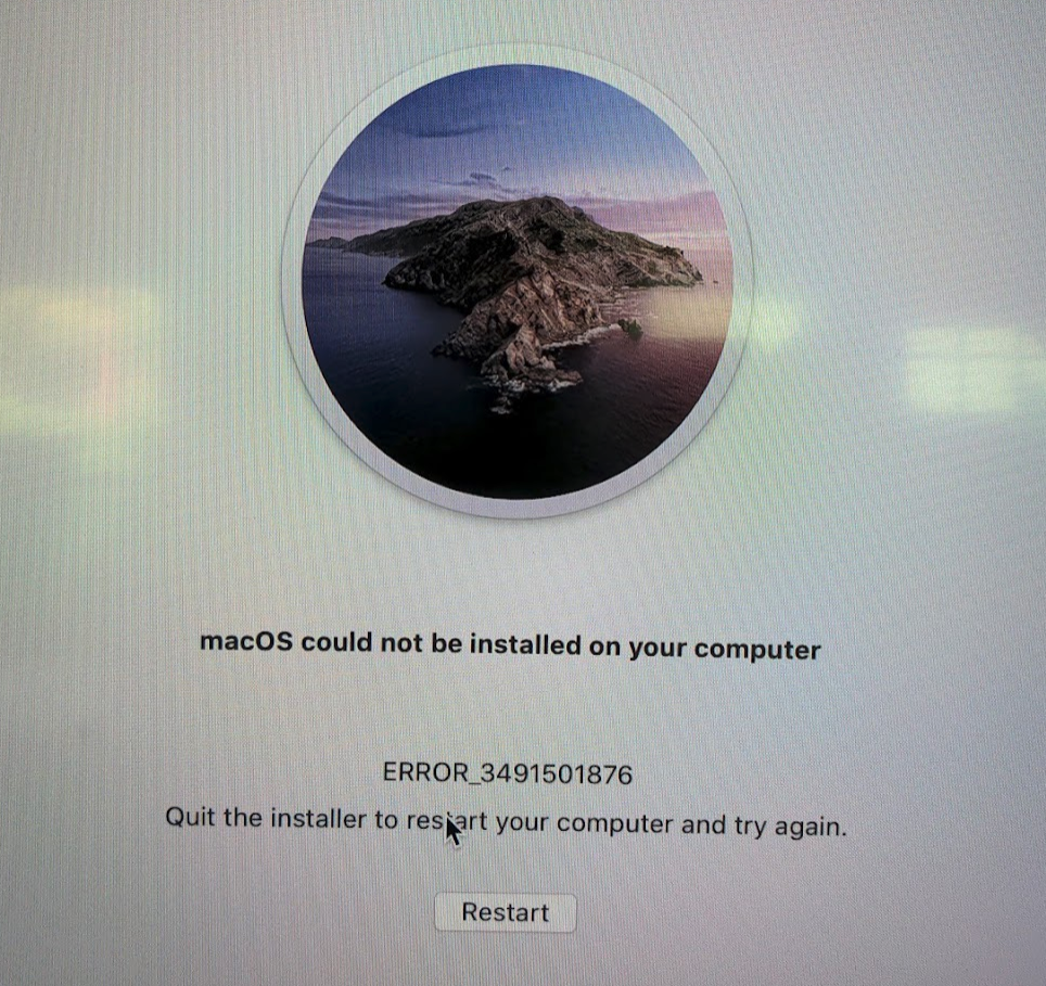

My Mac Pro 5,1 is running Catalina 10.15.7 (19H1030), and the current OpenCore (0.73). With the latest mac/iOS security issue, I wanted to install the Security Update 2021-005, but "check for updates" says I'm up to date. I tried downloading the update, but it reports "This software is not supported on your system." but the log doesn't say why. Are other folks seeing this? How should I proceed with troubleshooting?
Have you enabled the VMM flag in your config.plist (see the 1st post)? You need that to show upgrades in Catalina.
Right! I tried that, and indeed Software Update then prompted me to install that update, which seemed to go fine, then on the reboot after the black screen with apple and progress bar, I got the attached message (ERROR_3491501876). Fortunately, the reboot after that one was fine, but I was again running 19H1030, and am back to the state where it doesn't see the update, and won't let me install it manually. Hmmm.
Well I am running out of suggestions....how are you enabling the -no_compat_check boot argument?
That's a good question - it was a long time ago that I set this up (and didn't take sufficient notes). It's not in my config.plist, but is there when I type `nvram boot-args`:
boot-args -no_compat_check
So I probably did the recovery NVRam procedure at some point. I no longer have Mojave handy, so it's not easy to check that. Thanks for your help, btw! You've given me lots of helpful things to search for and try.
I have OC 0.7.3 installed with Martin's package on my 5,1. I just keep a copy of my OC config with the VMM flag enabled. I swap that, reboot and update. Then I put back the orig OC.conf with the VMM flag disabled so I have graphics acceleration back.
I would try it in your config.plist. The "could not be installed on your computer" makes me think that might be an issue.
...and you are welcome. I'm sorry it hasn't worked yet but so many have helped me that I am happy to try and return the favor.
