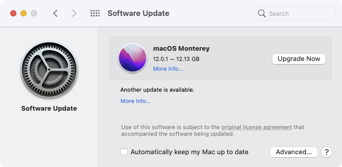

I add as also discussed often with khronokernel that VMM OTA updates should be fixed today by apple to deliver the full Monterey 12.0.1 version.

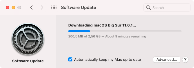

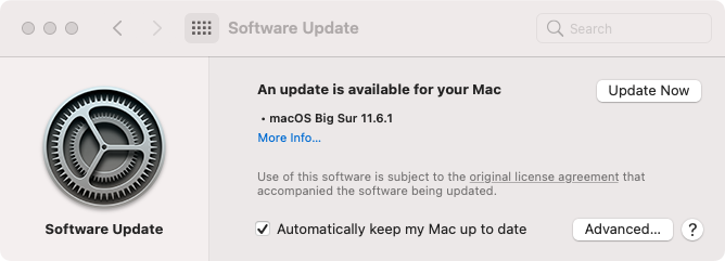

No Monterey yet, but Big Sur 11.6.1 (20G224) is available at Software Updates:

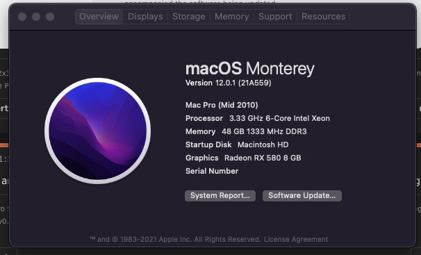

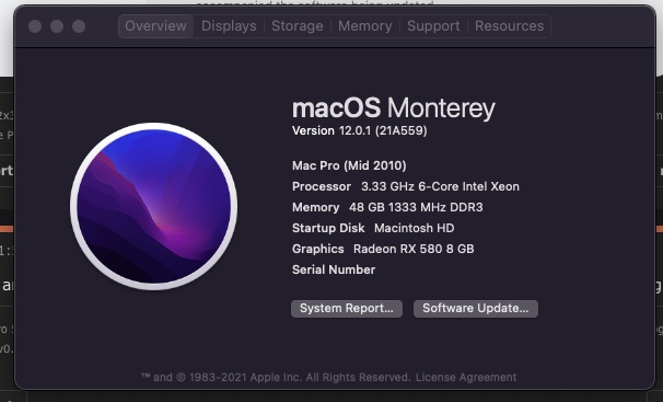

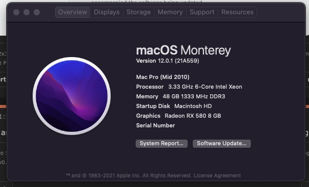

Just finished installing on a 5,1 with @h9826790's 0.7.4 package. It worked flawlessly. The OTA update showed up in Software Update. I hit "Upgrade Now" and just let it do it's thing. Thanks @cdf, @h9826790, and @Syncretic for all the work on this. The Mac Pro 5,1 lives another day!
Is Ethernet broken? I’ve heard mixed reviews that Ethernet is a tossup for some reason. What doesn’t work or is everything fully functional.
Not sure. I legitimately just used @h9826790's package almost completely unchanged. The only thing that I changed was the csr-active stuff but even that shouldn't matter.
