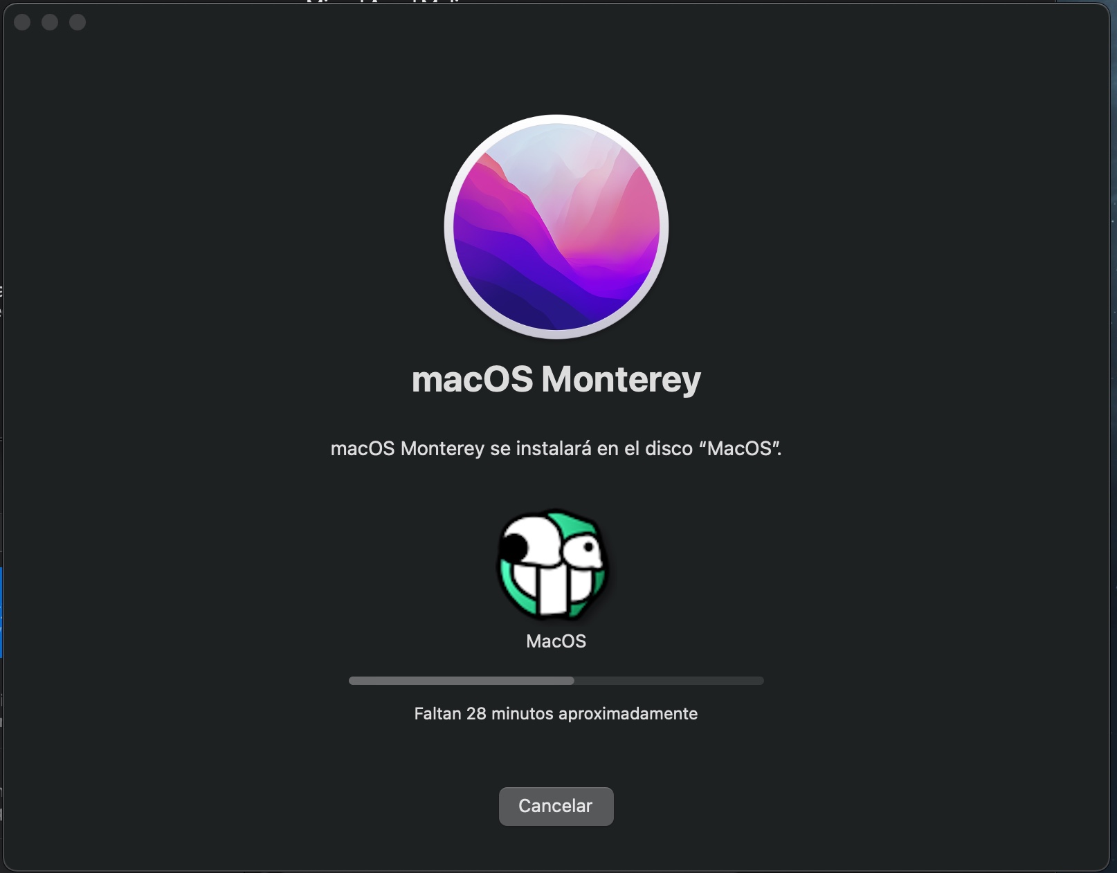

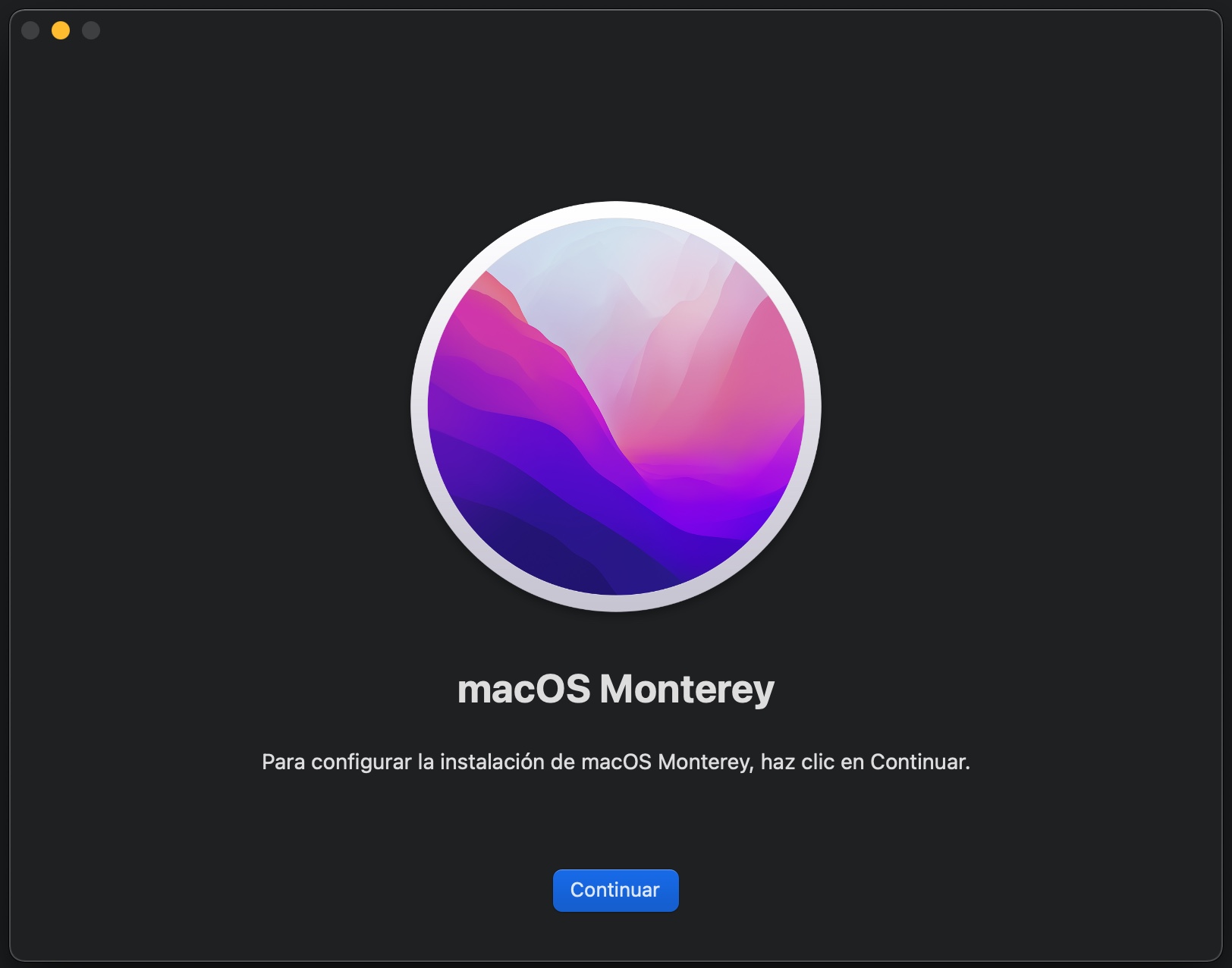

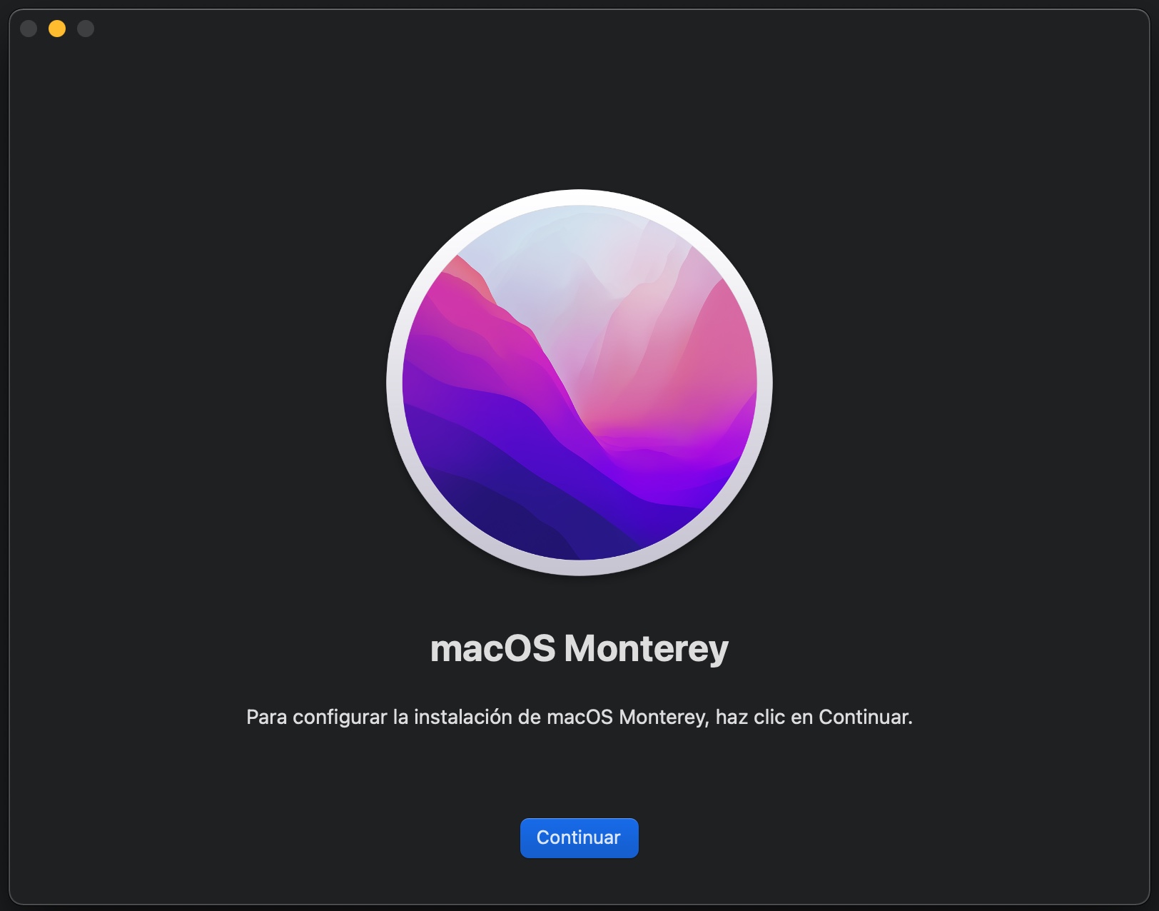

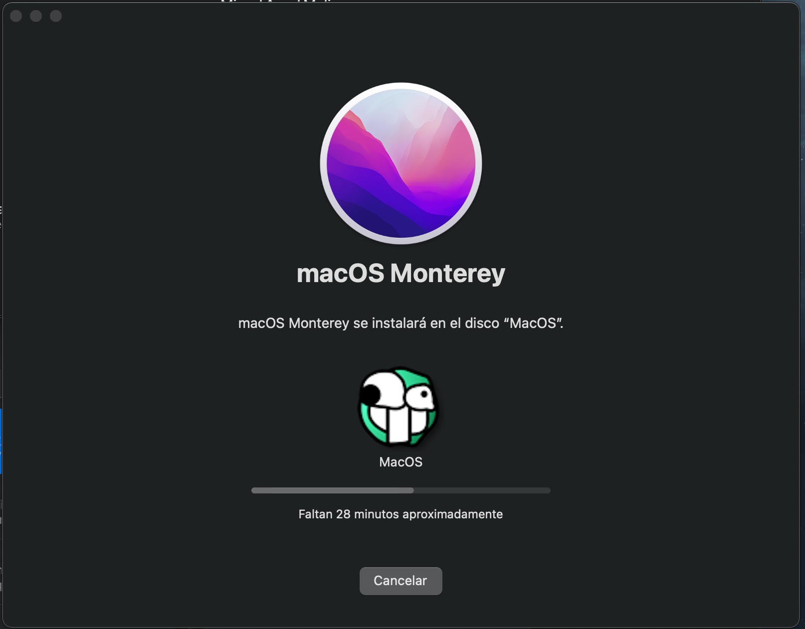

I try to update to Monterey from 11.6.1, but don't install... don't throw any error...
I run the Monterey installer (from system update) and seems working, but when reset 3 times (one of them I can see how many minutes left), BigSur again... This is the 4th try...

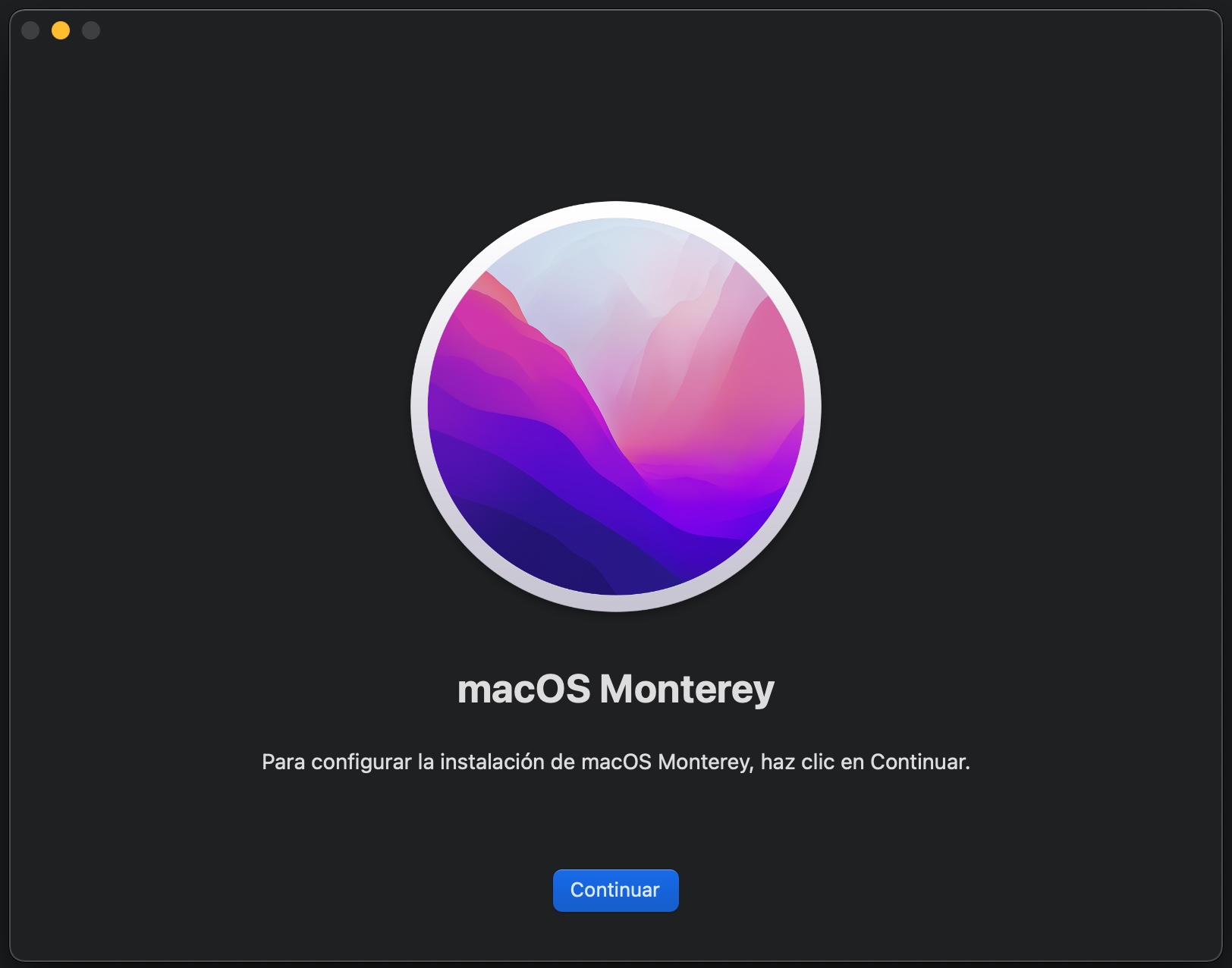

This is the installer...
The first reboot:

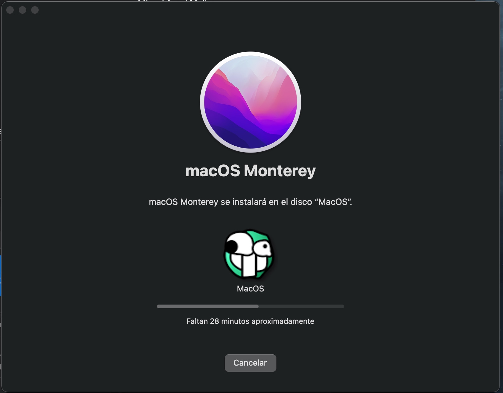

...and back again...
Same shít ... 5 times, always return to BigSur...

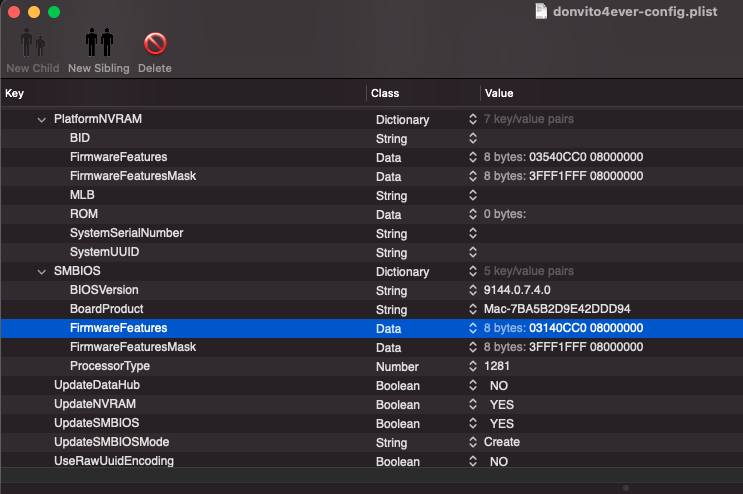

I have OC 0.7.4 from Martin with modified the SMBIOS tags (the attached file)...
What can I do??

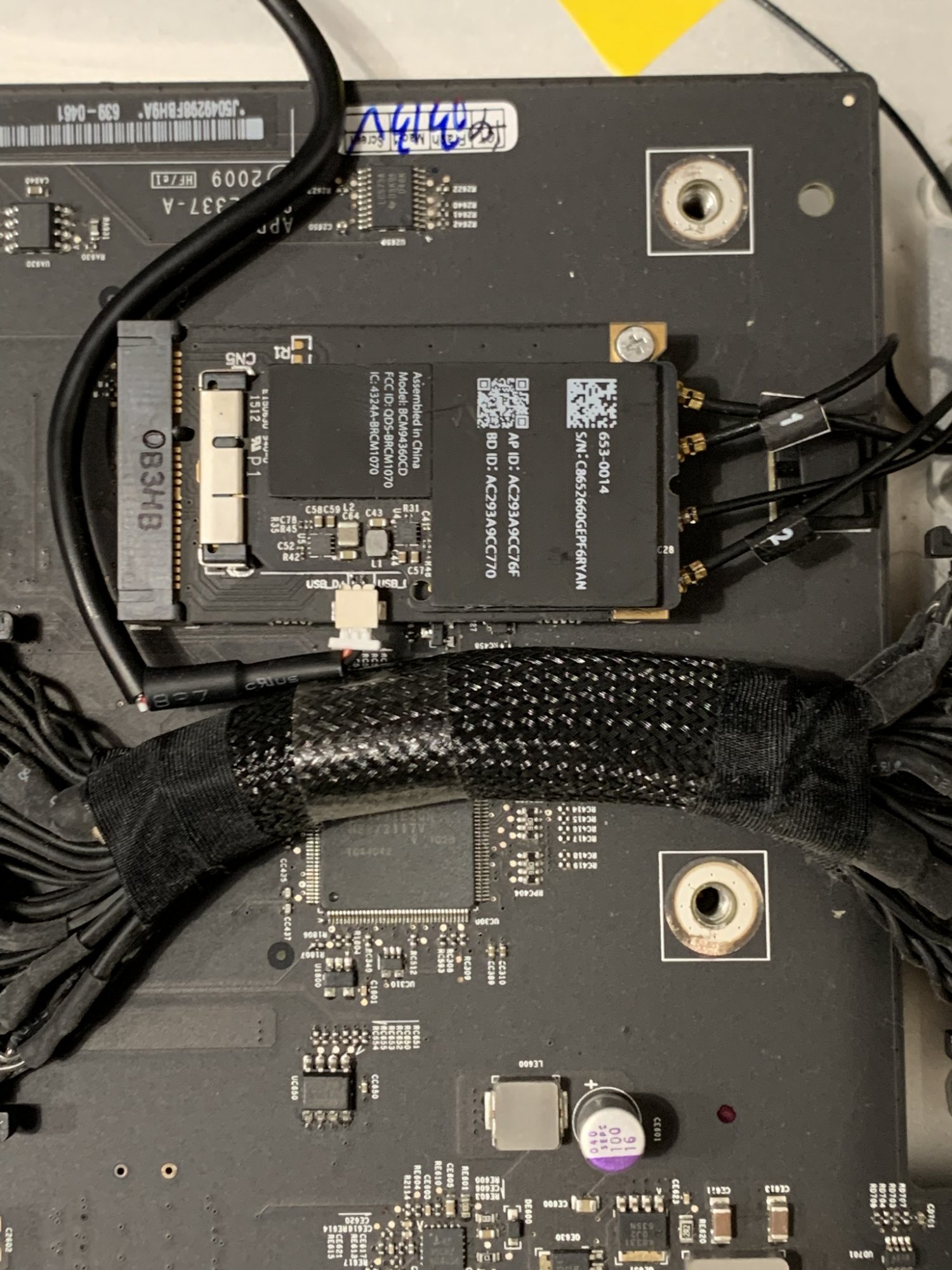

A while back I bought a mini-PCIe adapter and an Apple BCM943602CDPAX (MIMO 3x3, BT4.2). Requires some hardware work but worth the effort as it just works and supported in Big Sur and Monterey. There's no s/w changes. The parts & steps required are described in this post. You can buy a complete kit too but costs significantly more than doing it yourself if you have the skills. Takes 30 minutes max.
My DIY method cost me $40 in total.
Reactions: paalb
Familiarise yourself with how to disassemble the Mac Pro, you need to take out the CPU tray and the frame that holds it in place. The case fan cables are very hard to disconnect from their connectors so do those carefully.
That's the proper way to do it but I was feeling adventurous (i.e. lazy) and managed to install the bluetooth cable and Wifi module without taking out the Frame & Case Fans. It's a bit fiddly & tight for space but can be done.
The first reboot:
What can I do??

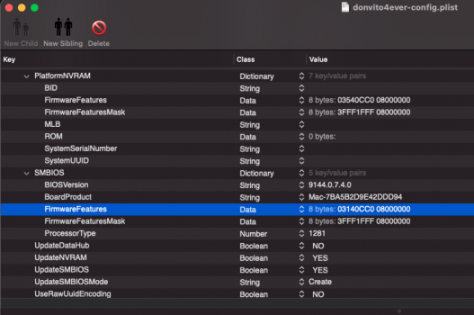

In your config.plist, you have mismatch of FirmwareFeatures in PlatformNVRAM section and SMBIOS section:
That is, the value of FirmwareFeatures in PlatformNVRAM should also be copied to FirmwareFeatures in SMBIOS.
These values are actually correct. The MacPro5,1 has a mismatch between its firmware features in NVRAM and SMBIOS. What we are doing here is preserving the original values and just adding the extra bit for Monterey.
