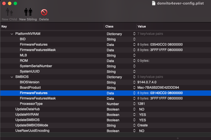

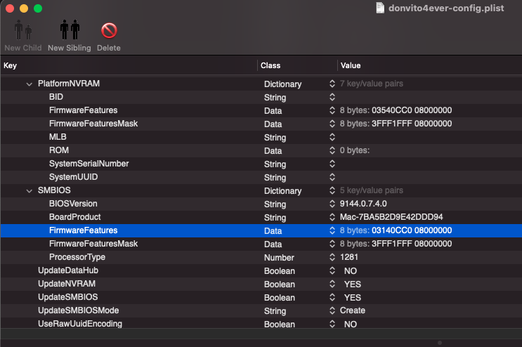

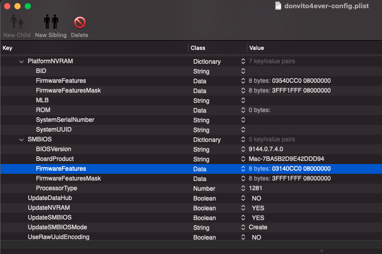

In your config.plist, you have mismatch of FirmwareFeatures in PlatformNVRAM section and SMBIOS section:
That is, the value of FirmwareFeatures in PlatformNVRAM should also be copied to FirmwareFeatures in SMBIOS.
Thanks for your help. I think this helped a bit but I'm still not able to install Monterey. I get to one reboot and sometimes I get the circle w a diagonal line like a do not enter sign, I can reboot then it works until a third of the way then continues to about half way and stops and won't go further - I waited for an hour. When I reboot, it boots into my big sur 11.6.1. No problems other than I was hoping to have Monterey. I attached my config file since at this point Im a bit lost but know I am close.
  • config.plist.zip

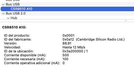

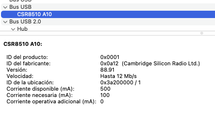

Thanks for all your answers!! Monterey installed successfully BUT.... no Bluetooth... Wifi and Ethernet are perfect, but no Bluetooth...
I have a BT USB Dongle 4.0 that works perfect in BigSur...
When I look in the system info, I see that the USB Dongle is detected, but not recognized as Bluetooth:
I was reset the PRAM 3 times in a row, in terminal "sudo kill -9 $(pgrep bluetoothd)"... nothing works...
Any idea??

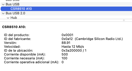

Any idea??
if you still have the stock BT card in your 5,1 it will work just fine. I have 4x 5,1's running 12.0.1 and BT works great!
I'm using OCLP 0.3.1

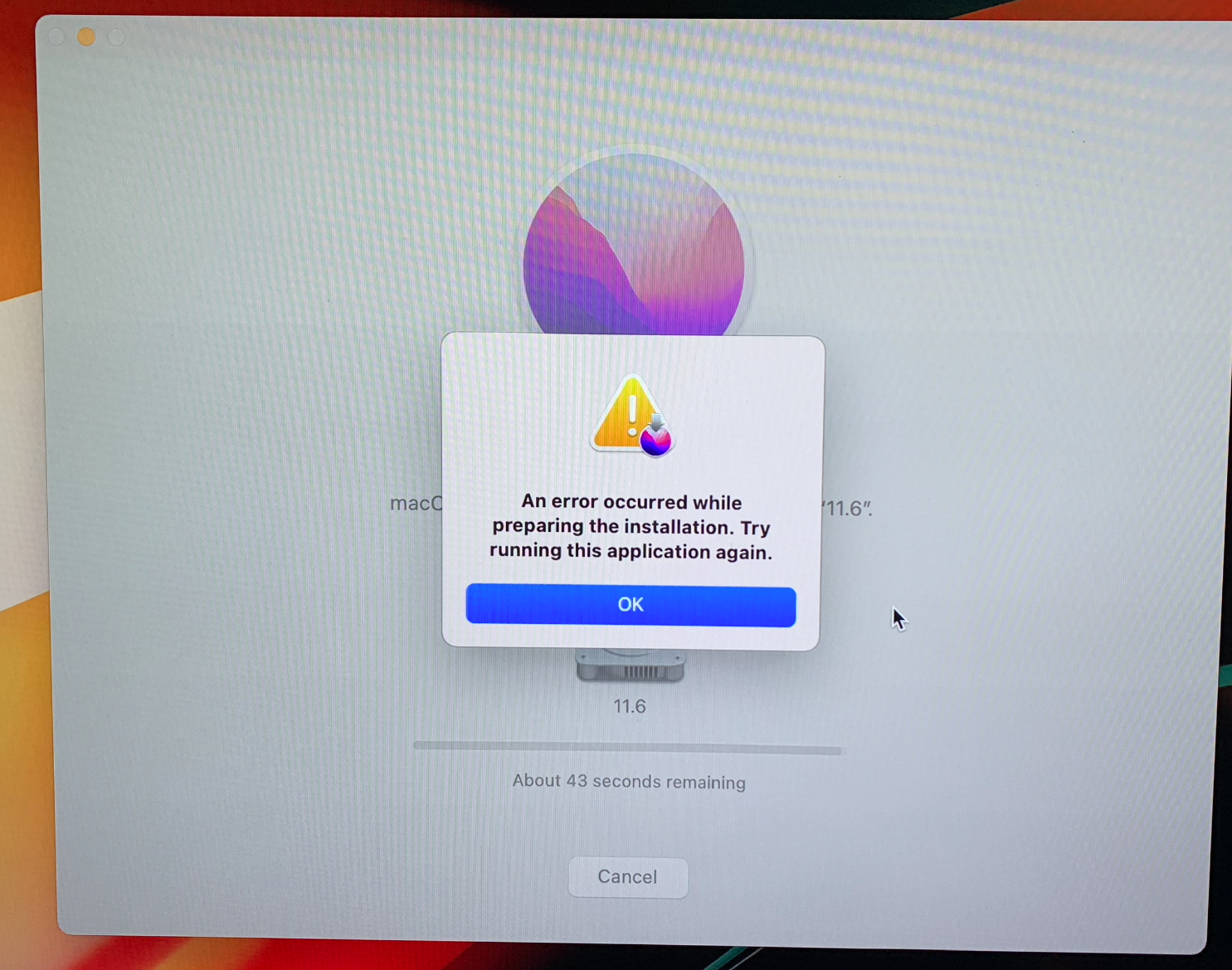

Edit: This is a new one, this was after using your plist file and running the installer again:
After I hit OK the finder disappeared leaving just the desktop background. CMD+OPT+ESC window still worked but was empty, no finder there.
I disabled the BT of the new stock card because I have a lot of BT losses... I installed the newest model with BT 4.0.... but have low signal...
I know that must be a software problem, because I have the same problem in my 2 Mac Pro 5.1...
