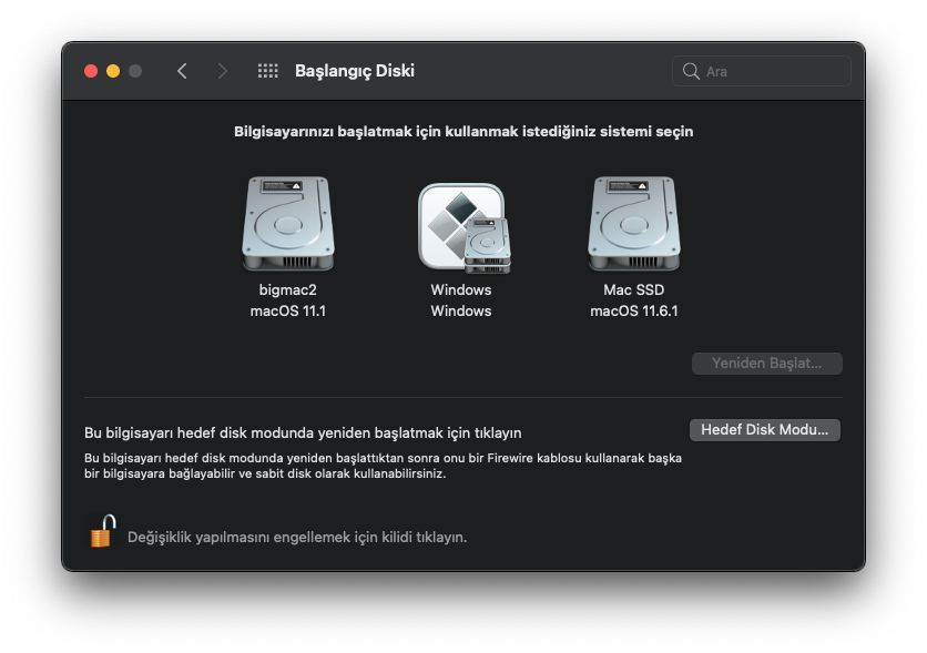

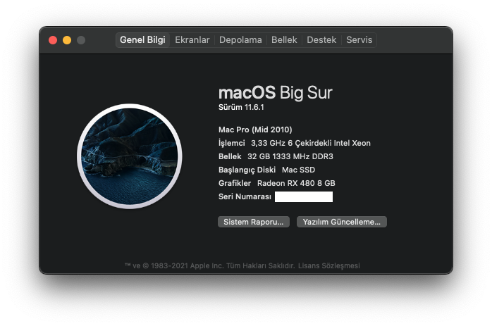

Thank you so much. I'm using Mac and Windows with OpenCore in Mac Pro Mid 2010.

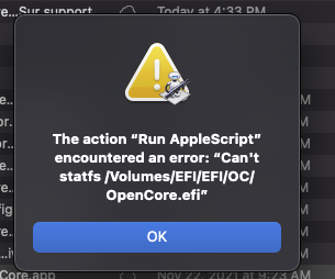

Has anyone seen this error before? This occurred yesterday while trying to bless OC 7.5 after doing a little editing on the config.plist file for my legacy wifi card. Changed two values, saved... and this came up. Machine wouldn't boot - had to roll back to a previous SSD. As a curious aside, the drive wouldn't bless in ANOTHER Mac Pro 5,1 - similar config, even AFTER rolling back to previous Config.plist file. Going to end up reformatting that drive, cloning a known good startup - but wow what a lost afternoon! <bleh>.
OC 7.5 Titan Ridge Yes SSDT version - Mac 5,1 - Big Sur - 12 cores, 96 gigs, all drive sleds removed but startup, all external drives shut down.
