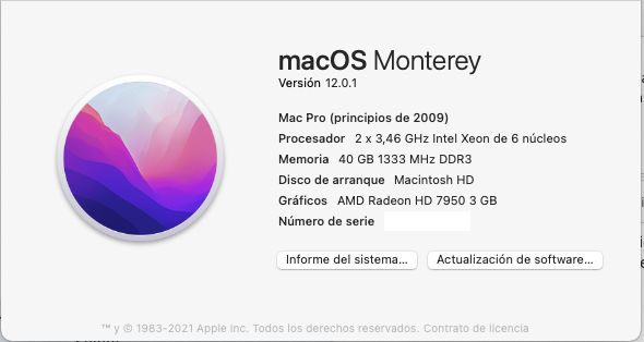

Well, what a coincidence, I can tell you this morning I did just that. Always Catalina, about two years. No big Sur. I just installed Monterey in an SSD via OCLP 0.3.1. Then used Migration Assistant. Been using it some hours and when I saw everything was working fine, cloned it to the NVMe.
So happy. Everything works like a charm.

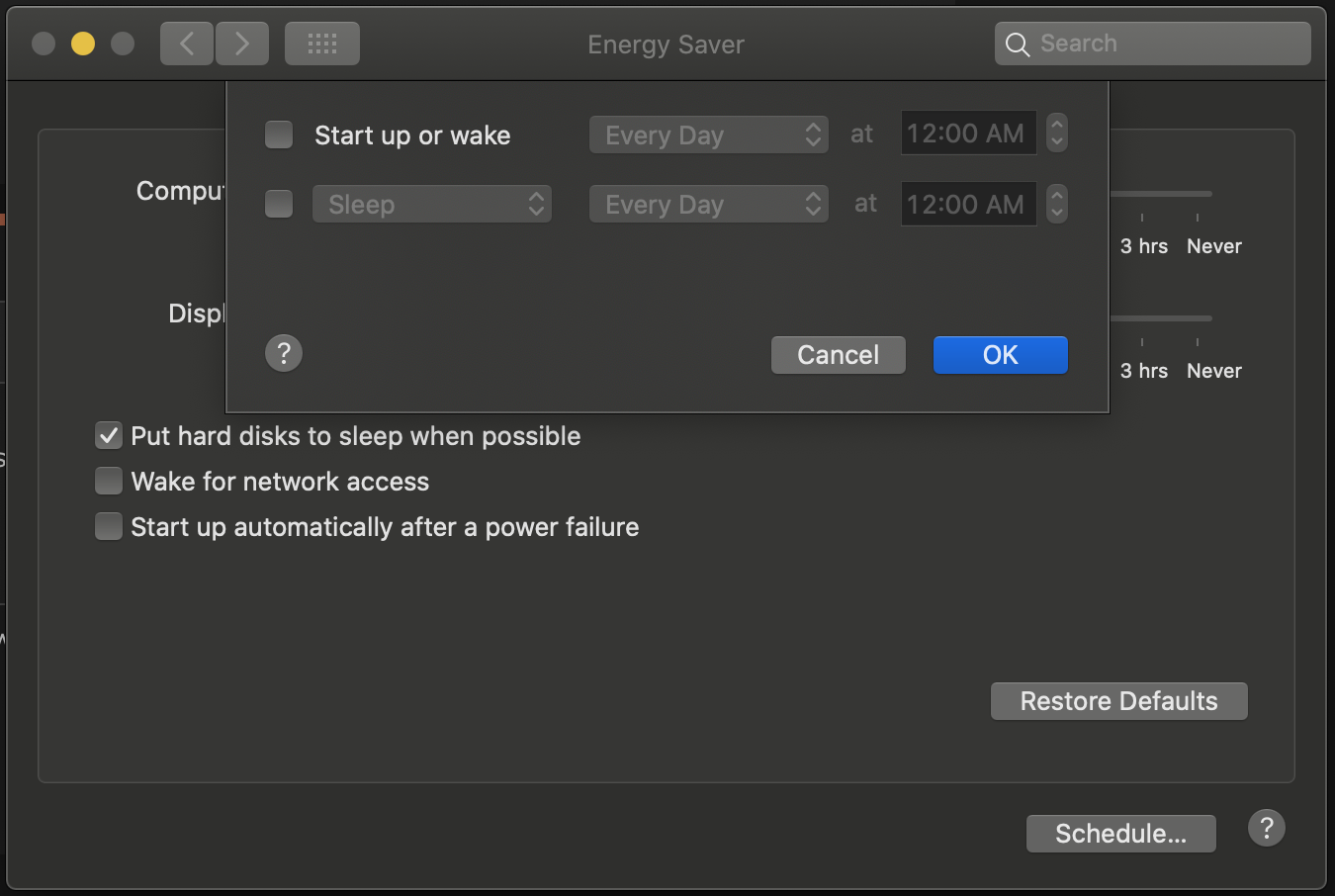

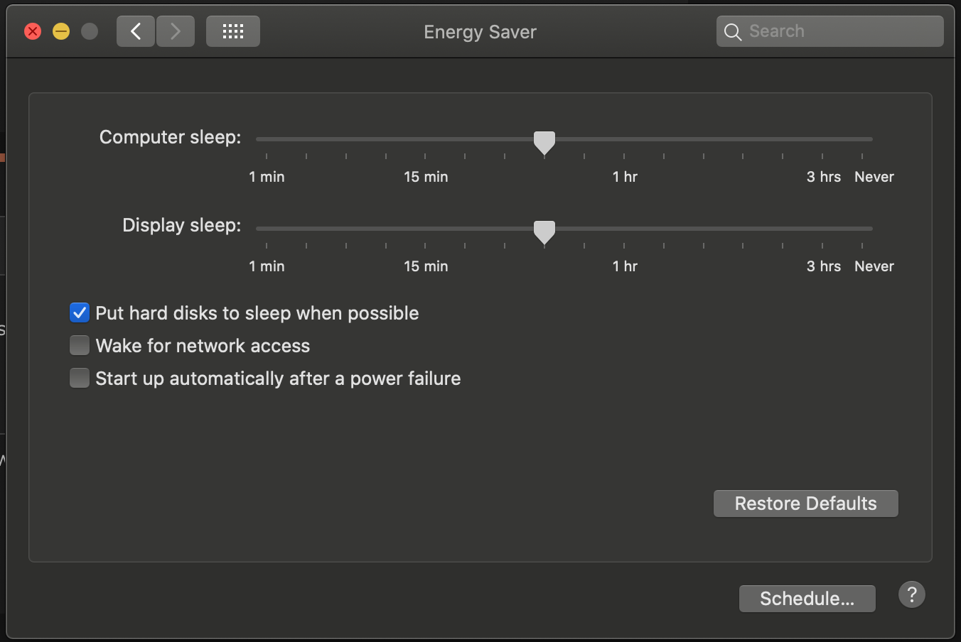

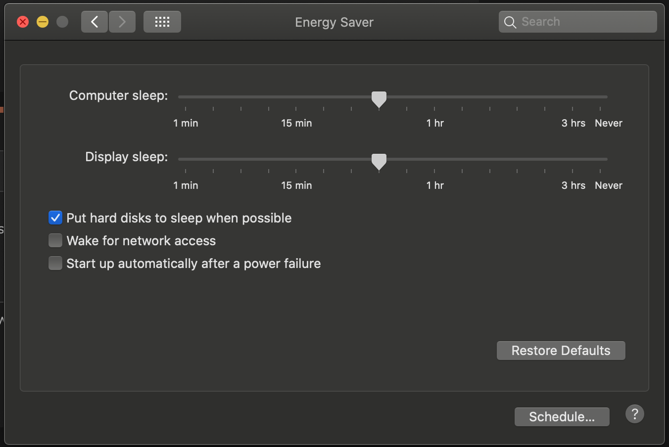

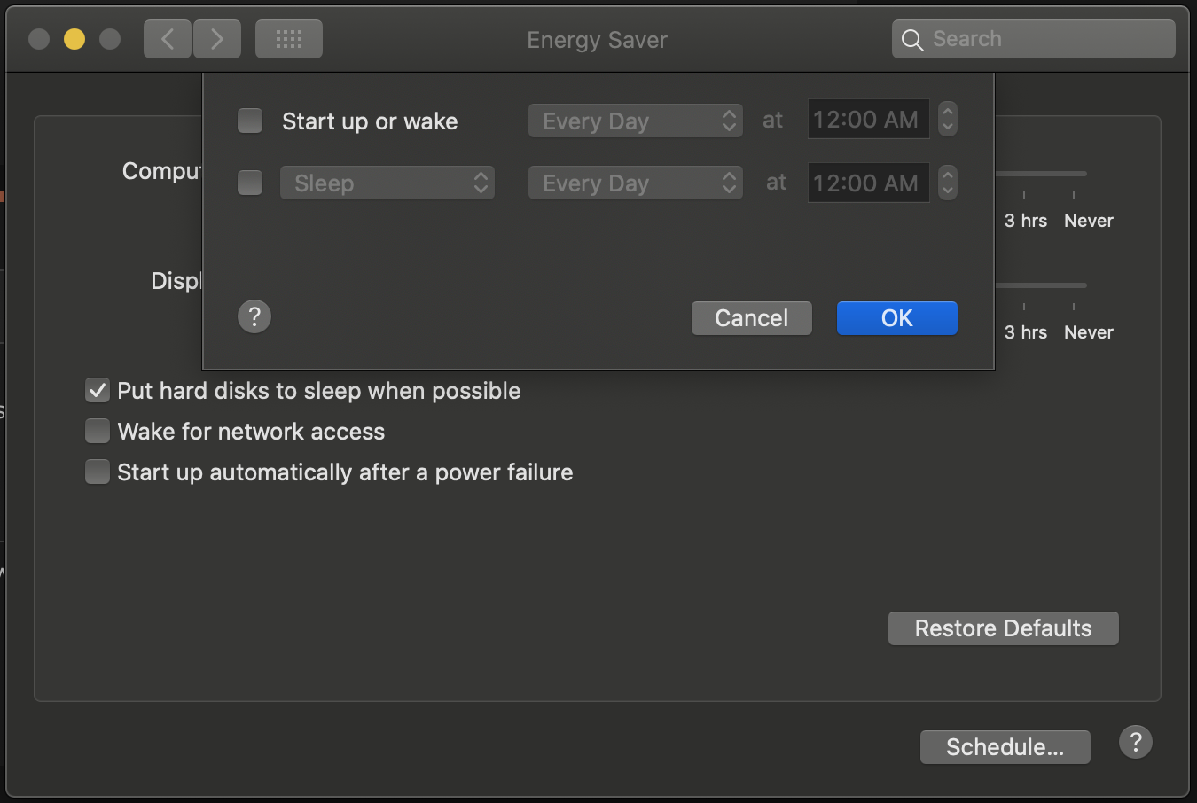

I am encountering a really weird issue and i'm trying to determine where it's Catalina or OC, so first posting here to see if anyone else has gotten it with OpenCore, and if not then I will check in the Catalina subforum:
When I put my cMP to sleep (i.e. at night when I am actually falling asleep), after a while of being in sleep-mode, my machine just randomly reboots (and I assume it has a KP or some sort of crash that triggers it?).
Energy saver looks like this:
Google search shows that this was a common occurrence on MBP's, but since this is NOT an MBP, there is no "powernap" for me to disable within energy saver, so those threads are pointless.
I'm not sure what to look for in Console, so still researching that front, but just wanted to ask if anyone else has encountered anything like this on their cMP running OC?
I have a feeling it's related more to the OS, but just want to be sure if there is something in my config.plist that could be causing it? (I doubt it since I'm using Martin's pacakge)

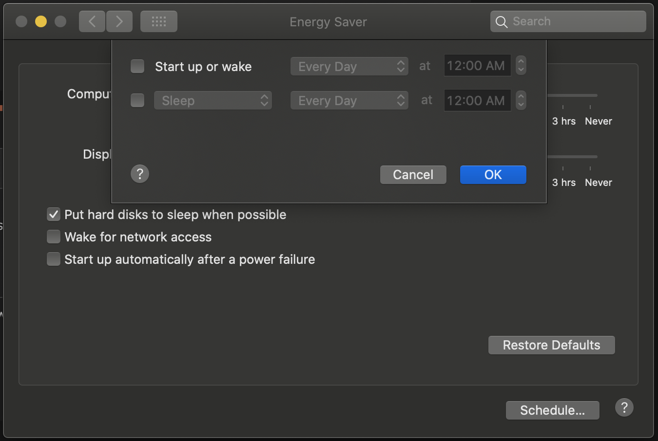

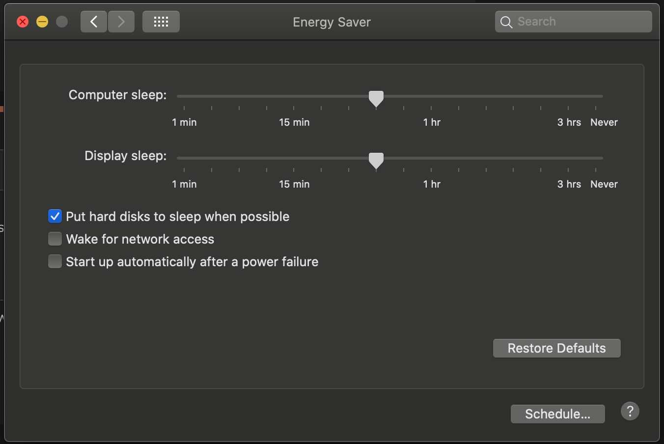

Did you check the BR2032 RTC battery voltage? It's the first thing to check with sleep problems.
