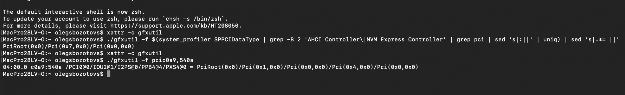

Sure. First carry out steps 1 and 2 of Internal PCIe drives. Then
  • Open System Information and find the name of your disk in the PCI section
    Look for "AHCI Controller" or "NVM Express Controller." You should see something like pci0000,0000.
  • In terminal, enter ./gfxutil -f pci0000,0000. Make sure to replace pci0000,0000 with the actual name of your disk.
This should return the desired path.
I'd like to understand why the command isn't working for you, though. Please enter system_profiler SPPCIDataType in Terminal, and post the output. Is your disk listed there? If so, which one is it? Thanks!
thank You, path for slot 4 I receive only by this old method. two files with my data attached (as to pci1002,7314:- this is inner NAVI 10 USB bus of my RadeonPro W5700- this unknown controller as I understand reduces my cpu performance- i have to make it work by giving right parameters or disable it in opencore , but don't know how yet)

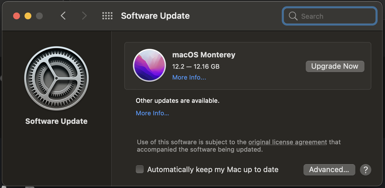

I just did a supposedly seamless update to 12.2 (countdowns etc) but seems after finally booting it didn't update at all! Still on 12.1 with update showing in System Prefs. Anyone have idea what this would be the result of?
TIA
This happens when the computer fails to boot from the update volume and starts from the regular main volume instead. Re-download the update and make sure to interrupt the boot process, select the "other" Macintosh HD from OC bootpicker and wait for the update to complete. Some restarts will apply.

Thanks. The Macintosh HD was still there at boot but selecting it just aborts every time about 20% in (12 in a row and I gave up). Tried restarting the update in control panel. Same problem just much longer to happen (doing all the xx minutes remaining). No boot.
Changed VMM to on. Nothing boots anymore, not even the old Monterey 12.1. Tried my Mojave drive to boot but after selecting it just goes black and comes back to bootpicker. Eventually had an old big sur drive booted (USB 2.0!) so I could turn off VMM and get back to where I was.
Unfortunately I have absolutely no idea why this is happening (OC is becoming a bit complex for me) so going to have top stay with 12.1 for now. I am going to try one of Martin Lo's OC packages and see if that helps to boot 'Macintosh HD'
Edit: OK Martin's OC 077 ('vanilla') boots back into old 12.1 install without problem but no go on the update. Macintosh HD remains in bootpicker but that will just end in a boot loop if selected.
Side effect - Martin's OC config will not recognise updates - I tried following his vide for updating Catalina/Monterey (VMM and updateSMBIOS = false) but SysPrefs says I'm up to date on 12.1
Unfortunately not a seamless update for me.
Yes. I updated two days ago without any issue. If your config is up-to-date (with SecureBootModel, BoardProduct in DataHub, FirmwareFeatures in NVRAM,...), it's just a matter of upgrading like on a supported Mac.
What about VMM? Continue to leave it blank, or is that still needed as well?
The guide mentions it's needed for OTA updates (and actually how I got from Mojave>Big Sur on this drive), but that was a while back, when 0.7.4 was the newest version of OC.
