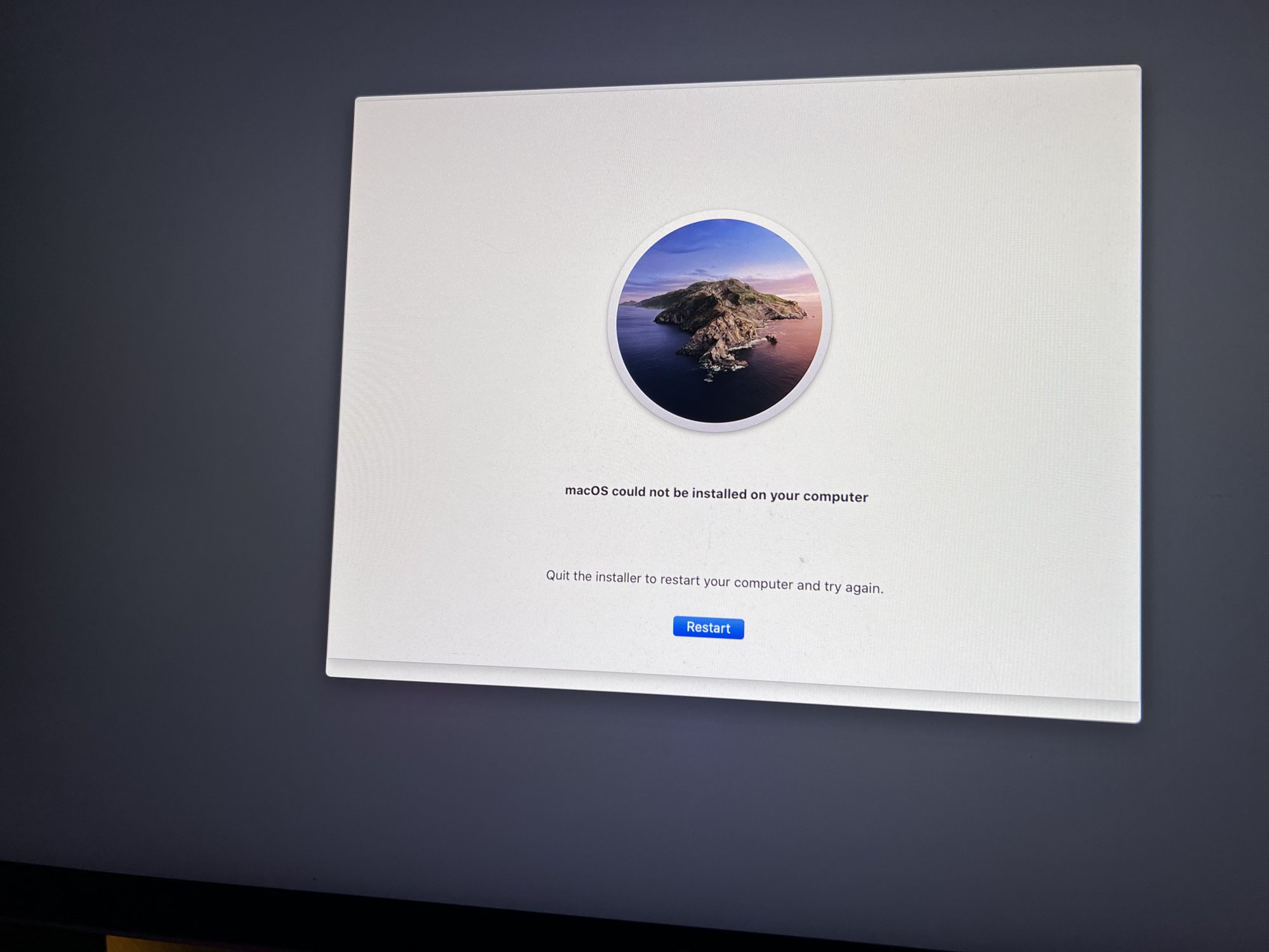

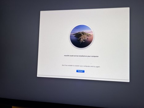

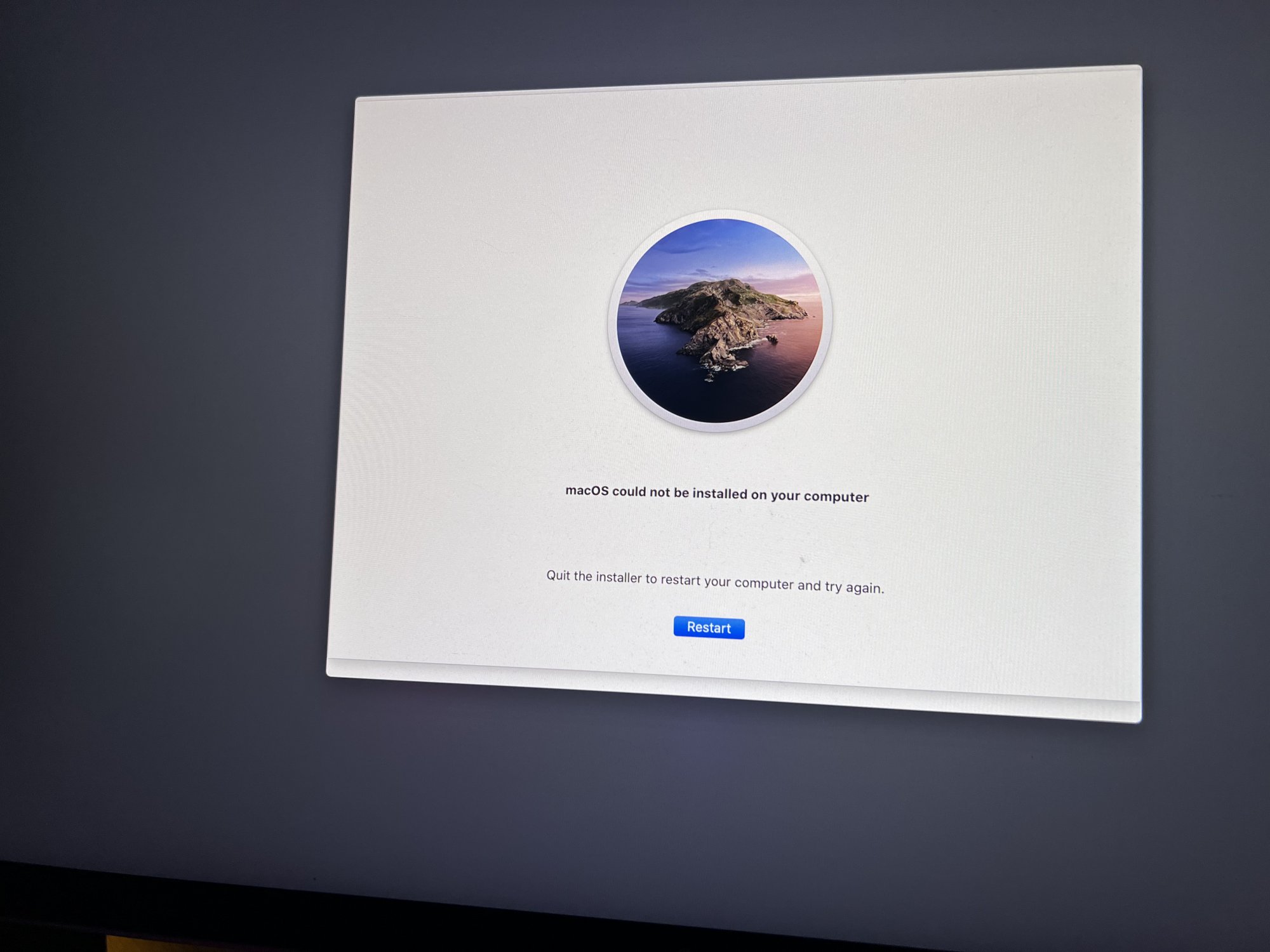

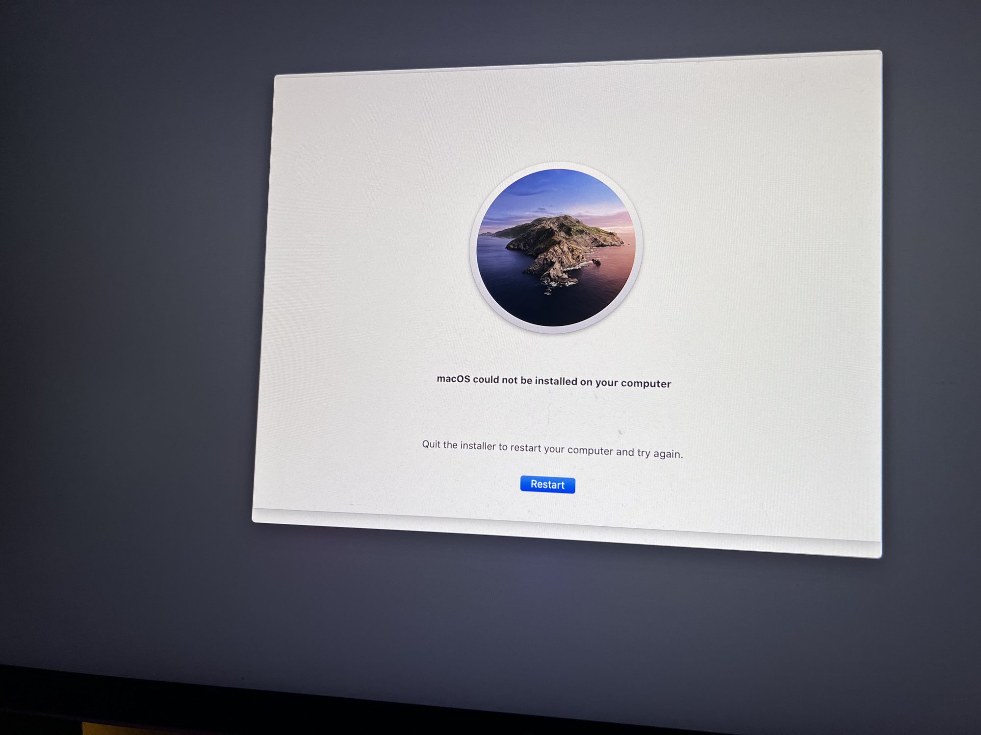

At the moment, Mojave because it crashes each time I upgrade, but that turns out to be an issue with the card too.
About to test a fix, hopefully the issue will go away with the OS upgrade.
About to text a fix, hopefully the issue will go away with the OS upgrade.
Mojave knows nothing about your GPU, that's the reason for the 'Display 31Mb' with AboutMyMac. You only have a display working right now because the EFI driver fallback / OC support of GOP cards.

MacOS Could Not Be Installed On Your Computer
Very frustrated with this build, clean install of Opencore on a MacPro 4,1 with hacked firmware and a RX580. No matter what OS I've tried to install on it, I end up with the above message, and I've tried El Cap to Catalina along with the Catalina Patcher build.
Googling the error provides an endless stream of clickbait listicles most of which claim the issue is the system date being incorrect, the clock is correct.
Any thoughts appreciated.
