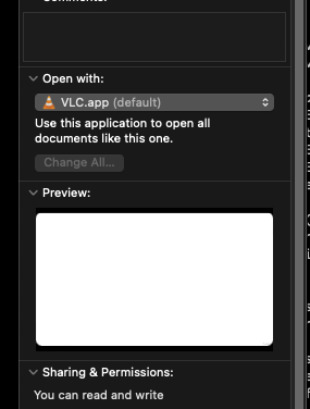

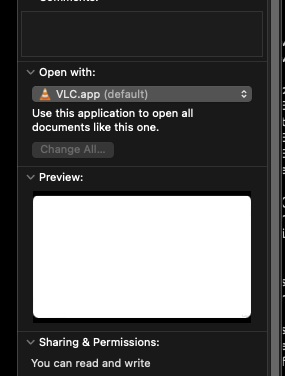

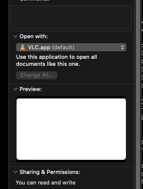

Is this in your browser - or are you using VLC or......
What file types?
If you right click on a file that won't play and then go GET INFO what is the Open with?
