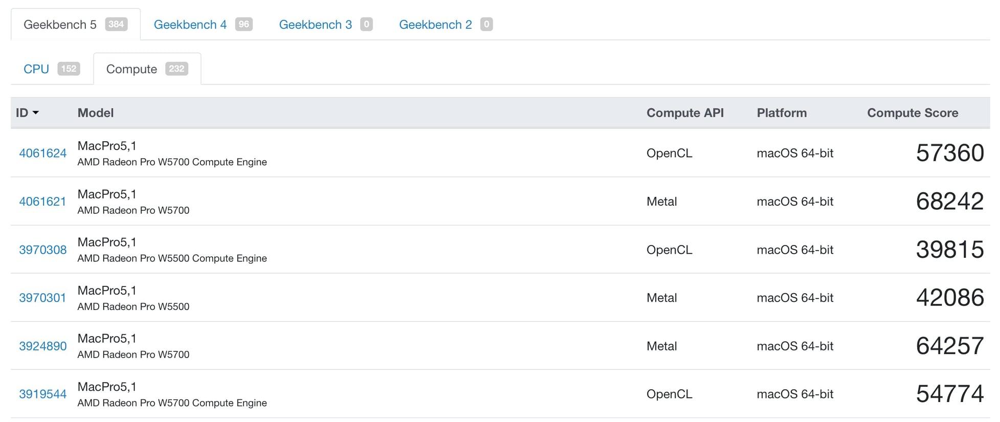

Thank You. I, just updated to OC version 0.7.7, and test my video card RadeonPro W5700 in geekbench5. It has significantly increased the score. the new Lilu and Whatewergreen is likely to work better under Monterey. below are new and the previous test results for RadeonPro W5500 and W5700. cMP dual Xeon5680, 96Gb RAM
Reactions: prefuse07 and cdf

Thank You. I, just updated to OC version 0.7.7, and test my video card RadeonPro W5700 in geekbench5. It has significantly increased the score. the new Lilu and Whatewergreen is likely to work better under Monterey. below are new and the previous test results for RadeonPro W5500 and W5700. cMP dual Xeon5680, 96Gb RAMView attachment 1942414
What were your previous scores Gustav?
