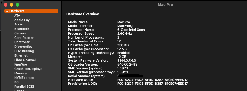

Hello friends... Happy new year!! I'm stuck since last year!! 🙂o)
I'm trying to update my MacPro 5.1, with Nvidia GT 710 2GB, this weekend. After spend a lot of time with "a required firmware could not be installed". I believe the AAAAAAAAAAAAACAAAAAAA== to AAAAAAAAAAAAAAAAAAAAA== did the trick.. (I don't know if I'm right... Am I? -- I did the Monterey install to a HDD, migrate all the data from a SSD, then trying -with no sucess- install Monterey to the SSD, and getting the firmware issue again!)

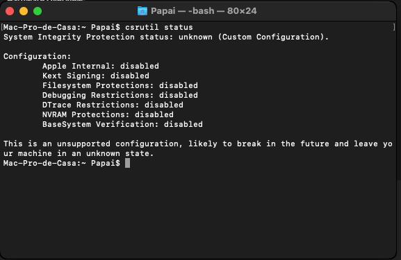

After that, I'm stuck at SIP disable, to after that patch the wifi/bt and Nvidia card. (I don't mind to buy a better PCI board to wifi/bt, by the way...)
So, reboot to Recovery, did the csrutil disable, without the authenticated-root (I can't do it... not abled).
Then, the status is:

I'll address the first two questions:
  1. Either enable the VMM flag (easiest) or update the firmware features with SecureBootModel set to default (better for future updates). All the details are provided in Post #1.
  2. This is the hardwired SIP problem. See Post #8,577.

Hey @cdf, it worked! The funny part is I was trying to do a lot of the #8,577 post, but, with a lot of insecure feelings. Now, everything is working perfect, but the wifi/bt.
Thanks a lot!!

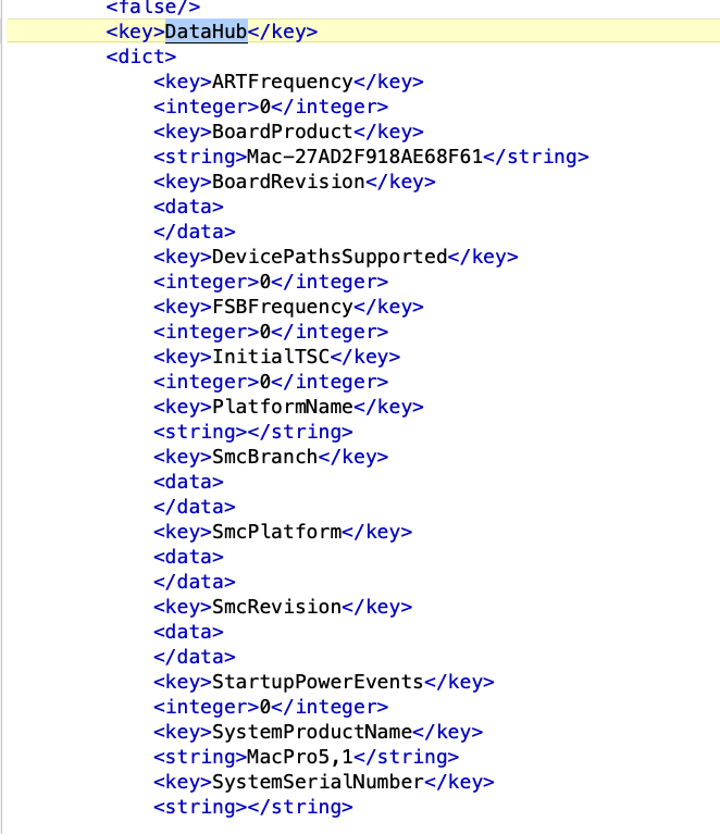

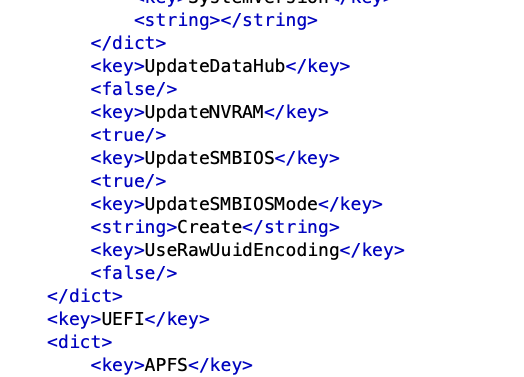

I use OCLP and all looks OK in my config.plist EXCEPT UpdateDataHub is set to FALSE so I guess I need to set it to TRUE ?
Yes, provided that DataHub is not set to true under ProtocolOverrides. Also, you can leave SystemProductName empty, because it's an existing OEM property.

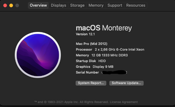

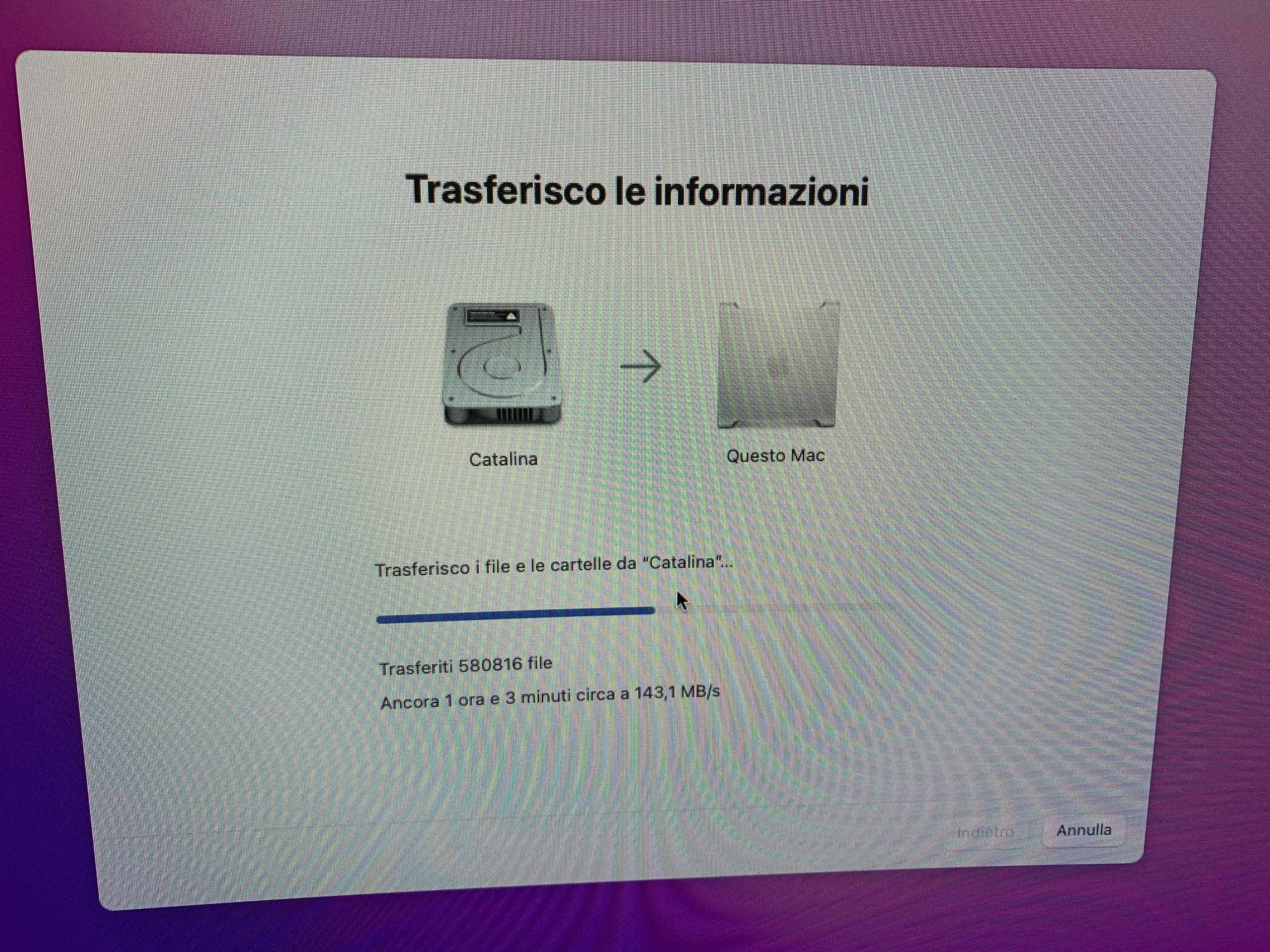

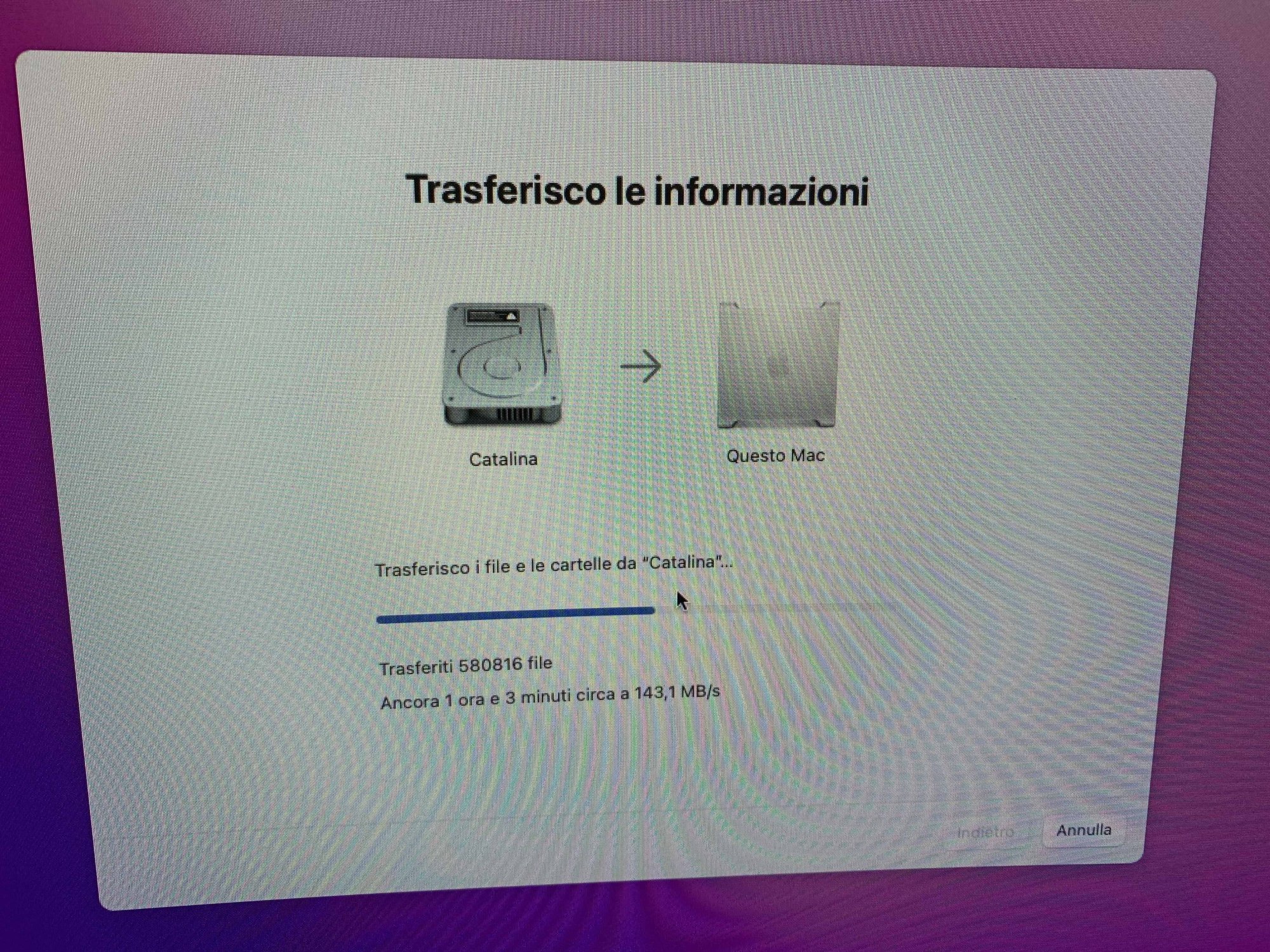

I thought about sharing my experience.
I used method 1 to clean install Monterey 12.1 on a Macpro4,1 with updated Bluetooth and Wifi and it worked absolutely flawless. Everything worked without a hitch and I could copy my data from my Catalina install.
The funny thing is that Apple knows we are installing Monterey on CMPs, otherwise why would they spend time into inserting the right MacPro picture in the code? Even the fix for the race condition ( surplus ) is kind of weird... Hopefully they won't go back at next update.
@cdf : would it make sense to switch the configuration to method 2 now ?
