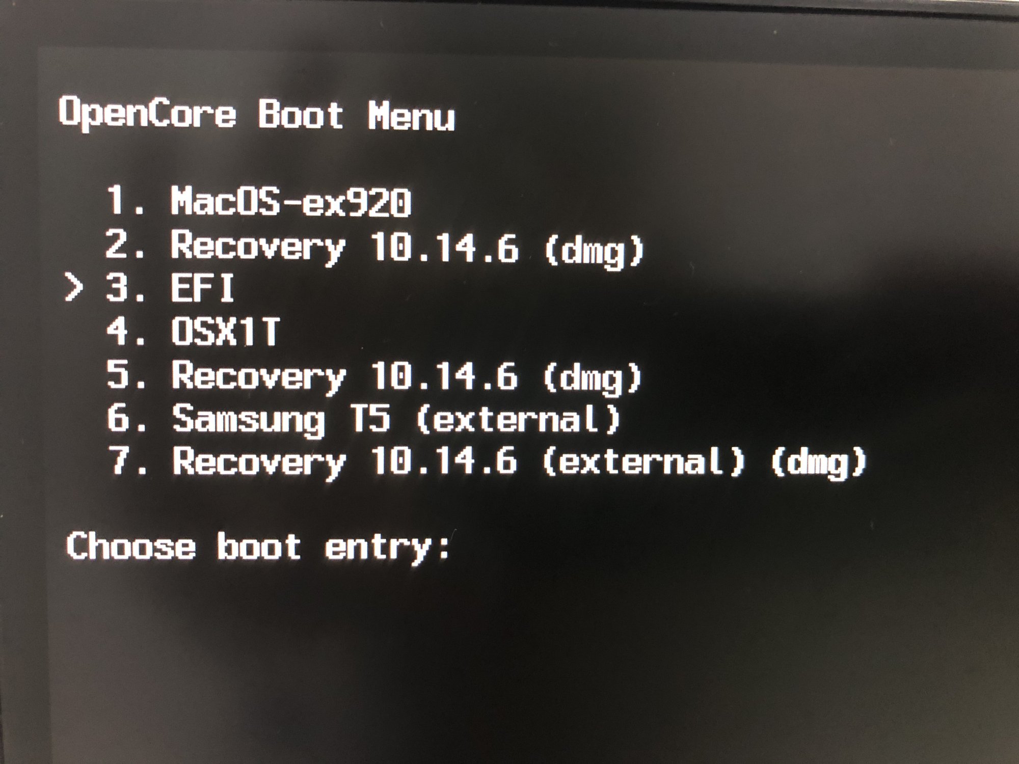

From the manual:
"2. BlessOverride Type: plist array Description: Add custom scanning paths through bless model. Designed to be filled with plist string entries containing absolute UEFI paths to customised bootloaders, for example, \EFI\Microsoft\Boot\bootmgfw.efi for Microsoft bootloader. This allows unusual boot paths to be automaticlly discovered by the boot picker. Designwise they are equivalent to predefined blessed path, such as \System\Library\CoreServices\boot.efi, but unlike predefined bless paths they have highest priority"
So try modifying this:
Code:
With your path of refindx64.efi
Is this correct @vit9696 ?

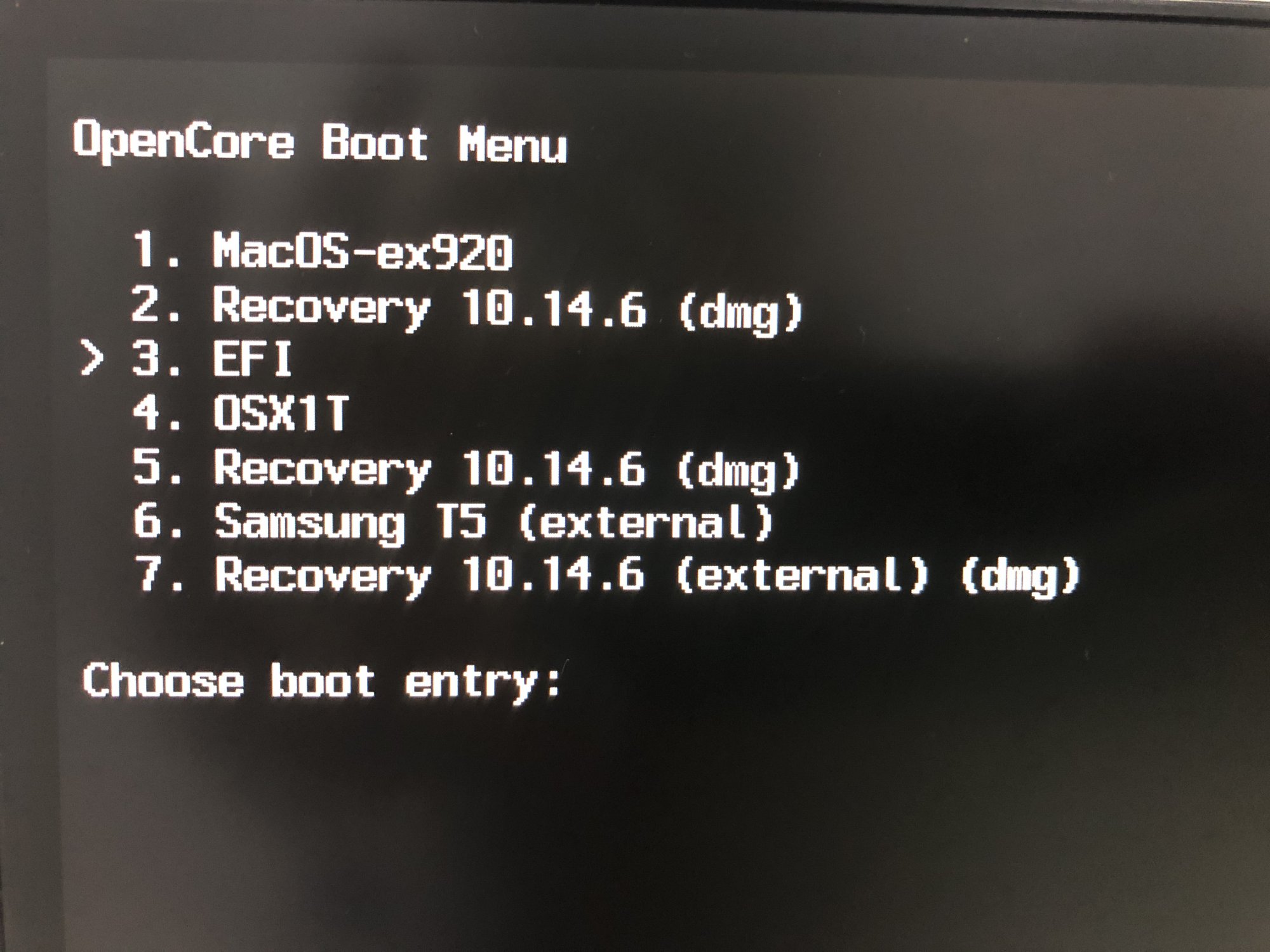

So I used the attached refind and this setting:
Code:
<key>Misc</key>
    <dict>
        <key>BlessOverride</key>
        <array>
            <string>/EFI/refind/refind_GOPx64.efi</string>
        </array>
And I got EFI option in OC, which when selected, booted to GRUB. All visible on the display.
Now testing this:
Code:
<key>Misc</key>
    <dict>
        <array>
            <string>/EFI/refind/refind_x64.efi</string>
        </array>
Code:
<key>Misc</key>
    <dict>
        <array>
        </array>

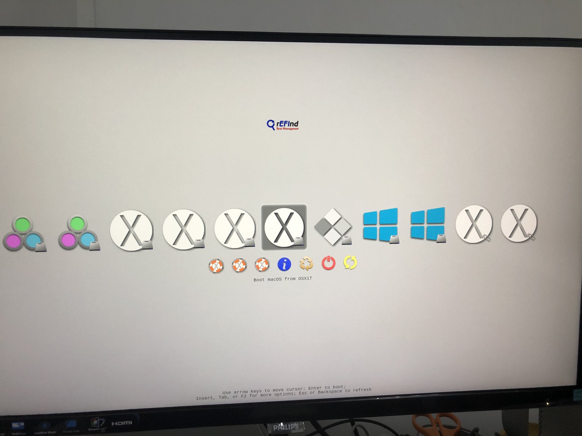

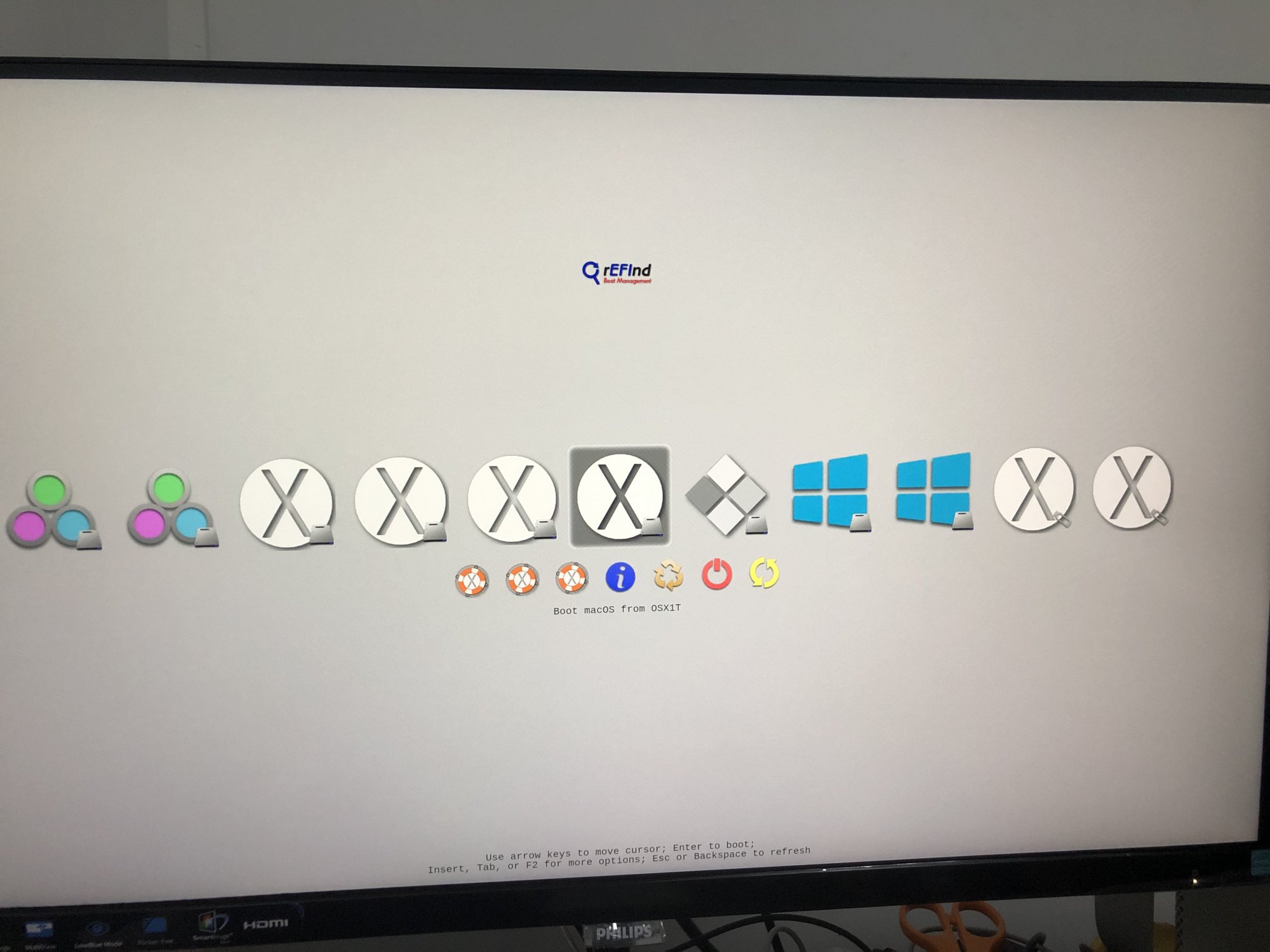

Thank you Startergo,
The solution works, by adding the BlessOveridde entry:
And then once I select the EFI, rEFInd shows:
Thank you very much.
Now unfortunately my HEVC decode acceleration is not working.
Should I inject the WEG-GREEN kext into the OC/Kext?
Will relook at H98's guide hopefully can find a solution.

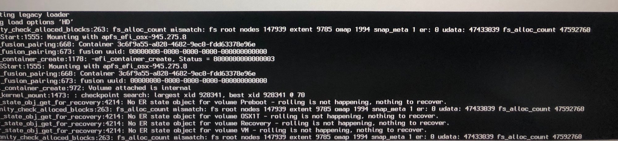

Follow up on my testing booting W10 CSM, unfortunately it is unsuccessful.
Though rEFInd able to shows the W10 it can't load (boot) it.
Got stuck with following message:
Strangely enough the OSX1T is being mentioned in the text above, it is actually Mojave on SATA, the windows is on different SSD SATA (under the CD-DRIVE).
I tried all three available boot partition options shown for W10 by rEFInd but none works.

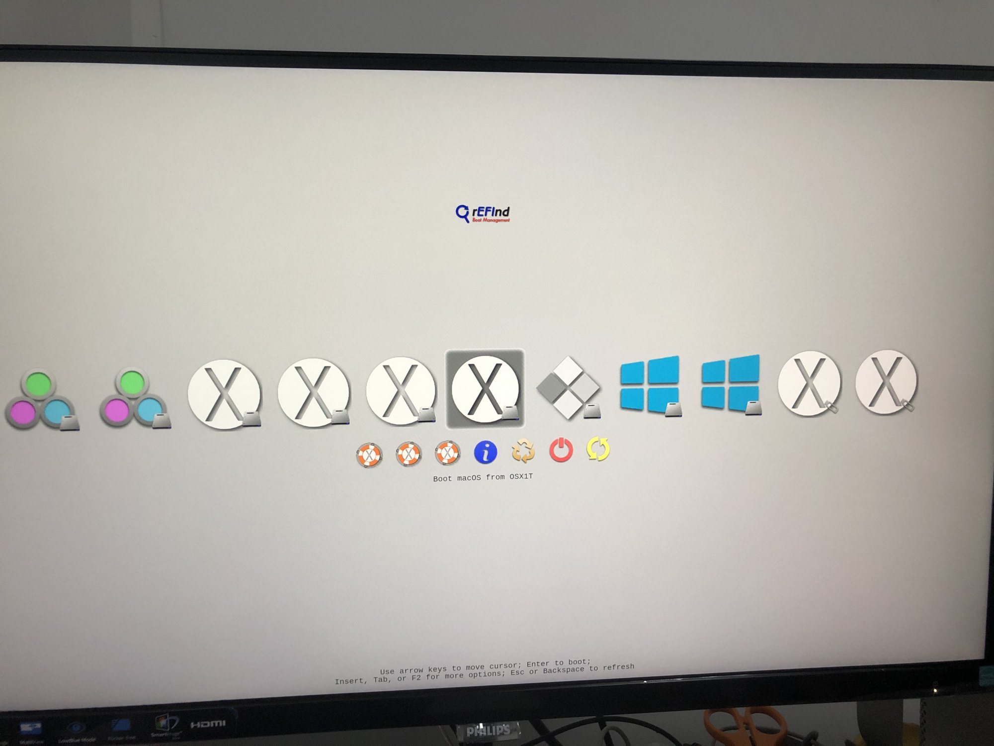

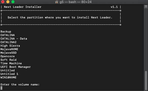

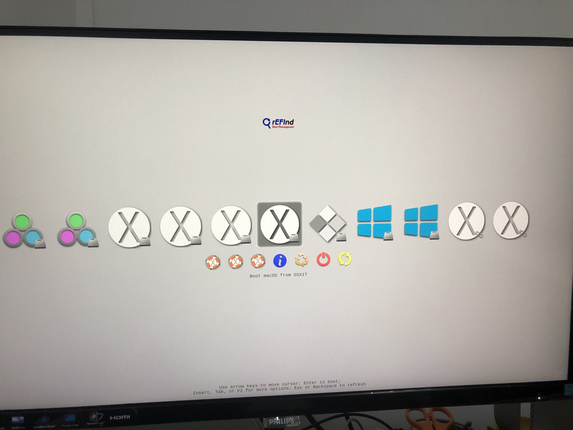

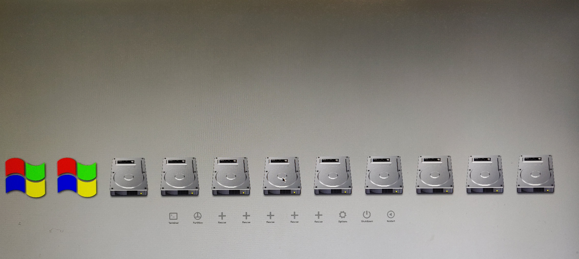

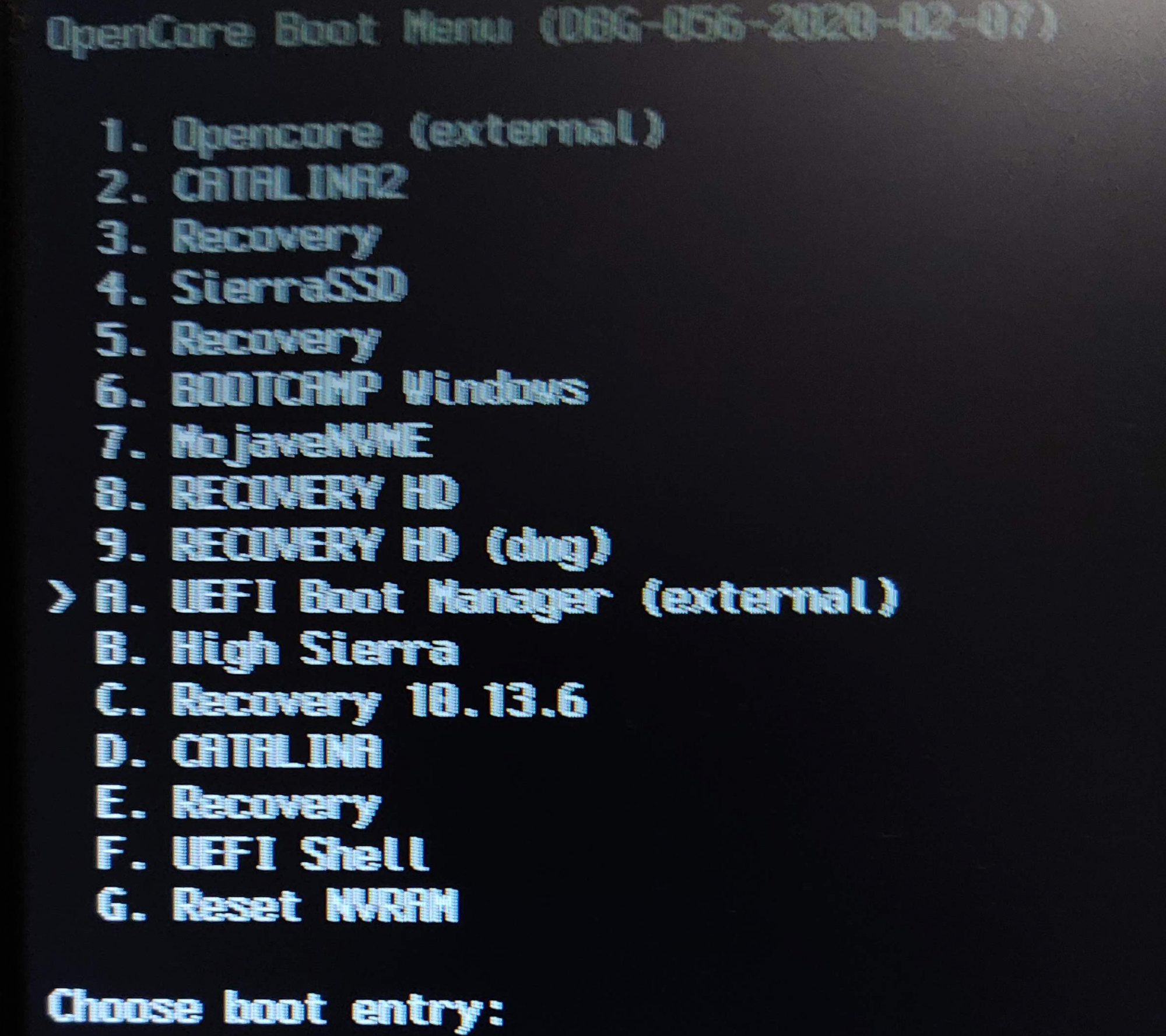

Ok. So here is a short tutorial on how to get a full blown boot picker through refind from OC boot picker.
1. Download the "Next loader" fork of Refind.
2. Attach a USB drive to the machine.
3. Open Terminal and type :
Code:
sudo -s
4. Drag and drop the "install.sh" from "~/next-loader-master/build/install.sh" in terminal and press enter.
5. Follow the prompts.
6. How do you want to install: Option 1 Install/Uninstall Next Loader.
7. How do you want to install Next Loader? Select option 2 "Install as the default boot manager".
8. Select the partition where you want to install Next Loader. Select the USB drive by typing its name as found by next loader:
9. Let it do its work. Don't select the reboot option just finish (option F).
10. Re-bless OC. You need to mount the EFI partition where OC sits and issue the bless command:
Code:
sudo bless --mount /Volumes/EFI --setBoot --file /Volumes/EFI/EFI/BOOT/BOOTx64.efi --verbose

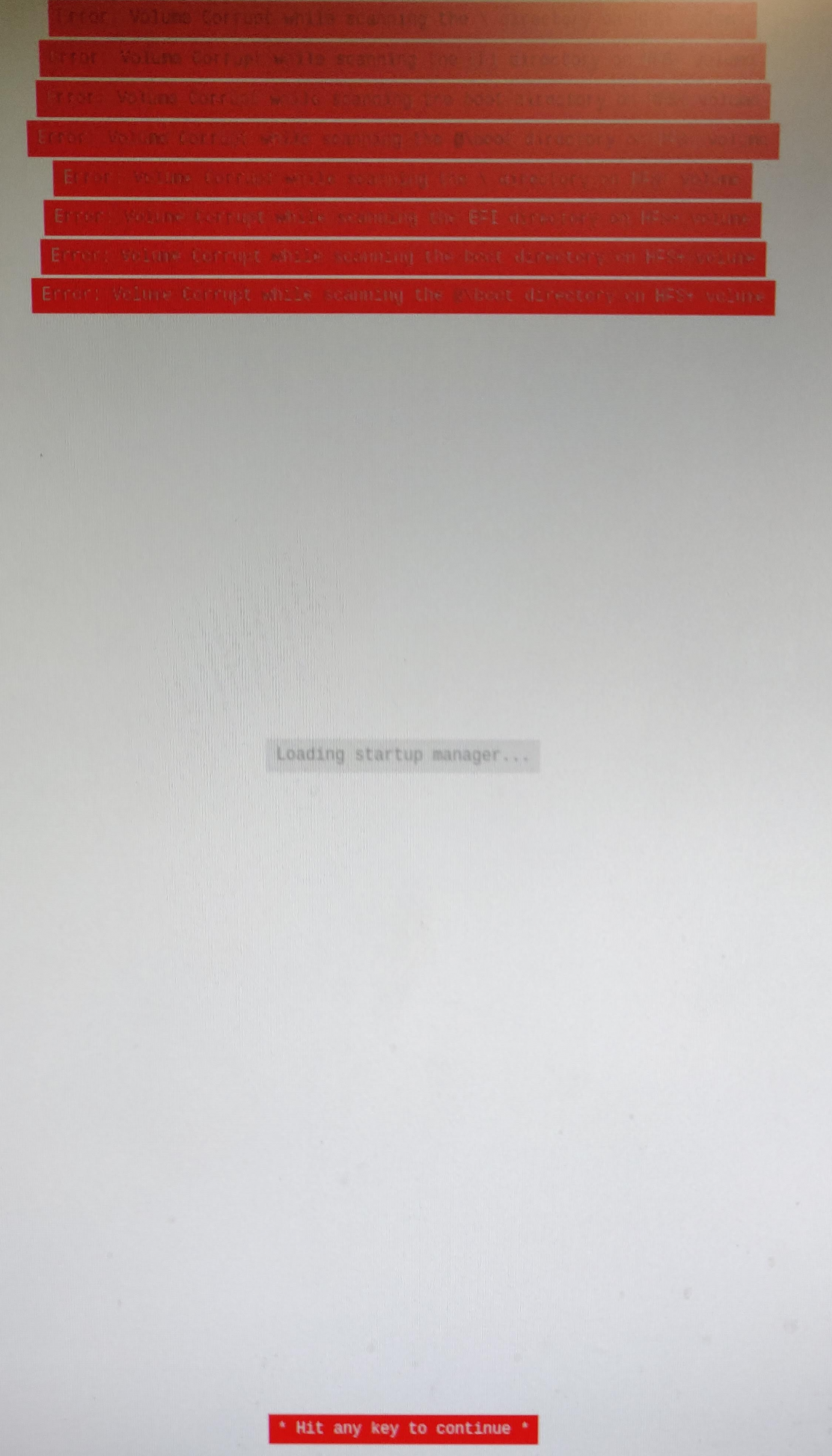

10. Reboot. At OC boot menu you will see the option "UEFI Boot Manager- (external)":
11. After selection you may see this screen:
12. Hit Any key to continue:
13. On the Left side the 2 entries are for EFI boot. One of them is my WIN10 EFI boot, which works. On the right side one of the other entries is the WIN 10 Legacy boot (for the same drive). For me that entry fails because my Windows is installed in UEFI mode. There are some installations like the "Windows To Go" installs where both entries should work and some where only Legacy will work. This fork worked for me before in blind selection it never connected the GOP driver to the screen though. Thanks to OC now the GOP driver works perfectly as you can see thanks to @vit9696 for OC and @abdyfranco for the Next Loader.
