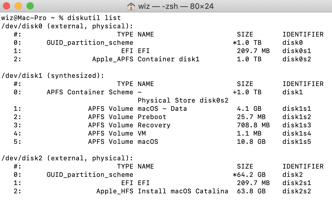

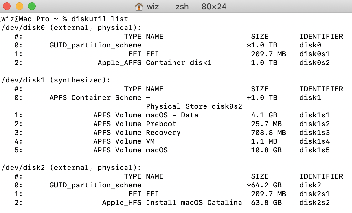

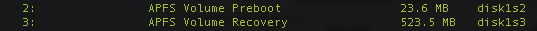

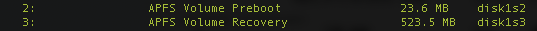

Quick update, and fix, on the unbootable recovery -
@vit9696 Please ignore my previous bug report as the issue is with the catalina patcher usb installer, already raised with @dosdude1, and not OC.
The catalina patcher is creating unbootable recovery partitions, with a larger parition size of 708.8MB vs 523.5MB, and the only way I could repair recovery is by using Catalina Recovery HD Partition app - thank you @chris1111
Doesn't boot -
Boots
Tested with and without OC - recovery 10.15.3 now boots perfectly.
Hope this helps all those impacted by this.
Cheers

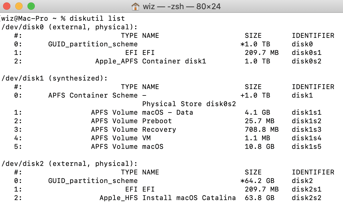

Doesn't boot -
Boots
Cheers

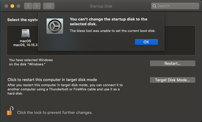

Still working on setting Windows 10 in Startup Disk. I made a little progress. Before I wasn't seeing Windows at all in the disk list. I discovered it is because I had SIP enabled. Once I disabled SIP it started to appear again. Is this expected behavior? Can an OC tweak make Windows appear in Startup Disk without disabling SIP?
Unfortunately even though it appears I get this message when I select Windows as the new startup disk.
