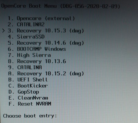

Running DBG-056-2020-02-09, no FileVault. Should I enable AppleBootPolicy to boot to recovery or is that not needed? Log and config attached.
I don't know if that's required, but I have AppleBootPolicy = true in my config as per the suggestion from the manual. And my config allow me to boot into Recovery Partition (APFS Mojave).
Reactions: rroumen
I don't have AppleBootPolicy = true. I have 2 Cat's 1 Mojave and one HS recovery. Only the HS Recovery boots the rest of them hang on "Halted on critical Error" Which is an OC message.
[automerge]1581462916[/automerge]
The common denominator for the unbootable Recovery partisions is APFS. Somehow OC does not let them boot.
After changing AppleBootPolicy = true I just booted successfully into Catalina recovery. 👍
Reactions: h9826790
I still get system halted even with AppleBootPolicy:

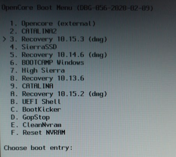

With AppleBootPolicy you get the version of the booted recovery and the -dmg at the end:
Still only Recovery 10.13.6 (Option 8 above) works.

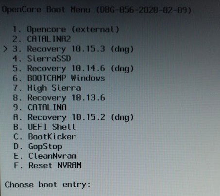

I posted the solution several posts back and the cause was confirmed by @vit9696 - OC verifies whether the dmg file has been altered/corrupted and if it was then OC reports "DMG has been altered" and halts booting.
The above solution is for Catalina and I believe there is recovery restoration app for Mojave as well.
Edit: AppleBootPolicy = true is needed for booting recoveries under OC. First check if you are able to boot the recovery without OC and if it doesn't then it won't boot via OC either.

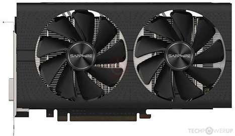

Hello, I have been messing around with the AMD hw acceleration instruction in the other thread (and that did work except the bootpicker), today I wiped all the drives and tried the instruction in this thread.
Everything from this thread post #1 works properly, except the bootpicker does not show up, my screen stays black until the logon.
However, as others reported, if I press 1 during the blackout period, it boots into 10.15. If I press 3, it boots into 10.14. If I press 2, it boots into 10.15 Recovery.
-I tried two different 4k monitors. I tried display port cable, and hdmi cable, and tried all 4 ports on the GPU (2 hdmi, 2 displayport).
-I tried a second gpu I have, "Zotac GT 710 Zone". It had the same black screen.
-I then put in my Apple OEM GPU, and it showed the bootpicker screen properly, and booted according to the pick properly.
I kind of have the feeling there is no signal going to the monitor until right before the logon screen. This is just my gut, I don't have any evidence. The progress bar shows up at the bottom for a split second right before the logon screen. I don't recall if that progress bar showed up at all when I was running plain 10.14 without any mods whatsoever.
If there is any testing I can do to help, I'd be happy to. (although this is all new to me. I did read both threads in their entirety over the past two weeks).
Edit: I just checked the ebay add I got the used Rx580 from a few weeks back. It said "Has ETH mod bios installed". I don't know if this is significant or not, but figured it was worth mentioning.
Thanks,
Nick
Hi Nich, I have the same exact issue. I have pulse rx580 8gb and I don’t get a boot screen. Very frustrating bad when I put an old Apple EFI gpu I see boot screen. Another problem is when I put the Apple efi gpu my resolution is distorted but that’s not important as I rather have my rx580 working.
Did you find a solution? I am not confirmed that my card was used for mining but I might just replace this card with a new one. Please let me know if you found a solution.

When I had both my EFI and regular Polaris card Windows 10 only output to the regular card's screen. The other one was black. Can you boot Windows without OC?
Did you ever flash your card? Or if you buy it used (the last user may flashed it)?
Modification of the VBIOS can break the GOP. e.g. Downvolt the card, or OC the card.
Update: Just saw that's a mining card. And the others already pointed out that's the problem.
Yes, I did it last night at midnight and then when right to bed, planning on updating this thread in the AM🙂. After a lot of hiccups (figuring out how to flash the card, then the flashed card not booting at all into win or Mac.... finally got it though). After the flashing of the card, it does indeed now show the bootpicker menu!
For others having the same issue, the video I watched to flash was:
And the rom I used was this one:
This ROM was the oldest one I found on that site from 2017-03-10 compile date. I had first tried the newest one from 2018-07-19 compile date and it would not boot into win or Mac. So I had to boot using a second GPU, with the RX580 still installed, and then reflash the RX580 with the older rom. I don't know if that was really the issue (rom compile date), but I'm happy now.
I have some other issues now related to HW acceleration, but I will ask them later.

My flashed MVC Polaris is not performing good, so I intend to replace the chip with the vbios installed by MVC and flash back the original vbios as I don't need it anymore.
Was yours not a dual bios card? (if it was, i hear you can just flip the switch to the other rom and you'll lose EFI UGA and be on the GOP ROM instead which should run the card's normal settings)
No it wasn't. Sometimes I was getting snowy screen output. It does not want to operate alongside the other card in Windows and the vbioses are different even though the cards are identical Dell's RX-580 (rebadged 480). I am not sure why they had to replace the vbios with an original RX-480 instead of just adding the UGA part. Anyway this is their decision and I don't blame MVC for that it just does not fit my needs.
I'd just sell the card as-is and buy another 'normal' one?
Someone else may be willing to deal with those issues to have an EFI card.
The UGA portion to my knowledge was too large to fit on the original chip from what i understand (granted this could just be padding / obfuscation to prevent it being stolen/pirated).
Yes they installed bigger chip plus it is read protected (I have noticed they use the same chip on some of the Nvidia GPU's), but I don't care about that I am not sure if I can get my money back by selling it unless someone is interested. For 350 you can buy the RX5700 now brand new.
