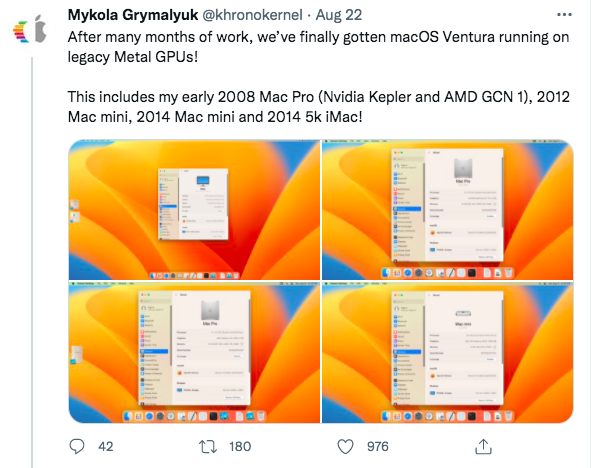

So just informing you guys, legacy Metal GPUs are now being supported in Ventura thanks to Opencore.
Dortania developer Khronokernel confirmed this recently, starting with the 2008 Mac Pro.
