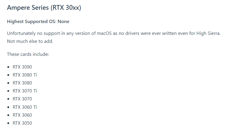

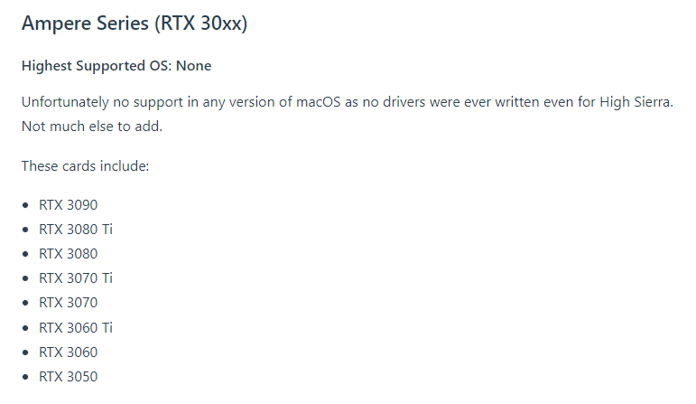

I'm sorry but there AREN'T ANY working drivers for the RTX series on macOS, period. Even if VESA mode was somehow possibly enabled he'd still be without any form of hardware acceleration. Btw this is not me, but the advice given by the Opencore team.
The reason its not appearing in the OCLP boot picker is likely because the Lilu/WEG they are using in the build doesn't have the necessary parameters set for the RTX cards, hence no support. So my suggestion is if he wants to get acceleration for both Windows and/or macOS in his work is to swap the card for a RX6800 or RX6900XT.

Yes correct. RX is AMD. RTX is Nvidia. Nvidia is largely not supported now, especially after High Sierra 10.13 (GTX 1080 Pascal was last major lineup supported) and certain macOSes afterwards such as Monterey with Kepler. Ventura has even less Nvidia support (hardly any) which is why most will need OCLP to work. That said Dortania is working hard to provide legacy Mac Metal support which was reported in active development recently.

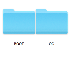

you need to remove the disk with efi, where you installed opencore or oclp
connect it to another mac (if you have special adapters, you can connect it via usb to ssd)- You have RAID via USB- put it instead RAID
open the efi on that disk (you can use the clover configurator- Marin's OC has it) download a normal opencore, as in post # 1, edit important parts in config file (as in cdf the instructions).
put new opencore in efi
insert disk back - should work
there is a second way - everything is the same, just use the ready-made version of opencore 0.8.0 martin lo
way three

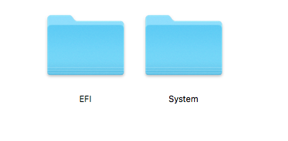

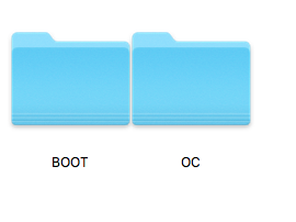

leave what the OCLP formed in the efi folder in place, just redesign the folders, as in post # 1-
in EfI folder make new folder "BOOT"
move file boot.efi (you can find it in system>library>core services>) to BOOT folder
this is exactly how oclp worked for me

the opencore was already blessed,
opencore can't find file boot.efi
you need to create a "BOOT" folder in EFI/EFI folder and transfer the boot.efi file from the system folder to it
and don't experiment anymore with opencore automatic configurators (like OCLP)
- do as in post#1 or use martin's version

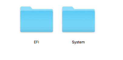

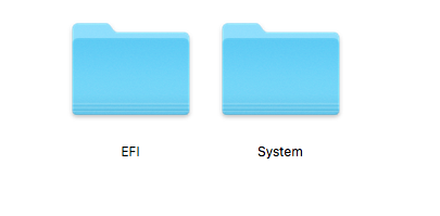

OLCP made this tree:
EFI>
EFI +SYSTEM
in EFI>OC (the standard folder as OC 0.8.0 with many kexts and drivers and with working config file)
in SYSTEM>LIBRARY>CoreServices>Boot.efi
because the installation procedure did not complete correctly, then the OC does not find the boot.efi file
he need to move boot.efi in new folder BOOT
