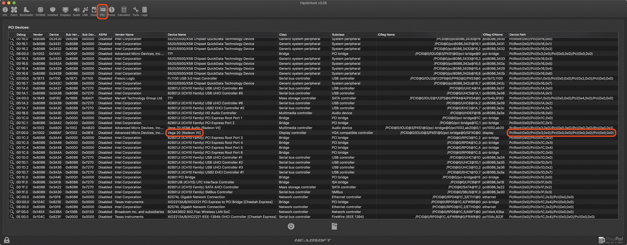

Another easy way is to use Hackintool -> PCI page -> find your device name -> get the device path
Reactions: octoviaa and Dayo
Thanks both. Got it done with a combination of the two.

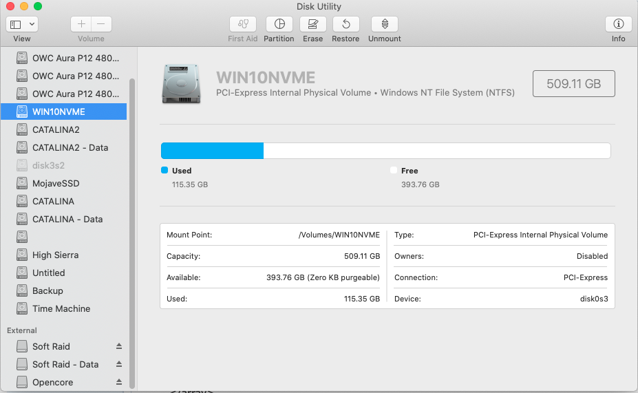

How i instaled Windows in UEFI mode.
Tools needed:
Brew (to install gdisk)​
Gdisk (GPT Fdisk)​
Virtual Box​
Windows 10 ISO image​
More than 3 hard drives​
First config virtual box to have full access to disk (In Mac OS preference panel)
Now open the Terminal and type:
sudo -s
Enter your password and hit return.
Type it:
diskutil list
Take note to the number of disk designated for Windows. (In my Mac is /dev/disk3)
Type it:
diskutil umountdisk /dev/disk# # = the number of your disk
Type it:
VBoxManage internalcommands createrawvmdk -filename "</path/to/file>.vmdk" -rawdisk /dev/disk#
Type it:
/Applications/VirtualBox.app/Contents/MacOS/VirtualBox
In the VirtualBox, create a VM for Windows 10 with the vmdk file created. Set the VM to use EFI.
Boot the VM and install Windows. At the end don’t create a user! Type Control + Shift + F3 to enter in audit mode.
In audit mode (sysprep) download and extract the driver** for your video card and install it from the INF file (AMD/DriverVersion/Packages/Drivers/Display/WT6A_INF)! Not from Setup aplication.
Now open the sysprep and select “Generalize” and “Shutdown”. After that close VirtualBox. If the disk not show in Mac OS Desktop, mount with diskutil mount /dev/disk#. Open the disk and check for EFI folder, if partition has no name, rename it to EFI.
Type gdisk /dev/disk#
Gdisk show an error in the partition and fix it, now rename the Windows partition to BOOTCAMP, save the modification and exit gdisk.
Then install (copy) OpenCore to a secondary disk (here i used my media disk) and bless it.
Now restart your Mac,
The OpenCore bootpicker now show BOOTCAMP Windows. Boot it and install driver with brigadier (google it).
** I needed to do this, because otherwise I would lose the video signal right after the boot.
Works!!

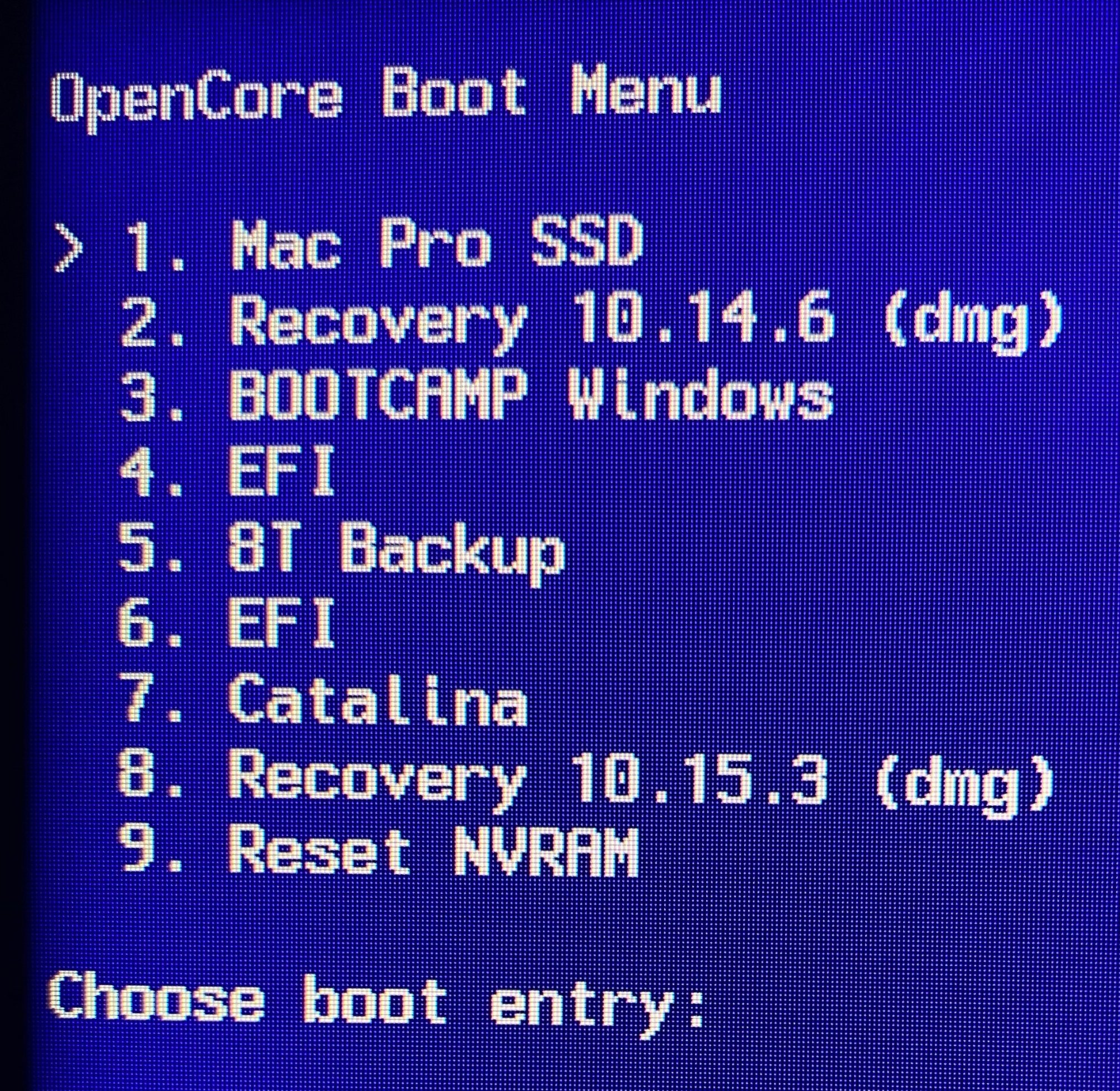

Anyway, I just did a clean EFI Windows 10 installation to one of my internal SATA SSD with only one USB drive. And I did that by using the OpenCore boot picker.
I believe it's the hard way already, just to confirm the idea can work. I put OpenCore on the target SSD's EFI partition, then boot from this SSD -> load the USB installer -> install Windows on this SSD.
I even make it more complicated. During Windows installation, I intentionally remove all partitions on the SSD, and let the installer re-create the required partitions. Therefore, OpenCore is removed.
This cause me have to do one extra step.
After the first stage installation, Windows installer will reboot. The cMP will stuck at no boot condition (may be it's looking for OpenCore). So, I shutdown the cMP, re-insert all my MacOS drives that have OC installed, and perform a NVRAM reset.
Then my cMP boot to the OpenCore boot picker again. I can simply choose "BOOTCAMP Windows" to continue the Windows installation.
Anyway, I re-installed the Bootcamp drivers, GPU driver, and some basic softwares. Perform a few reboots, then dump the BootROM and check it. There is no more certificate as expected.

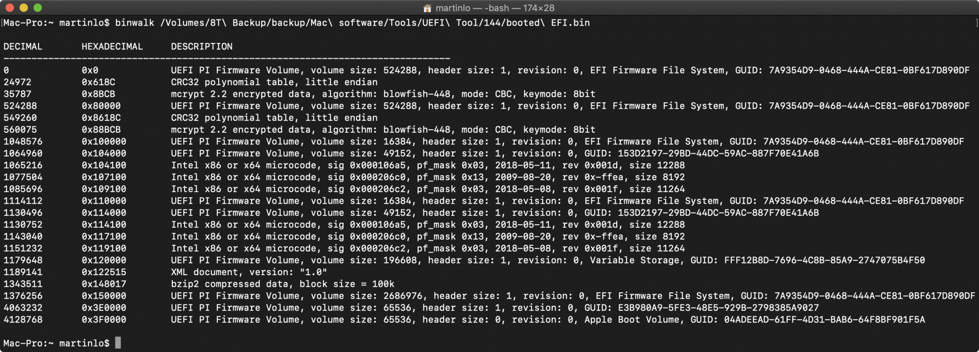

I check that by using Binwalk, and keyword search in iHex. Both method can't see the "Microsoft Windows Secure Boot Variable Signer".
So, I also believe that we can run EFI Windows risk free now.

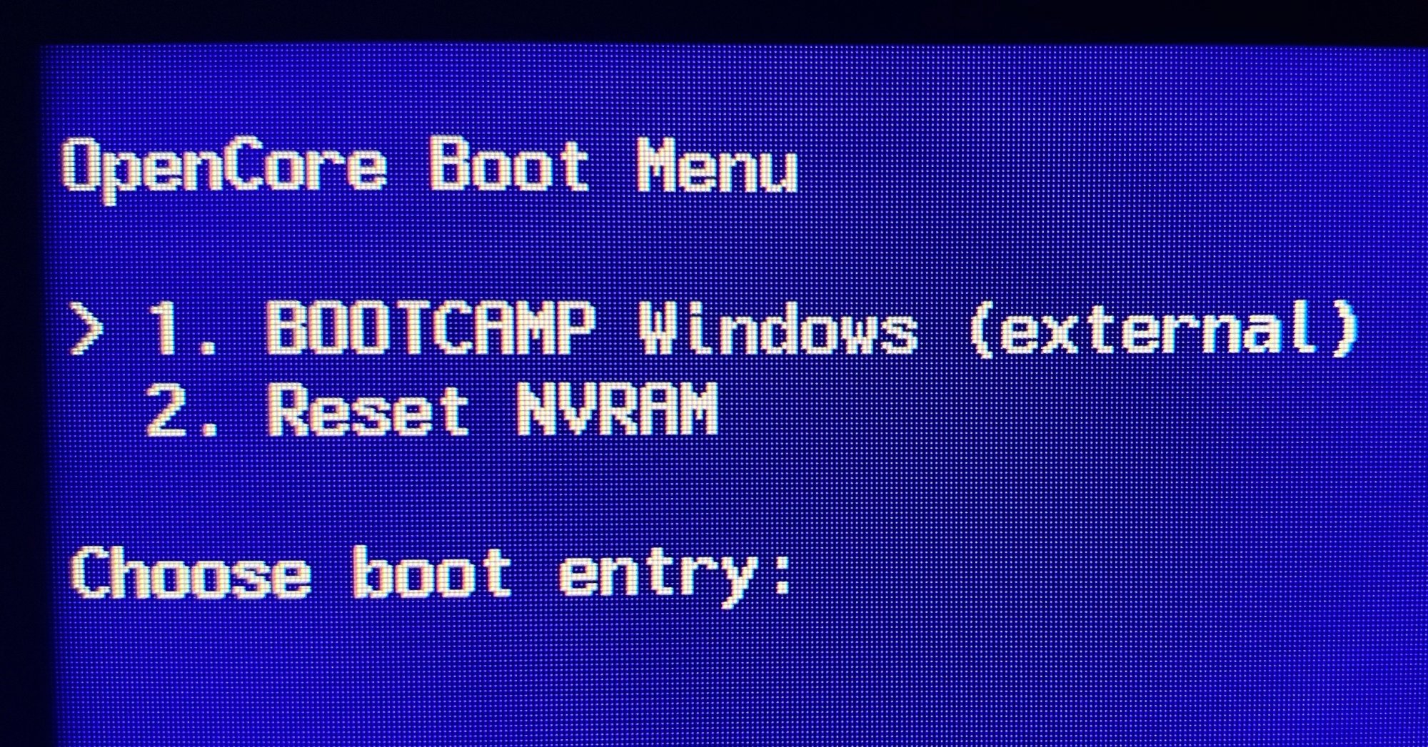

Okay, got my Windows 10 EFI install working now. Couple of things:
- Followed the instructions for driver installation - all good, except there's no control panel appearing in the system tray, I have to run it from Windows\System32\AppleControlPanel.exe.
- Changing the boot device overrides OC entirely. How are you guys getting persistence of OC when using the boot pickers?
I also had it all go south when Windows would stick at its own boot screen with no spinner, just the blue logo. Had to use the inbuilt repair and rebuild to get it back, but I doubt this is anything to do with OC.
Finally, how do I go checking that this install isn't harming my NVRAM and make sure OC is in play under Windows? Because of the picker overriding OC I'm pretty sure this boot is not under OC's power, so I'm guessing this could be a scenario where those certificates being written to NVRAM become an issue.
