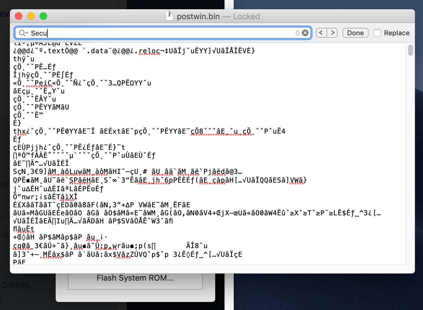

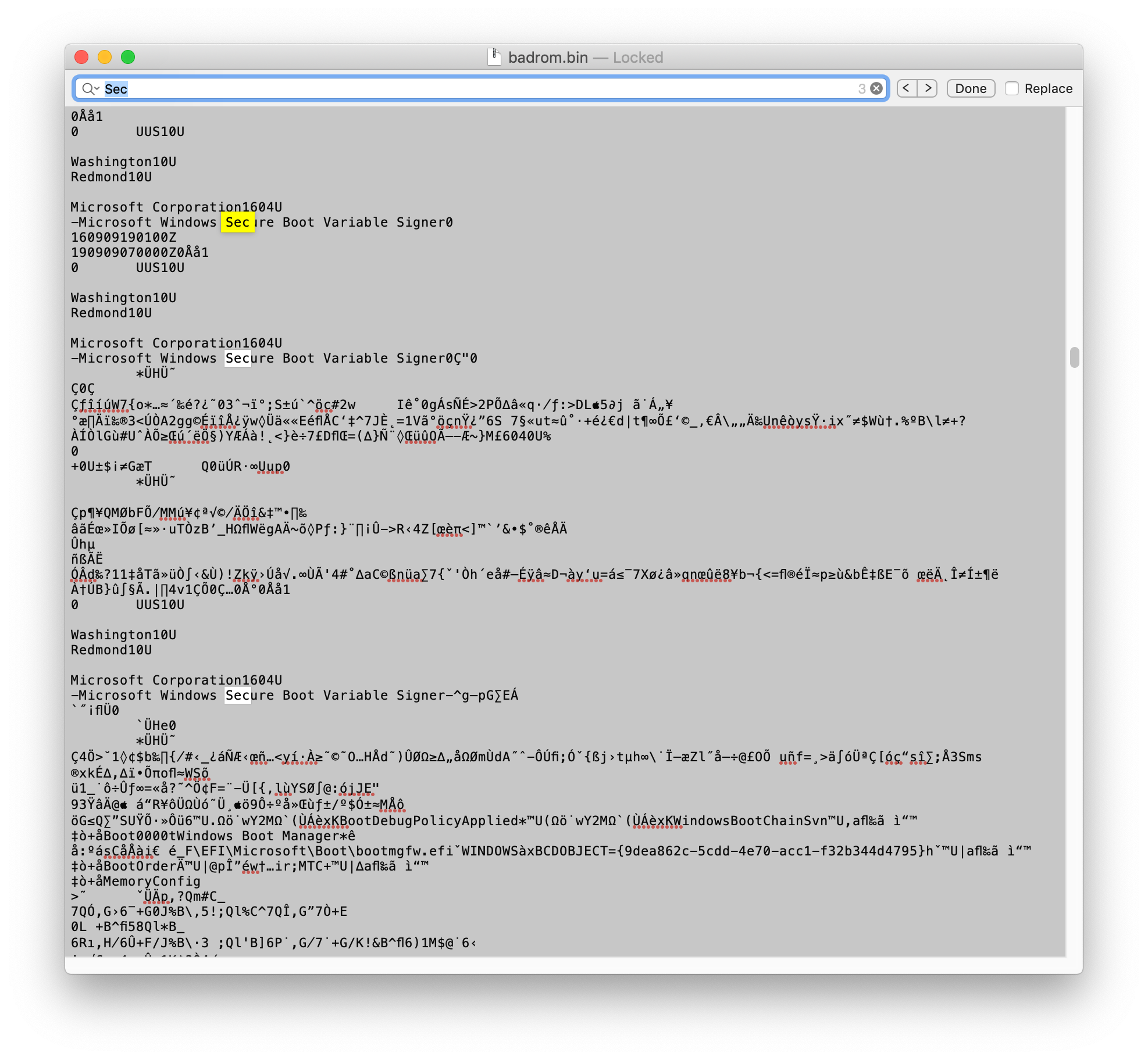

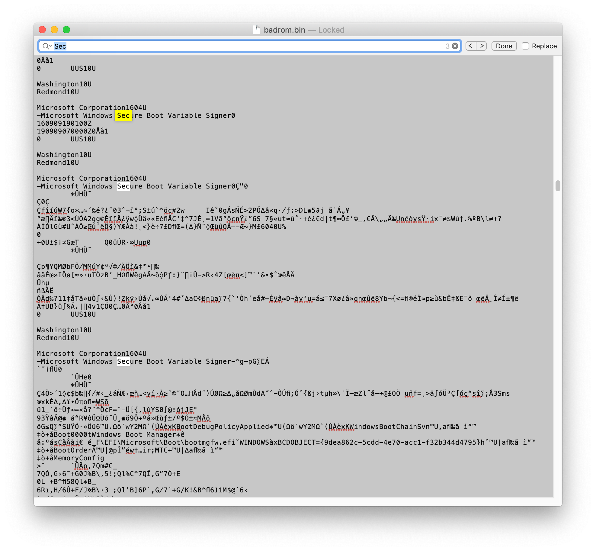

Been around the houses a bit on this tonight. I've found that it's very easy to wind up in a position where Windows boots itself in EFI mode with no indication that it's doing so; no blue Windows logo or spinner shown, just suddenly landing on the login screen. By that point the damage is done. I booted to my Mojave fallback to find the dreaded certificates appearing.
That's no bueno. A reflashed ROM from backup and all is well again, but it's too easy to fall foul of this.

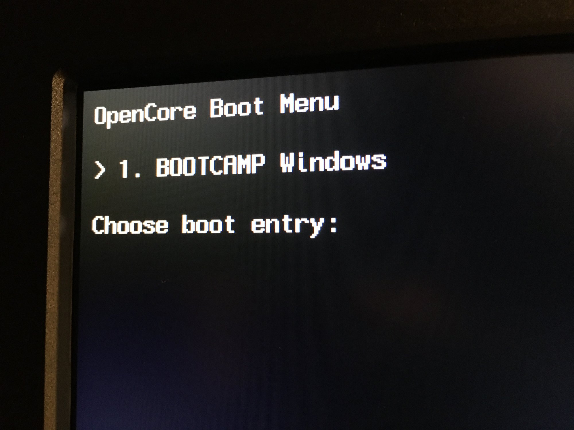

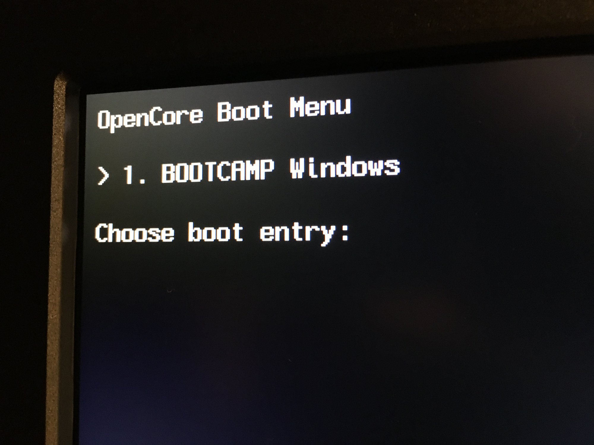

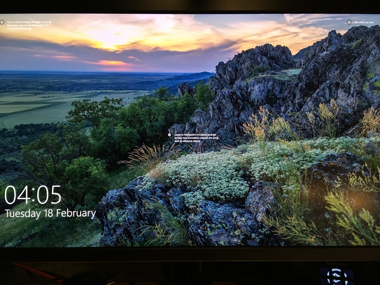

So, I replaced Microsoft's \EFI\Boot\bootx64.efi with OC's \EFI\BOOT\BOOTx64.efi and deliberately did not bless it before removing all other drives and rebooting. I just wanted to see what the machine would do left to its own devices. OC options HideSelf is false and BlessOverride is:
XML:
<key>BlessOverride</key>
        <array>
            <string>\EFI\Microsoft\Boot\bootmgfw.efi</string>
        </array>

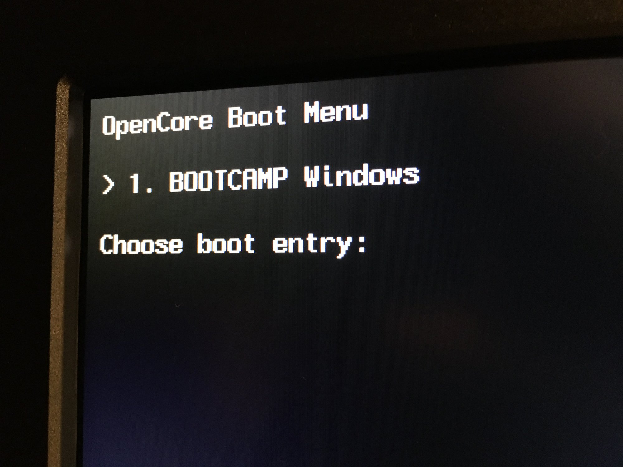

Reboot and I see this:
That's much better. It takes about 37 seconds for the picker to appear after the chime, I guess while it looks around for sources to boot from. This is why the \EFI\BOOTOC folder is probably a no-go; it'll likely always find and boot from an \EFI\BOOT in preference when it doesn't know what to do, meaning BootROM corruption with certificates.
Going to test whether it survives a reboot. Taking nothing for granted with Windows.

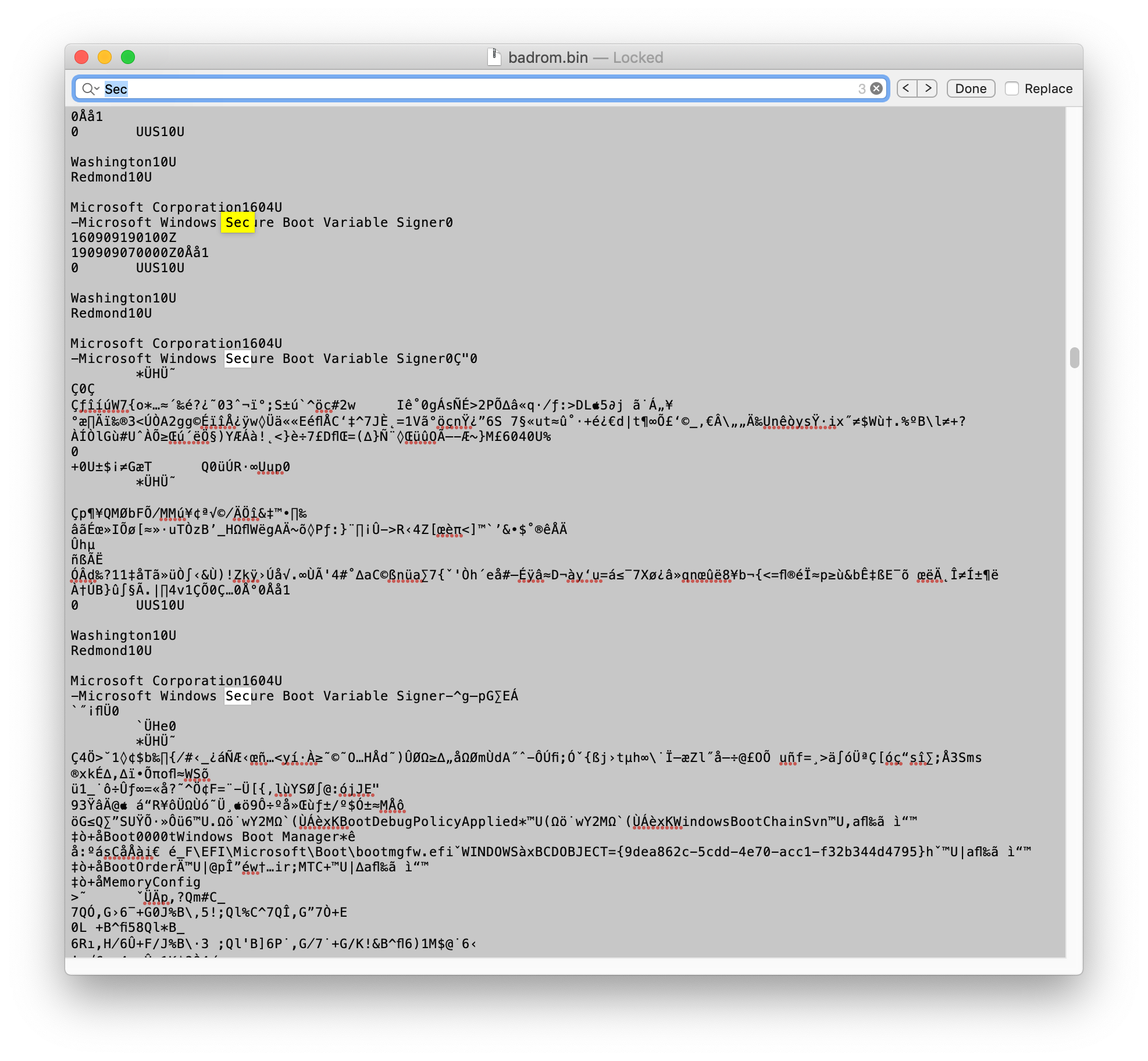

UPDATE: Survives reboot. Now to go back to Mojave and check the BootROM.
UPDATE2: No BootROM corruption! Now to go back to Windows and try the 1909 to 2004 update.

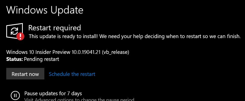

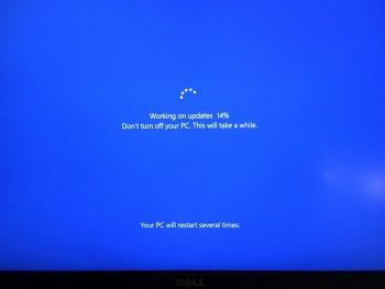

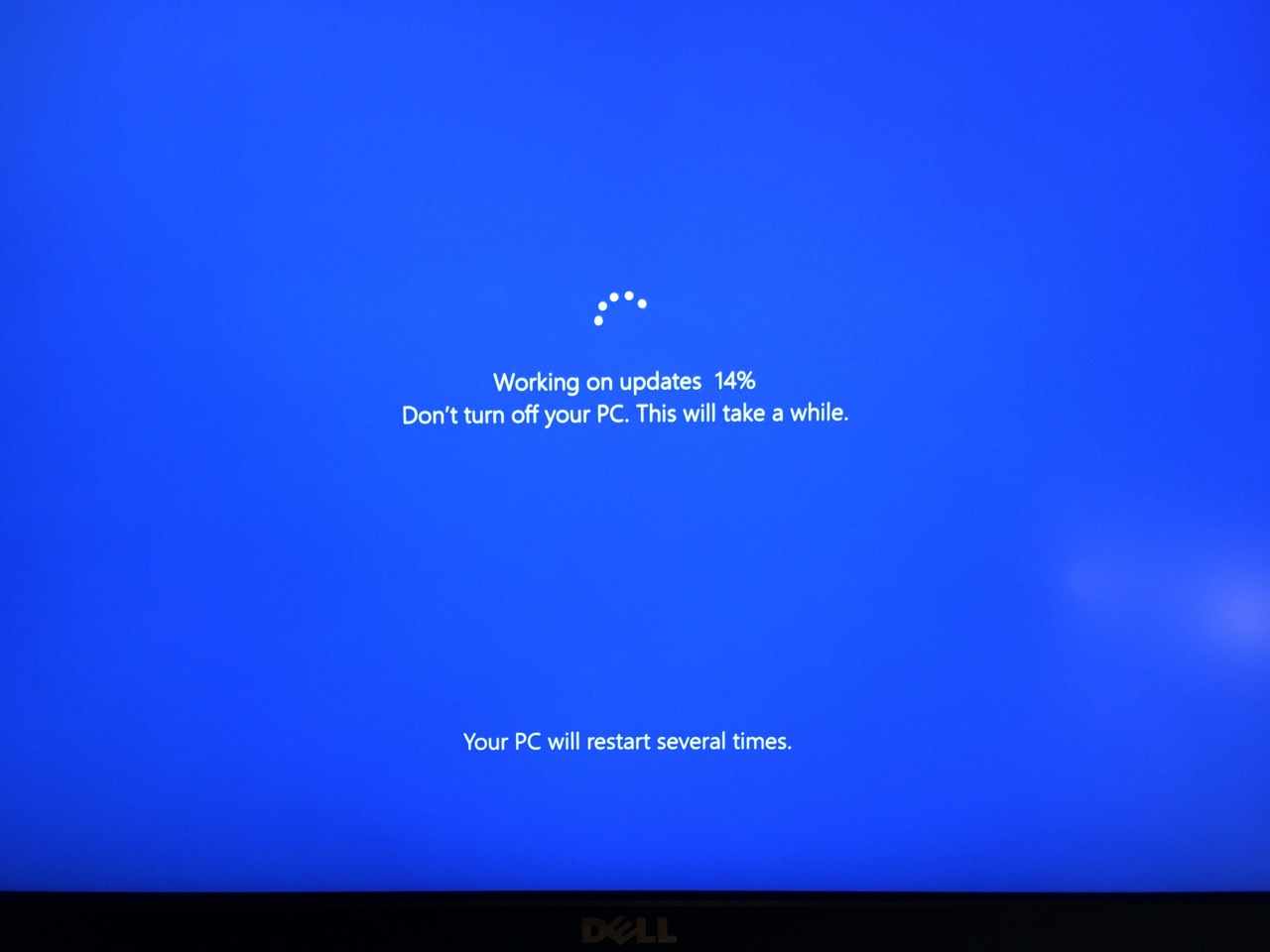

UPDATE3: No update installed yet, back in Windows through OC; but with no other drives installed it did fail to boot the first time. OC was found and launched, but Windows just sat there with the blue logo showing and no spinner. Power off and back on and it booted through OC just fine, though I got a 'what were you doing when your system crashed' feedback screen.
Wish me luck:

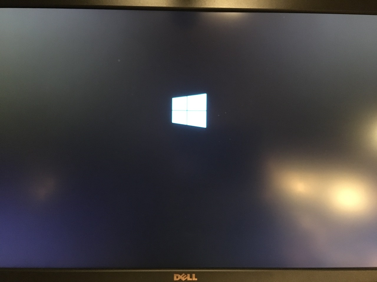

UPDATE4: Initial boot into installer worked through OC, our \EFI\BOOT was not affected. This time.

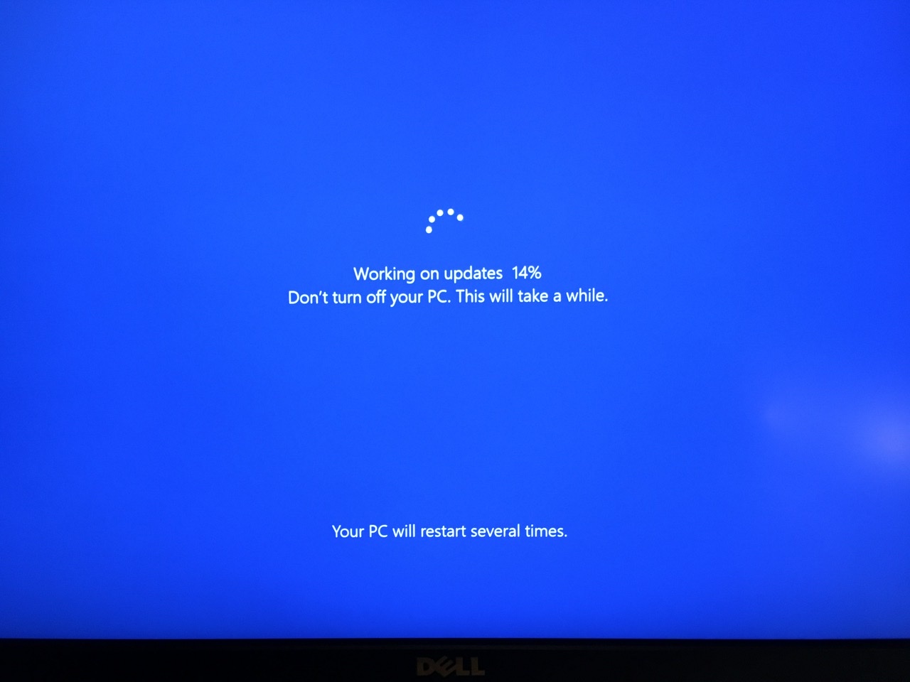

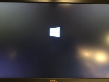

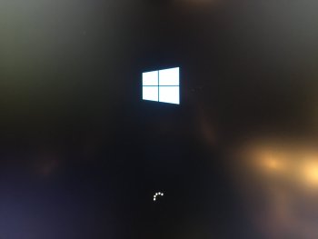

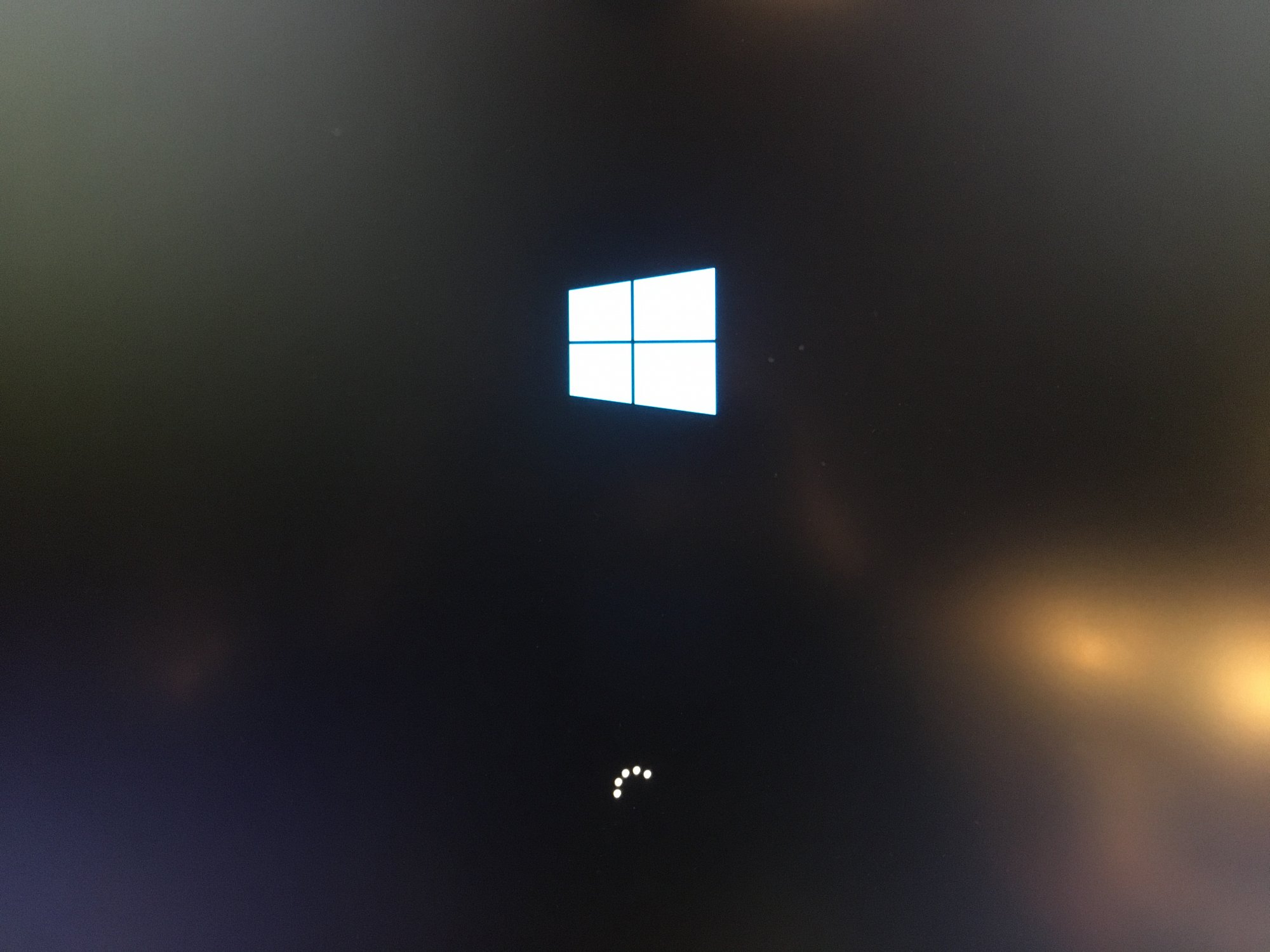

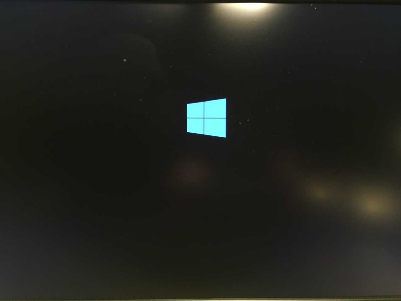

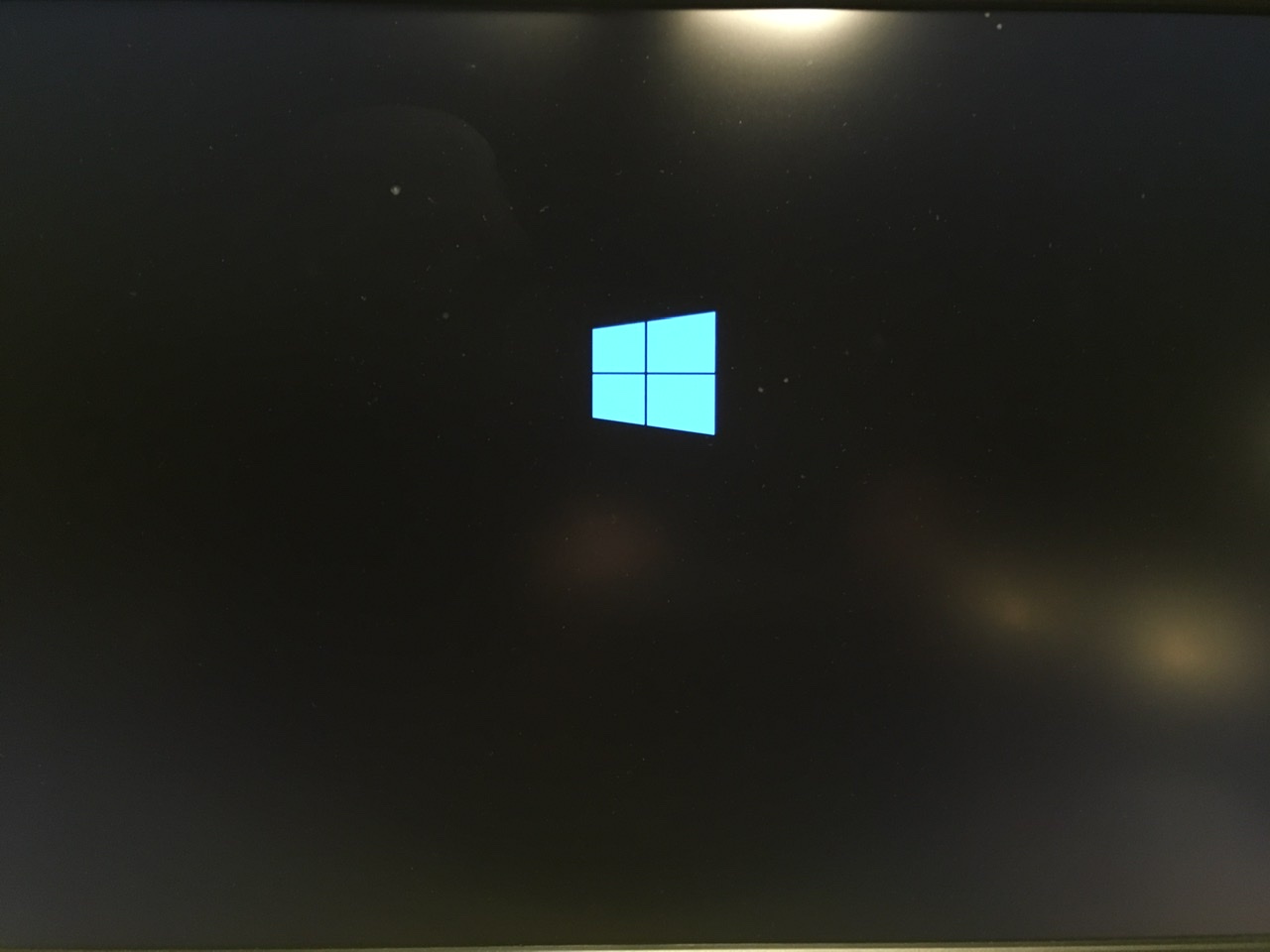

UPDATE5: First reboot of the upgrade and OC is still present, but no spinner on the boot screen again. Hard power off and power on, OC boots Windows and briefly “attempting to recover installation” is shown. Machine auto-reboots. OC kicks in, Windows boot logo... no spinner again.

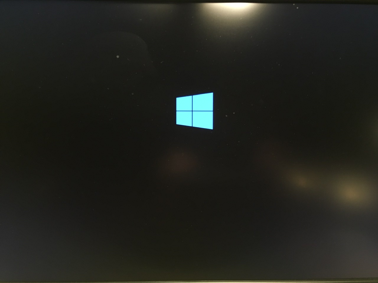

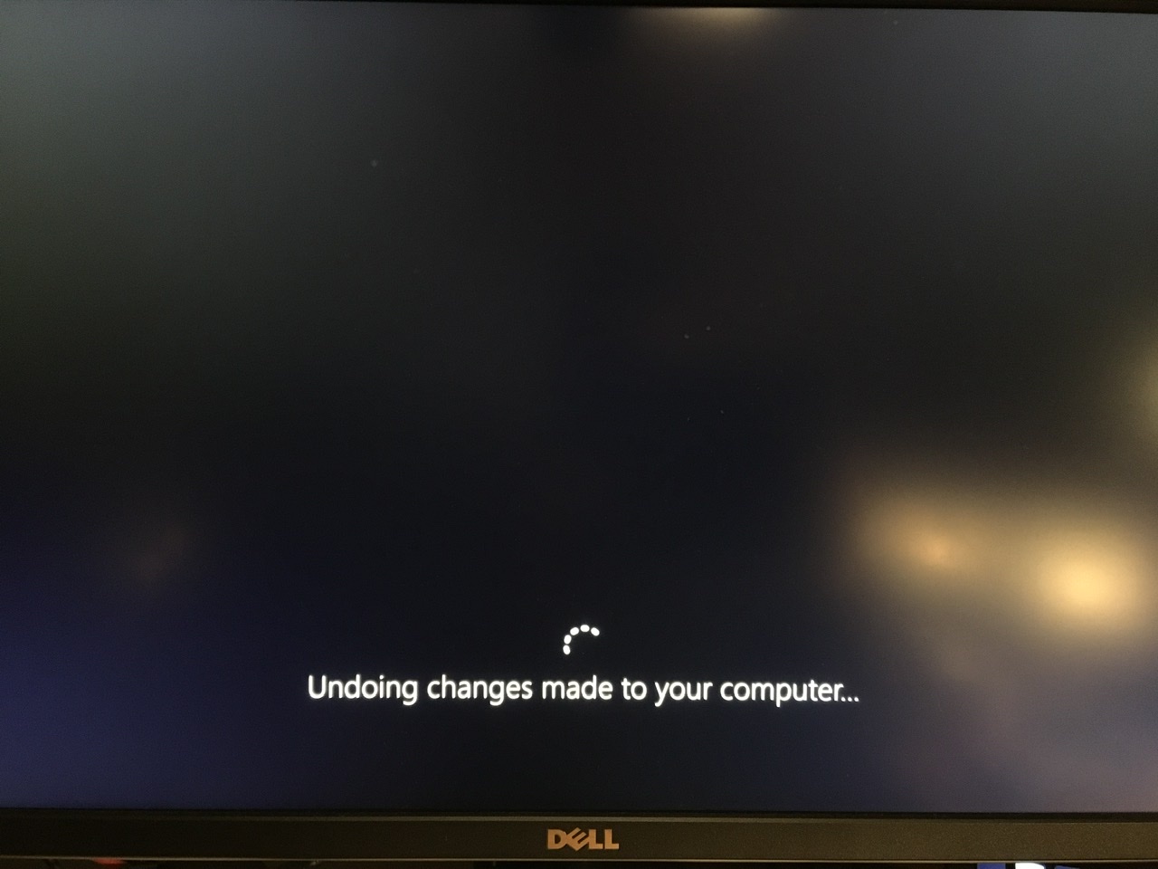

Hard power off and back on, OC still okay, Windows spinner starts, then:

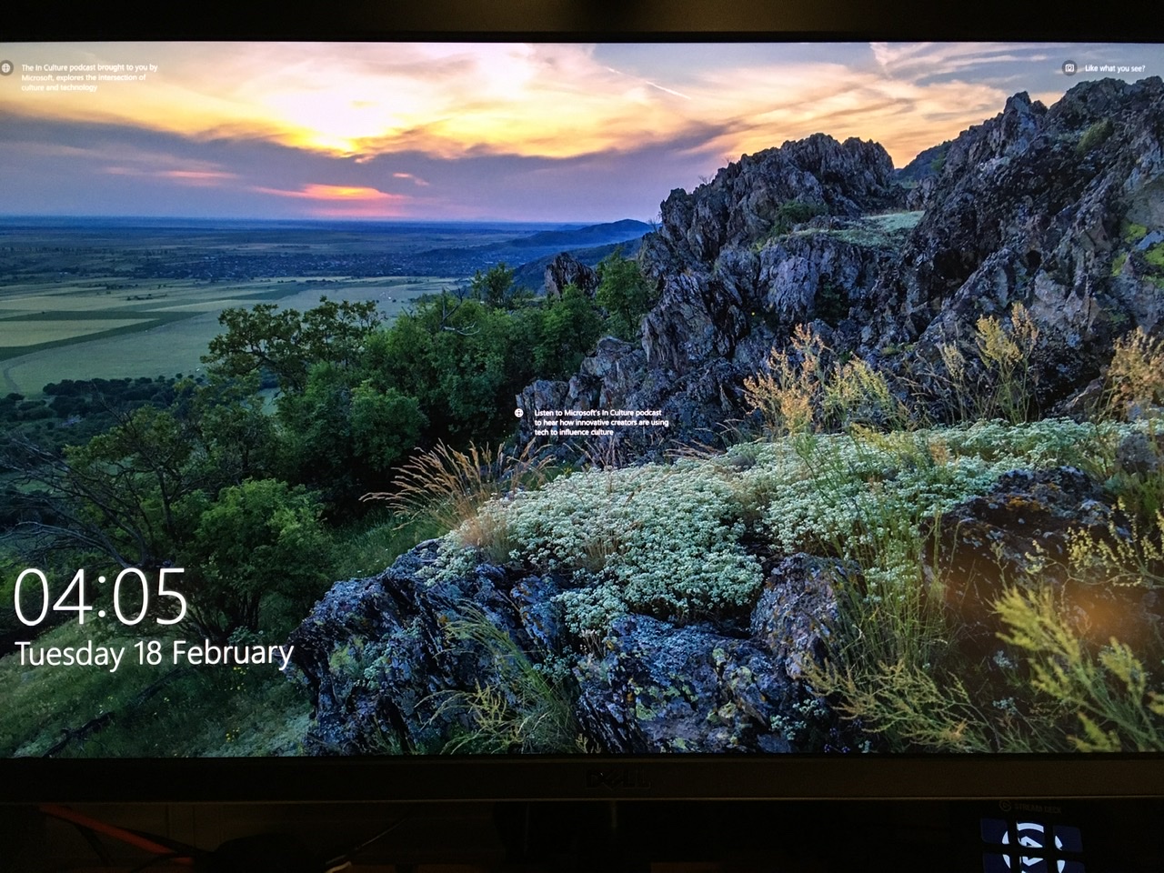

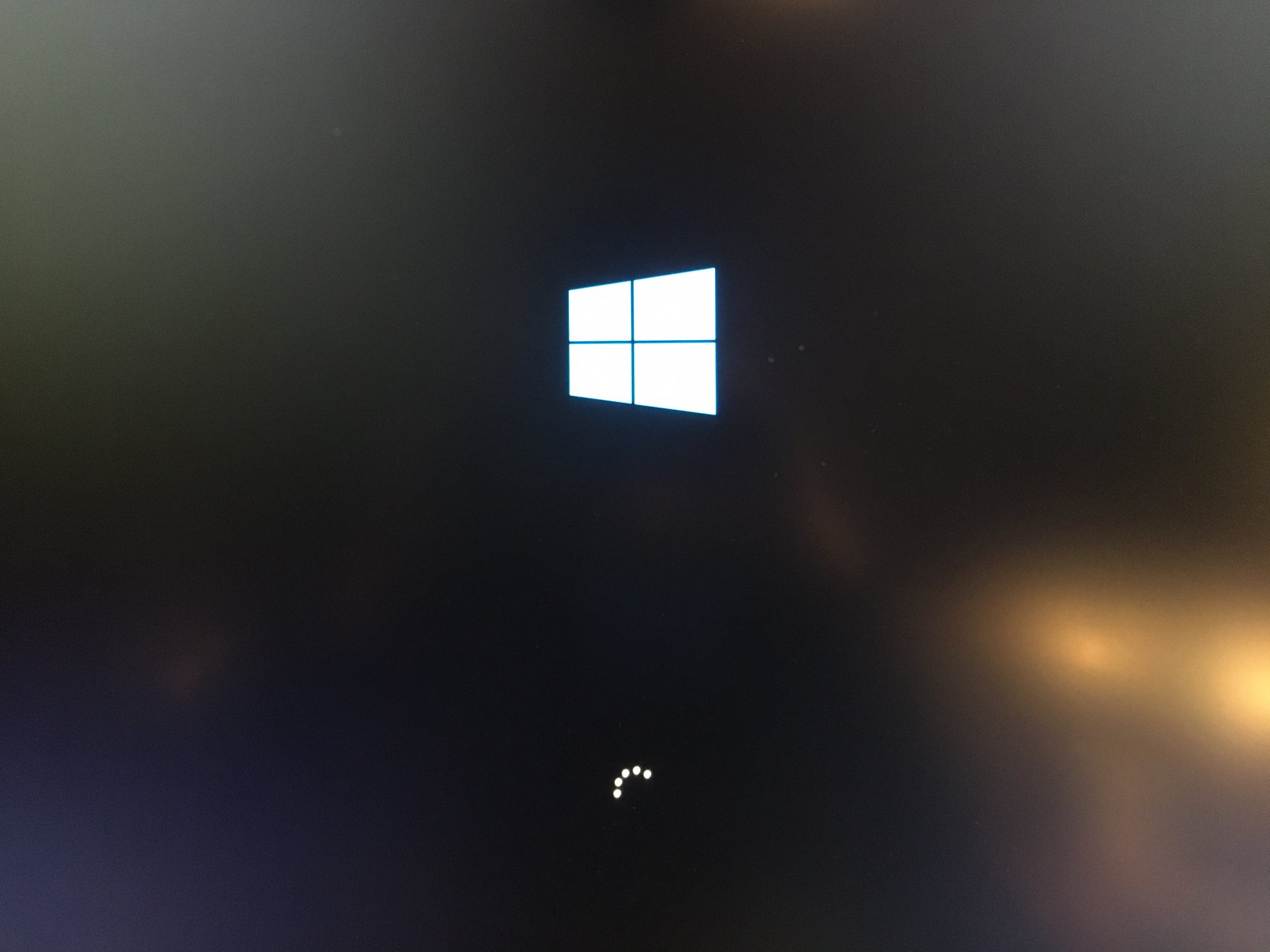

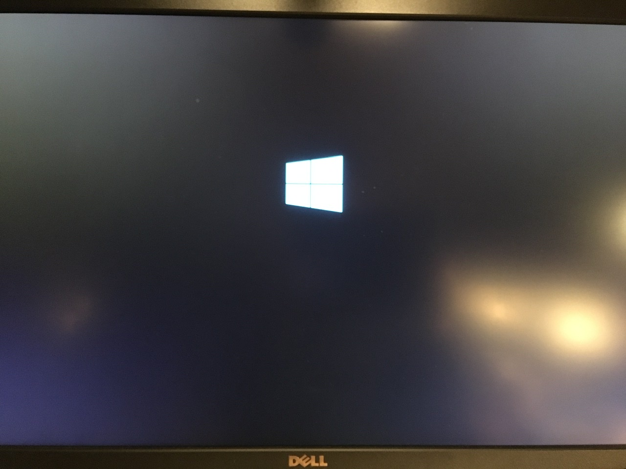

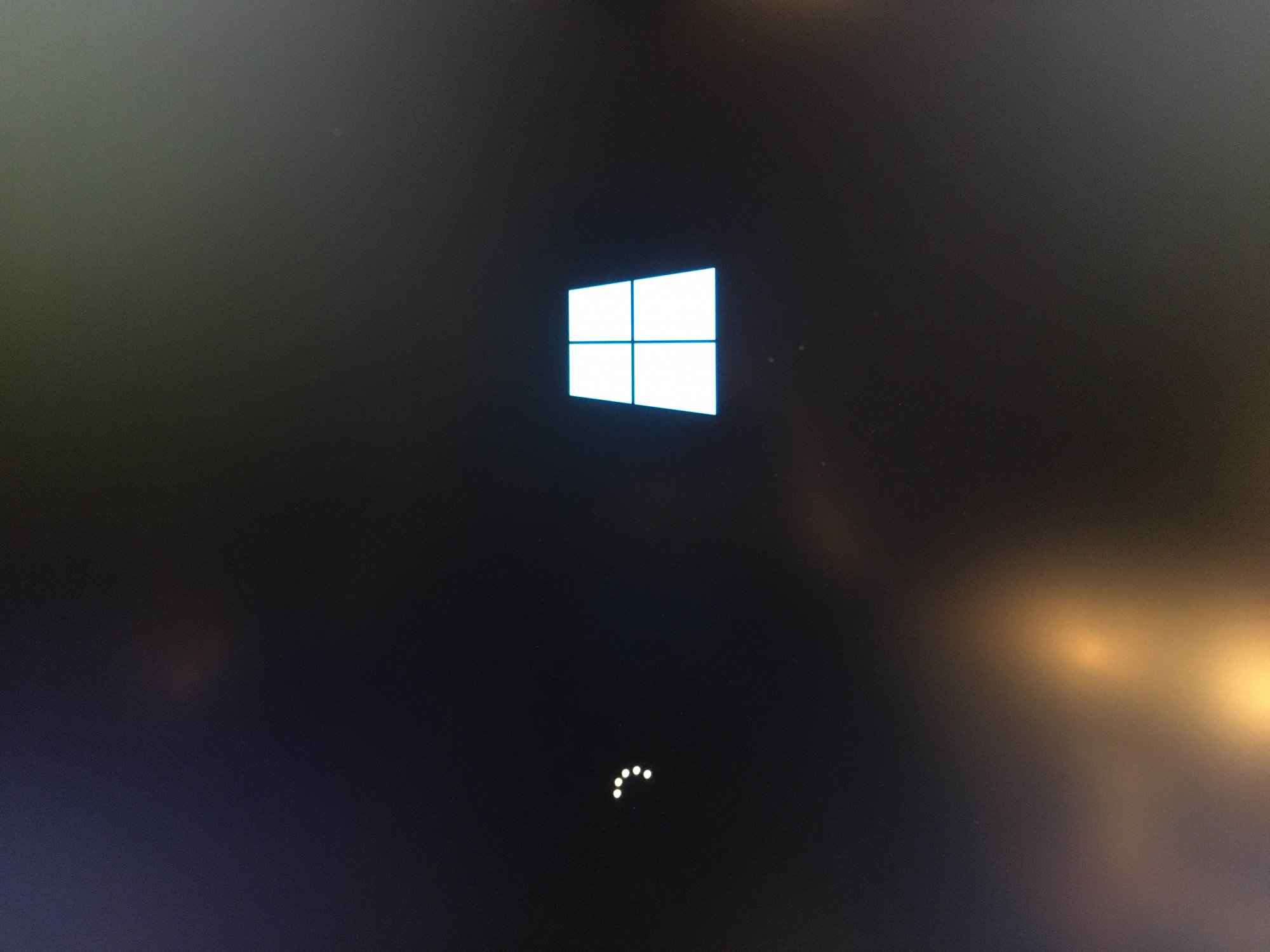

Auto-reboots. OC kicks in, Windows is booted, logo appears, no spinner again. I’m seeing a pattern here. Every other reboot during an installation and Windows is failing to start up properly. Remember, there’s only the one SSD installed to one SATA bay. It‘s in Bay 4 - I wonder if this behaviour would change if it were in Bay 1. Something to test another time now I know my BootROM is safe.
Another hard power off, OC kicks in, Windows spinner appears.

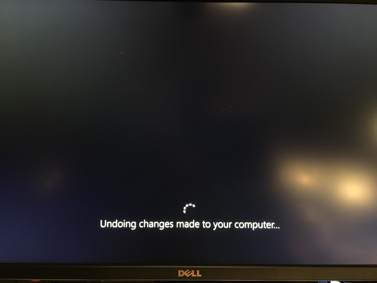

Recovery back to 1909 is successful. Two last things to try before quitting - check a standard reboot for spinner activity and then double-check my BootROM integrity.
UPDATE6: No issues at all rebooting. OC still present, spinner appears, back in Windows.

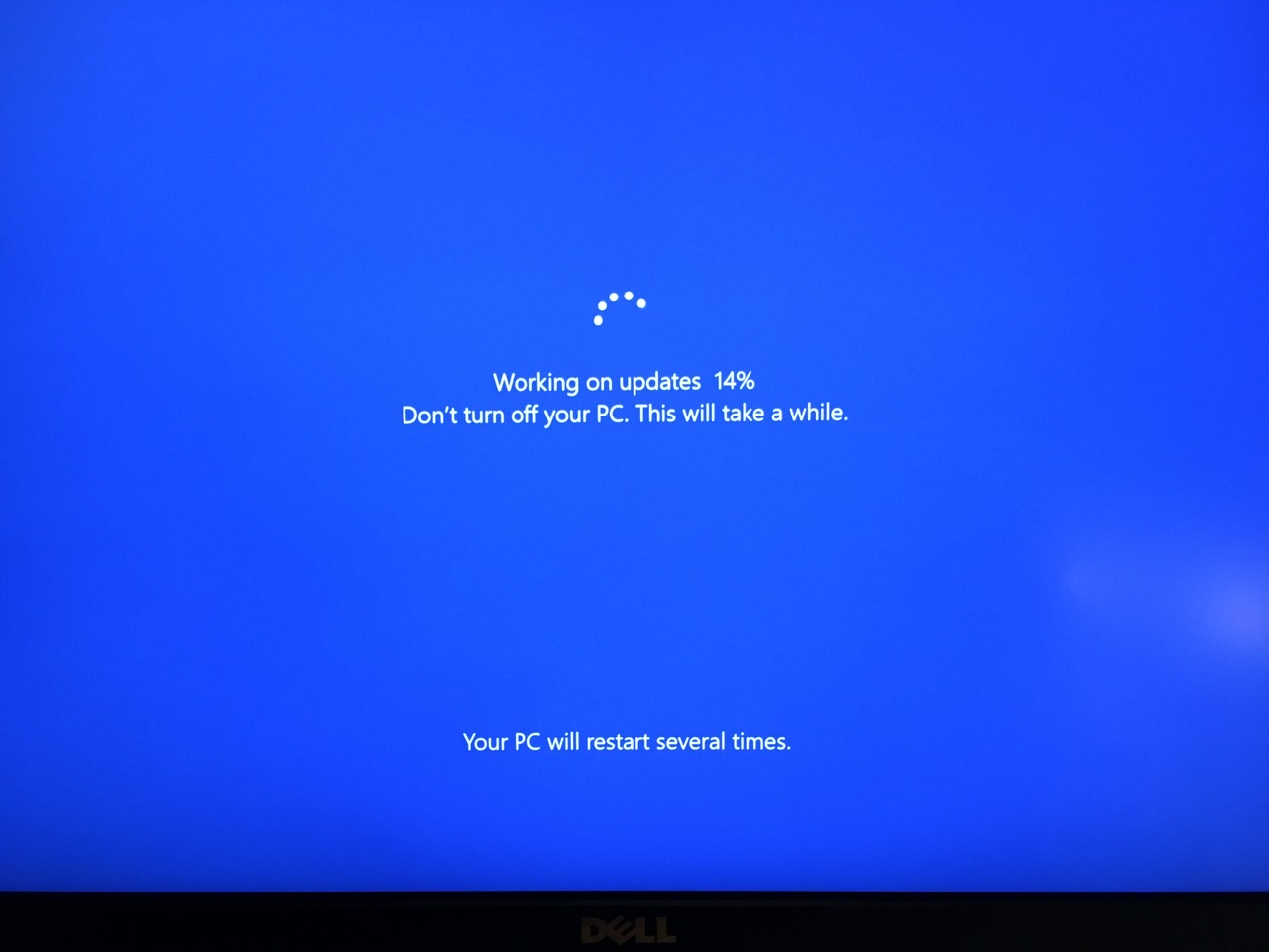

Here we go again, this time with the AdviseWindows property set to true.

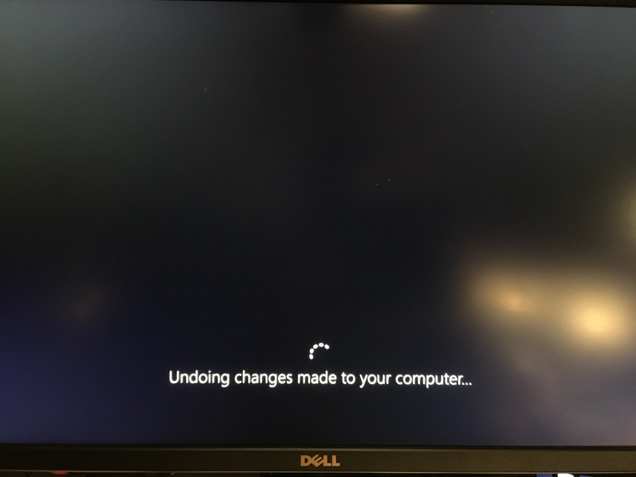

UPDATE: Gah.
Okay, so the update runs to 29%, auto-reboots the machine, no spinner, hard reset, spinner, “attempting to recover”, auto-reboot, no spinner, hard reset, spinner, “undoing changes made to your computer”, auto-reboot, spinner (fine that time), we’re back to the login screen.
Only drive present on Bay 4 internal SATA and OC remained active throughout.
I'm going to have another look through the documentation, but other than moving the drive to Bay 1, which I don't really believe will make any difference, I'm all out of ideas on this one. It would be a monumental PIA to have to reinstall Windows from scratch with each major update; or potentially have it continually attempt to apply an update which always fails.
Why, Windows? Why?
