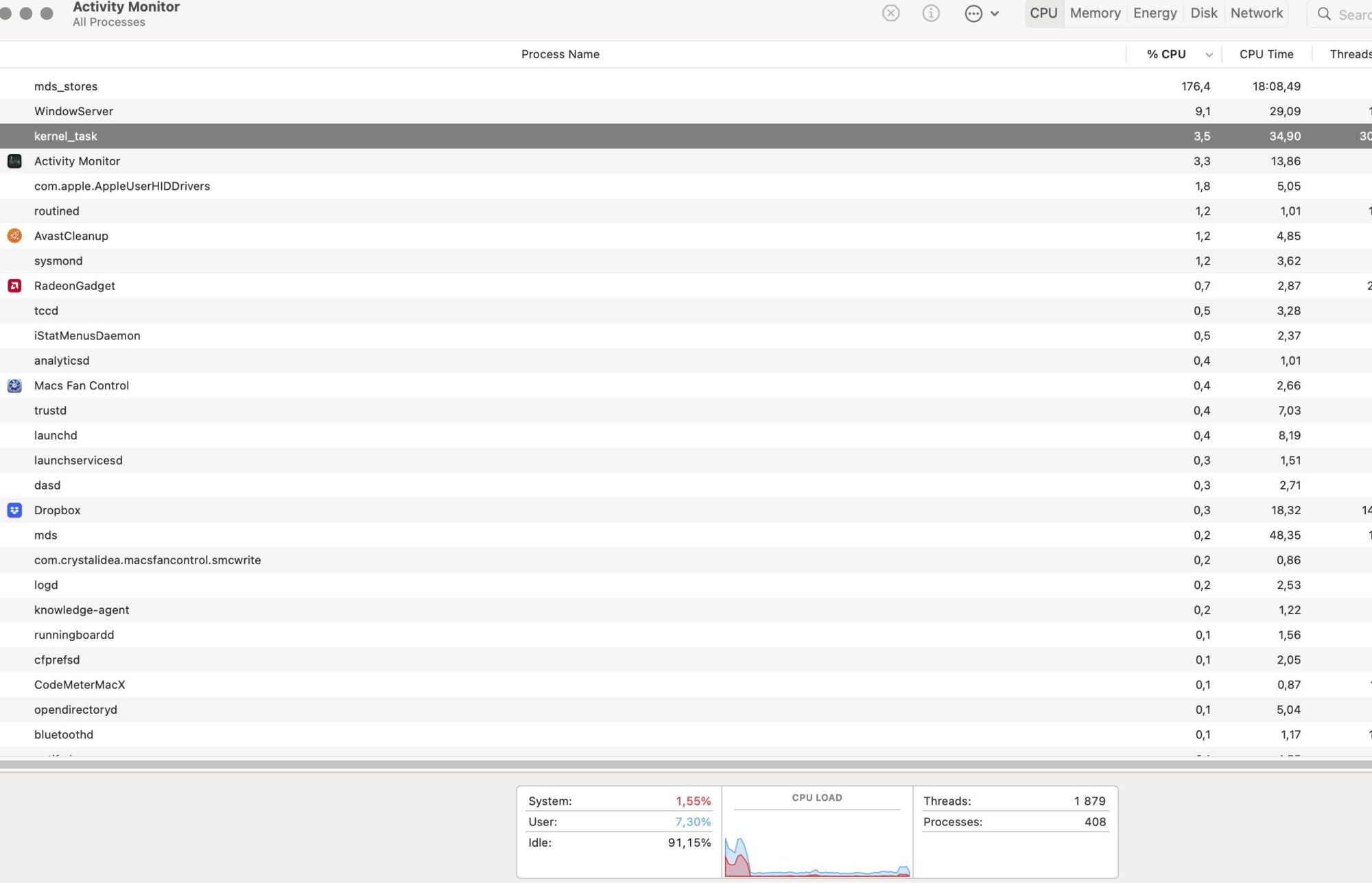

As for me, after the update, indexing of disks appeared
- the processes "mds" and "mdworker" and unknown kerneltask, these three processes did not stop for almost 40 minutes
- I did not wait until this madness was over...
Reseted nvram and smc - did not help
as a result, for two hours I turned the computer on and off, each time I turned it on, I reset SMC and NVRAM
Kernel task 60% and mdworker on each core continued to use all CPU resources
and only after I myself got tired of turning the computer on and off - finally all the processes disappeared after the next reset of smc and nvram

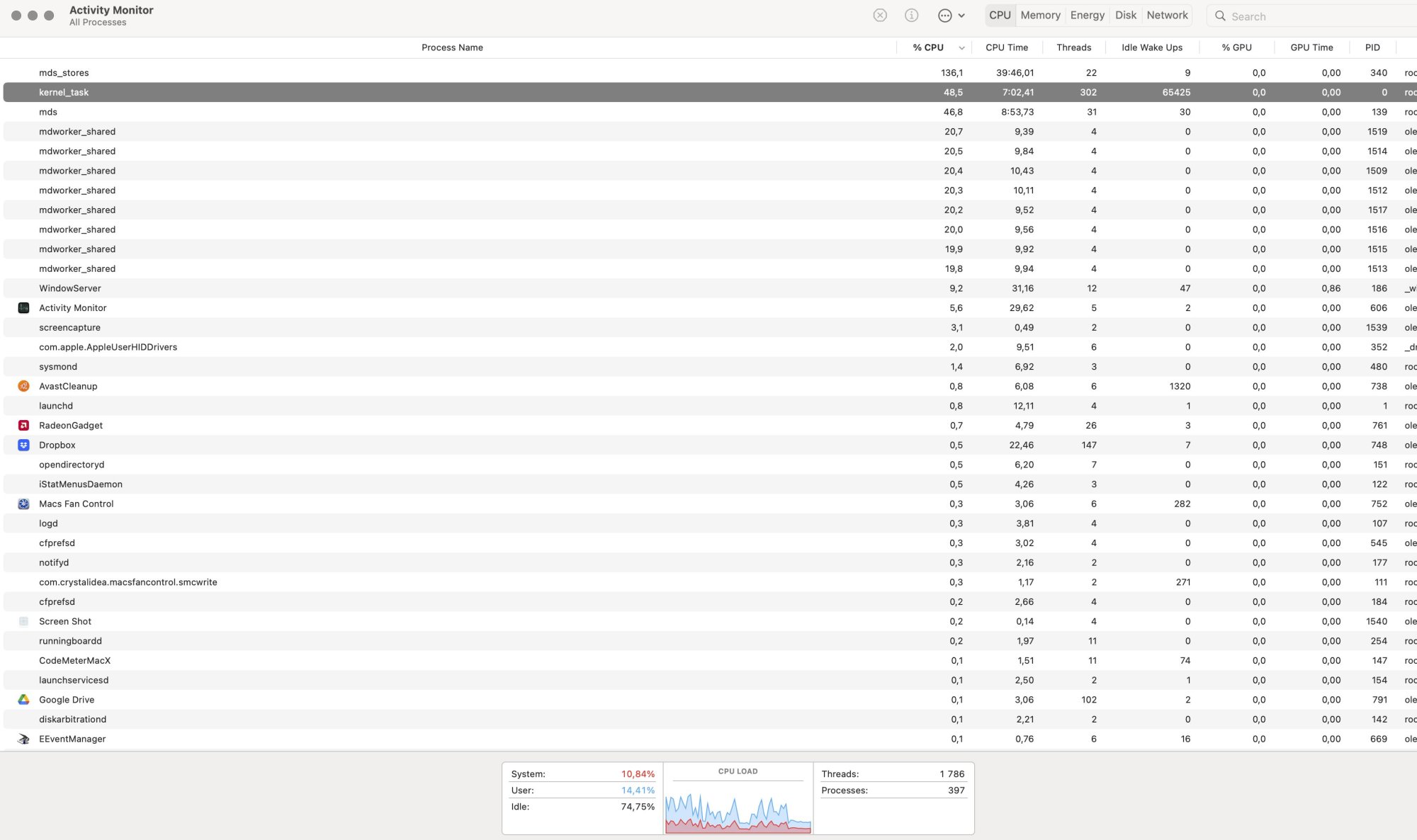

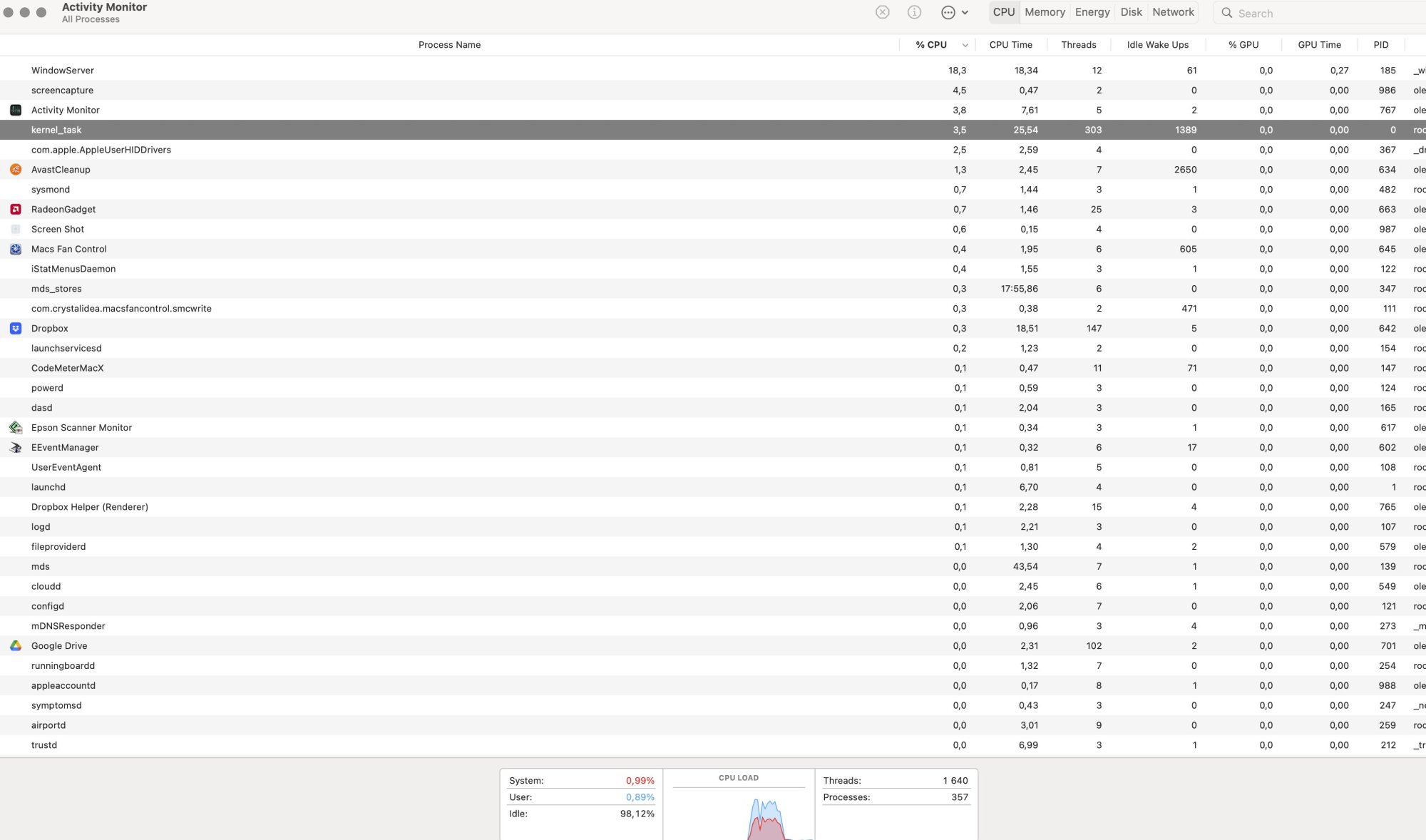

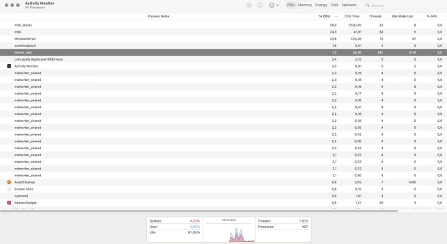

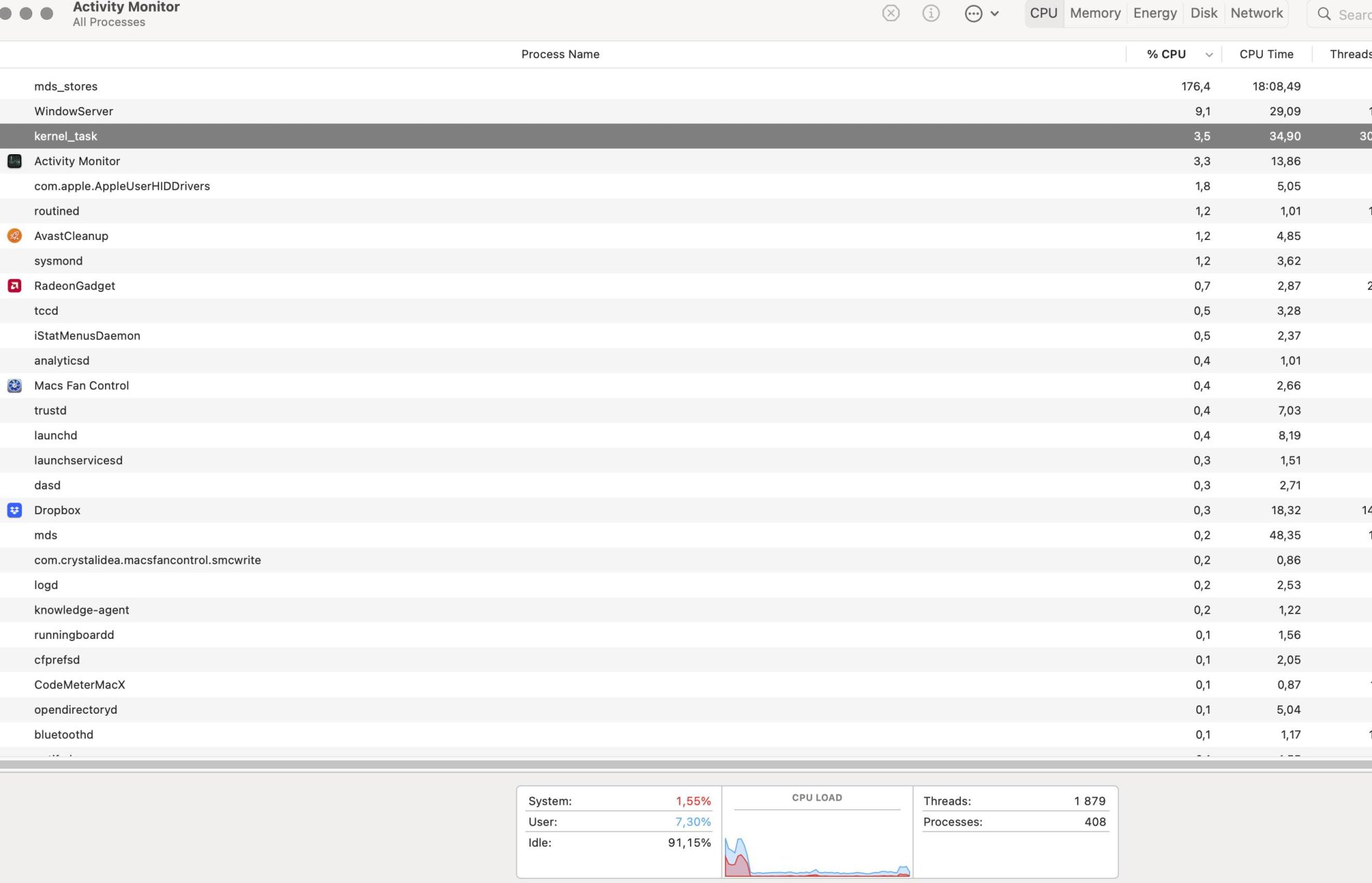

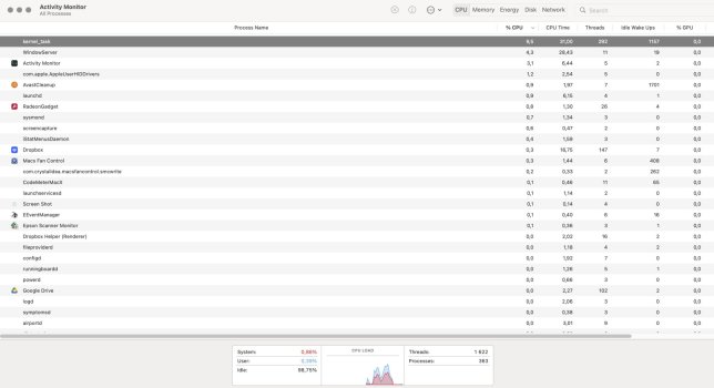

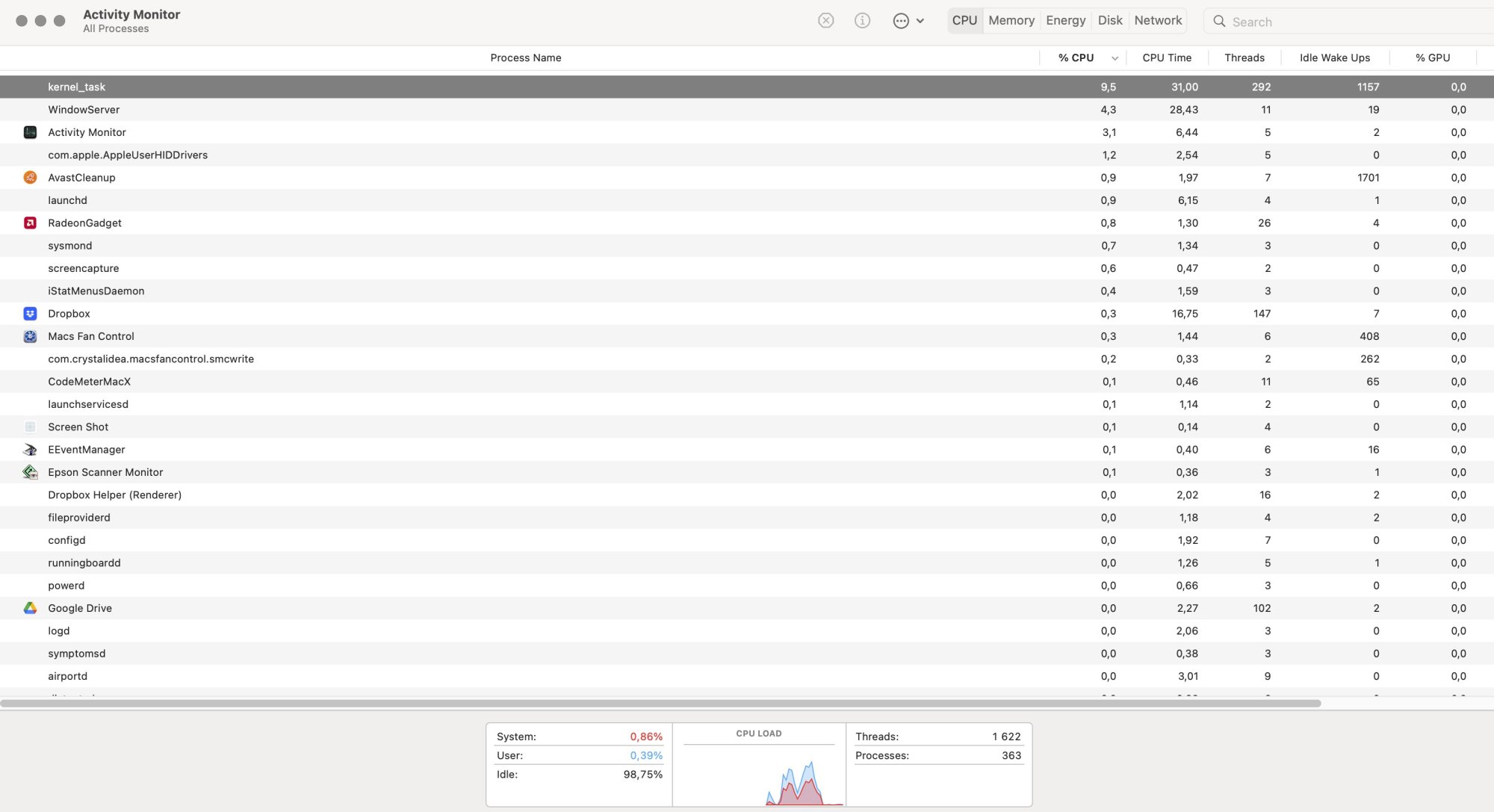

All week I worked in macos
But today again I got a problem when trying to boot into Windows on my cdf config
windows hangs on boot window
I reset smc and nvram and booted in to windows (and already foresaw a repeat of the problem with macos)
Windows on shutdown asked to wait while it is being updated

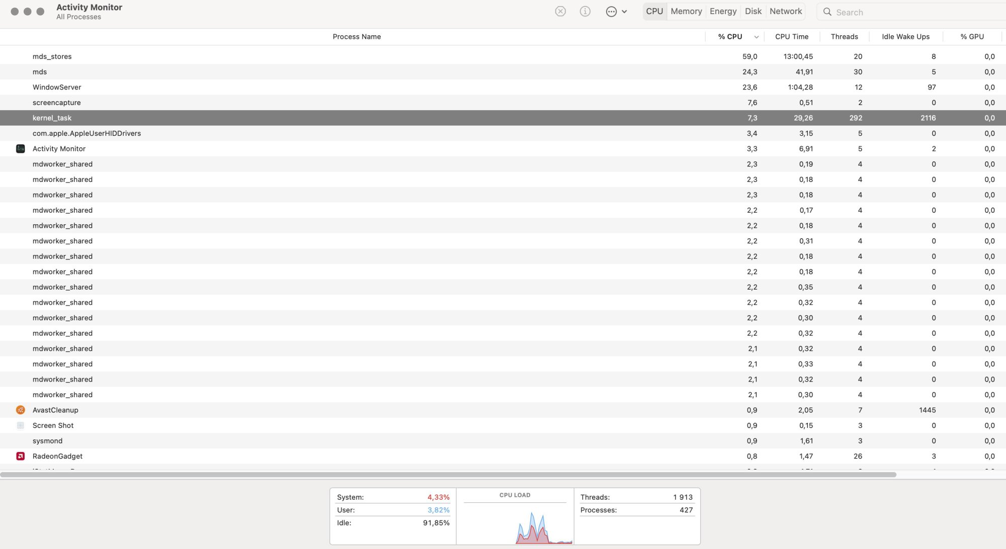

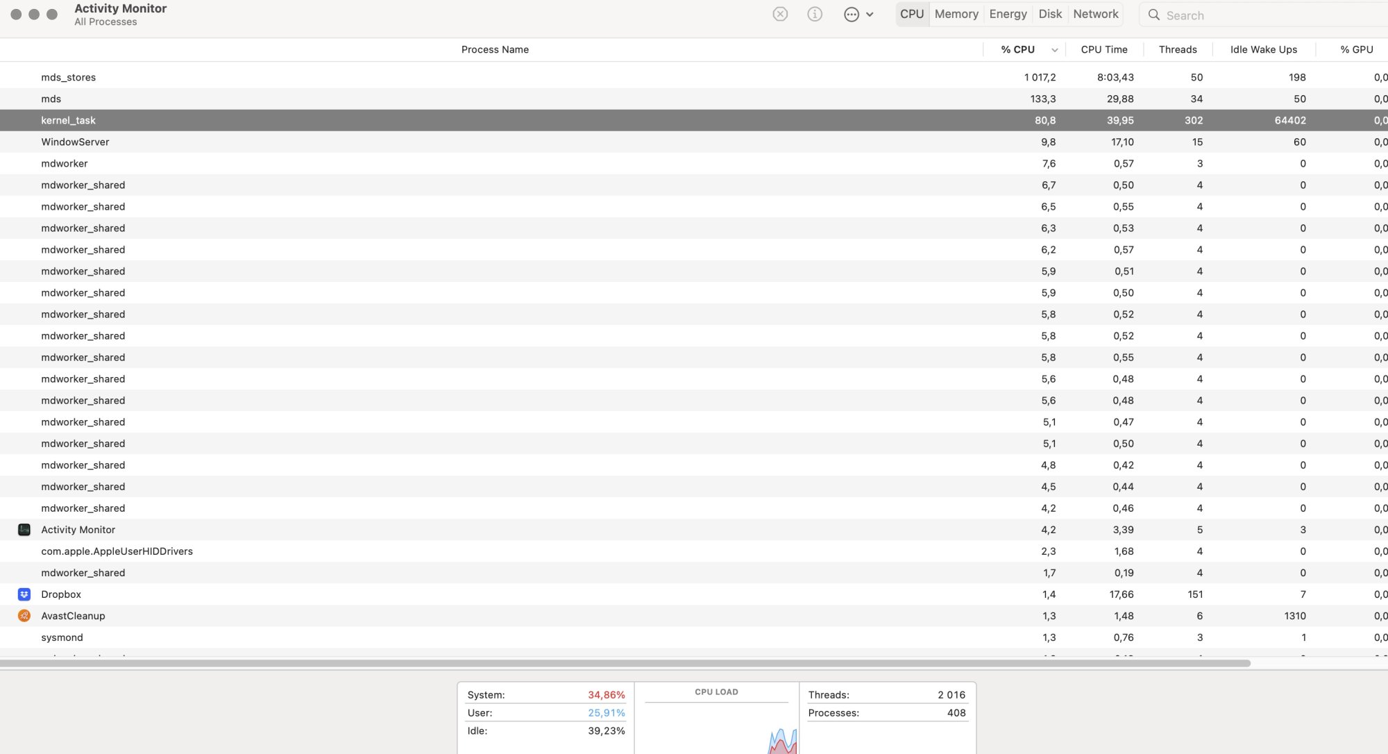

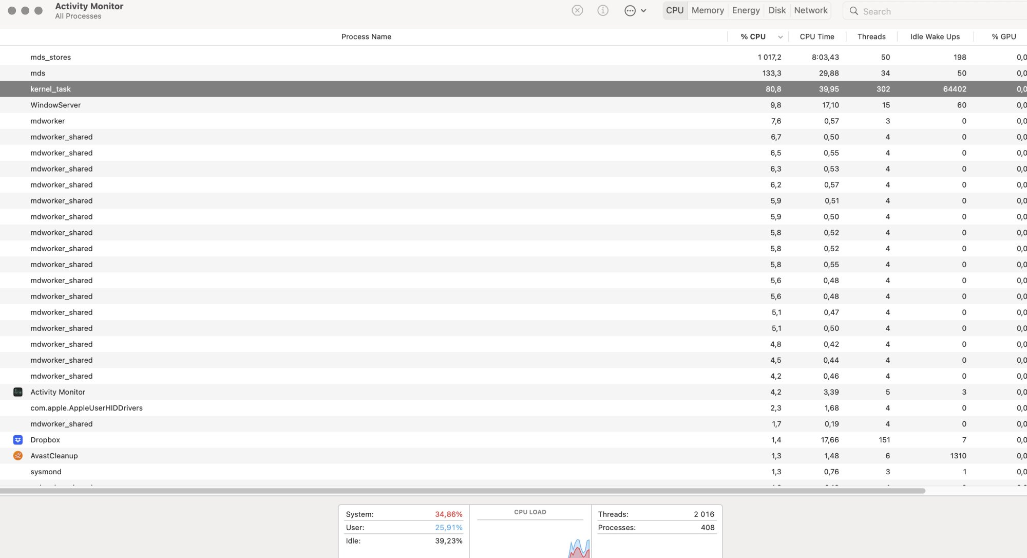

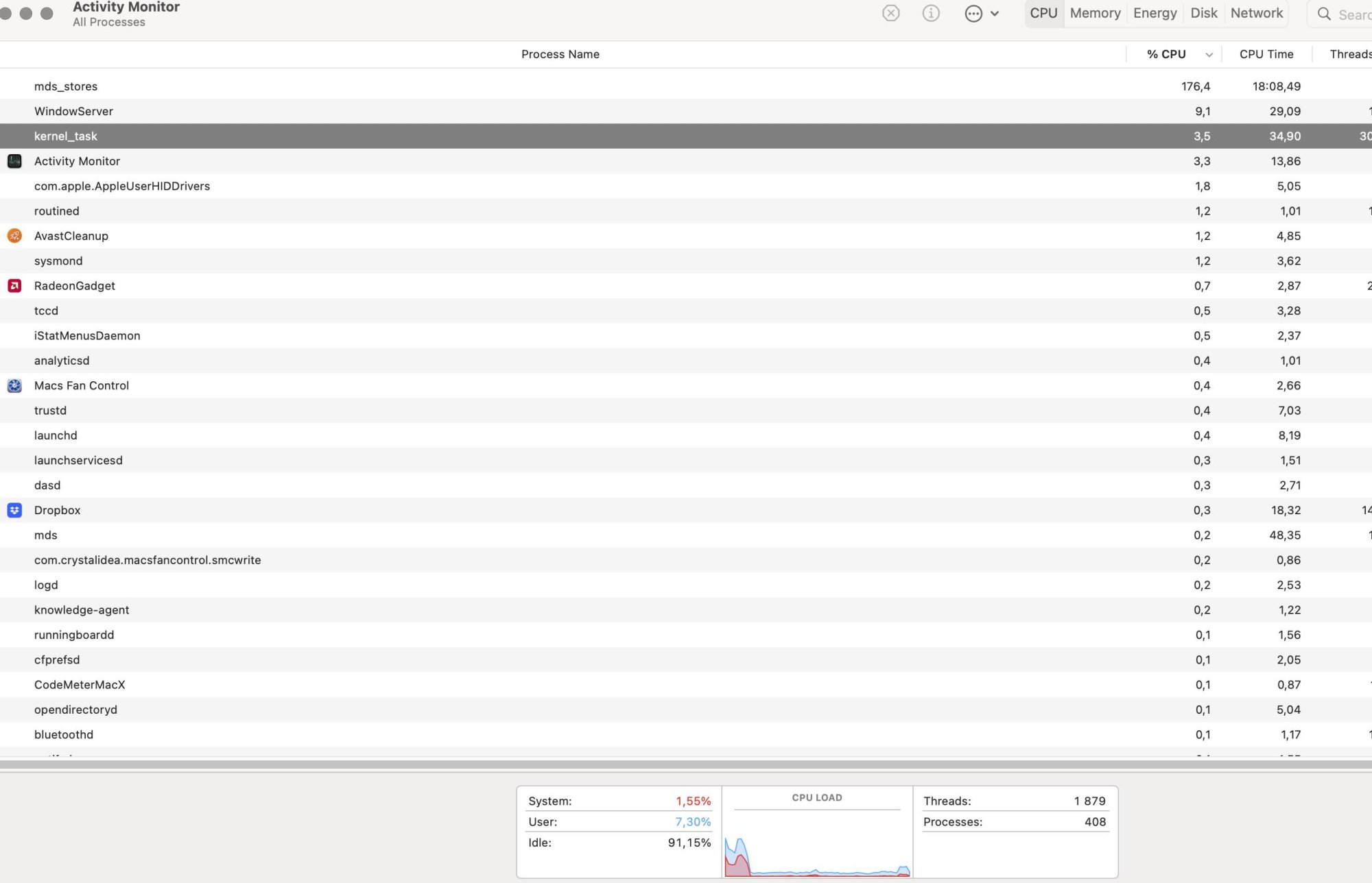

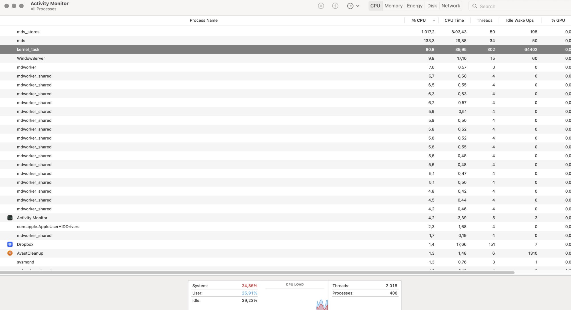

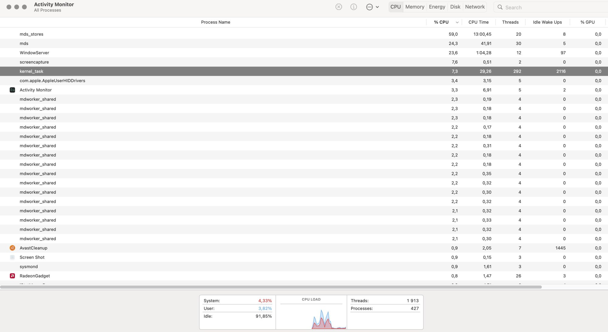

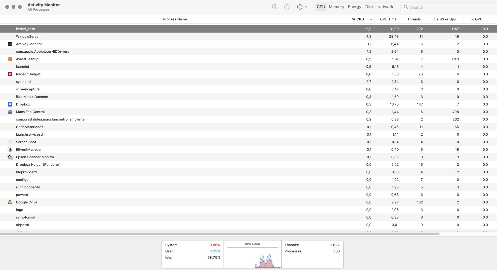

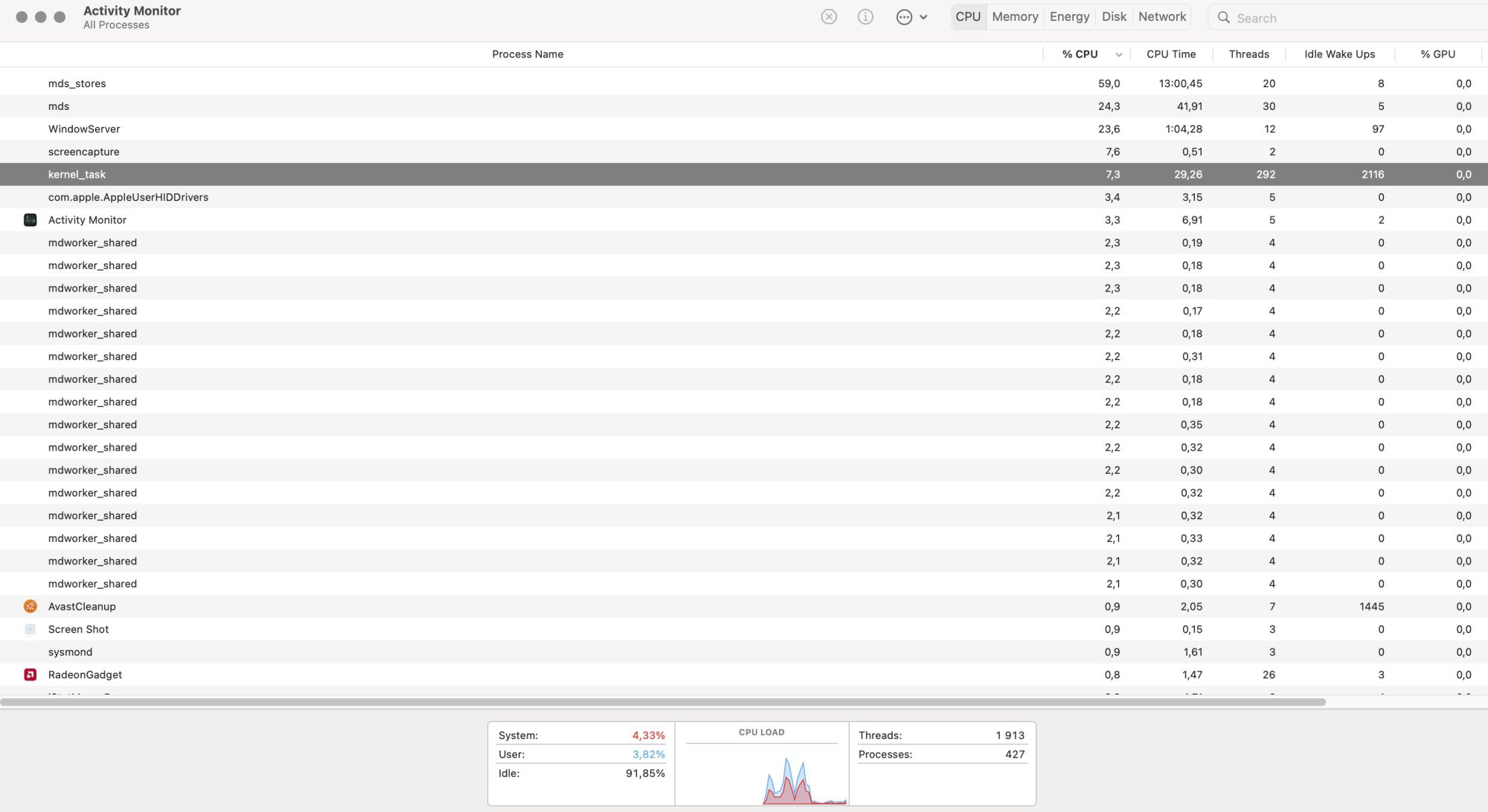

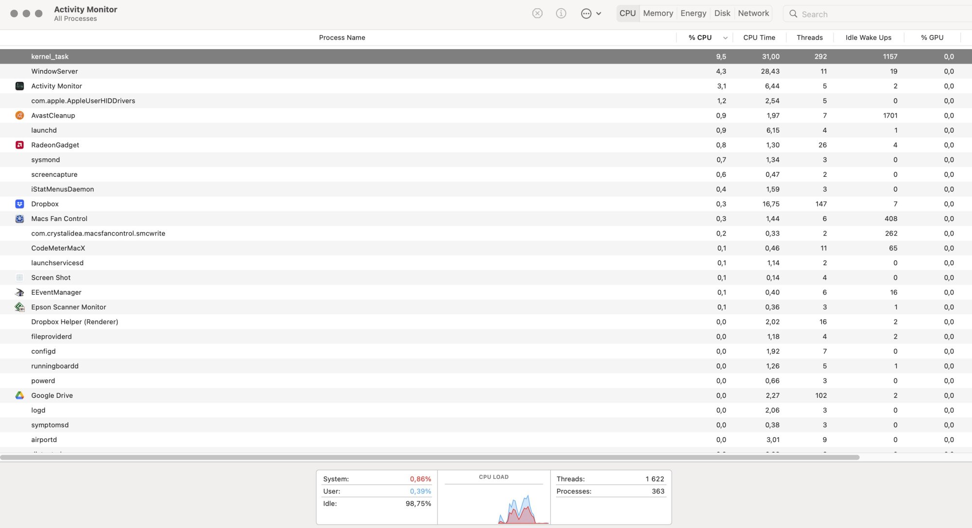

And rebooting into the macos, I got a lot of uncontrolled processes - again kernel task 80%, mds, mdworker, etc.
Multiple smc and nvram resets - which I had to do continuously for two hours, finally killed the kernel task
(and of course they disabled a trim on my two SATA SSDs)
but the mds process did not stop for more than 20 minutes
in general, for me an indicator that something is wrong, this is a kernel task more than 7% and multiple mdworker on each core
Therefore, I thought that MDS probably indexes incorrectly due to trim
I enabled trim and all processes returned to normal
but I once again made sure that rebooting into Windows affects the state of nvram-
this is a question for opencore devs
maybe the lines about nvram update or smbios update need to be reconsidered somehow?
there are several illustrations in the appendix - incorrect work, fixed it, but without trim, and with trim

as far as I remember, the same behavior was when the monterand problem first arose
and then, when it was solved with the help of no_avx kext or syncretic's patch and aspp-override - I remember that after updating the macos, it was necessary to change the maxkernel
Maybe now the version of darwin has also changed?
or something else similar?

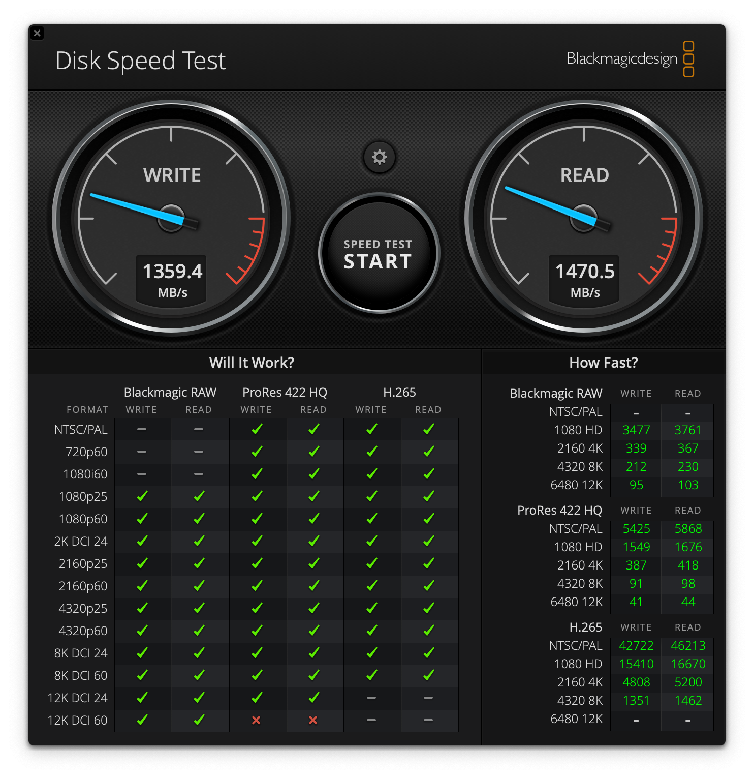

Has anyone successfully used an M.2 ssd on a smart PCIe card with OC? (Or OCLP for that matter.) And got full 3,000+ MB/s read/write speeds?
I can find no reference to this, anywhere.
Prior to OC I ran Mojave with an IOCrest X4 pci smart card and got the expected read/write speeds. Both as in OS installed drive and as a storage volume.
I'm at current OC release on Mac Pro 5,1 running Monterey. Have dual NVMes on an IOCrest X4 adapter card. The card is recognized, and I see in the pci tree that the switch, an ASMedia 2824 chip, directly preceeds the NVMe ssds ... but the smart switch must not be enabled because both drives max out at 1300MB/s. And these cards don't use a driver. Any idea how to fix?
Does the card and its location need to be registered on IOPlane in order to be enabled?
Same card with different branding here.
Which slot did you put it in? What ssds do you use?
I had to move the card from slot #2 to #3 because of the RX 6800XT I installed, however previously, when in slot #2 in synthetic benchmarks my Adata SX8200 Pros were as close to ~3000 as the rest of the hardware permits.
In slot #3 I get around half that, which is fully expected.
I was obviously disappointed I had to move the drives to a slower slot, tried using a ribbon breakout cable which proved fairly useless, however the speed difference actually makes zero impact on daily use and is perfectly unnoticeable.
