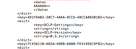

Hello,
I've updated my opencore from 0.7.6 to 0.9.3 and when I run the commande to check which OpenCore version I've it return this
Code:
4D1FDA02-38C7-4A6A-9CC6-4BCCA8B30102:opencore-version    UNK-000-0000-00-00
I'm attaching my plist file.
I've updated the plist file using both the Macrumor thread, the plist available in the first post and dortania's PDF.
My original PLIST has been built using OCLP first and today I've done it manually.
Thanks!
As I can see- you use OCLP- not OpenCore from post#1
Reactions: NC12

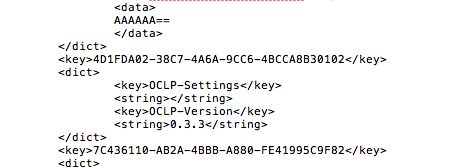

Hello,
Code:
Thanks!
Confirm that you only have one EFI folder.

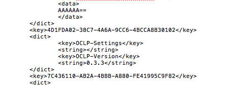

The sign of OCLP are from my original setup with 0.7.6 a while ago. But last weekend I have not used OCLP to update OpenCore.
Yes I can confirm only one EFI folder.
Your ExposeSensitiveData needs proper setting and your NVRAM begs for a triple chime cleanup.
Thanks for your advice will do this next time I boot my cMP :)
but if you use OC, you need change config too- this config from old OCLP and your opencore not work properly
