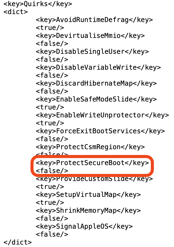

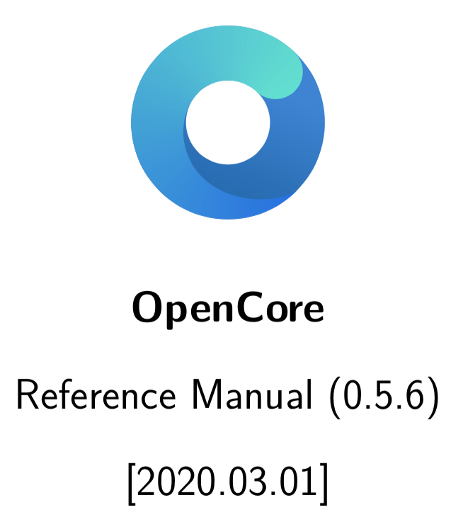

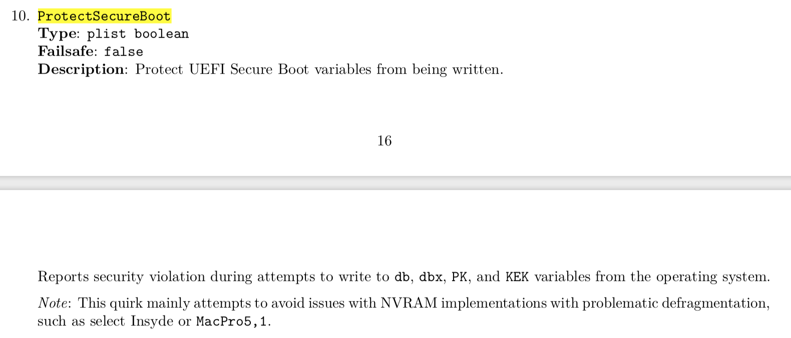

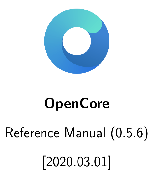

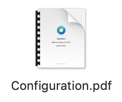

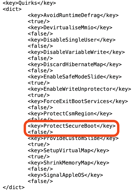

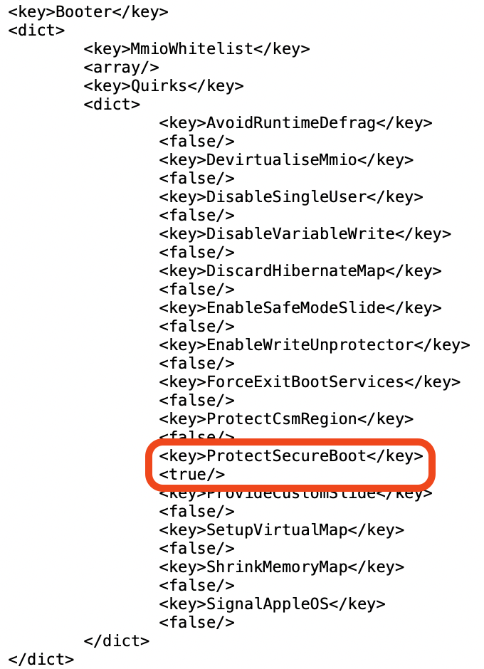

How exactly does one turn on protectsecureboot in config.plist ?

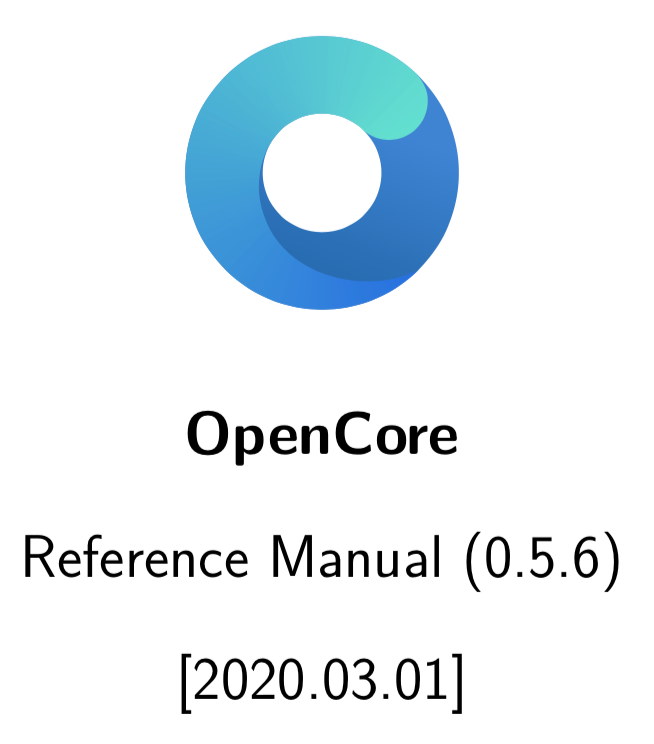

All functions explained inside the manual. You better spend some time to read it.

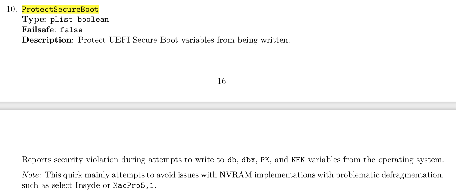

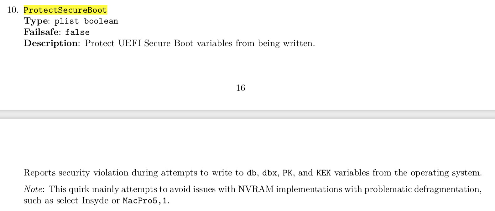

e.g. For ProtectSecureBoot

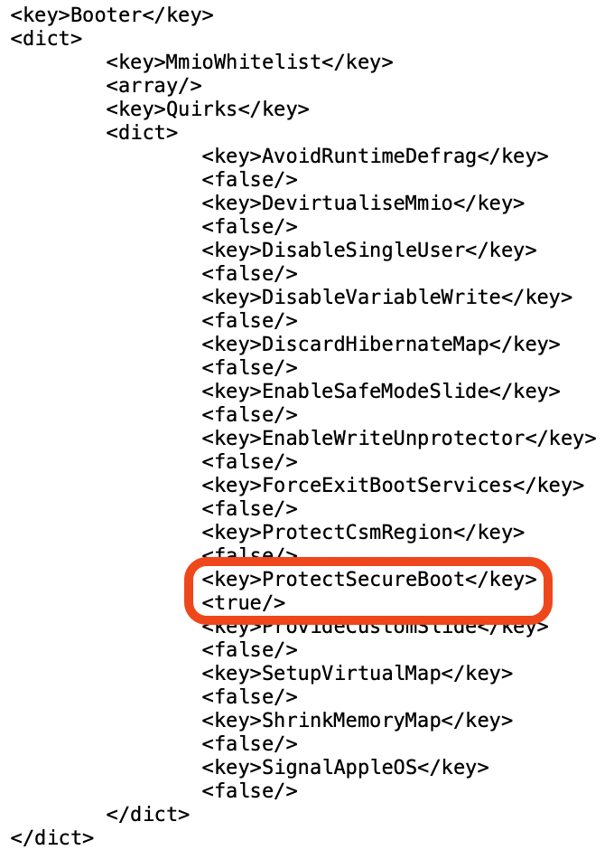

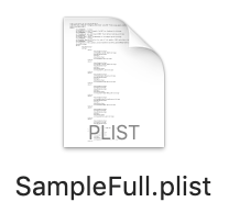

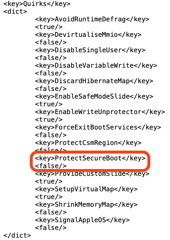

The actual usage also demonstrated inside the sample config.

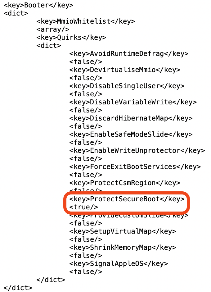

Therefore, after your read the manual, you can copy the key from the sample config to your own config.plist (if the key isn't there yet). Then modify the value to what you need.
e.g. If you want to turn on ProtectSecureBoot

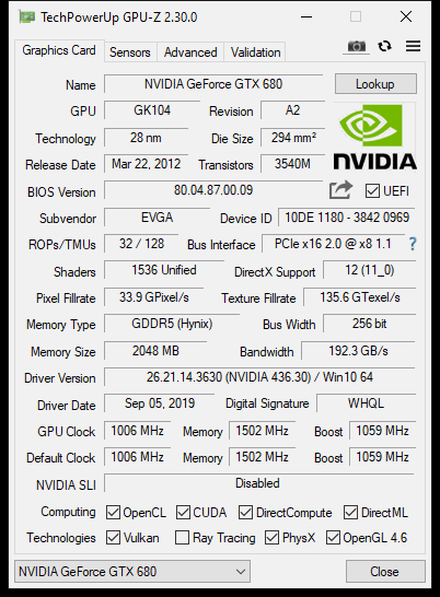

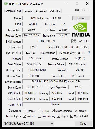

Hey all, i am having this problem with flashed Nvidia gtx680 gpu.
I had no problem in legacy version of windows with nvidia gpu
I managed to install Efi windows 10 at last but having black screen at first boot then it says “Nvidia windows kernel mode driver” after a 45secs or more waiting.

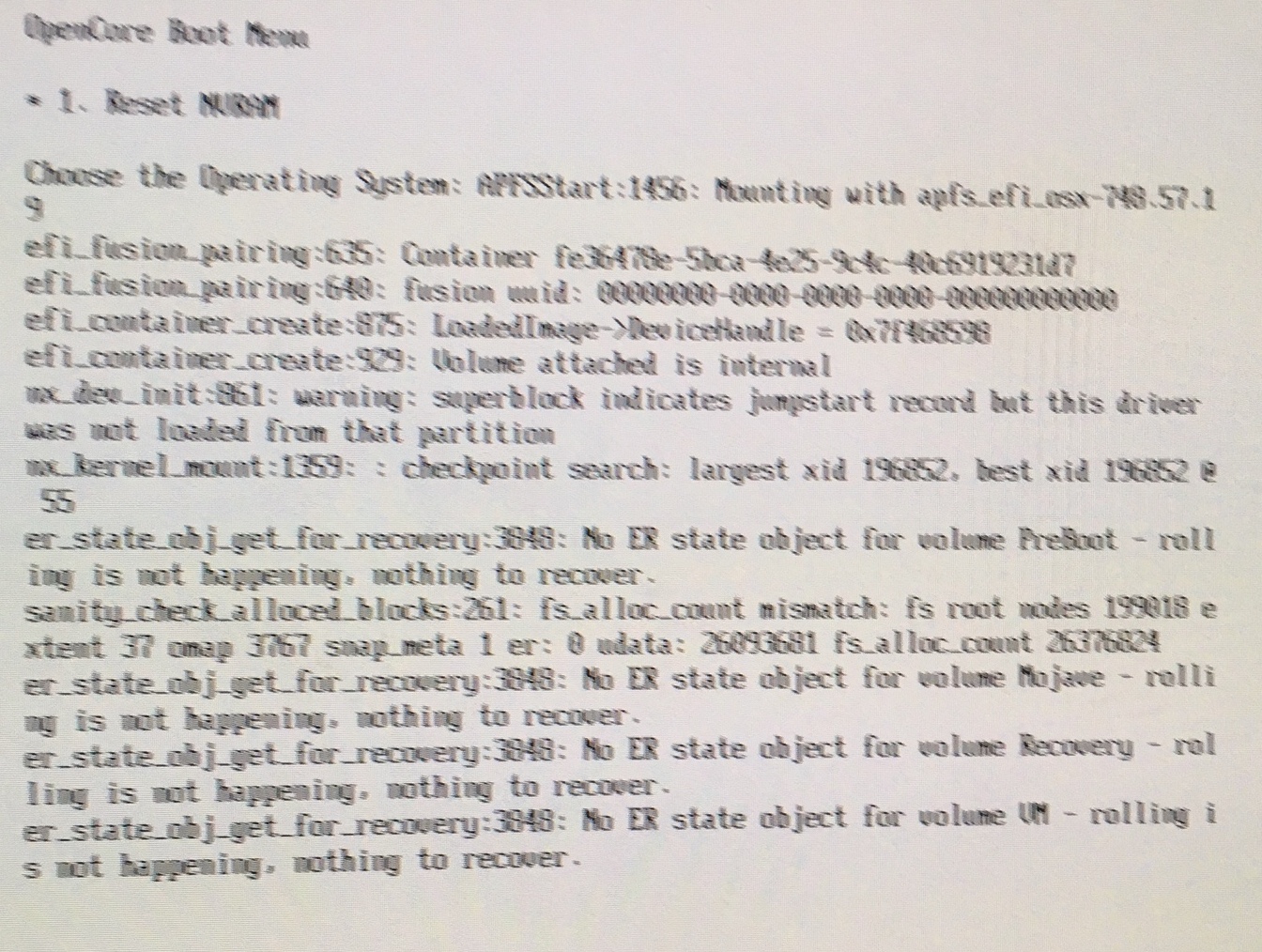

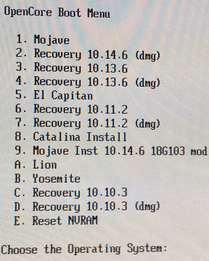

Tried Open Core (Settings from Post 1) on a Mac Pro 3.1 (EFI64 GPU, APFS Rom Patch if that counts)
just copied the EFI Folder to a USB HDD and blessed it.
Just worked but maybe I have found a bug.
When I do
Code:
<key>AllowNvramReset</key>
<true/>

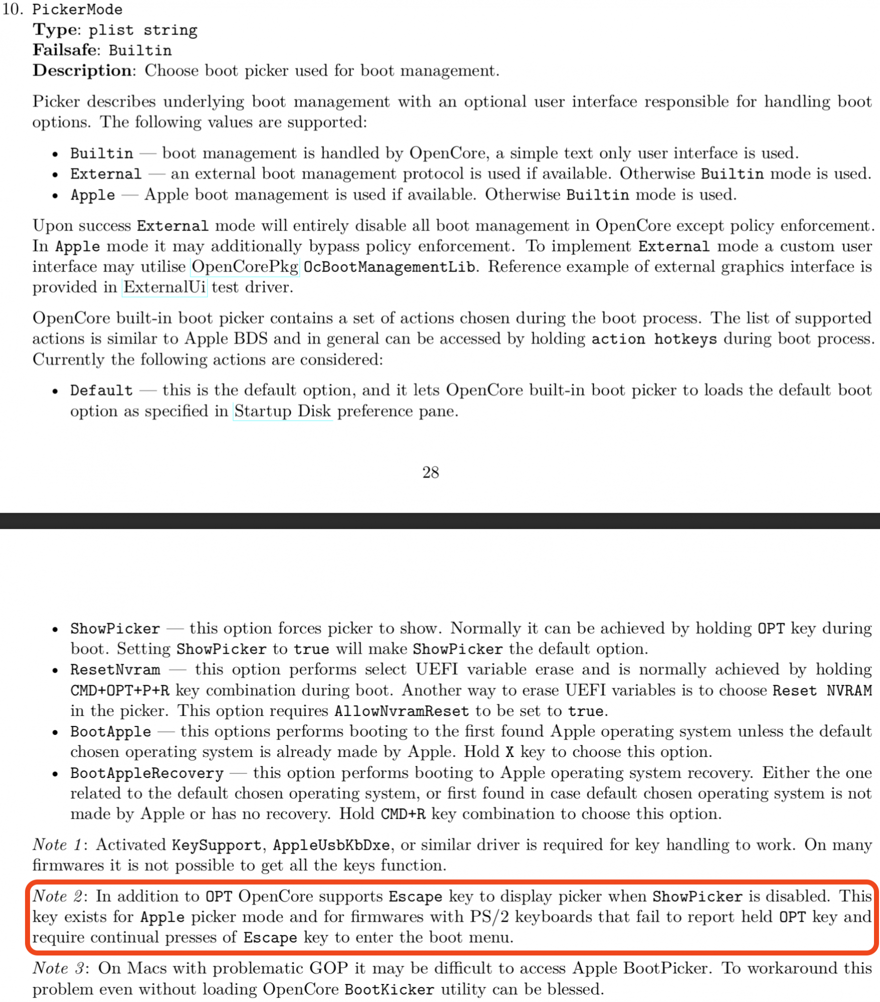

I get 1st option to reset nvram, it resets of course after delay and error messages.
When ESC key is pressed it takes me right to picture 2 with correct list of systems plus clear nvram option.
after ESC key:
Reactions: MIKX

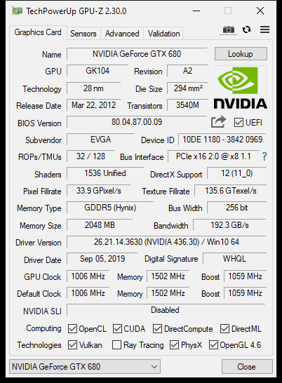

It says gtx 680 supports UEFI and the bios is there. I am confused :/
That's the Mac EFI UGA, not UEFI GOP.
GPU-Z CANNOT tell if your card has a real working UEFI GOP in the firmware. It only detect if there is anything in the EFI section.
is there a way to flash with UEFI GOP firmware then?
