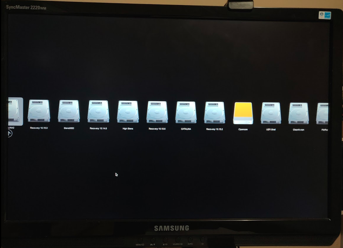

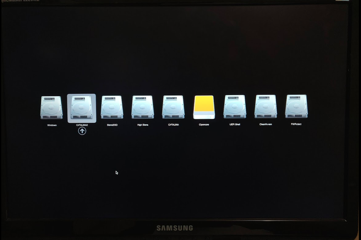

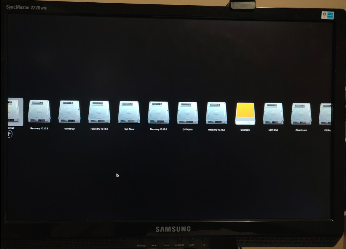

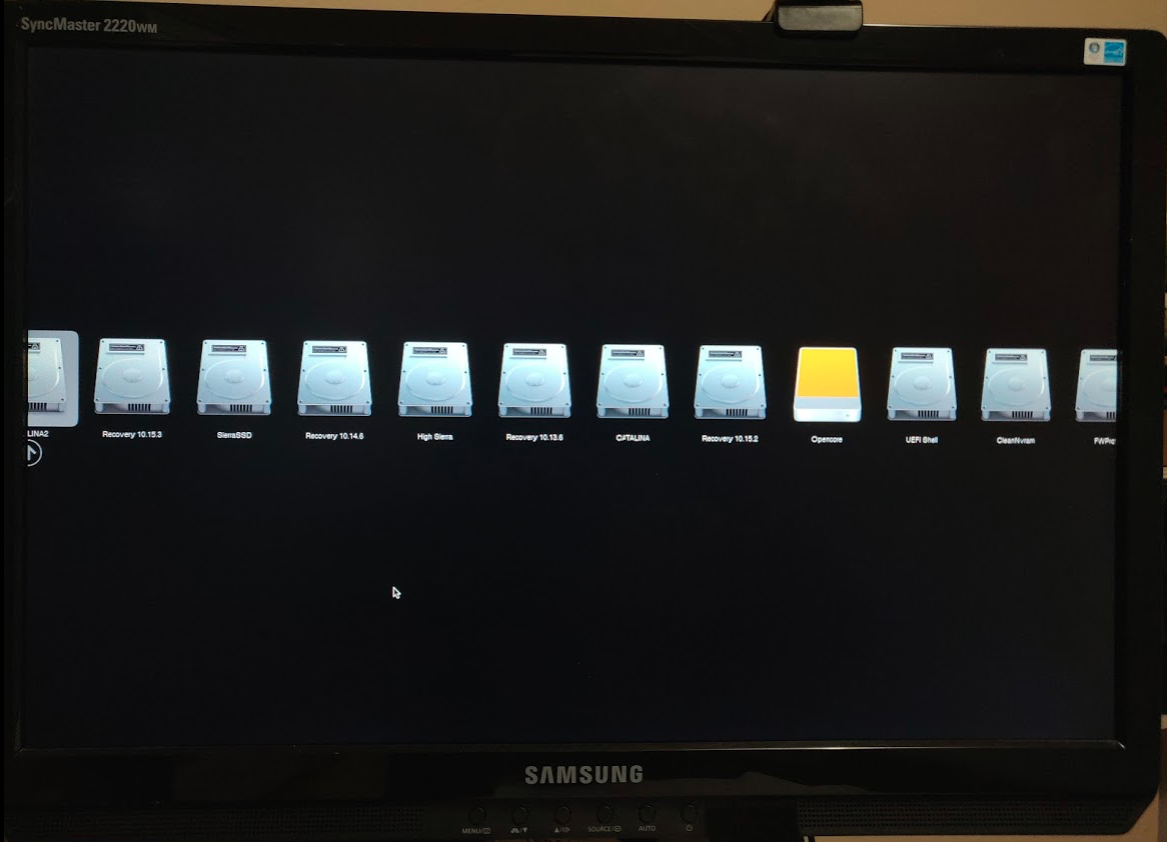

After pressing spacebar I got some icons getting out of the screen. There is no secondary raw like in NDK's bootlicker:
I'm finding with mine that it seems to be related to the monitor Pressure. Maybe that's the case with you too?How did you set proper resolution in OpenCore?
