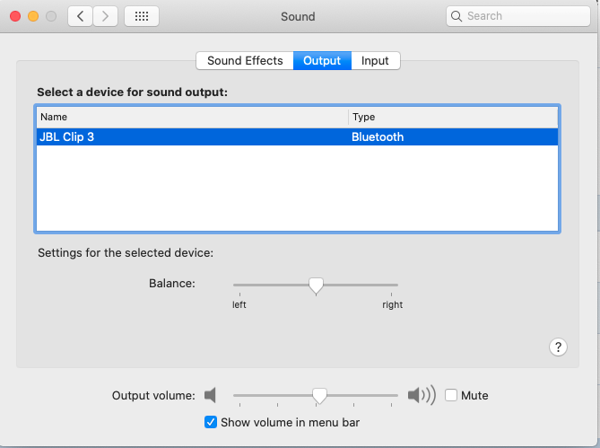

Somebody said system audio (internal speaker) disappeared with 10.15.4 update. I have the same issue. When I connect bluetooth speaker I get it back. But only for the bluetooth.

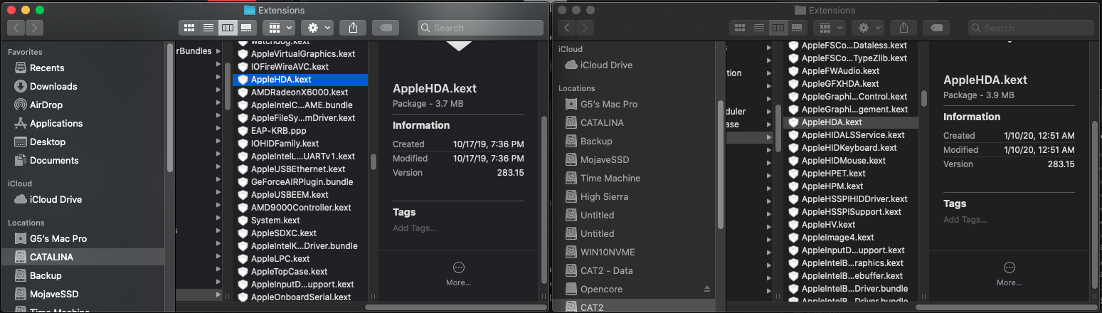

So I noticed my other Cat's sound was working. Then I compared both AppleHDA.kext:
Apparently the older AppleHDA.kext was the working one.
For those who have Audio issues with 10.15.4 attached is the latest workin AppleHDA.kext

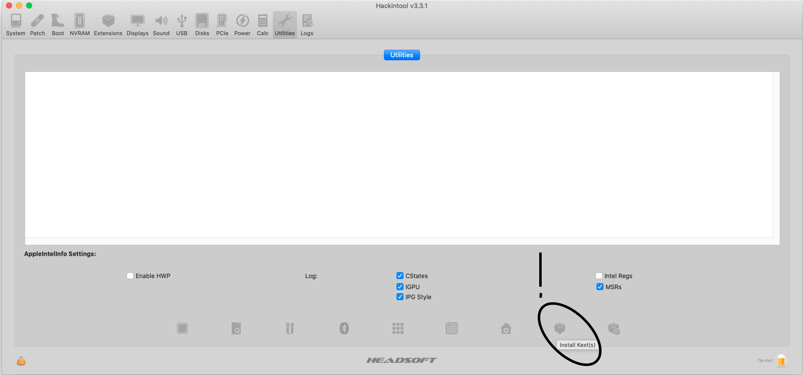

Use Hackintool and install this kext in /S/L/E overwriting the non working. You may backup the original before doing this :
